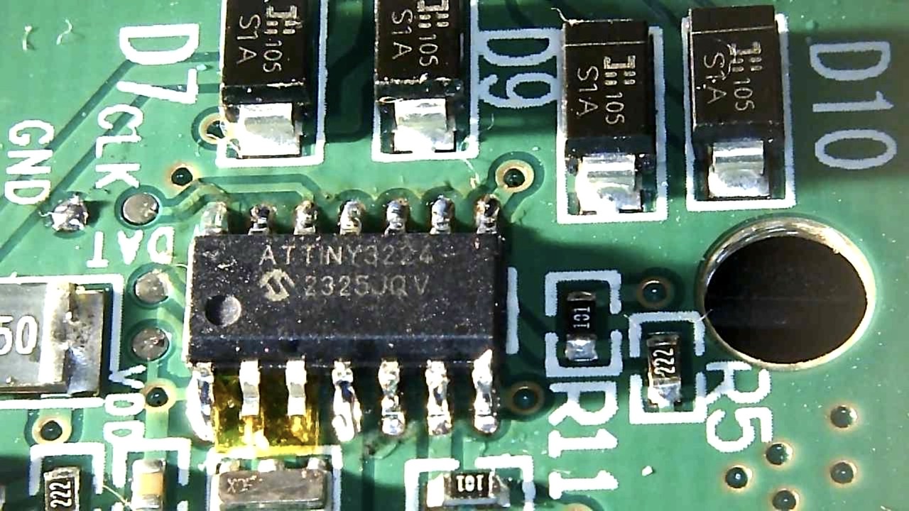

While this looks like an ordinary Scalextric Lane Changer, it does have a few differences. I replaced the factory fitted PIC 16F with an ATtiny3224 in a SOIC14 package - which is generally pin compatible so not to hard. I then wrote some C++ code to implement normal XLC functionality. The result is that it works correctly.
The reason for doing this is to create a starting point for adding extra functions such as collision avoidance, pacers barred from pits, configurability of flipper direction when LC pressed and, maybe, some sector timings. Non of this is particularly novel but its fun to implement non-the-less.

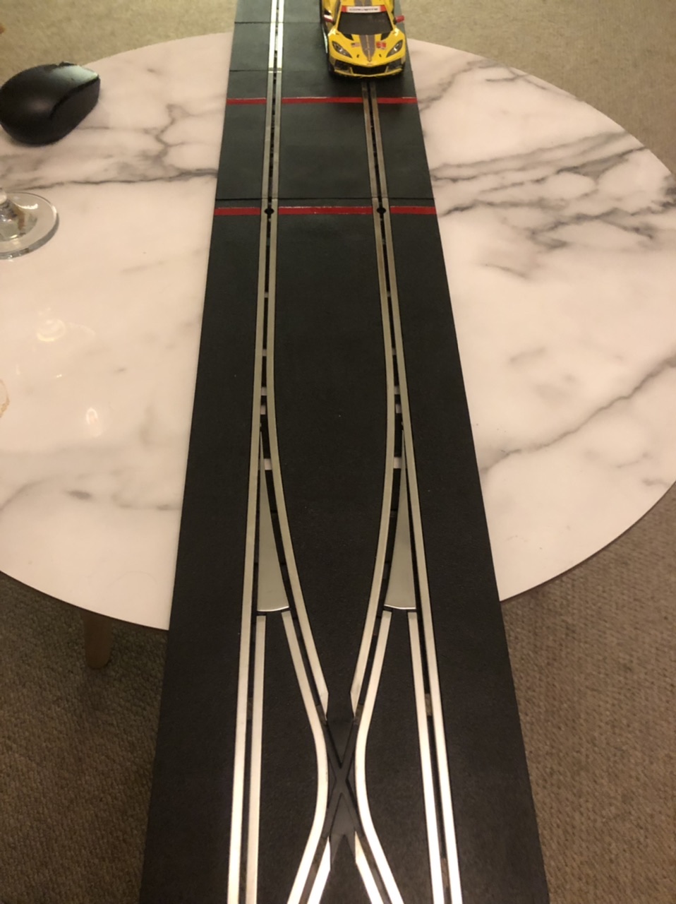

RE: Experimenting with Scalextric Lane Changers - Dr_C2 - 29th-Oct-23
I recognise that so far I have only shared some photos of Hornby/Scalextric lane changers with a bit of red paint added.
So two bits of further background:
1/ one of the red stripes shows where the ‘standard’ Hornby/Scalextric sensors are located. The secondary or ‘earlier’ red stripe shows a pre-decision sensor location. This is all about collision avoidance - which done properly (IMO) needs two sensors per lane i.e. the ‘pre-decision’ sensor followed by the normal ‘decision-point’ sensor. Next I will show some photos of the standard Hornby XLC pcb with the upgraded ATting3224 in situ plus the extra wiring for the two lanes of ‘pre-decision’ sensors.

[attachment=32199]
Here is an ATtiny3224 fitted to a standard Scalextric lane changer PCB. This board has been under test at rug/carpet level hence the specs of dust. It’s functioning precisely as it should.
The ATtiny has a factory calibrated internal oscillator so the silver component in the foreground (known technically as a ceramic resonator) is no longer required. This frees up I/O pins 2 and 3 (and adjacent landing pads) for two additional sensors. As mentioned earlier these extra sensors are useful when implementing collision avoidance. I refer to these additional sensors as ‘pre-decision’ sensors since they are used to read vehicle position at a point in time prior to decisions being taken on whether to permit driver lane change requests or not.
Next the additional sensors need to be wired-in and the collision avoidance algorithms added.
This is a nice little project which has the potential to help avoid unnecessary collisions on Scalextric digital setups - improving flow and reducing damage to cars.
I believe previous versions of third party anti-collision firmware have used a single sensor per lane and retained the original PIC 16F630 microcontroller. Both the extra sensors and the upgrade to the ATtiny should bring some performance benefits and, at the same time, simplify the coding process.

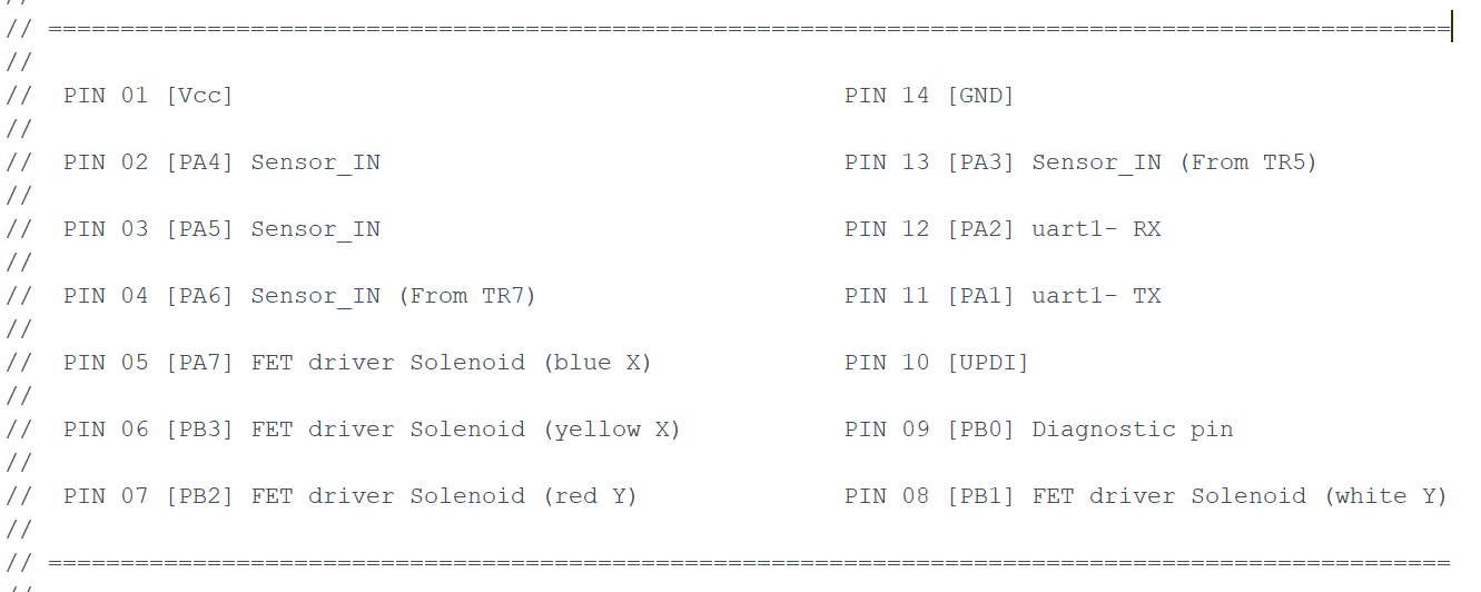

Finally, for this post, a graphic showing the pin-out which overlays the Scalextric lane changer perfectly. Extra pins in use are for the two additional sensors mentioned earlier and the hardware serial port. This port is useful for configuration of the lane changer, speed/ID read-out and a ‘black-box’ diagnostic read-out which should be useful as the anticollision side of things is developed.
Thanks for your interest in reading all of above.
