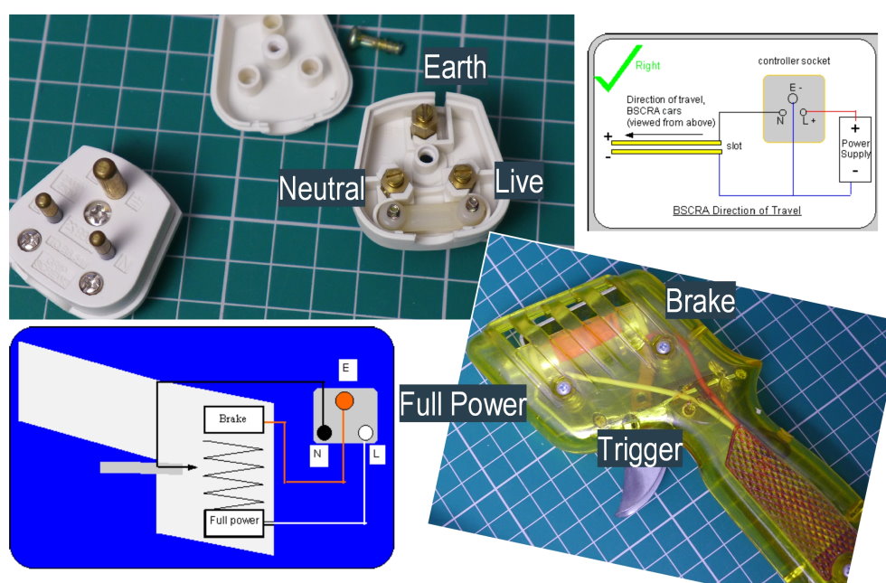

i have Parma controllers on my home track
and a DS controller for club track
but since Pendle club closure , i have no use for the DS controller unless i travel , which due to work commitments is not really possible
my problem is .... the club track was -( negative) polarity , and my home track is +(positive)
a problem i didnt realise i had , until i tried the DS on my home track
my question ..... is there a way i can easily rewire my track / Parma controllers / DS controller so that they would all work on my home track , and the direction of track travel would remain the same ( this point is most important ) ?
i tried swapping wires etc , but quickly became confused , so returned everything to original and just continued with the Parma's , but the option to use the DS would be great if possible
i am reluctant to mess with the DS , but the Parma's and track wiring are more to my 'tin pot' electrical standard
any help is appreciated
Kev
RE: + - track power -
Kevan - 8th-Oct-23
Parma controllers will work either way your track is wired as it's only a resistor so sounds like your track needs the wires swapping round to suit.
[attachment=31961]

The full thread that image is from is here:
https://slotracer.online/community/showthread.php?tid=2082
You might need to rip out all the wires and start from scratch, but it’s worth it.

perfect Andy thankyou

which ever way round my home track is wired , its opposite to the way Pendle club track was wired , hence the reason why my DS controller wont work on my home track , but would on the Pendle club track
i will rewire my home track to the way highlighted by Andy and will report back
might be a week or 2 though
changing the innards of the DS would be the last resort , it would most likely end up in the parts bin , in seperate parts , knowing me and my electrical expertise
OXO cube - 9th-Oct-23
upon inspection ,
following Andy's track wiring post ,
i found that the wiring from the power supply to the 3 pin plug sockets was correct
but the wiring from the plug socket to the track rails was the wrong way around
at the rails
a few moments wiggling the low voltage light bulb around in my head
and i had a brain fart
i just turned each powered track section through 180 degrees
and the track is now powered correctly and direction of travel is correct
