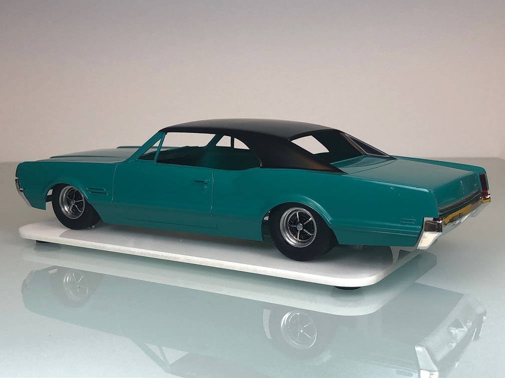

This year of Olds 442 was an odd duck. I may be wrong, but I can't think of anyone turning one of these into a slot car. If you got one, please show us.
These are the parts I bought for $5. Barely enough for a slot car. I have since located the tail lights at a flea market.
[attachment=31122]
I found a pic of a completed kit on Google that inspired me to paint it Tamiya Cobalt Green.
[attachment=31123]

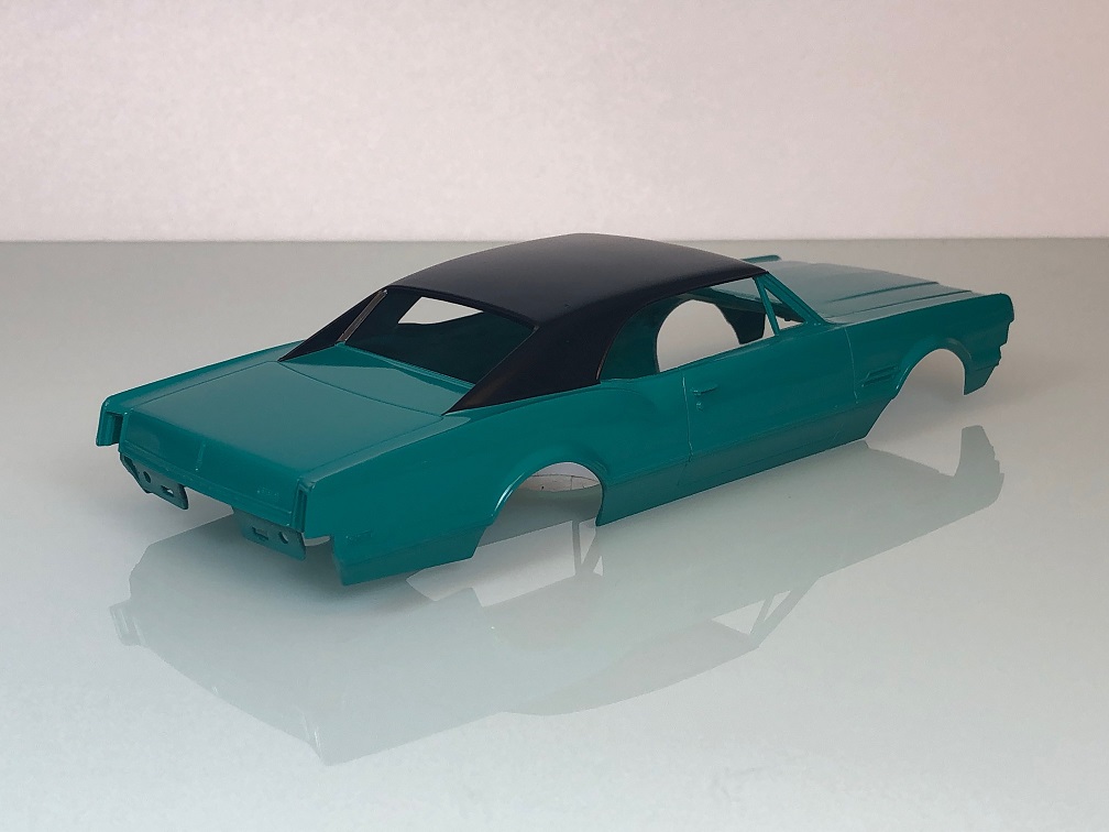

The body was painted, and a custom chassis was machined.
[attachment=31124]
The car fell on it's roof seconds after being painted. Luckily a vinyl roof was in the works anyways.
[attachment=31125]

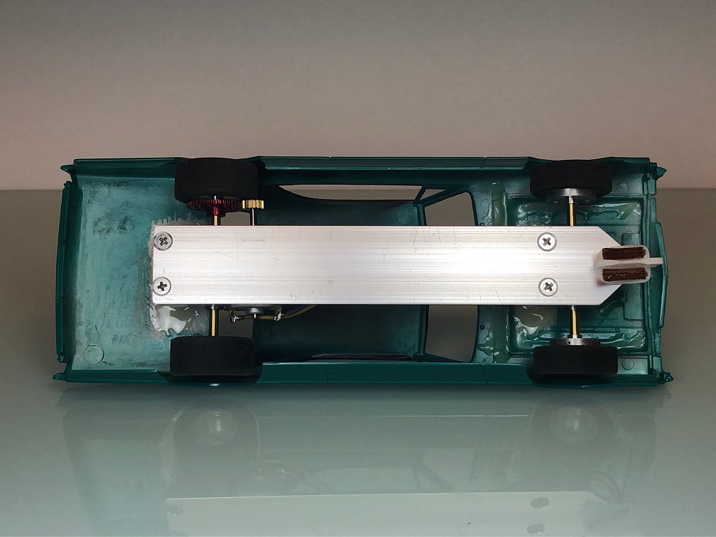

This is the part where I hold my breath. Mating the chassis to the body.
[attachment=31126]

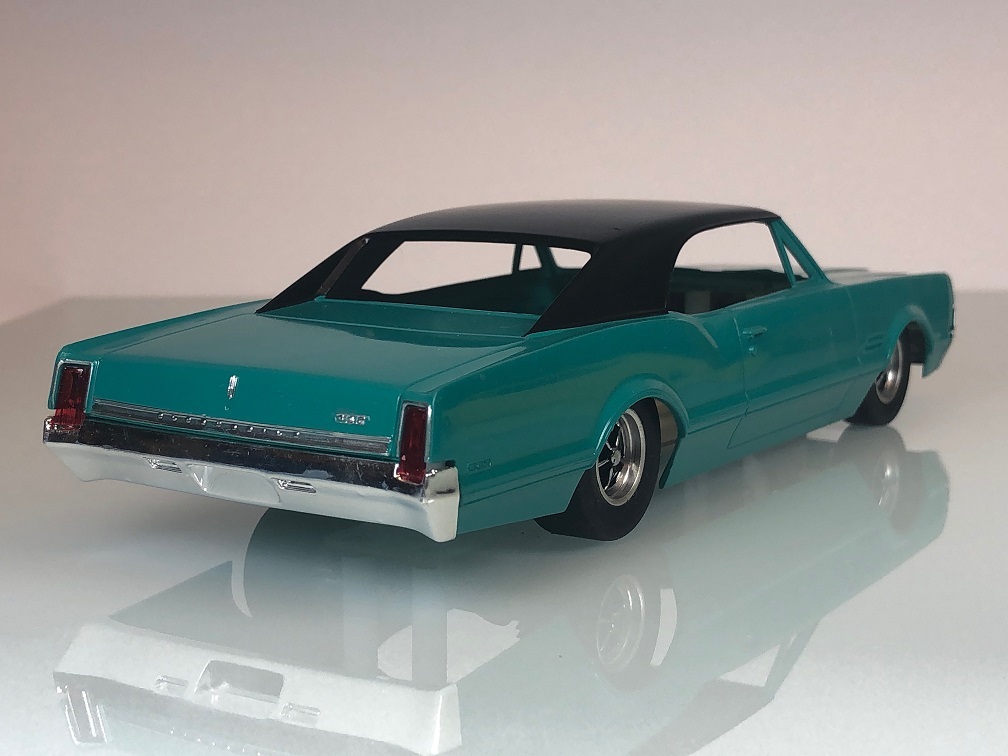

The car runs. It needs bumpers, chrome trim, windows, and interior.
[attachment=31127]
[attachment=31128]
More to follow. Thank you very kindly for looking.
Ken

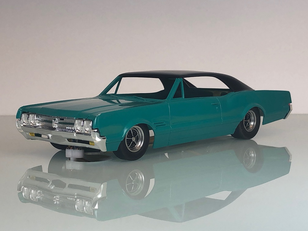

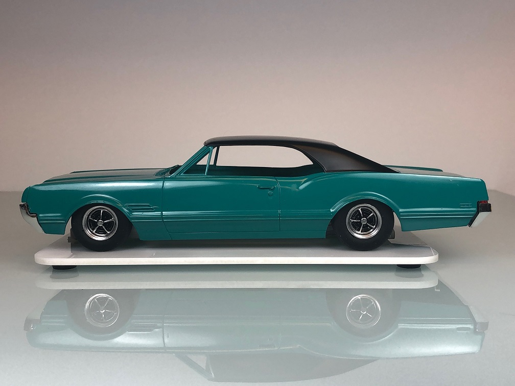

RE: 1966 Olds 442 W30 - KensRedZed - 27th-Jul-23
A little more progress. A ton of Molotow chrome penwork yet to come. Then the windows.
[attachment=31138]
[attachment=31139]
[attachment=31140]
[attachment=31141]

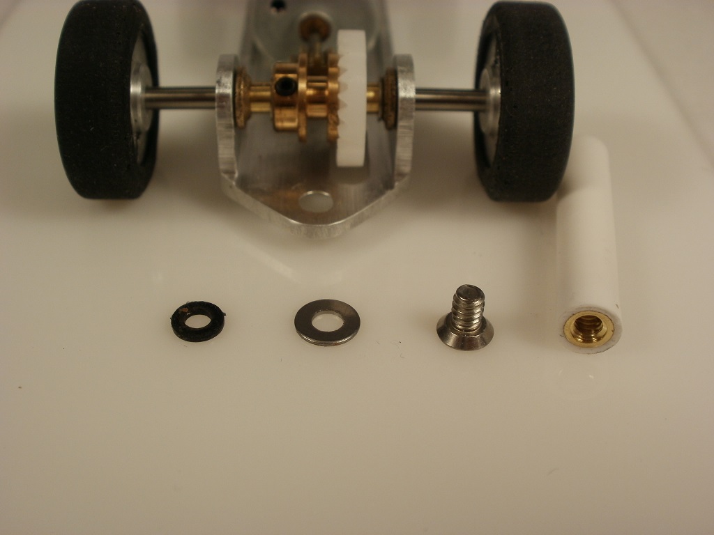

RE: 1966 Olds 442 W30 - Tibbs - 27th-Jul-23
Looks fantastic Ken, what do you use to fix the white spacers to the chassis?
Cheers Tony
Thank you very kindly, Tony.
5-minute epoxy is used to fix the #227 Evergreen styrene tubing to the body.
My apologies Tony. I read your post wrong.
I use 4-40 press-in brass inserts with #227 Evergreen styrene tubing.
[attachment=31145]
Link here.
https://www.professormotor.com/product-p/pmtr7013.htm
It's also available in bulk from here. A bit cheaper too. I buy them by the hundreds. I build too many cars.
Part # 628-575 on page C199.
https://spaenaur.com/media/ecatalog/C198/index.html
