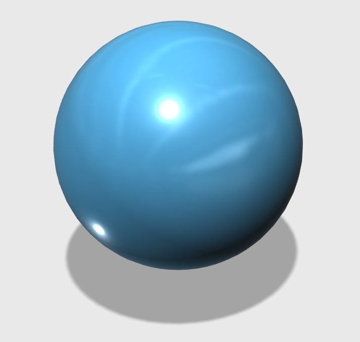

To explain, below is a ball or sphere 50mm diameter drawn on CAD.
[attachment=30655]

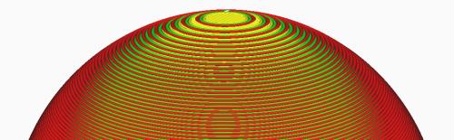

Take the CAD file to the printer ‘slicer’ software and it turns the sphere in to a collection of plates each plate is the layer thickness set.
[attachment=30656]

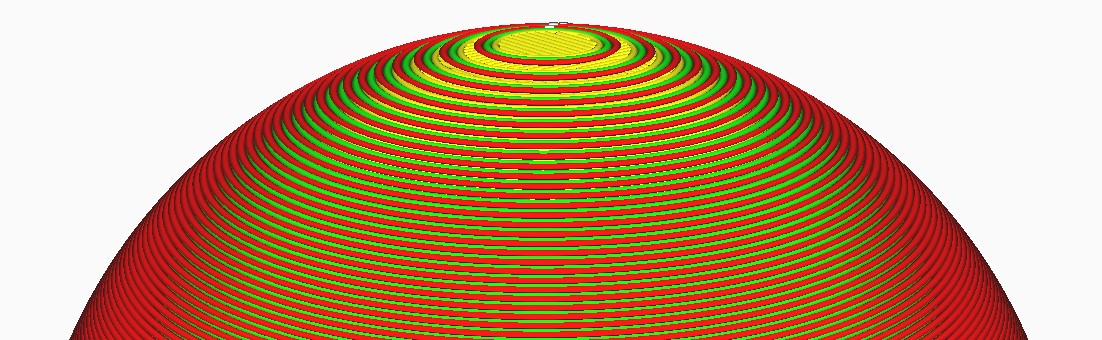

This is at 0.5mm layer to show the concept of the overlapping plates forming the sphere and the steps are quite apparent. In practice this would require aggressive post print sanding to smooth out these steps.

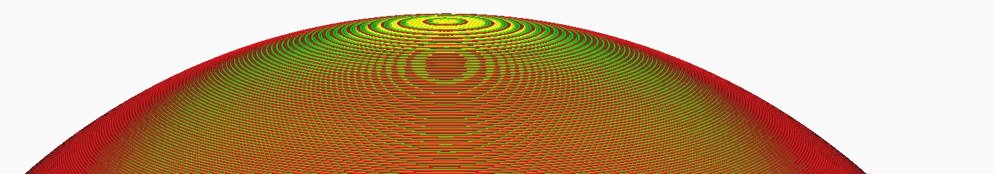

Same file now at 0.1mm layer (usually the best most FDM printers can achieve and the steps are much finer but still there so will still need some sanding.)
[attachment=30657]
Resin printers can offer much finer resolution i.e. 0.02mm and the steps at this setting are now indistinct in the overall curve.

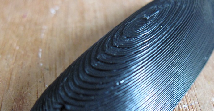

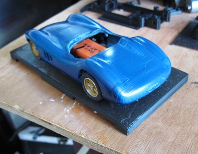

Now for some real world testing on a FDM printer (Creality CR Mini). Taking the rear quarter of the Aston DBR1 that I sectioned for vertical printing, this part has curves in 3 planes so an ideal real world test piece as only 14 minutes to print at 0.24mm layer.
[attachment=30659]
1st up 0.24mm layer
[attachment=30658]
Steps clearly visible

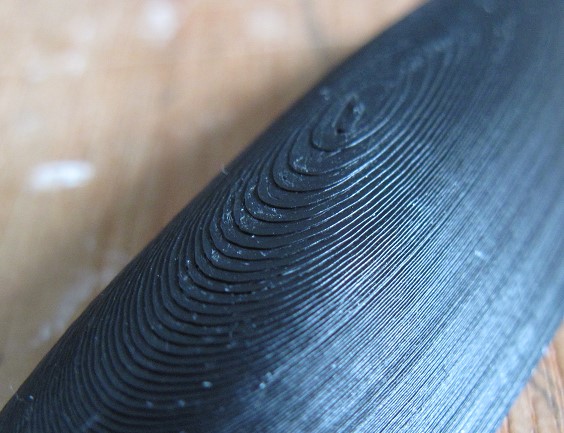

0.1mm layer
[attachment=30661]
0.1mm is the stated limit of many FDM printers including the CR 10 Mini.

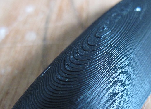

[attachment=30662]
Most printers can go to 0.08mm which gives a good result, some can go down to a stated 0.05mm.

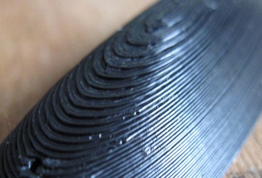

0.04mm layer
[attachment=30663]

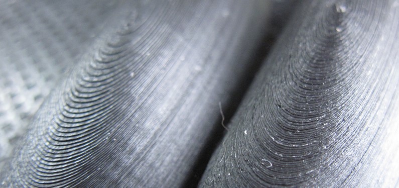

0.08 & 0.04mm, side by side
This shows the printer did achieve a better resolution than 0.08mm (and better than the stated minimum of 0.1mm) by how much I can’t measure but overall it does look better than 0.08mm layer height.
The 0.04mm setting was achieved using the standard 1.8 degree stepper motors that came with the CR10 Mini. I dialled this setting into Cura crossed fingers and watched as it printed. Why try down to 0.04mm?, this came from a comment attached to a recent printer review where the new printer has 0.9 degree stepper motors on all 3 axis including Z or layer control. In theory these stepper motors should be capable of finer and more consistent resolution than the 1.8 motors. In the comments below the review, one of the comments stated that 0.04mm can be achieved using the 1.8 degree stepper motors in older printers.

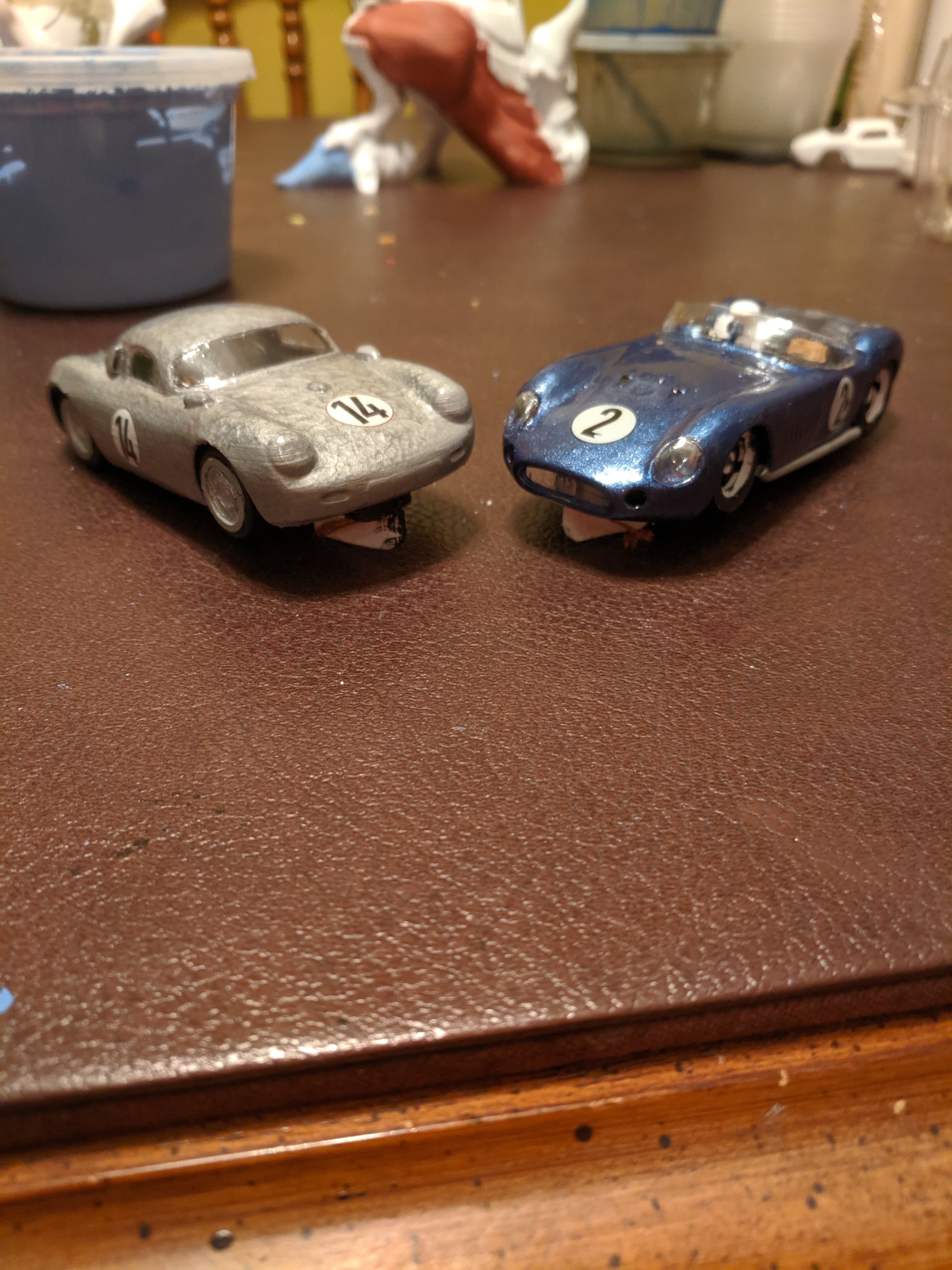

This is why I have always run bodies at 0.06 layer height (exactly half a step between).  The Ender3 is plenty capable of running at 0.04 but the already lengthy print time is extended another 50% so I don't do it.   I don't sand for hours, it isn't required at those layer heights.
Note that the resolution / quality of the file makes a significant difference in finished body quality as well.  A low-poly body will still look blocky even printed in resin.
[attachment=30667]
