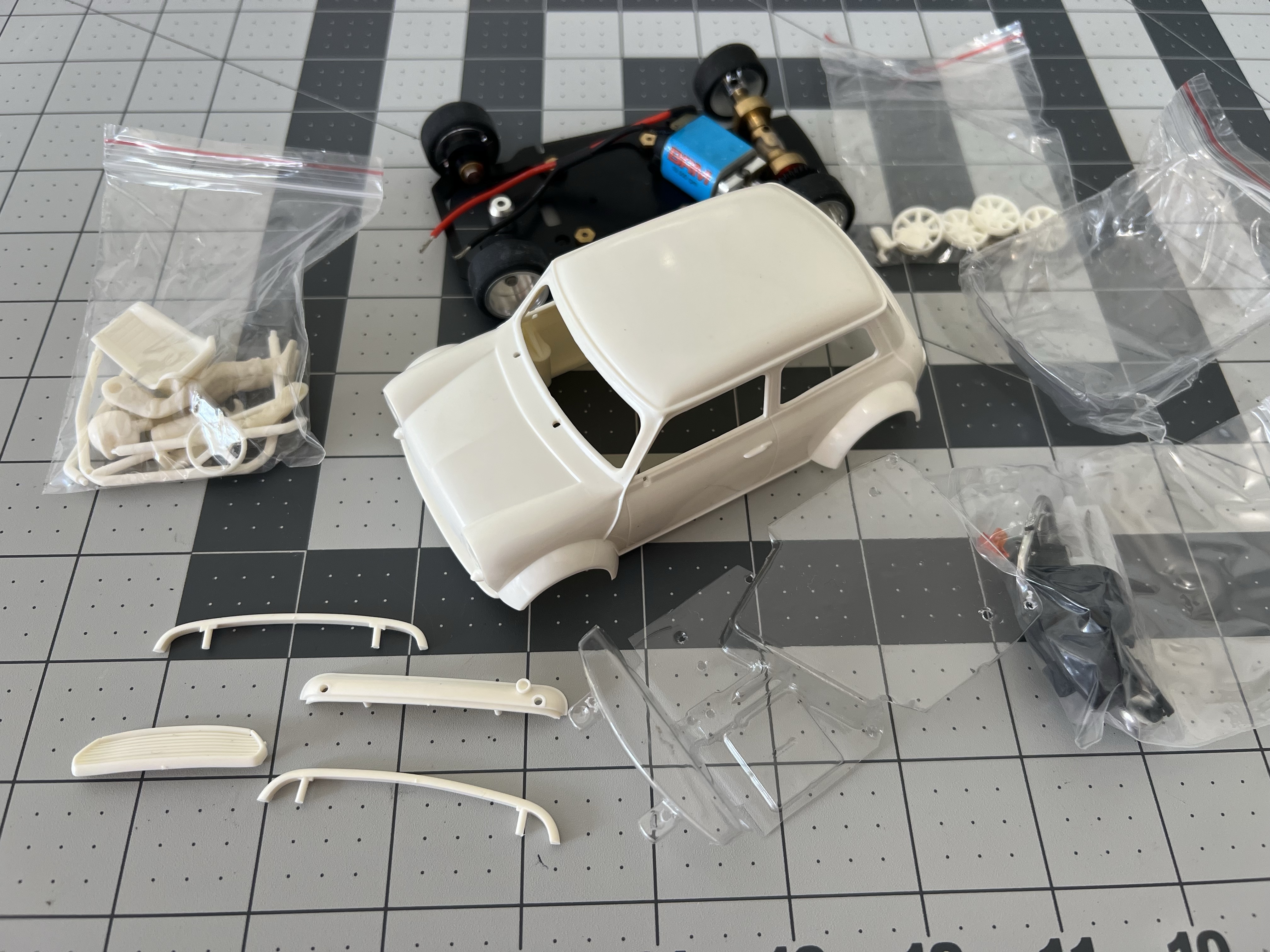

I started this build thread because I think these cars are run often and they're pretty popular. Here's the kit in its purest form, right out of the box.

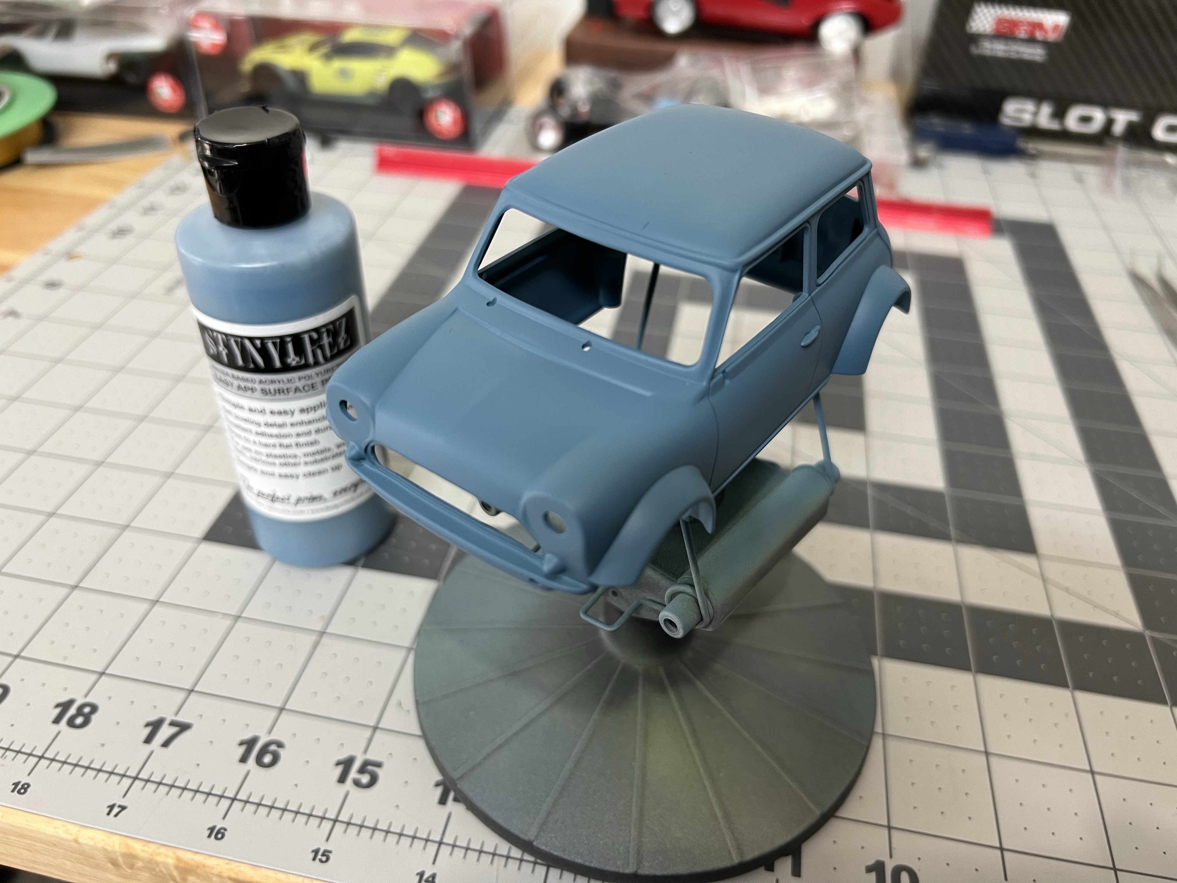

I've since cleaned up the flashing all around the car. I also hollowed out the grill and rear tail light locations. I still have to bore out the front locations because lights will get installed in front and rear. I first applied an 800 coat of MrHobby gray primer, then sanded until I was almost back to plastic. Then I used this Stynylrez primer and gave it two coats. Here's how it looks.
[attachment=30298]
I'll let this dry for a day and then sand it smooth with 1000. I'll then give it a first coat of color.

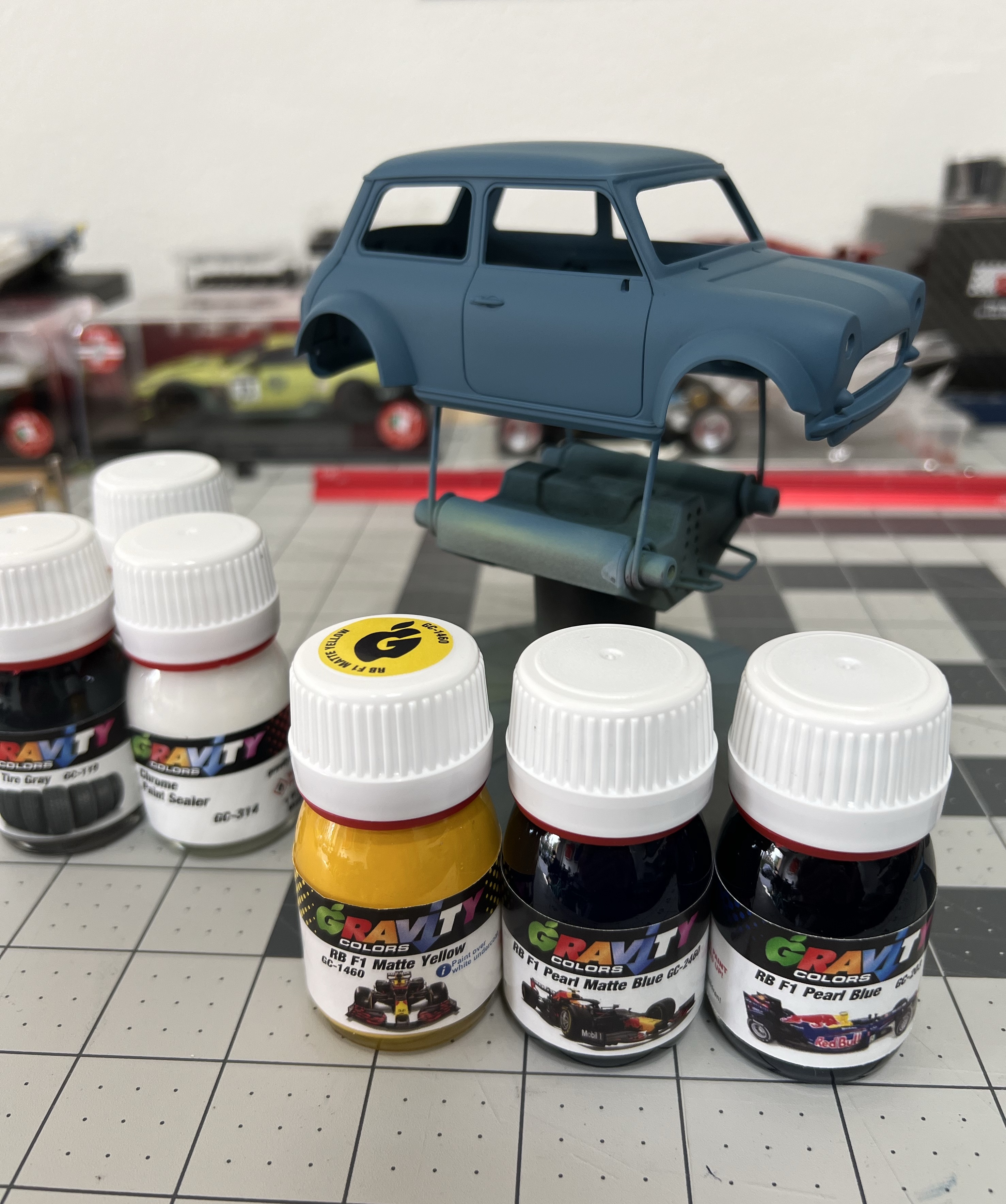

RE: BRM Mini Cooper White Kit build - DPJ - 27th-May-23
Paint arrived... now to paint it...!

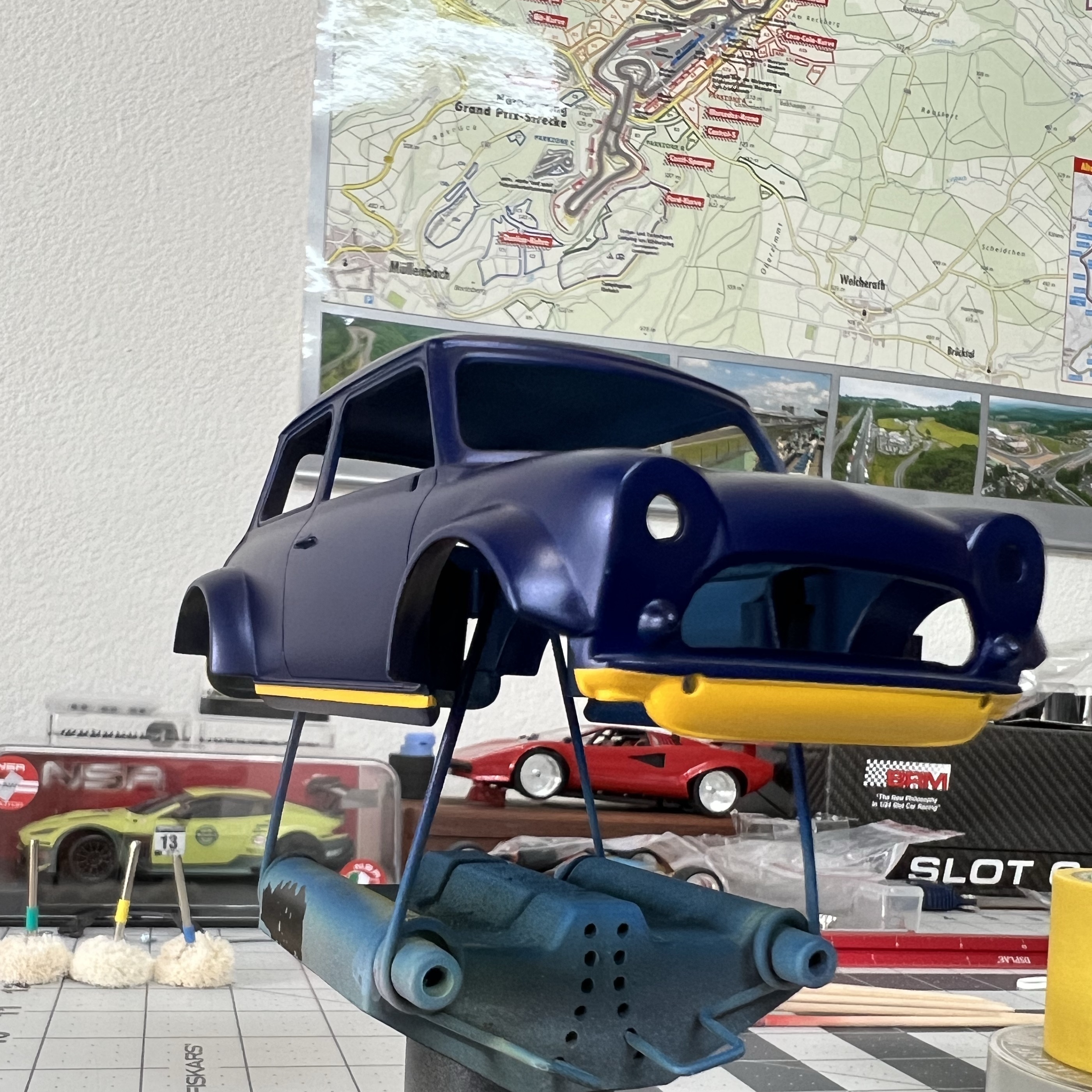

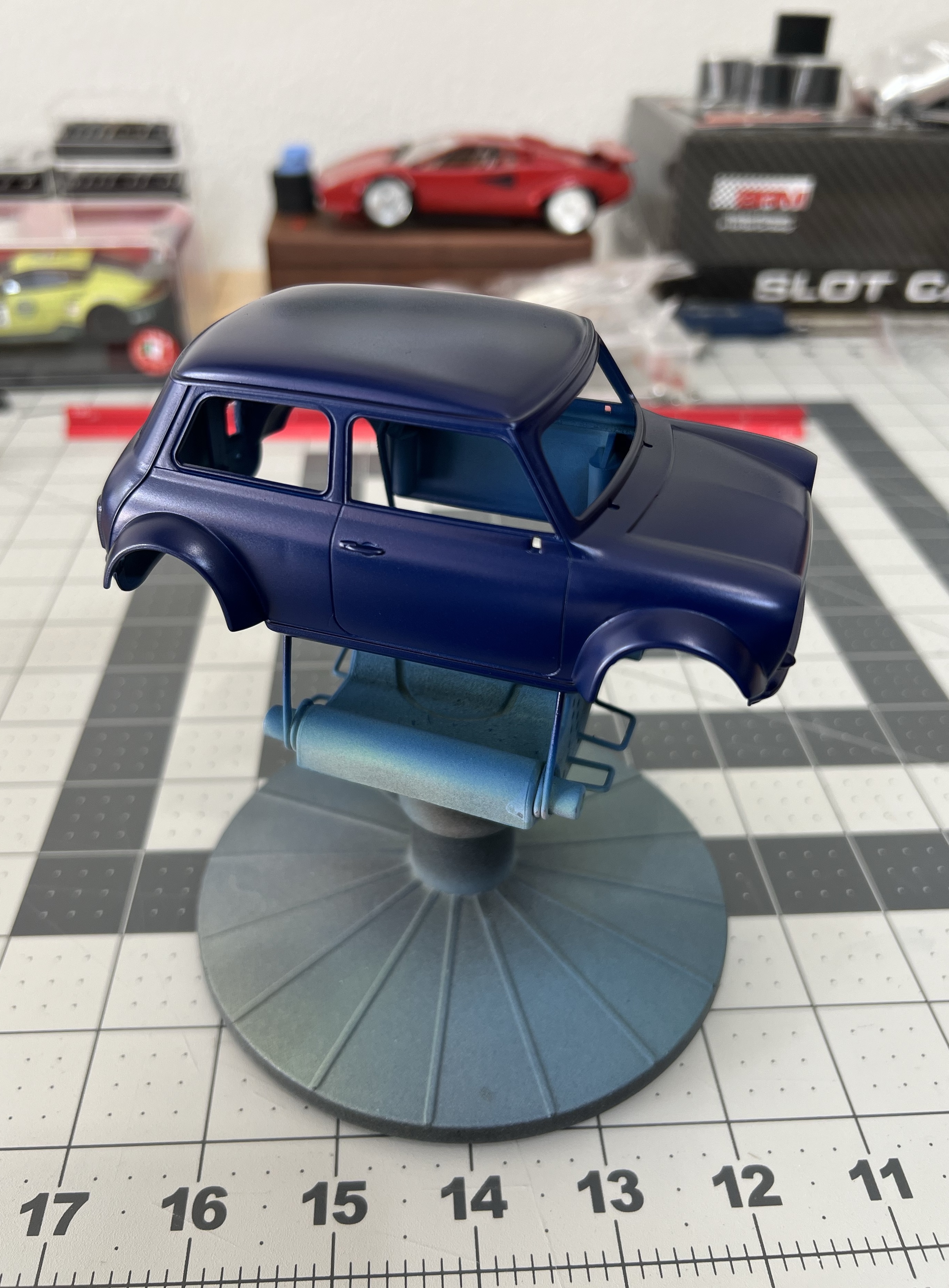

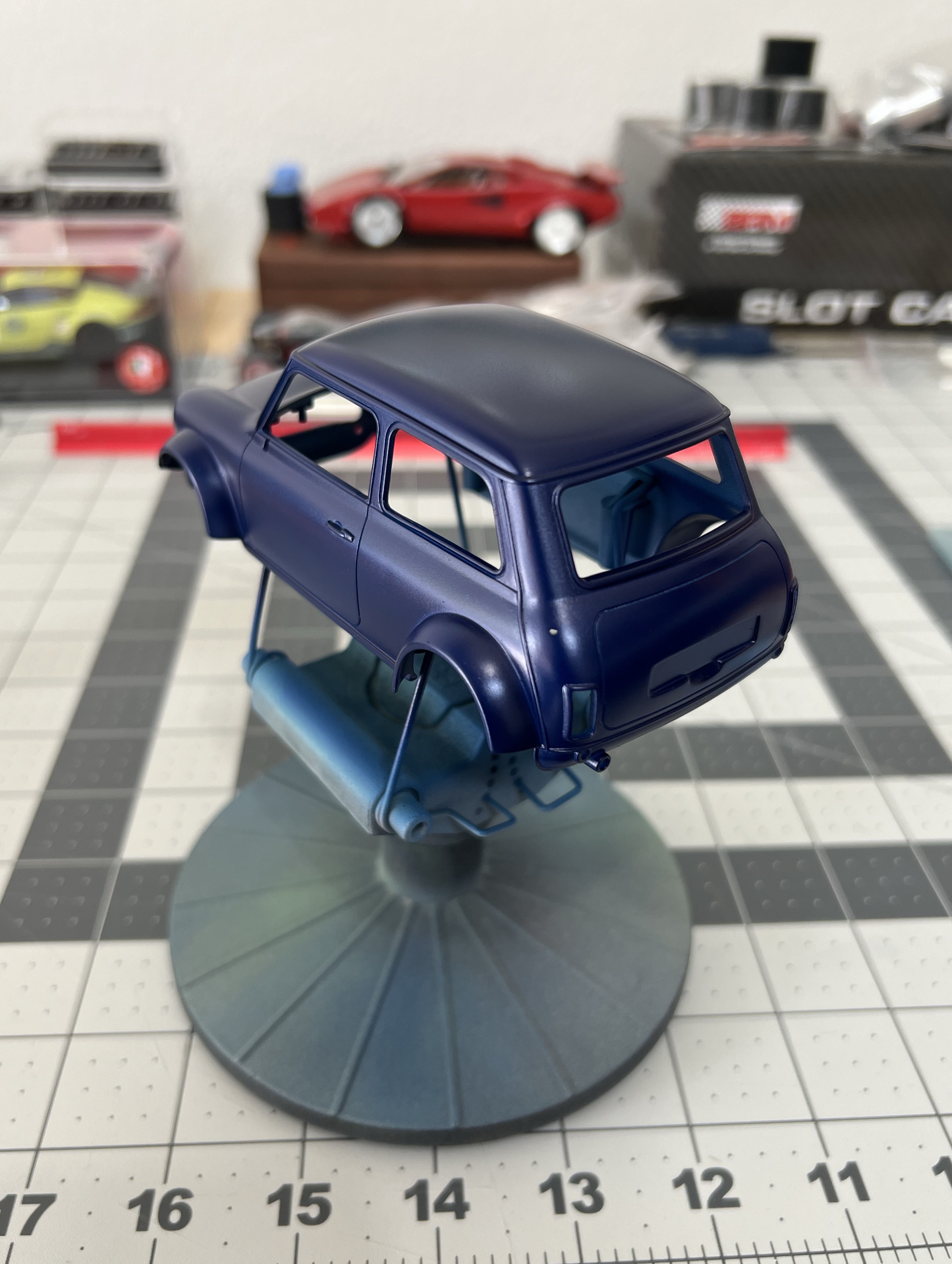

Paint is on, now the fun begins!
[attachment=30429][attachment=30430][attachment=30428]

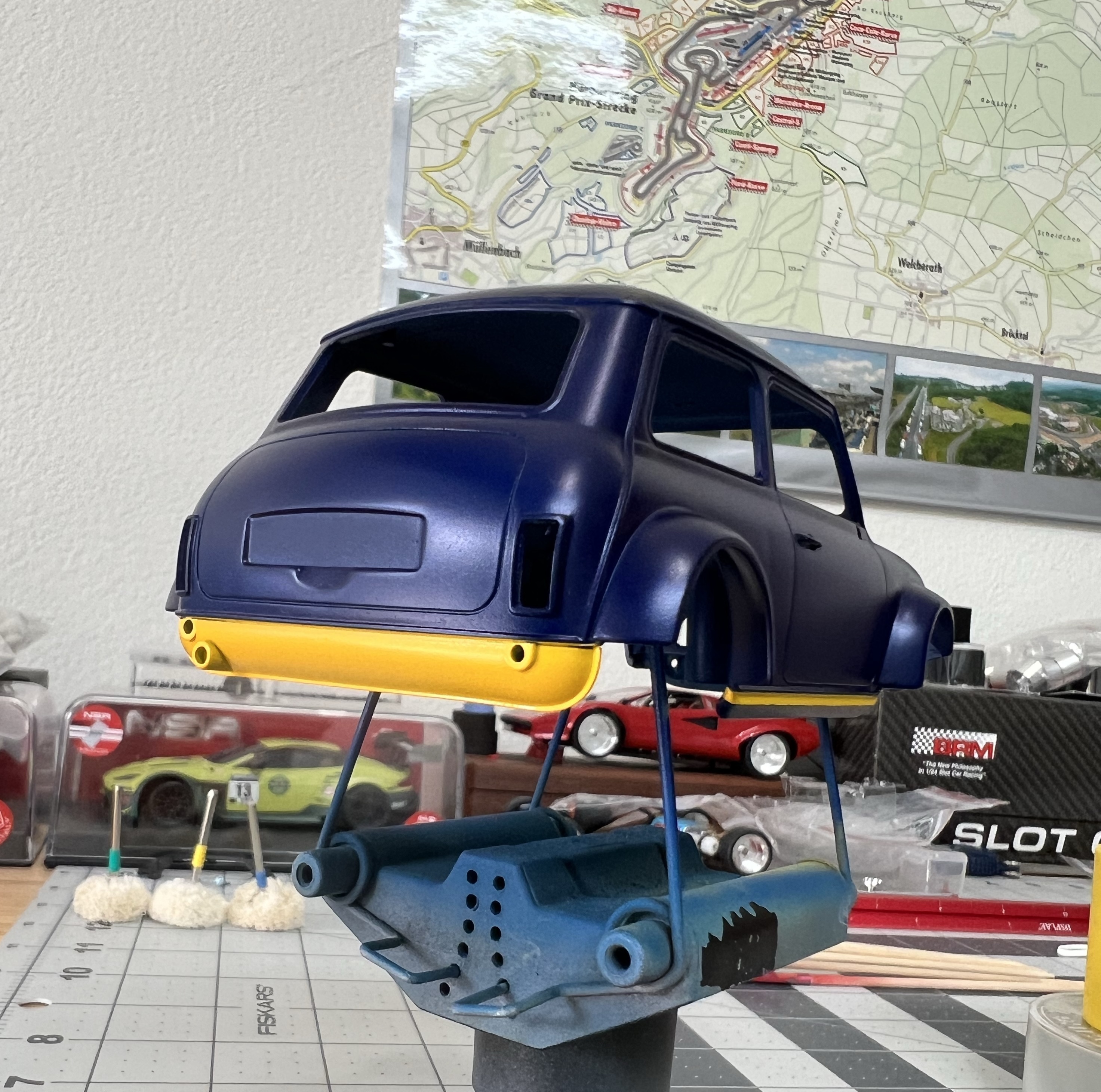

RE: BRM Mini Cooper White Kit build - DPJ - 29th-May-23
[attachment=30439][attachment=30438]

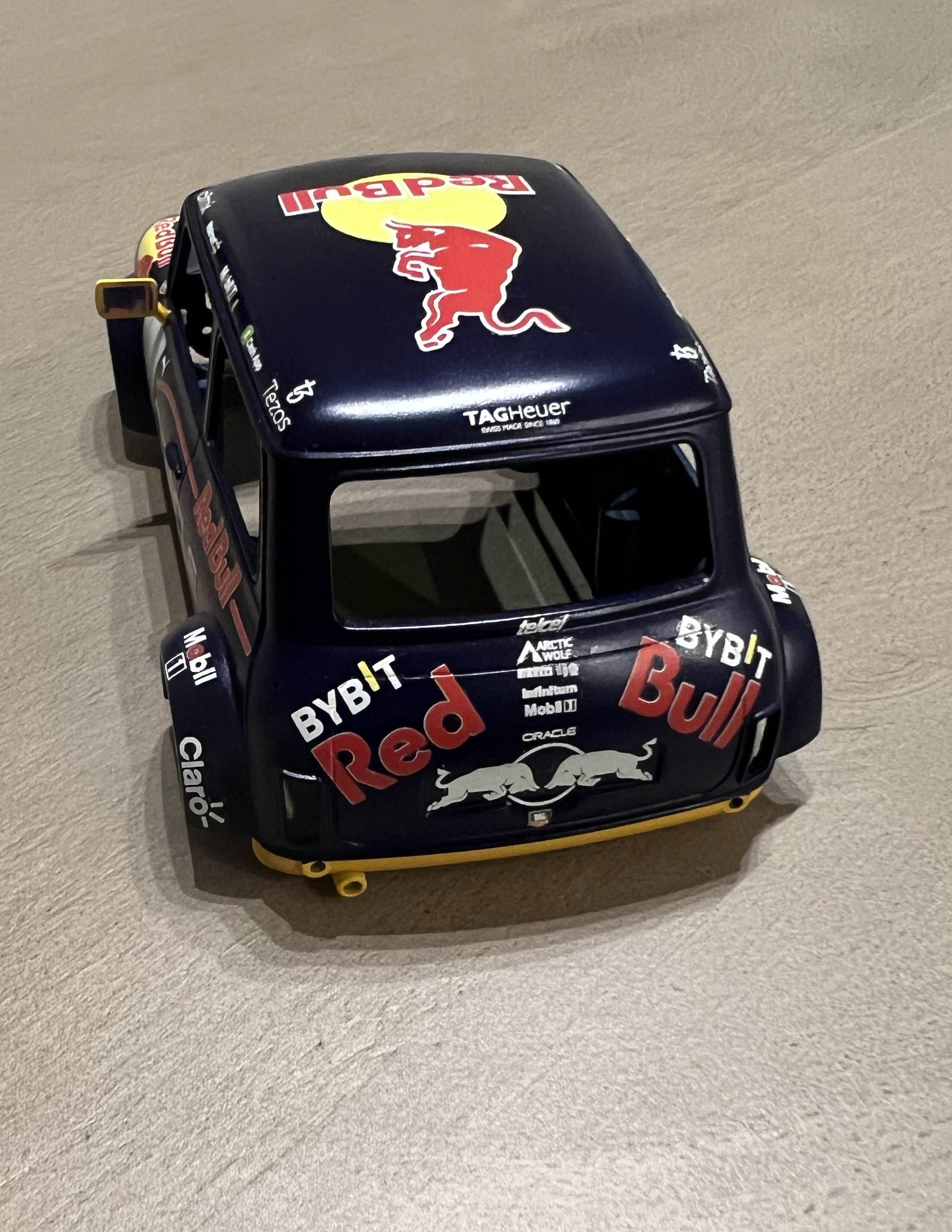

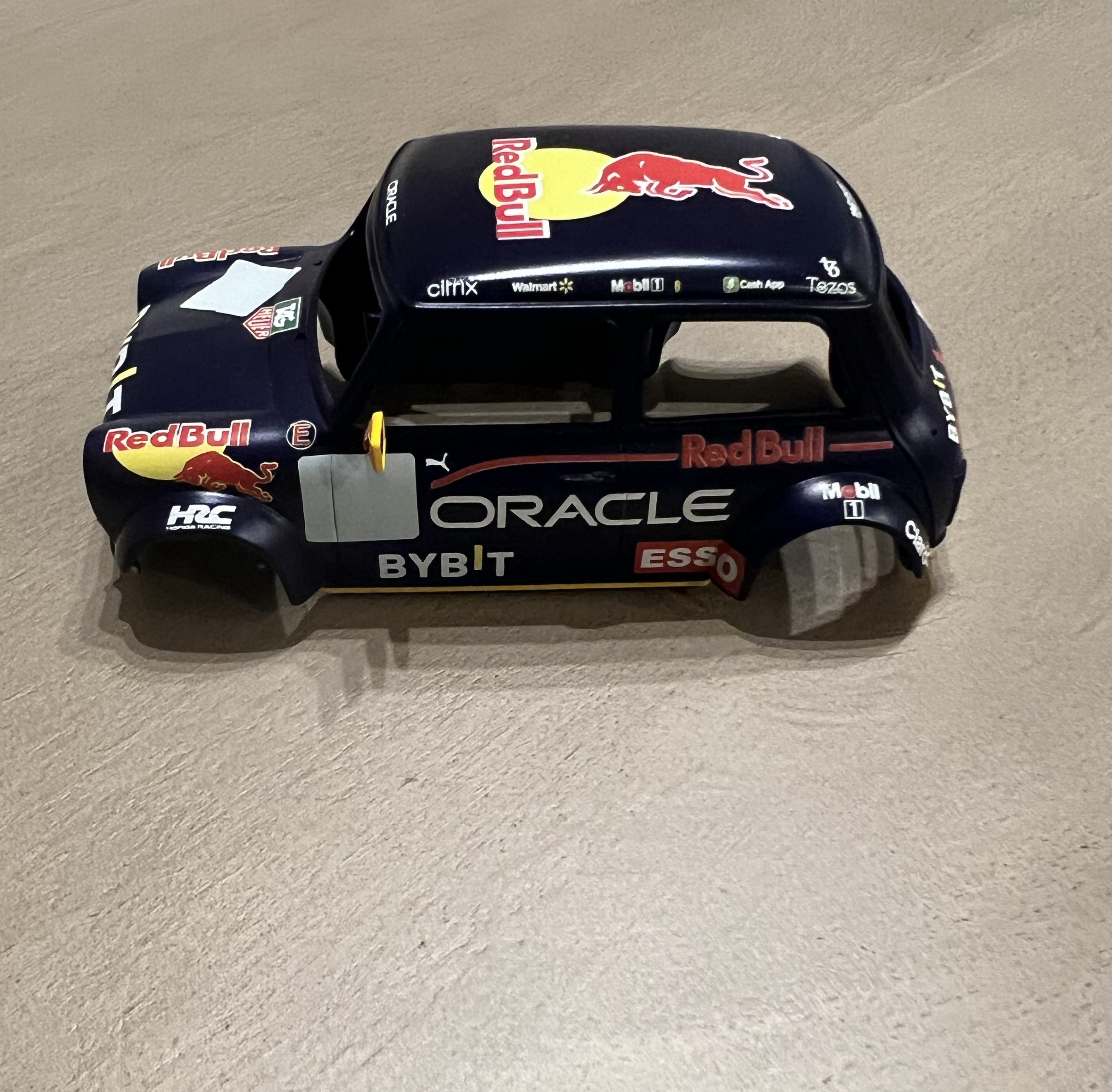

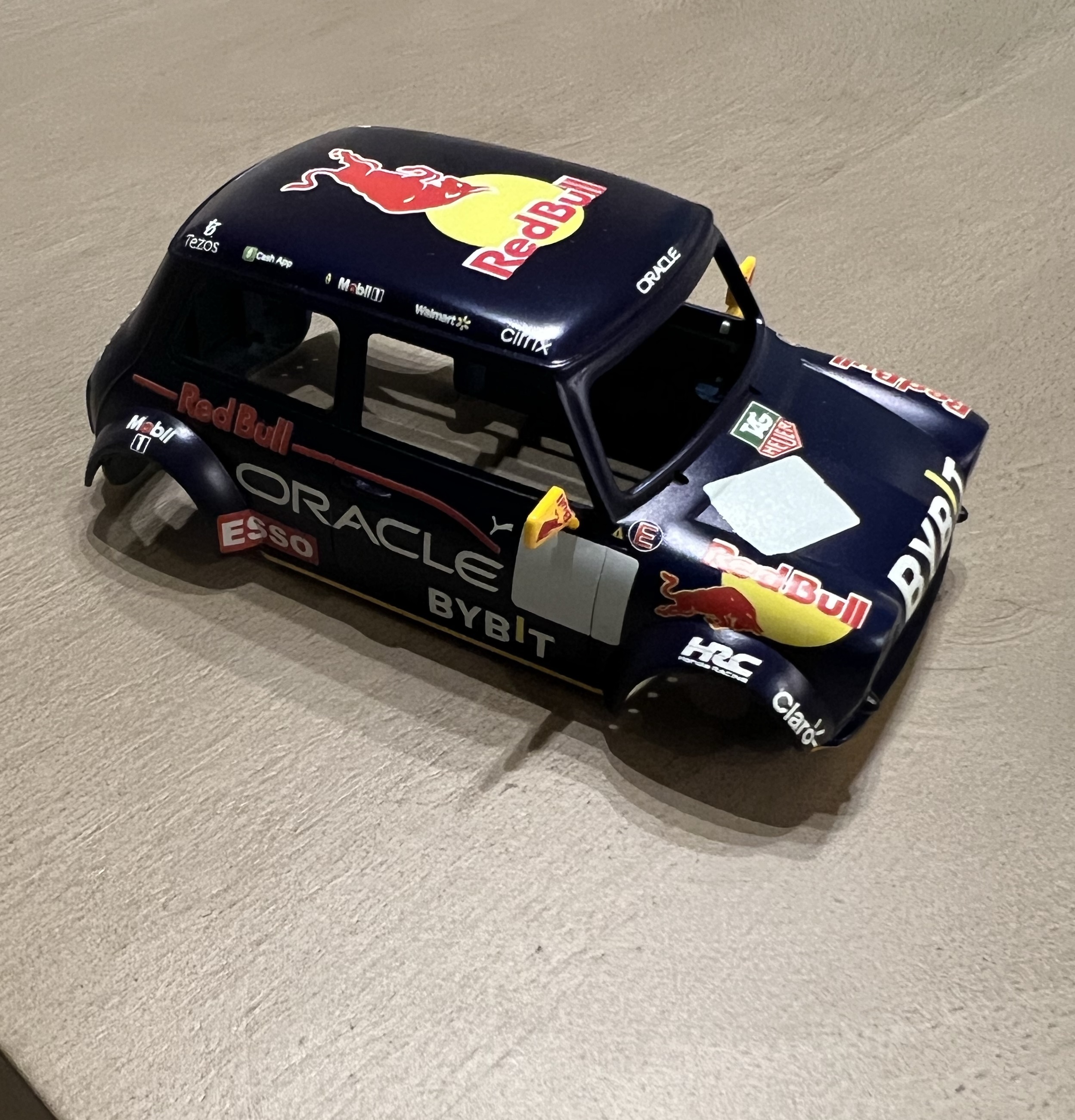

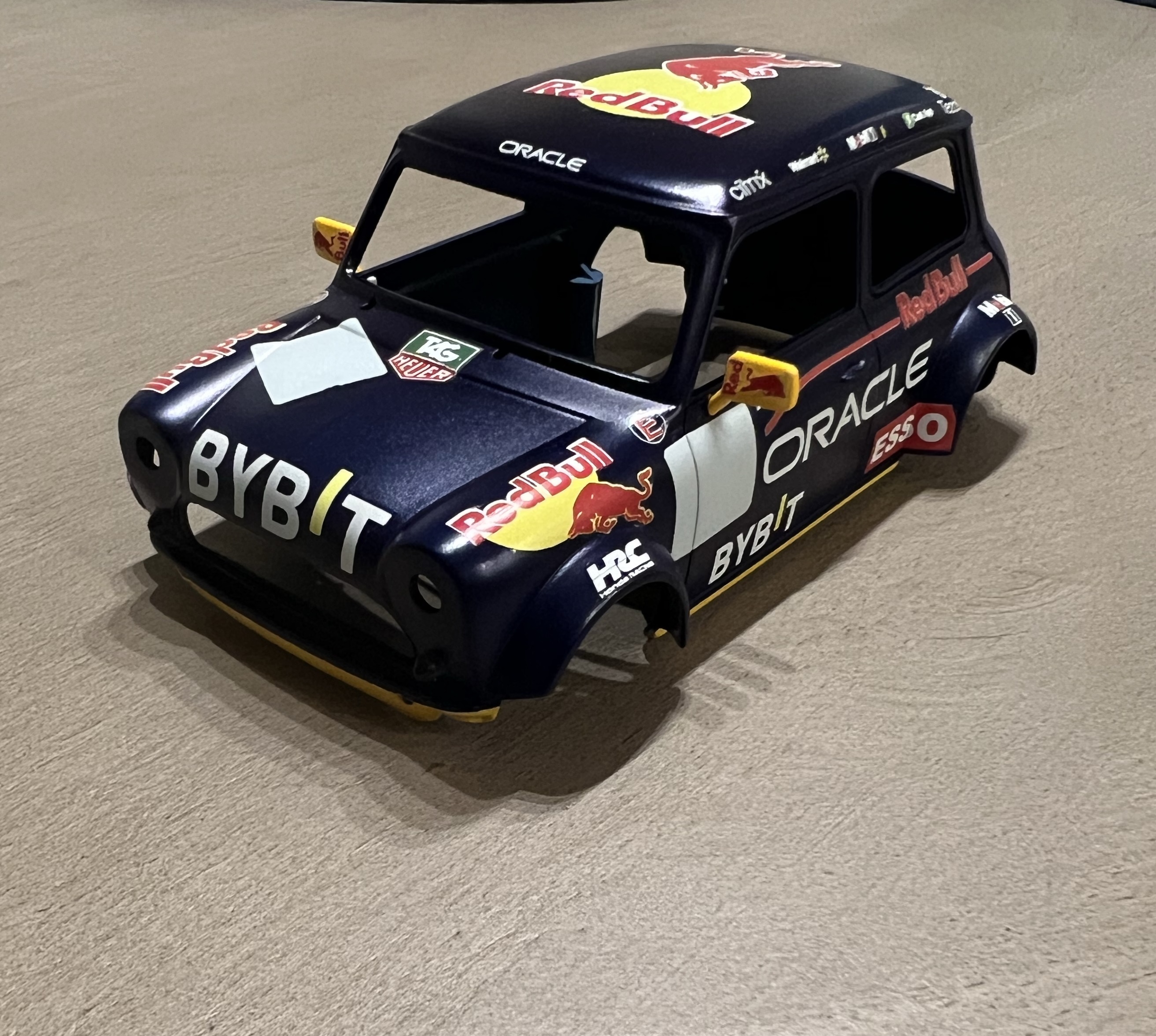

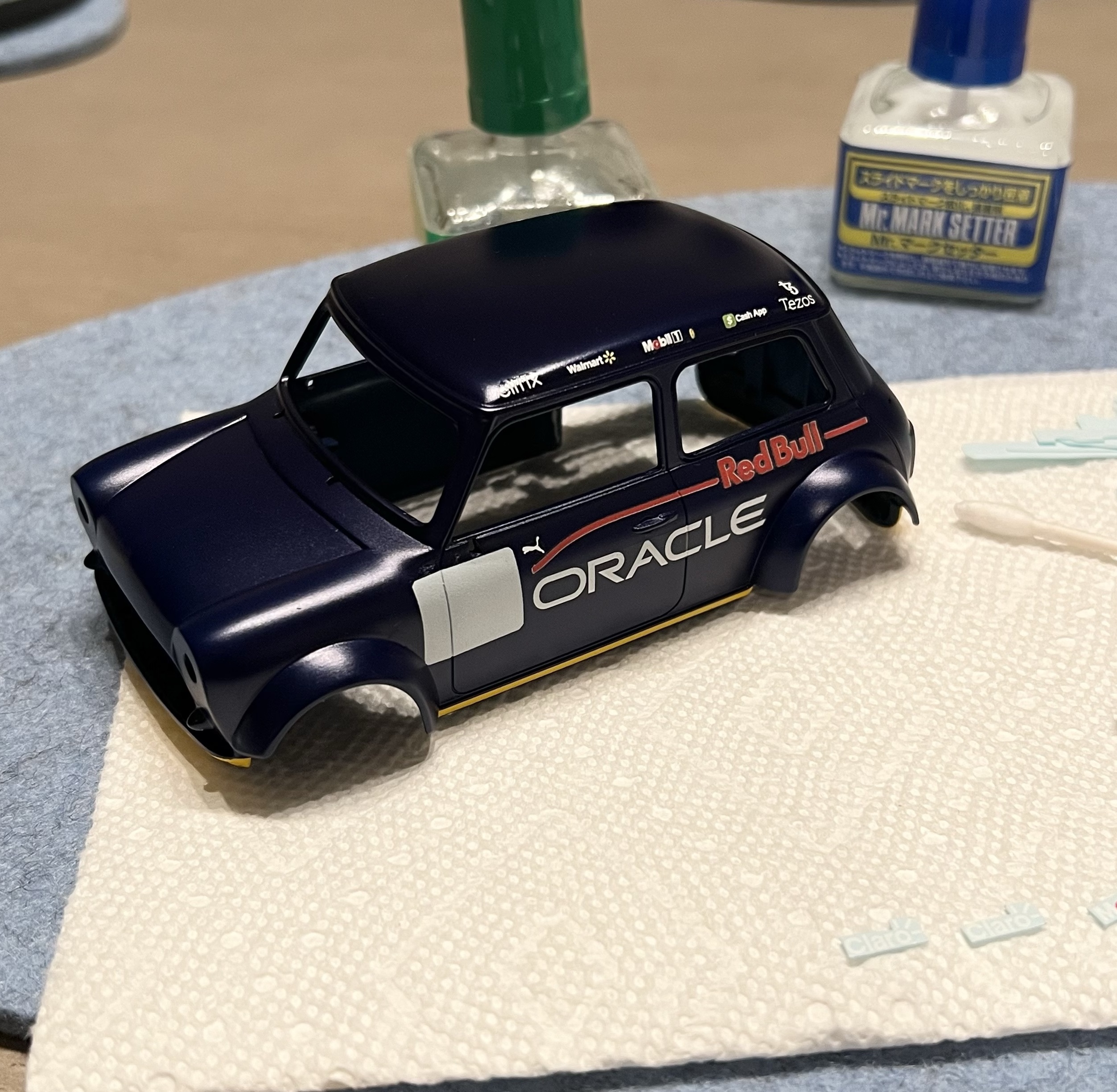

Here are the completed decals...
[attachment=30518][attachment=30517][attachment=30516][attachment=30515][attachment=30514]

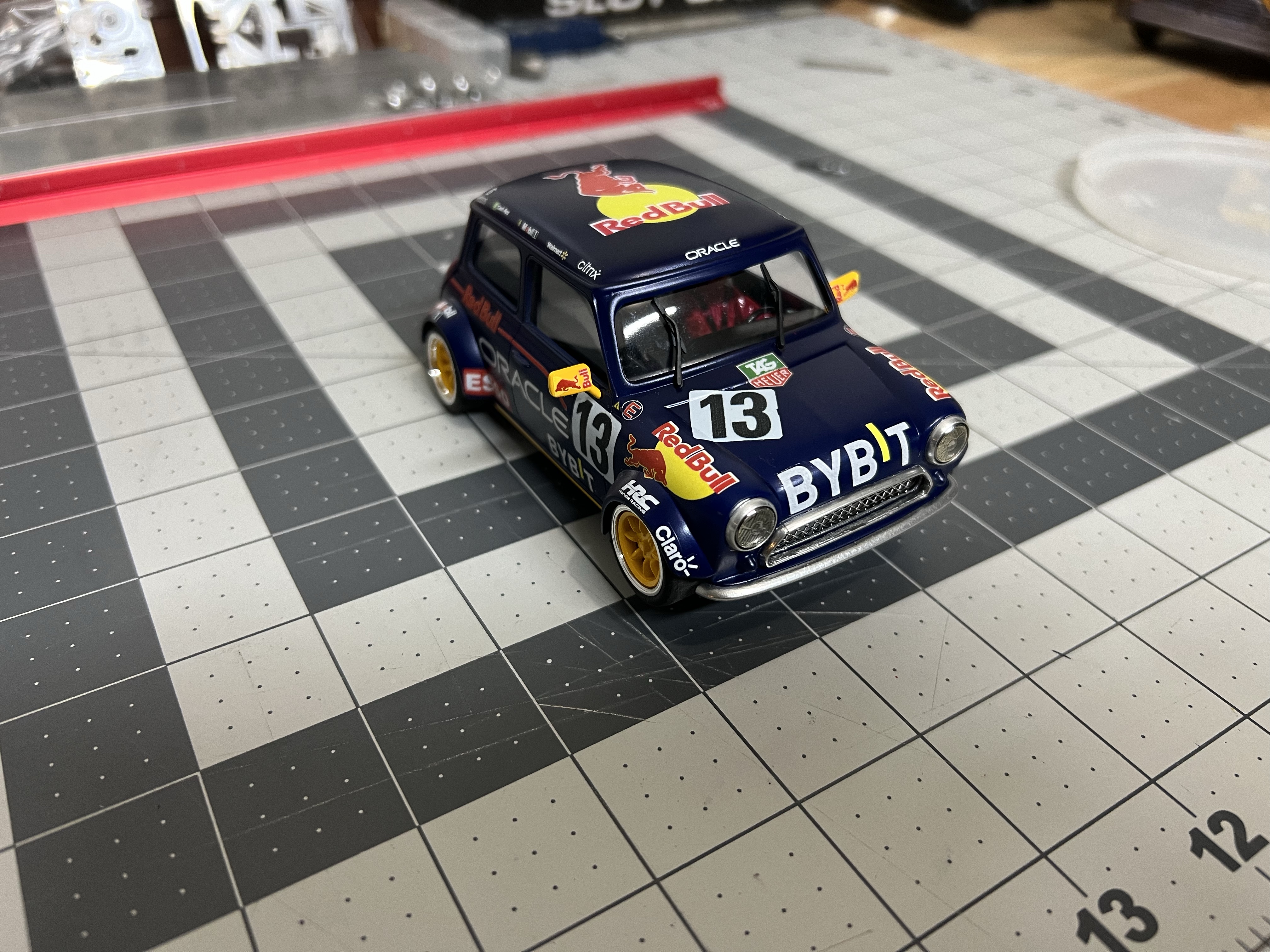

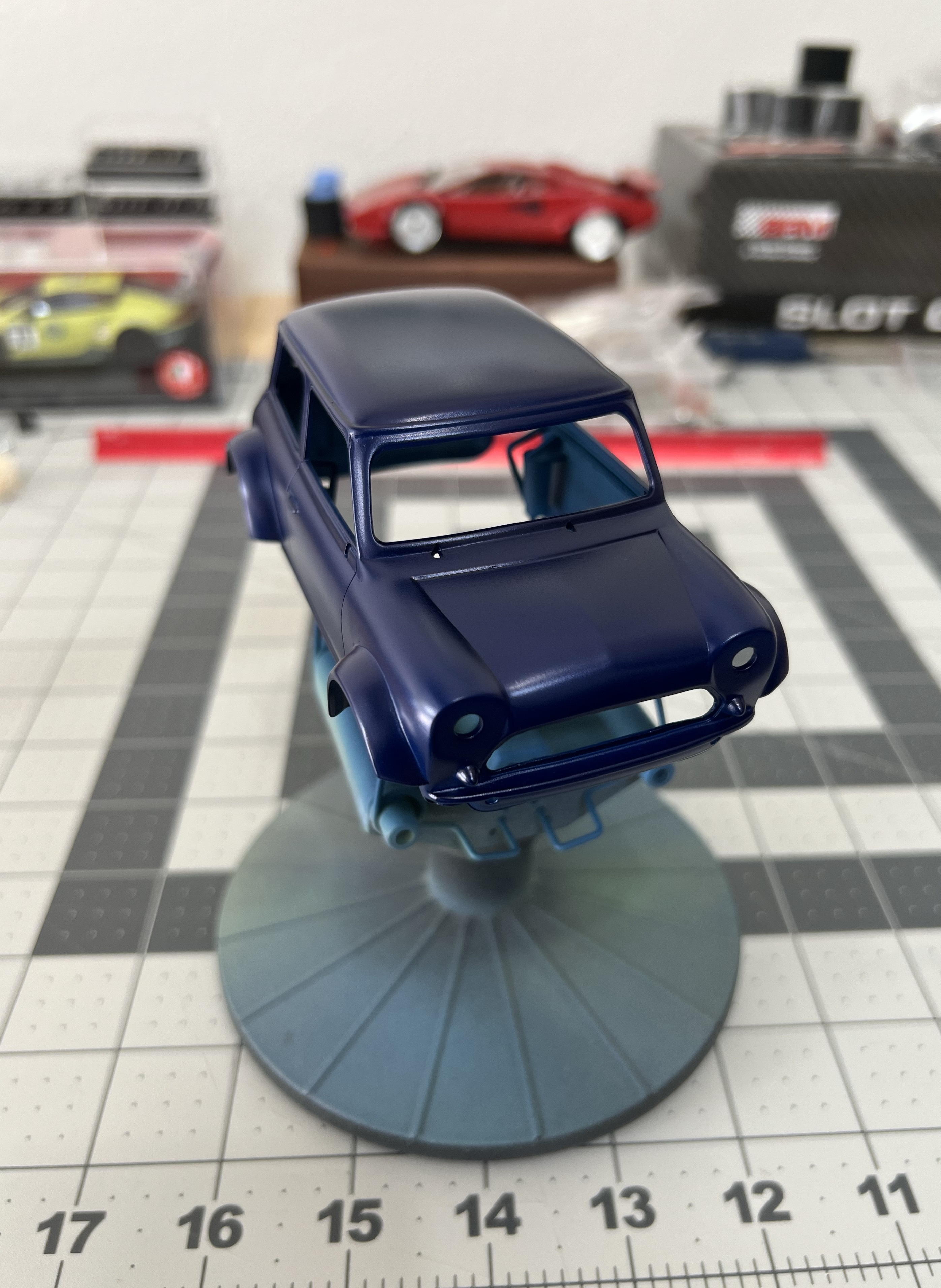

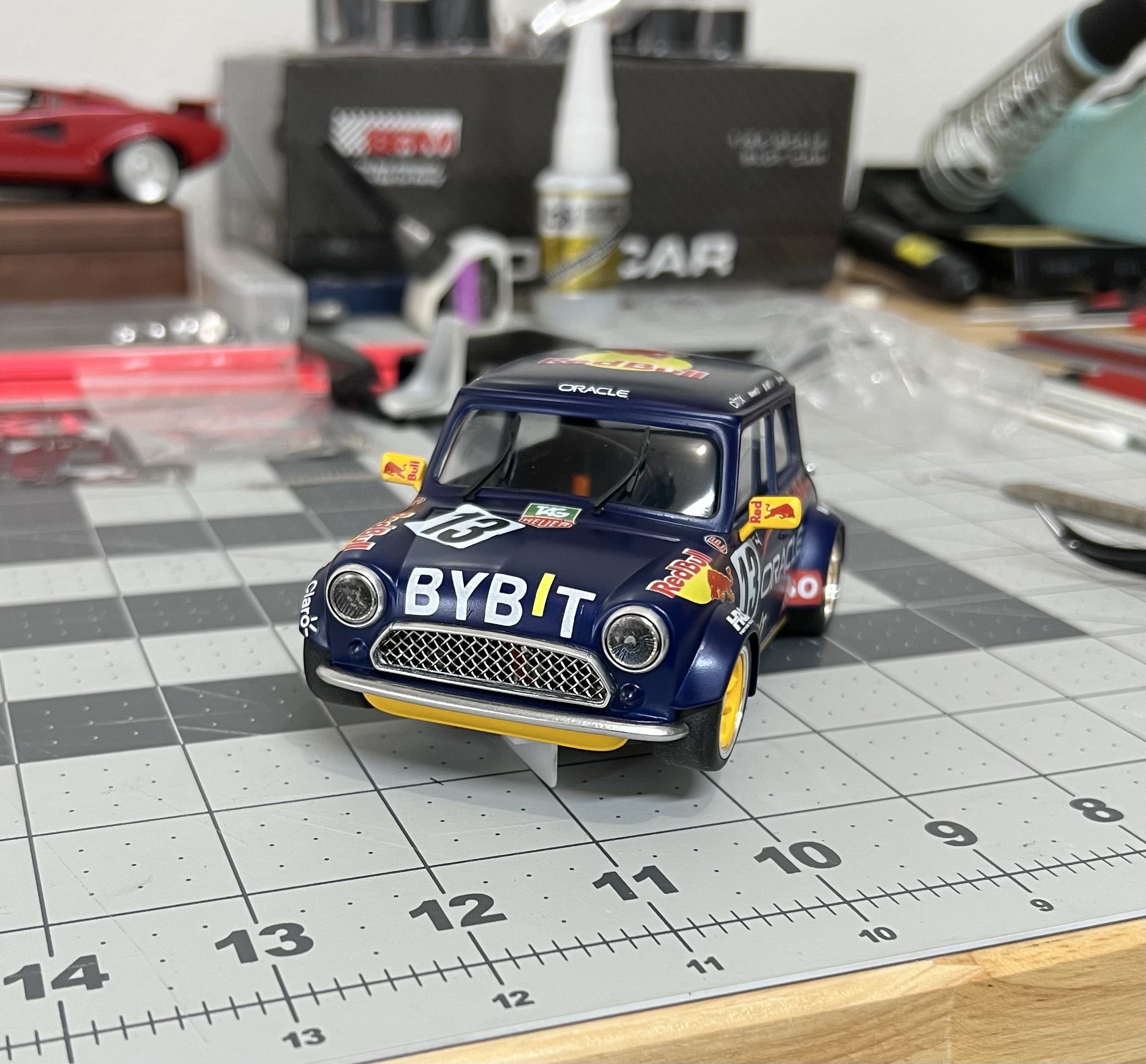

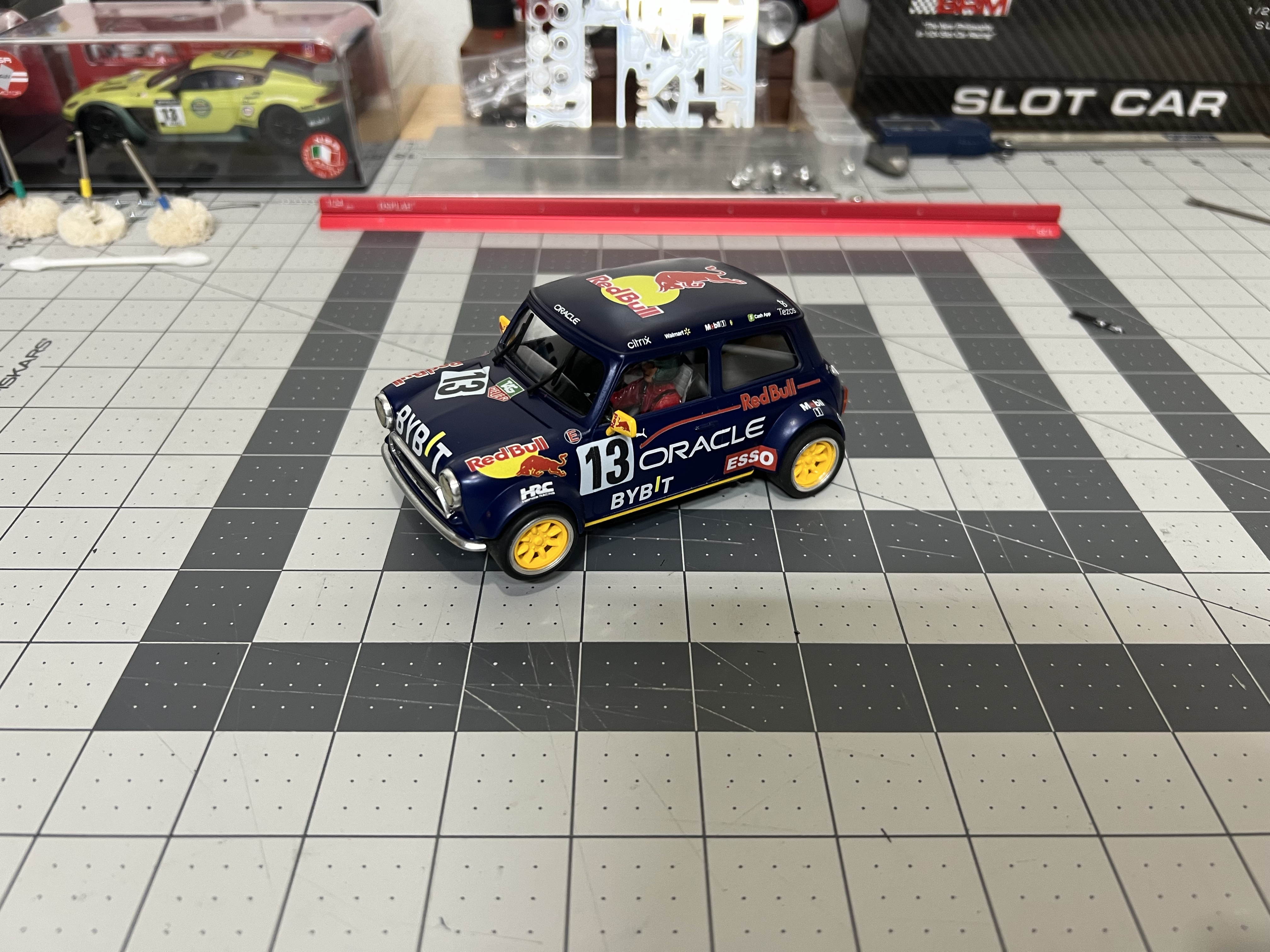

RE: BRM Mini Cooper White Kit build - DPJ - 11th-May-25

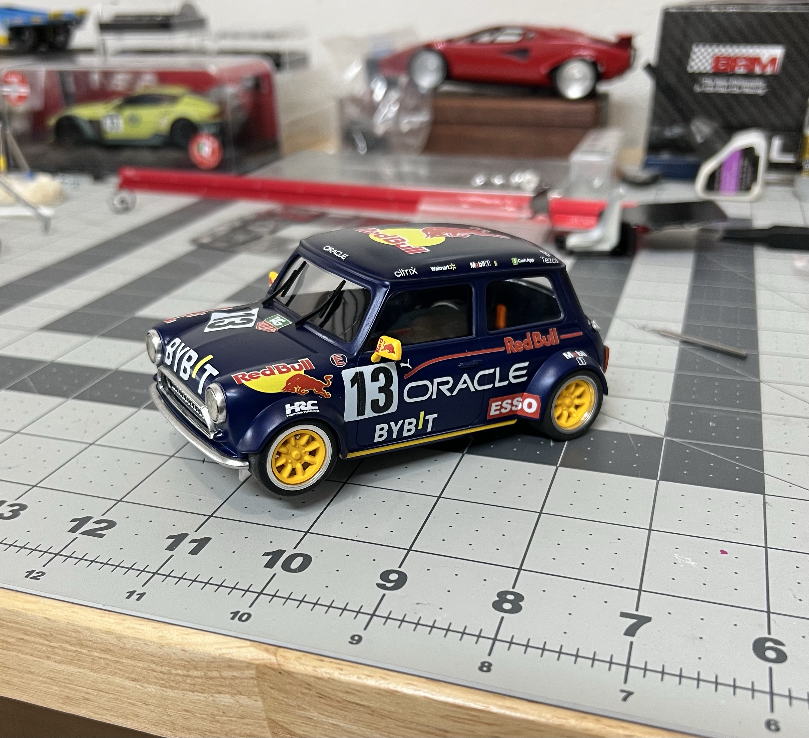

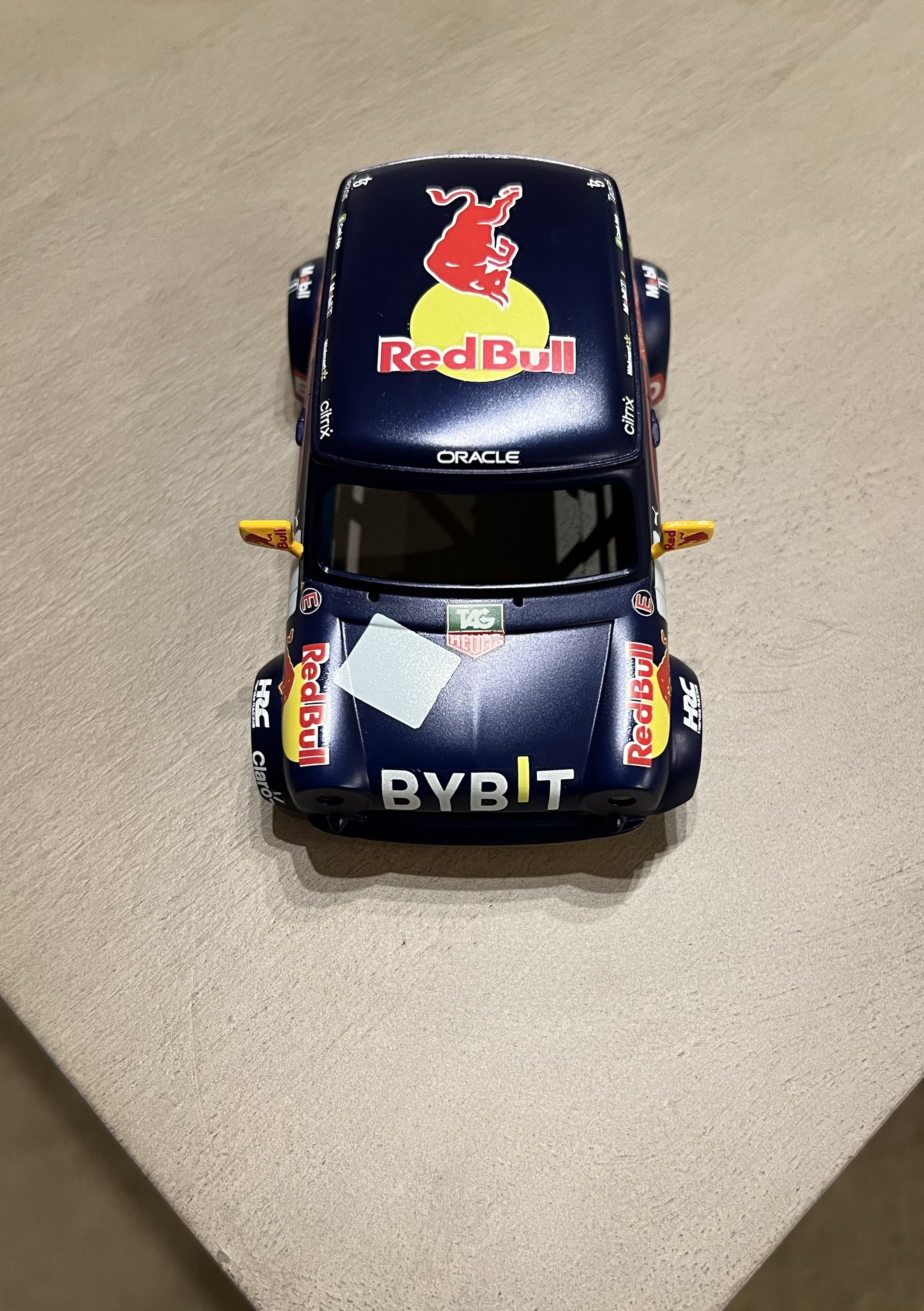

Paint and decals have been finished for some time, here it is...
[attachment=40842][attachment=40844][attachment=40843][attachment=40845]
Now I have the front and rear lights to install, then it'll be complete!
RE: BRM Mini Cooper White Kit build - Top Down - 11th-May-25
Looks great!
RE: BRM Mini Cooper White Kit build - Kevan - 11th-May-25
I concur
RE: BRM Mini Cooper White Kit build - KensRedZed - 12th-May-25
Beautiful!  Checkeredflag
