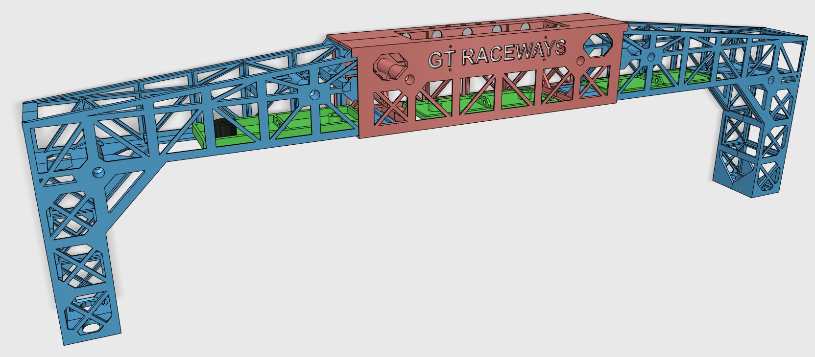

Below is the design for a 3dp replacement light gantry for the GT Raceways track.

The new gantry has been printed in 9 sections (6 for the gantry plus 3 twin IR transmitter trays) and spans 640mm of the GT Raceways 6 lane Ninco track plus borders. The design is telescopic with around 40mm of adjustment to get the span correct. The IR transmitters leds are are ganged in pairs in each tray (shown in green) at the exact lane width of the Ninco track, and are designed to be slid along the gantry to align with the track sensors. The sections will bolt together to sandwich the centre section and then be screwed to the track board.
The design draws inspiration more from Brunel rather than any particular real life gantry and is all about making it strong enough to sit still and not wave around over the track sensors.
