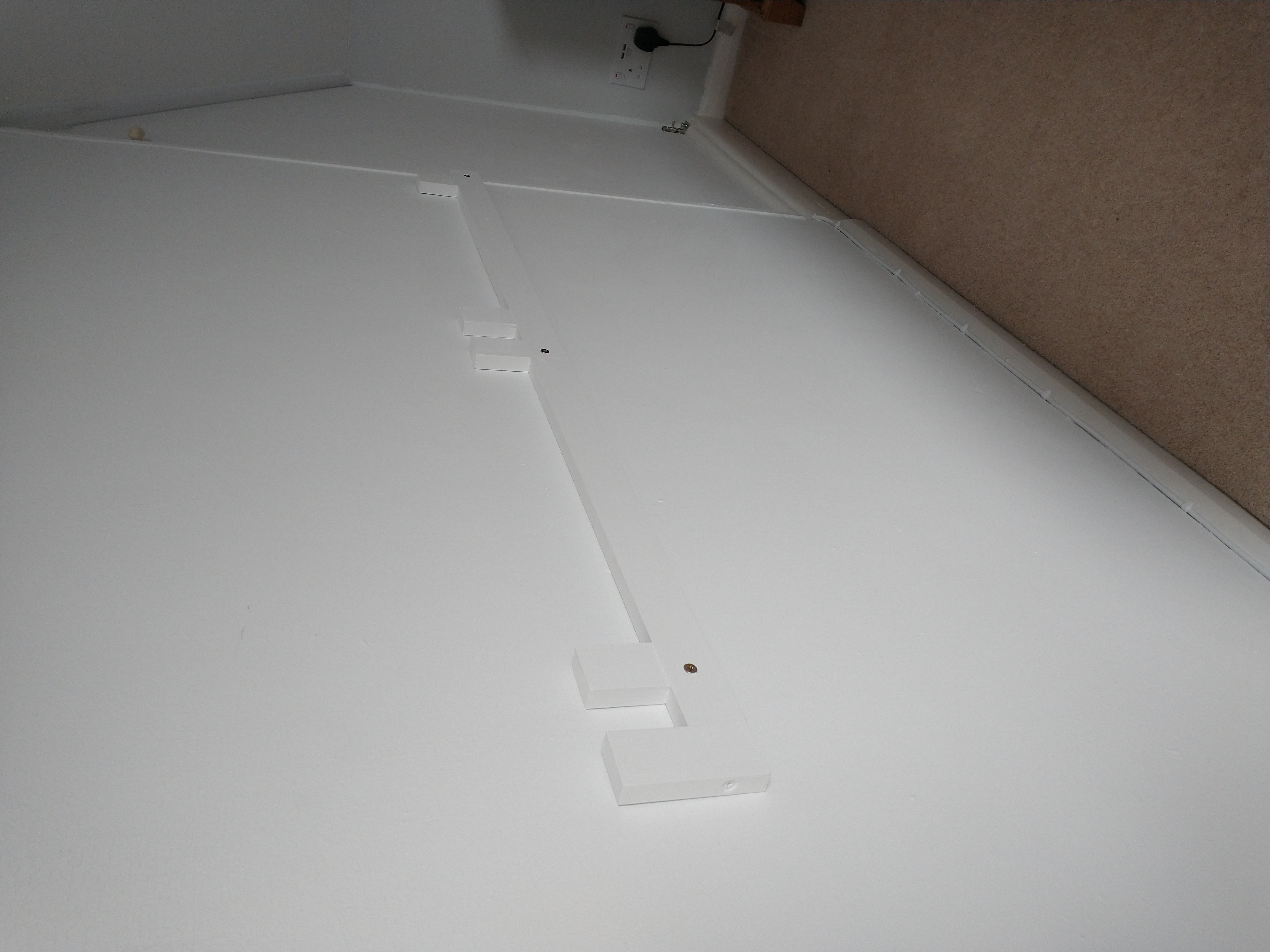

Mounted some supports on both walls either side of the bed. Painted them the same colour to blend in.

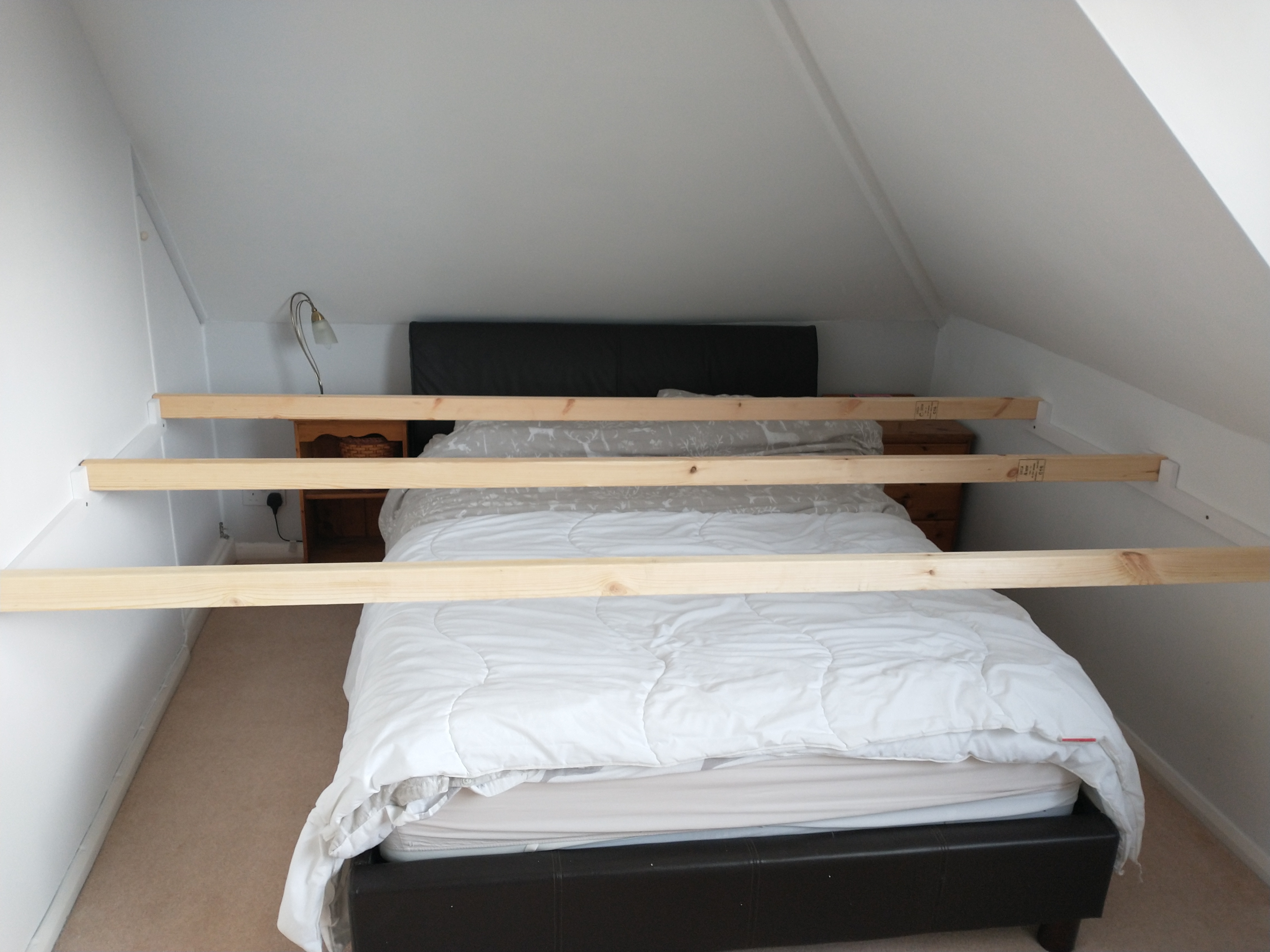

Ran 3 support beams across the room.

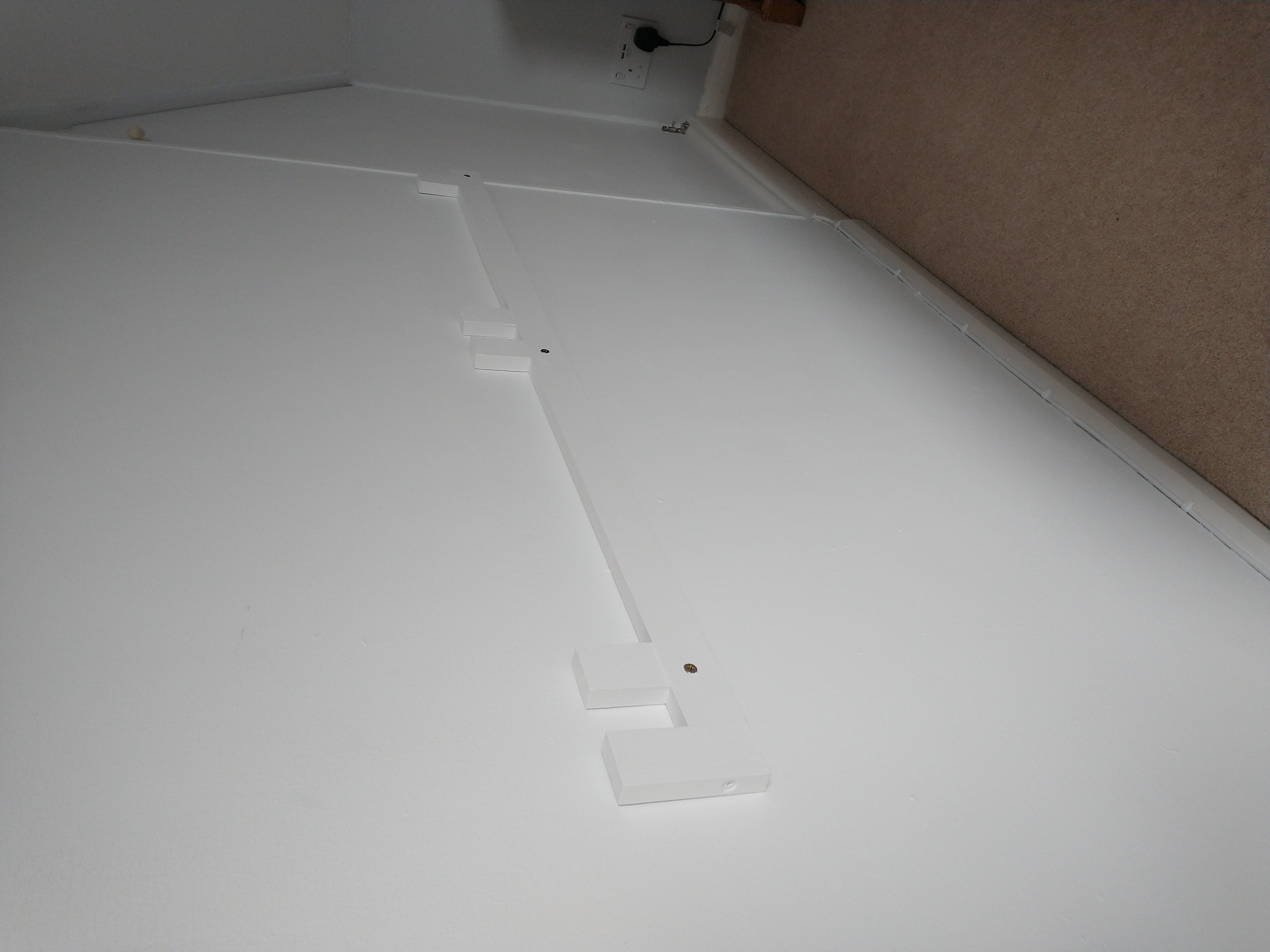

Hopefully picture has loaded this time.
RE: Baseboard location solved. - Serpico - 6th-Apr-23
Third time lucky?

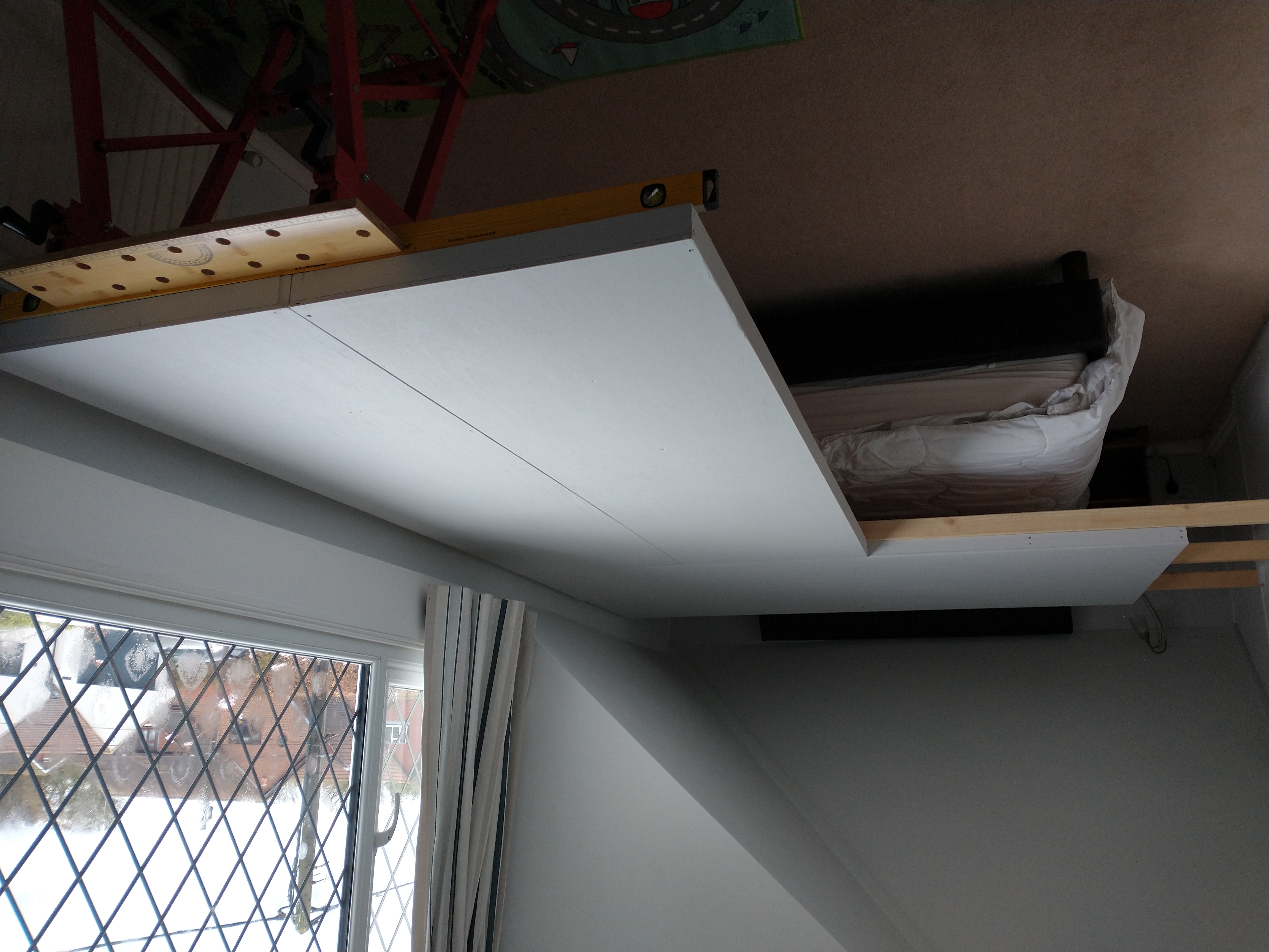

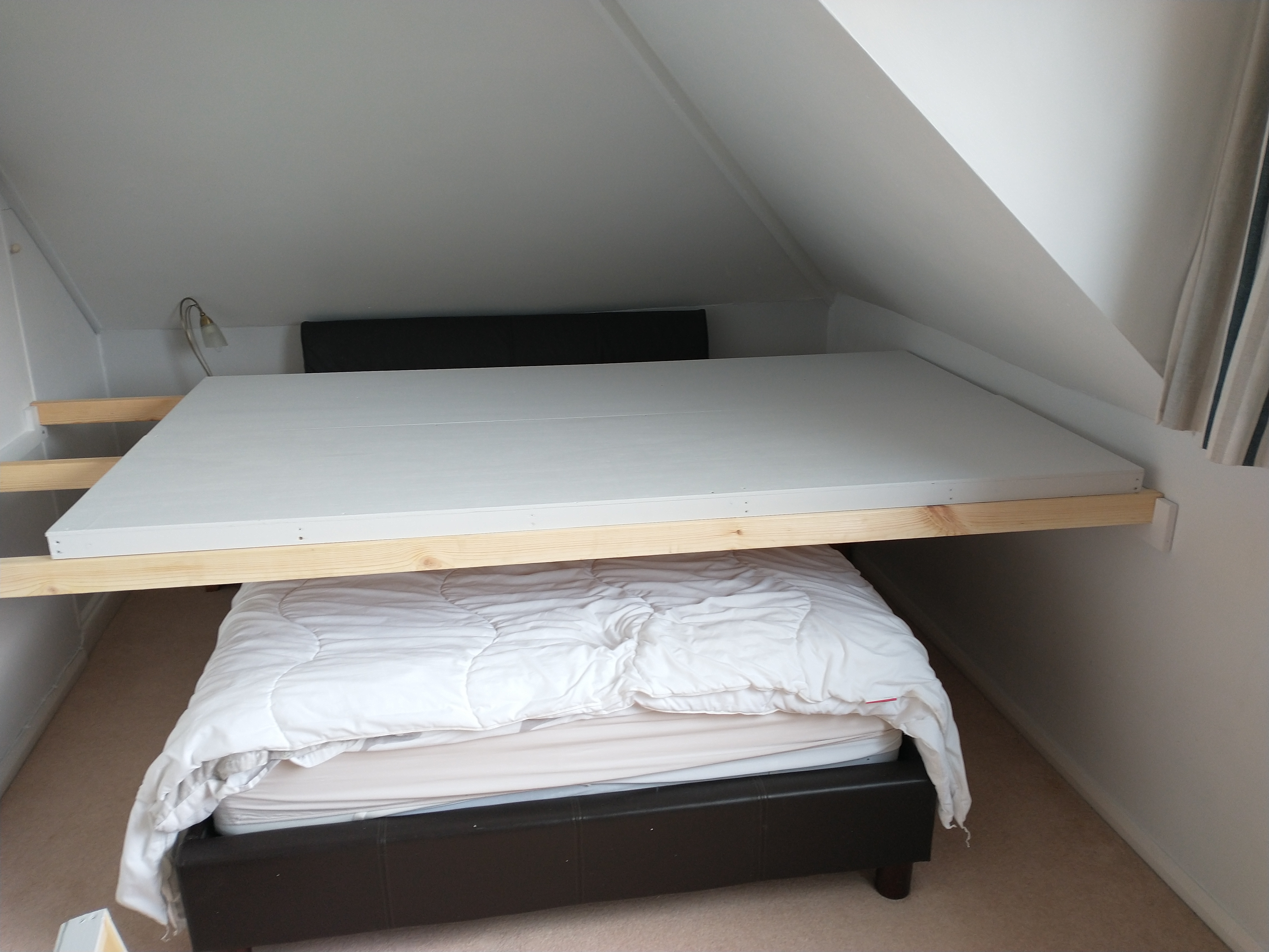

2100 X 600mm boards 2 X 1 frame with 9mm plywood on top.
Couple of extra boards under the window. Bought a cheap workmate as a temporary trestle but I'll make a proper one up which will be easier to store away. Boards aren't heavy so I can make one out if 2 X 1. Little bit of room left to extend the ends of both boards. The maximum length I could have was 2100mm, that way they fit under the bed. Must admit to being pretty pleased with my design, just hope the wife will be when she gets back from a week away with my daughter. She doesn't know about this.........yet?
RE: Baseboard location solved. - Kevan - 6th-Apr-23
You must be a magnet racer...driving upside down on the ceiling
Ive tried to put that photo the right way up but can't work out how to do it. Funny thing is when I click on it it comes up the right way up.
