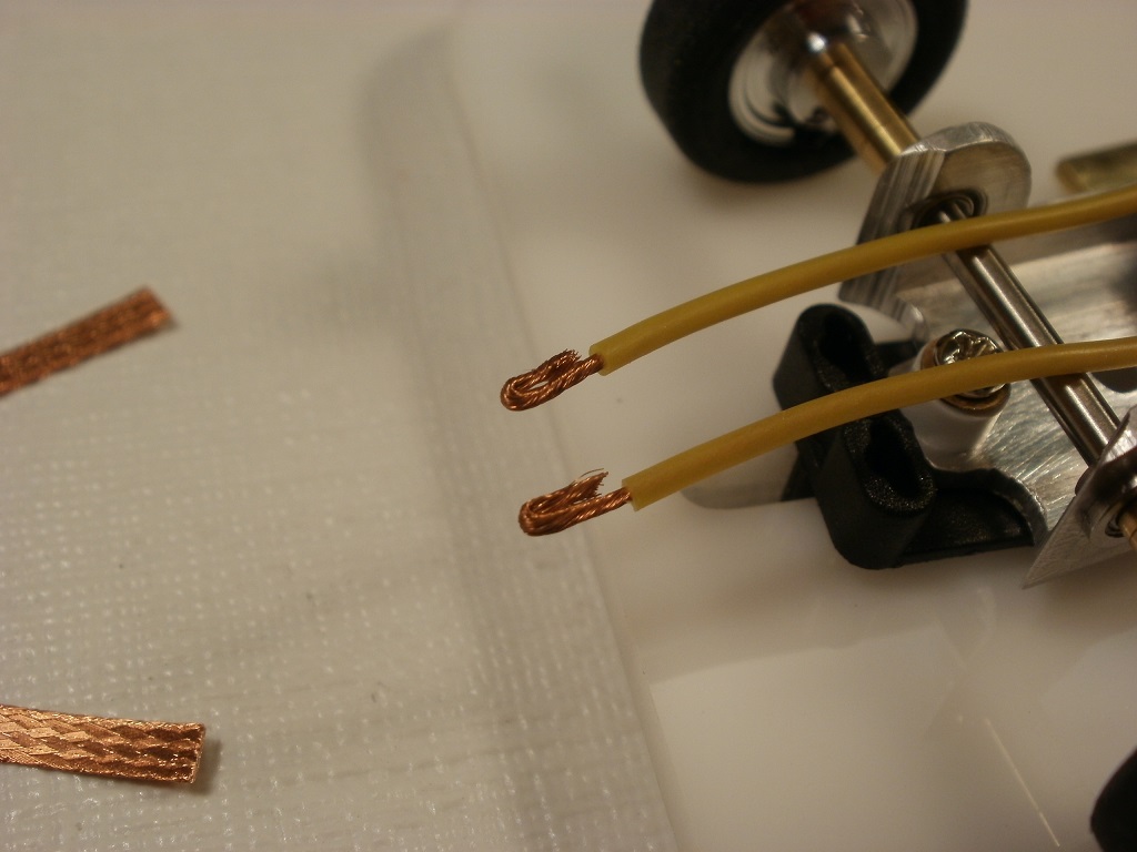

Luckily someone in my club wanted pics. This is how I install new braids. Others may do it differently.

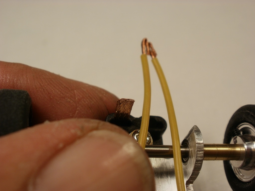

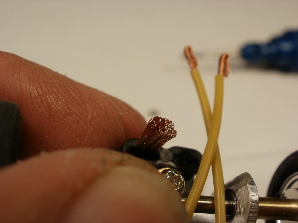

Remove enough shield to fold the wire in half to give it bulk.
[attachment=28423]
[attachment=28424]

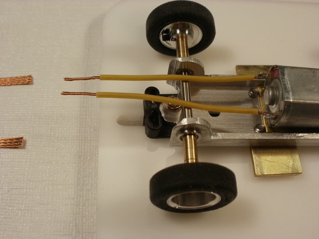

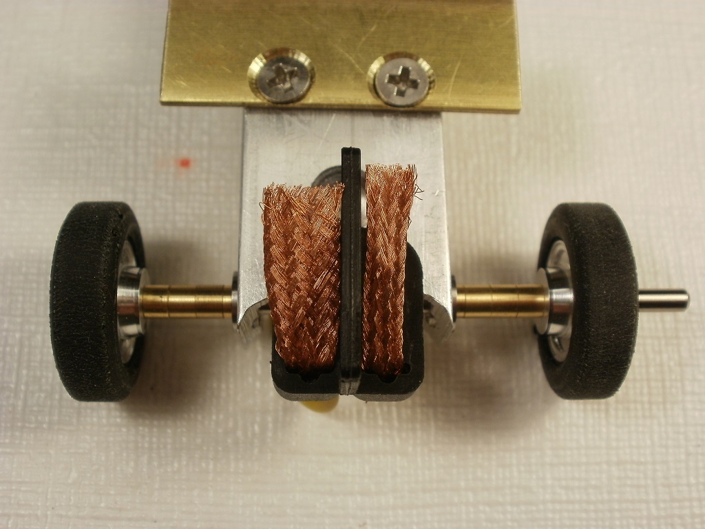

Then insert the braid through the guide and open the braid. The braid is actually a hollow in the middle. I use a razor to find the split. Then use a small flat screwdriver to open it up so the folded wire fits into the braid.
[attachment=28425]
[attachment=28426]

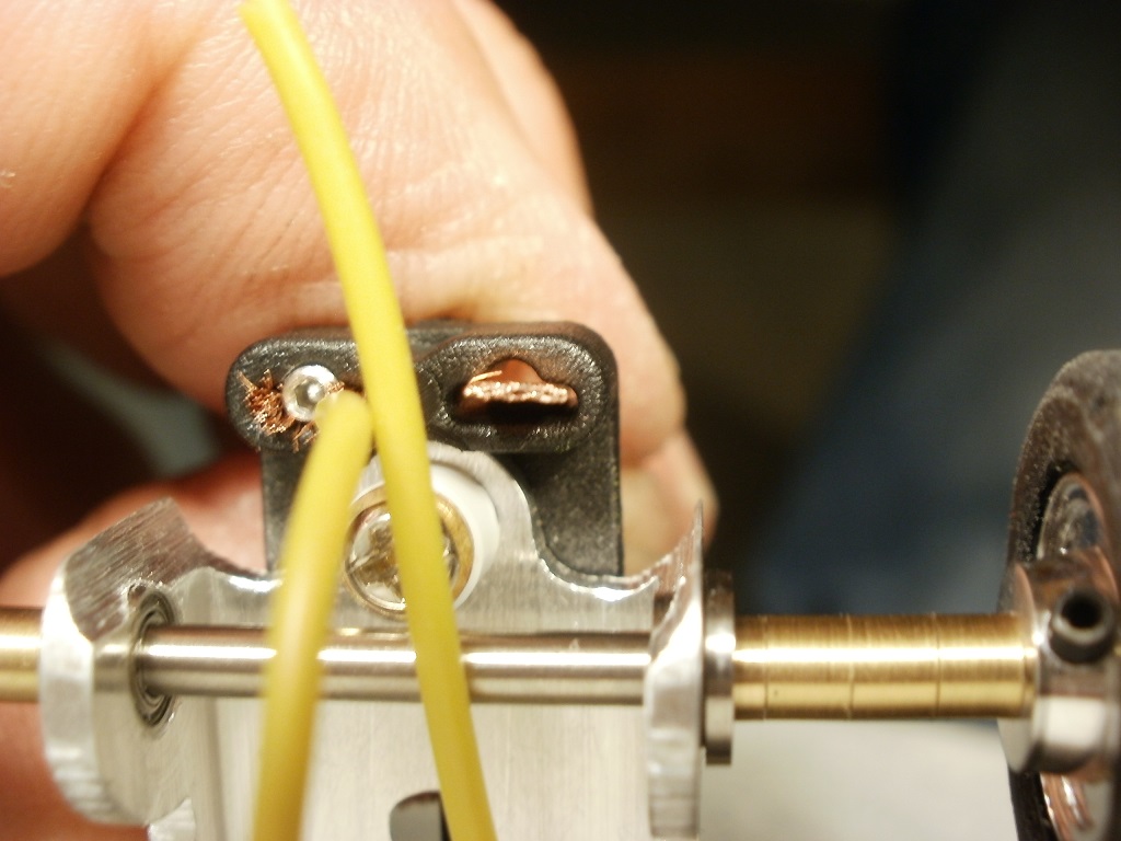

Now comes the real important part. Install the wire on the INNER side of the opened braid, followed by the set screw. The 2mm set screw only squeezes the wire on the side of the guide, but doesn't actually touch the wire.
[attachment=28427]
[attachment=28428]
Keeping the wires to the inside of the guide minimizes the movement of the wire. I have had zero failures in 4-years (since I started doing it this way).

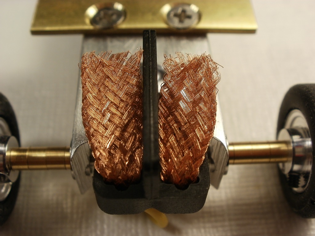

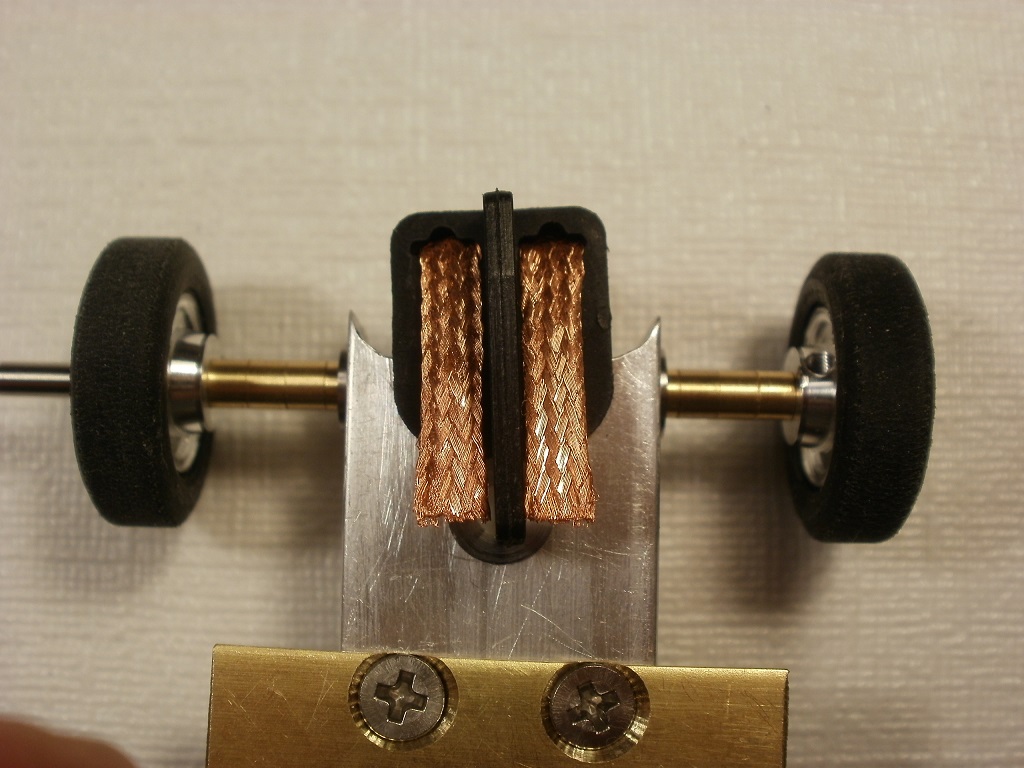

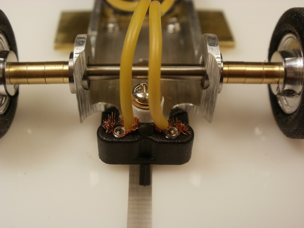

One last detail. Take the newly installed braid and push it backwards in the guide to spread the braid a bit. It helps to make full contact to the power rails.
[attachment=28429]
[attachment=28430]
[attachment=28431]

One point I forgot to mention. The set screw goes on the ousite of, and in the hole above the braid. The braid helps the prevent the threads from cutting the wire. Don't try and install the set screw inside the braid itself like the wire.

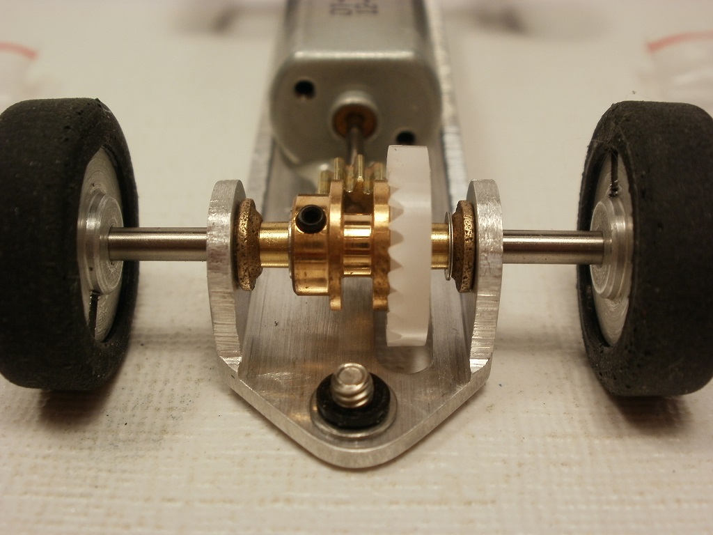

Chris Walker taught me that the motor shaft creates a lot of drag to the crown gear. So, I cut the motor shaft down and let the gears run free. I Then need to use Sloting plus or NSR (both are good) axle spacers on both sides of the crown gear to have the perfect gear mesh. It's just a matter of measuring and installing the bushings. No fussing around. It's easy math.
[attachment=28453]
Making sure the ends of the axle spacers are true, is critical.
