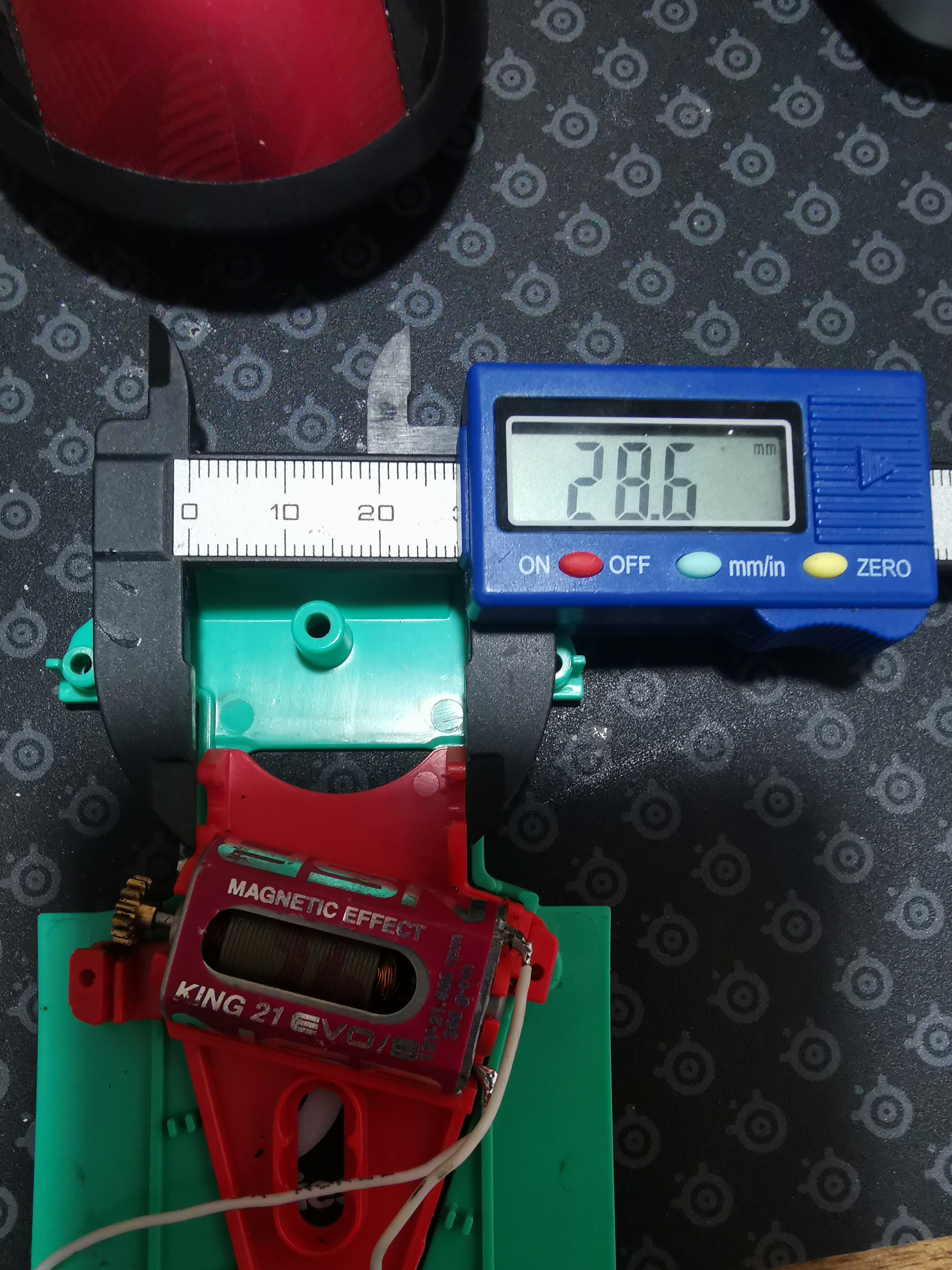

Hi, I'm a bit confused by sloting plus's description
Sloting Plus Combi Axle Tube 29.9mm 1x for use with Porsche 997 Ninco, Porsche and Corvette NSR. Previous Ref No: (SP053102)
Or
Sloting Plus Combi Axle Tube 31.0mm. 1x for use with Mosler, Megane, Lexus, Supra and NSX Ninco and Mosler NSR. Previous Ref No: (SLPL-1010)
As I thought the mount was the same for all NSR gt3 and the mosler? I guess one is for the old rectangle mount and one is for the triangle mount. I only have a triangle mount to measure and tempted to say the shorter one would be right but does anyone know?
Thanks

I have one of these tubes for a Racer Sideways pod. The Slotting Plus dimension is the overall length of the item, outside flange to outside flange.
So measure the distance between the outside of your NSR bushings and check which tube you need.

Thanks, measured a couple and coming out at 28.5, so the 29.9 seems most likely as needs a bit of room for the outside flange.

Did the 28.5 measurement include bushings?
RE: Which is the correct Sloting Plus Combi Axle Tube for NSR triangular mounts? -
tatter06 - 6th-Oct-22
No that was just the outside to the outside of the plastic cradle where the bushings would sit.

Hello Tater06, Measure from the outside of each bushing flange on the rear axle to determine which length tube you need....eg. the current NSR triangular sidewinder pods are 31mm across from the outside of each bushing flange,...so,....the 31mm size is the one you need for these pods.

I found an sw and an aw with bushings in place, can't be 100% sure they are original nsr bushes as I usually swap them out for 2.38 but they look fairly standard. Measuring both gives
Sw 30.4
Aw 29.5
So allowing for tollerence of chinesium calipers the 29.9 is probably the most likely. I was surprised they were different widths.
Yes I can see the sw would need to be cut away there's barely enough room for the motor wrapper.
I will order some of each length anyway as I would like to try them on an sw too.

The 31mm tube is the one that works (perfectly) for the NSR Triangular SW pod...........the 29.9 will deflect the rear uprights inward.

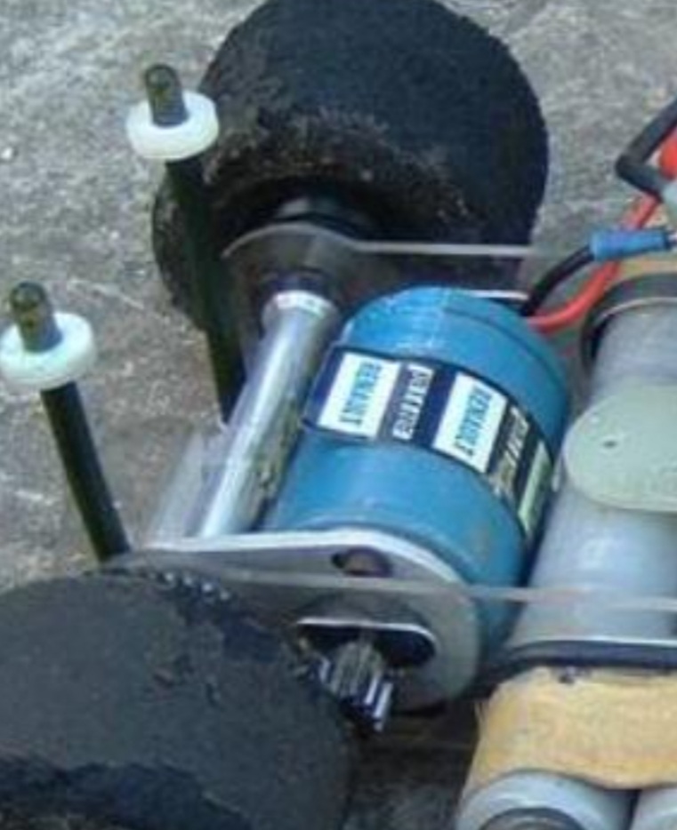

I wish Sloting Plus would go to the next stage.
An example below of a torque tube from a 1980s 1/12th rc
Lexan chassis from this era were extremely flexible.
The torque tube design adopted by all lexan monocoque designs of the time.
Locking the motor to the axle eliminates flex.
[attachment=26530]

That looks like an original Phantom 1/12th. They were great years ('81-'83) but the advent of carpet killed off lexan chassis. The torque tube was still used for a short while until dampers started appearing.
