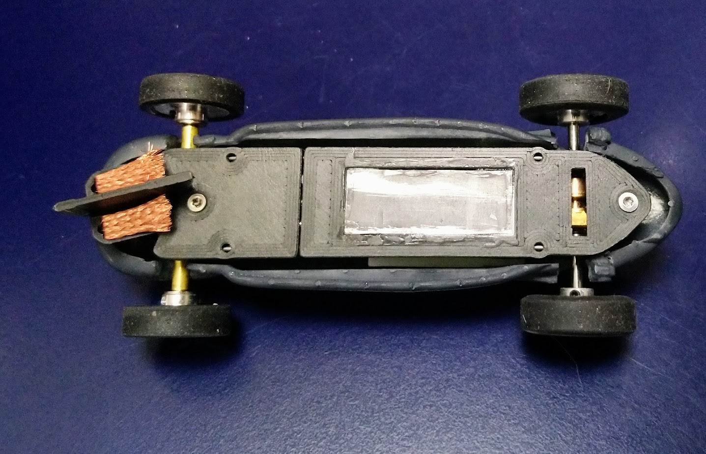

Take one 3D resin printed 1939 Mercedes W165 (Voiturette), modify a good working chassis design and you get a super competitive little track burner.
1/32 Mercedes W165, 3D resin blend, CF-PETG chassis, ballraced rear axle, Scaley green slimline motor, PCS tyres and wheels.
This is built to CSCRA regs, 2mm ground clearance, 5mm wide front tyres 19mm dia, 7mm wide rears tyres 21.5mm dia, 50mm wide across the tyre walls.

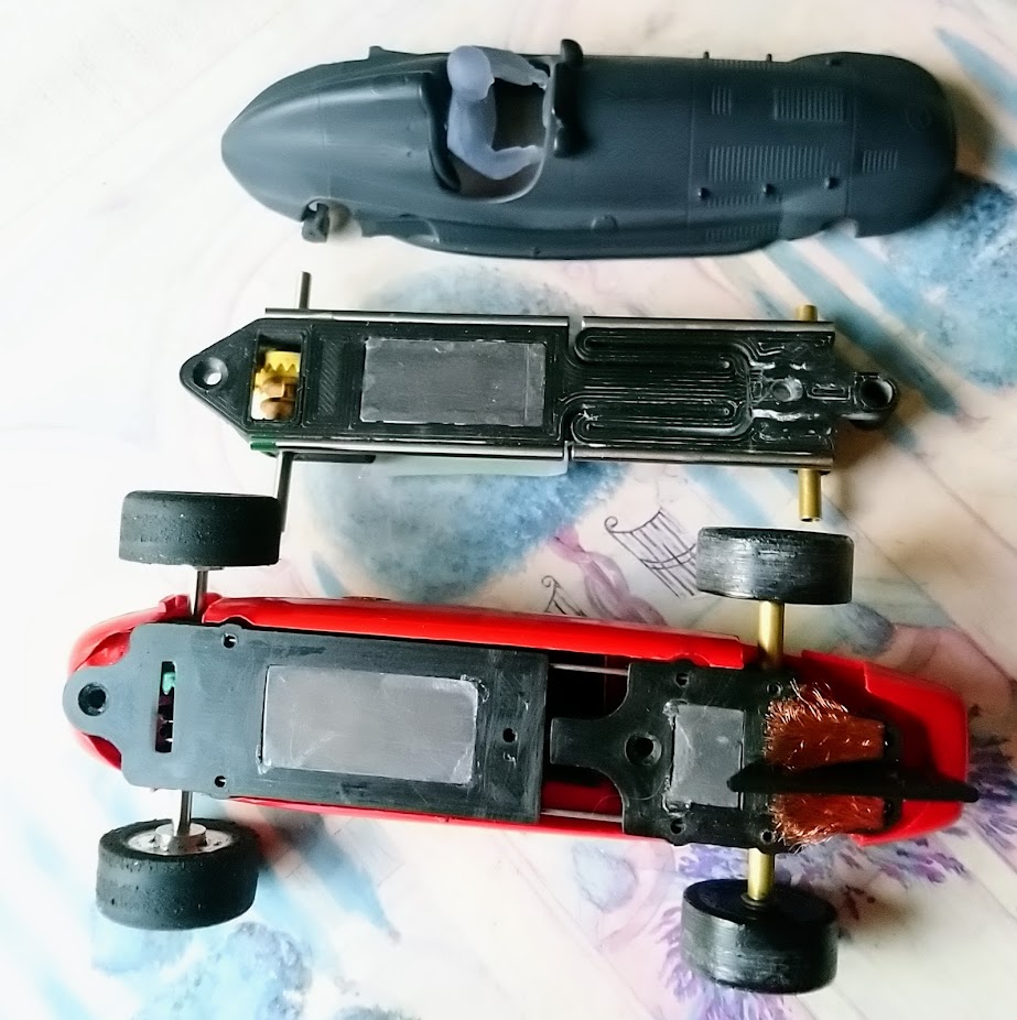

The original 'flexy' chassis was OK but nothing special on track but the Lotus 24 chassis works like a dream but I could see improvements.
[attachment=25092]
The new design
[attachment=25093]
What's it go like mister?...
...before anyone says, it's a crown gear not a spur gear.

Thanks, it actually exceeded my expectations by a couple of tenths.

I have a resin Penelope Pitlane one with a completely different 3D chassis and a Shark 25...but it's going to be replaced with an upsized version of the one in the W165 powered with a much-kinder-on-tyres slimline.
