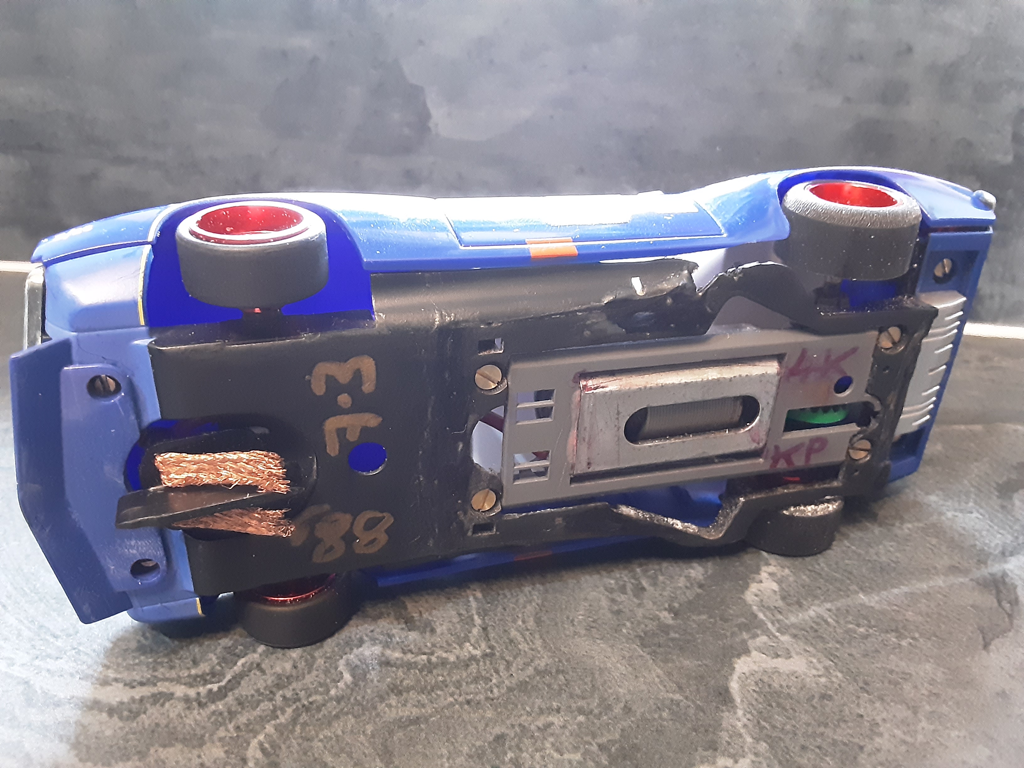

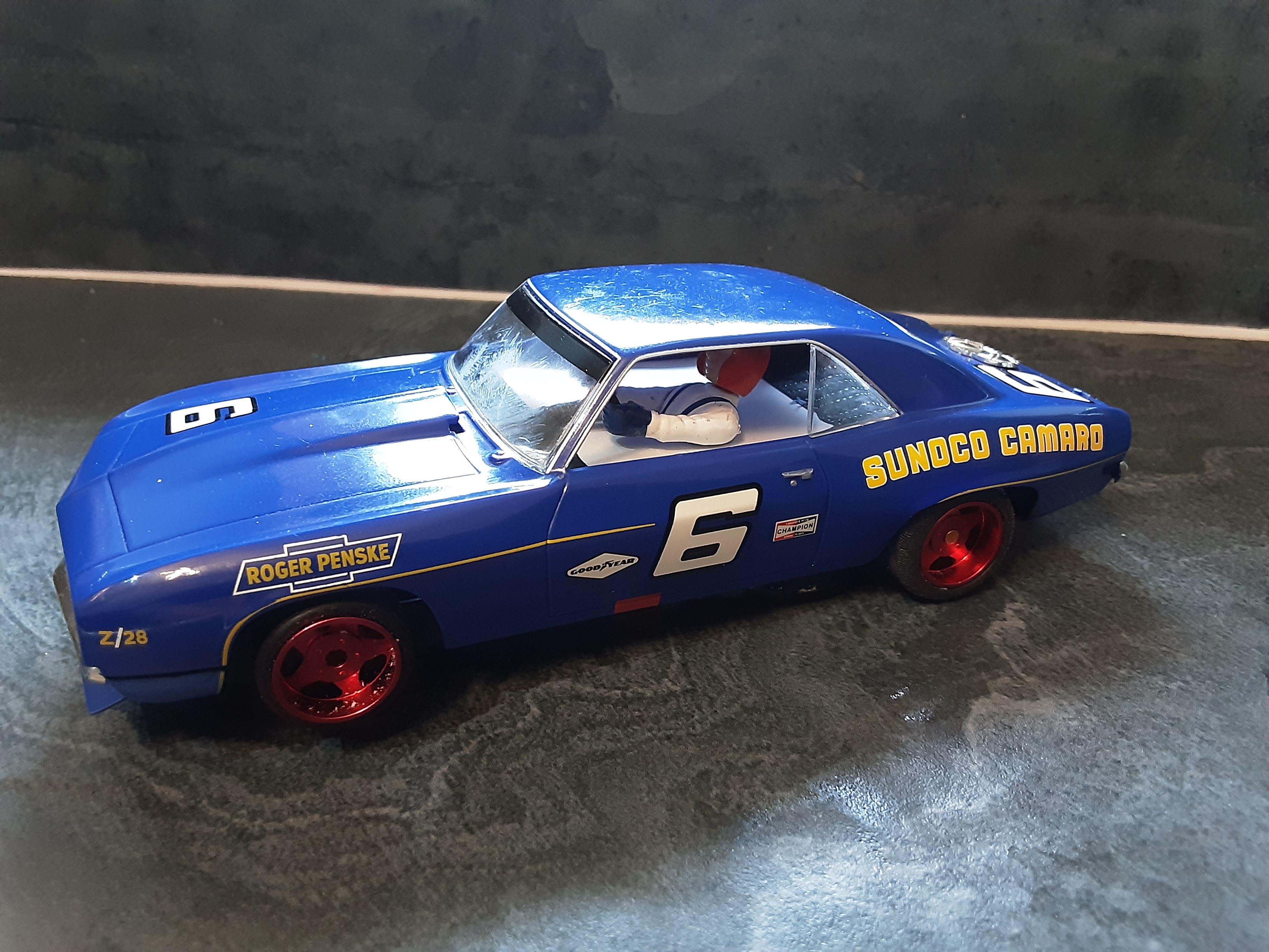

So, after picking up a used Scalextric Sunoco '69 Camaro for £20 at the recent MiltonKeynes swap meet, I began planning the cut'n'shut.
Researching other's conversions, there are clearly two schools of thought.
1- cut a chassis aperture to retrofit the motor mount.
2- cut a chassis aperture to take the motor mount "skeleton" from another chassis.
For the camaro, I chose the second.
The drivers for this?
1- the scalextric chassis was not wide enough (at its flat section) to take the motor mount.
2- the camaro has front and rear detail that has been designed, built and painted into the chassis rather than the body.
A donor skeleton was found in a racer sideways BMW m1 chassis that had suffered a major front end impact and split the front of the chassis after a floor impact.
The skeleton was cut out with a modelling knife and offered up the the scalextrix chassis and body to align ready for the chop.
The scalextric chassis was cut and the skeleton "spot welded" into place with very small amounts of superglue.
The rear of the chassis was chopped off and fitted to the rear of the skeleton.
Once the whole chassis assembly slotted together with the body, as required, the assembly was pulled apart.  Epoxy resin mixed with black powder residue (from the cutting and shaping) was then used to make the final permanent bond. Where a gap was present between the skeleton and chassis, small amounts of tissue paper was used to act as fibre glass.
Some pics below
I did not take pics during the process, sorry. I had not planned to write this little project up.
The most difficult part of the conversion was the alignment of the skeleton into the chassis to ensure that the motor was centred and aligned properly.
It took 3 attempts, cutting and rewelding before I was happy with the alignment of the chassis, skeleton, motor mount and body.
Once everything came together, the chassis was run over wet'n'dry paper to remove any lumps and bumps. The chassis was then put through a chassis flattening process using a steel flat plate, magnets and hot water.
I had intended to reuse the yellow scalextric wheels , cut into trims, inserted into NSR wheels. However, after the amount of time take to perform the major chassis surgery, I no longer had the motivation to cut the old wheels up.
The solution? "Staffs" wheels. Quality alloy wheels with set screws.
The red wheels look suitably and garishly seventies against the blue and yellow body.
As part of the conversion, I lifted a Slot.IT motor mount from another car complete with SlotingPlus titanium Axle, Slot.IT transmission and an NSR purple long can inline motor.
The factory fitted screws were replaced with precision machined NSR (rear) and PolicarF1 small head at the front. The body floats!
Top tip for the conversion is to fit the whole motor ensembly Into the skeleton to get the alignment right, then remove the mount to perform the welding.
This process is not just "measure twice, cut once".
It is more like "measure, offer-up, initial cut, remeasure, recut, offer-up again, spot weld, offer-up, recut, realign, offer-up, recut, offer-up etc etc etc".
Remember to offer up with wheels attached to ensure that the wheel arches are aligned.
The camaro was difficult in respect to the wheel arch alignment because the arches part cover the wheels (at the top) and part not (at the bottom). A very typical muscle car arrangement.
In Summary, this was an interesting and challenging exercise.
I'm glad to have experimented with this  but this is  not a process I plan to repeat.
Too much hard work and the results can never be as precisely engineered as a 3d solution.
Next time, I'll bite the bullet and find a 3d solution.
Please do leave comments and pics of your own cut'n'shuts

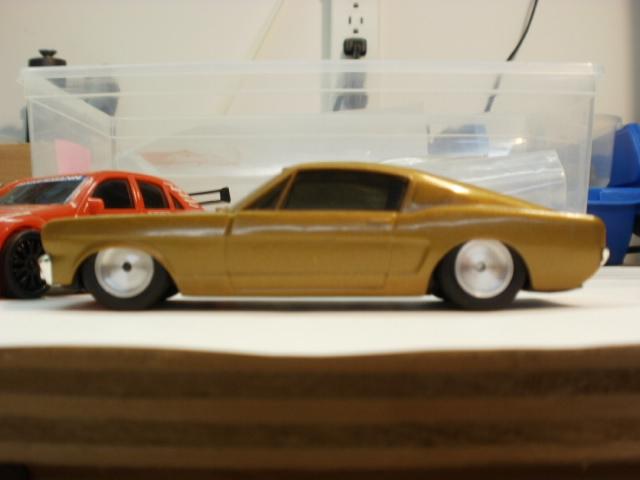

Before I built my first scratch built car. I tried reviving an old Eldon body of a Mustang GT-350 using a Hornsby chassis from a Mercedes.
A similar unmodified chassis on the left. The trimmed version on the right.
[attachment=21701]
I was able to lower the body a bit.
[attachment=21702]
In the end the car ran like a turd of hurdles. The wheelbase was slightly off and that drove me nuts. It all quickly came apart and the parts got shelved. The chassis went into the garbage without delay.
Unlike my Mustang disaster. Your Camaro turned out great!

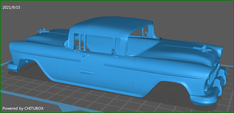

The #1 advantage as long as a printable file is available is you can go bonkers with a 3D cut'n'shut
Take two '55 Chevy's...
[attachment=21709]

Using 3d to create a and print a cut'n'shut car ?
That's a whole different level of insanity!
RE: Cut'n'Shut (ChopShopped ) Camaro - Kevan - 5th-Mar-22
Perfect for 'Crap Car Proxy' type racing.
RE: Cut'n'Shut (ChopShopped ) Camaro - merkit the grof - 6th-Mar-22
(4th-Mar-22, 10:53 AM)Kevan Wrote:  The #1 advantage as long as a printable file is available is you can go bonkers with a 3D cut'n'shut
If you carried out that insanity onto the chassis, wouldn't you end up with 2 guides and no motor?

A quick update after test number 1 of the cut'n'shut Sunoco Camaro.
Tested on painted scaley sport track (londonslotcarclub.com)
Urethane tyres
King purple motor
10-26 ratio
Nsr race braid.
The car performed well.
No unexpcted behaviour at all.
My main worry was that the car would straight line Deslot or Brake Deslot due to imperfect alignment of the skeleton and motor pod in the chassis.
I should not have worried. The straight line behaviour of the car was perfect.
The car entered the corners well and exited just as well.
So....
Enter "the power"
Due to an anomaly in the  LSC rules, class C cars (such as trans am) are allowed to use high power inline motors.
An NSR king 30 awaits. The motor will be pulled from a scaley Sierra PCR car that was never able to contain or control the output of a king 30.
Next entry will be initial testing after the king 30 is installed.
It's possible that this car could outperform a GT class car (class B motors, 25k maximum) at least in a straight line. Bigsmile
3rd entry will be a race report from the trans-am club night  in July
So far so good.
So I might yet do another of these cut'n' shuts if I find a suitable car and livery that can be chopped.
