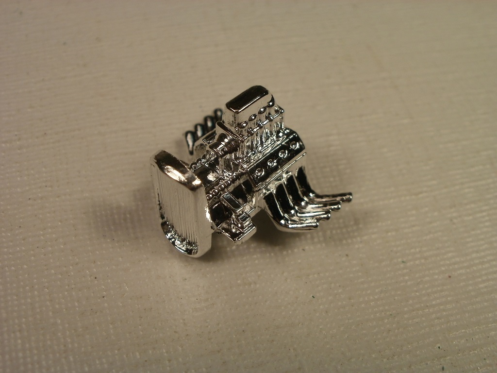

I've been a Hot Wheels vendor for several years. I have a few Hot Wheels laying around. A friend that makes scratch built HO hot rods inspired me to dig into a few boxes. This is what I've come up with.

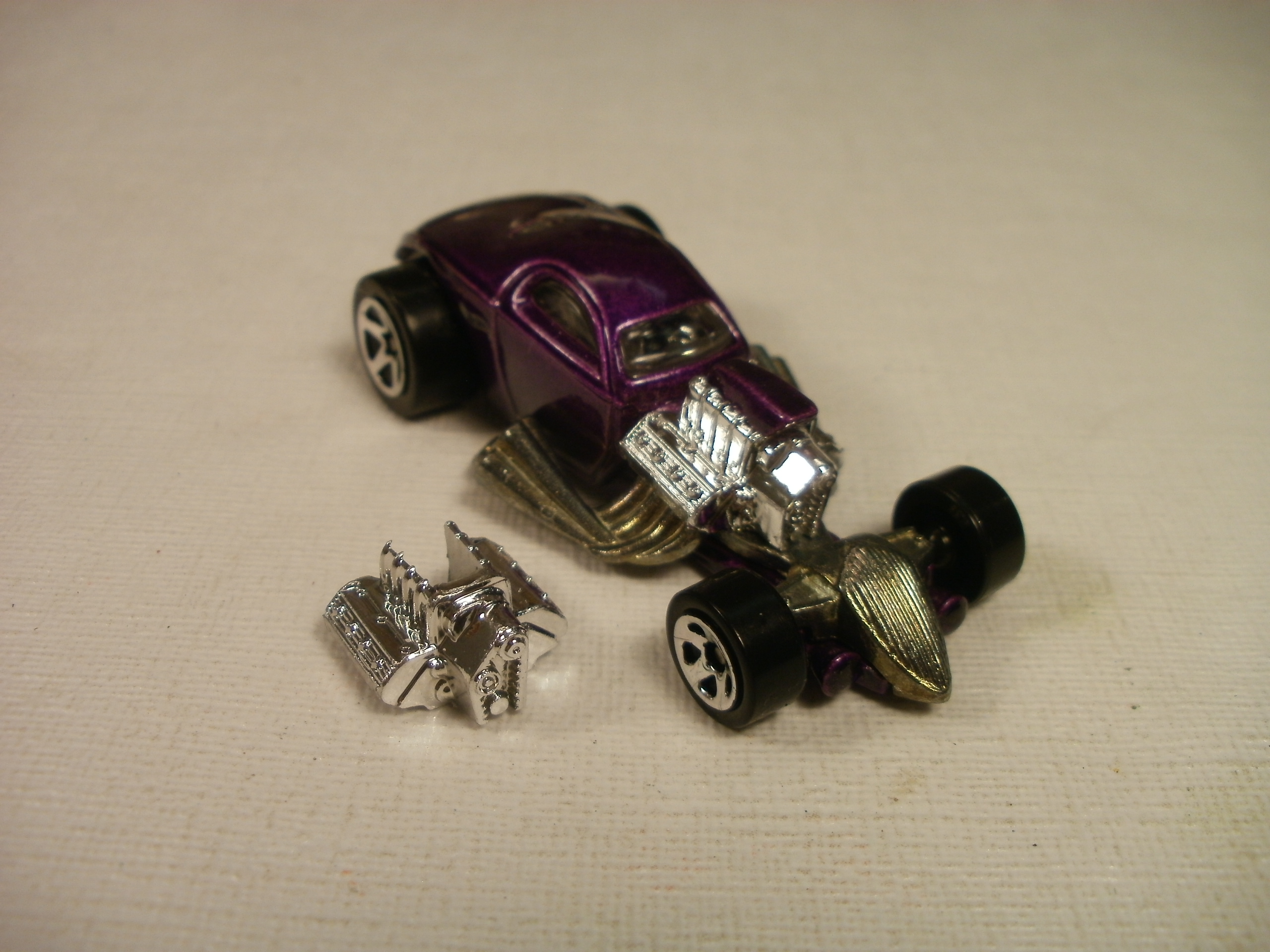

The 32-Ford has the most complete engine for a hot rod with exhaust and grill
[attachment=19939]
[attachment=19940]

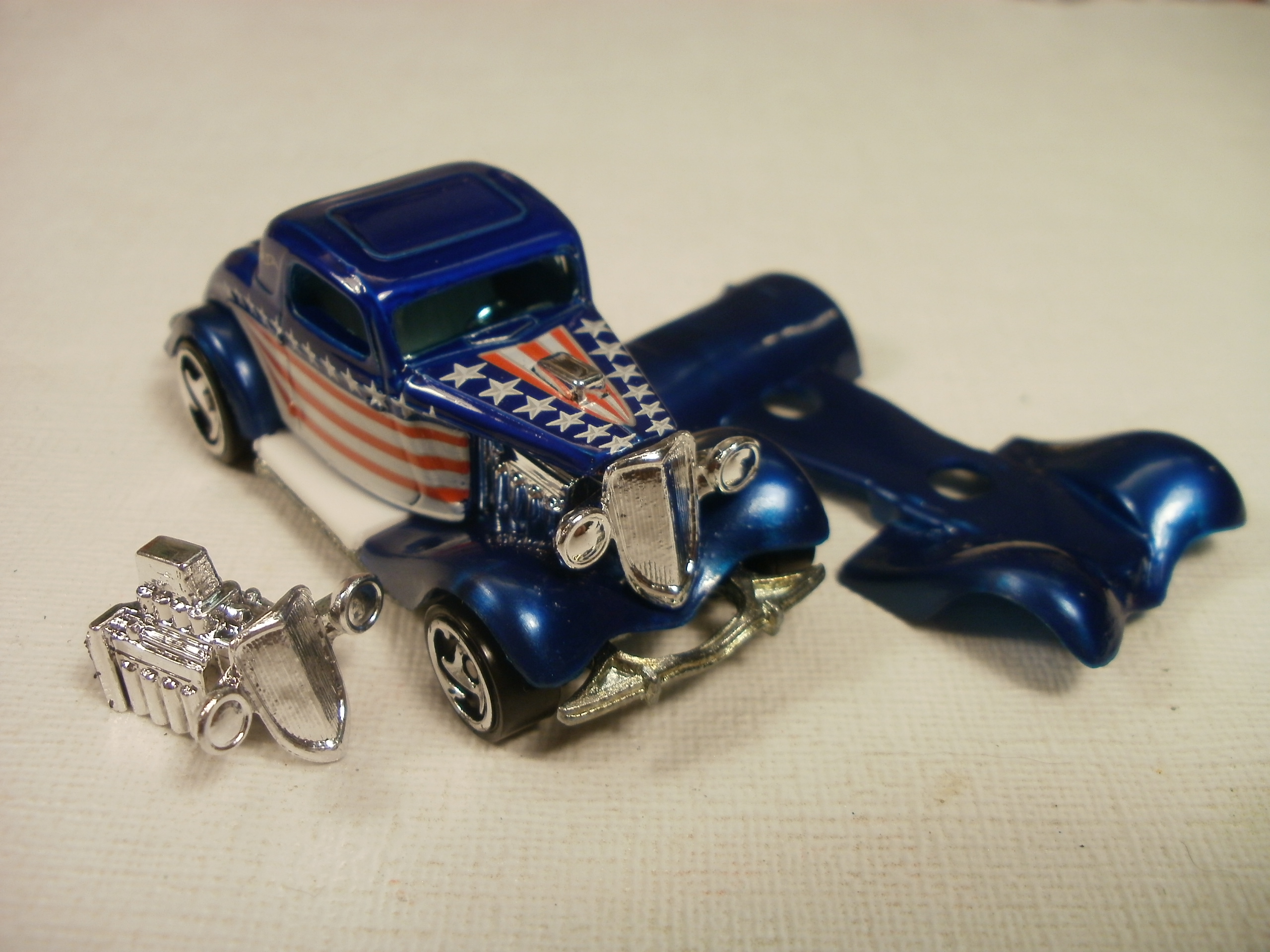

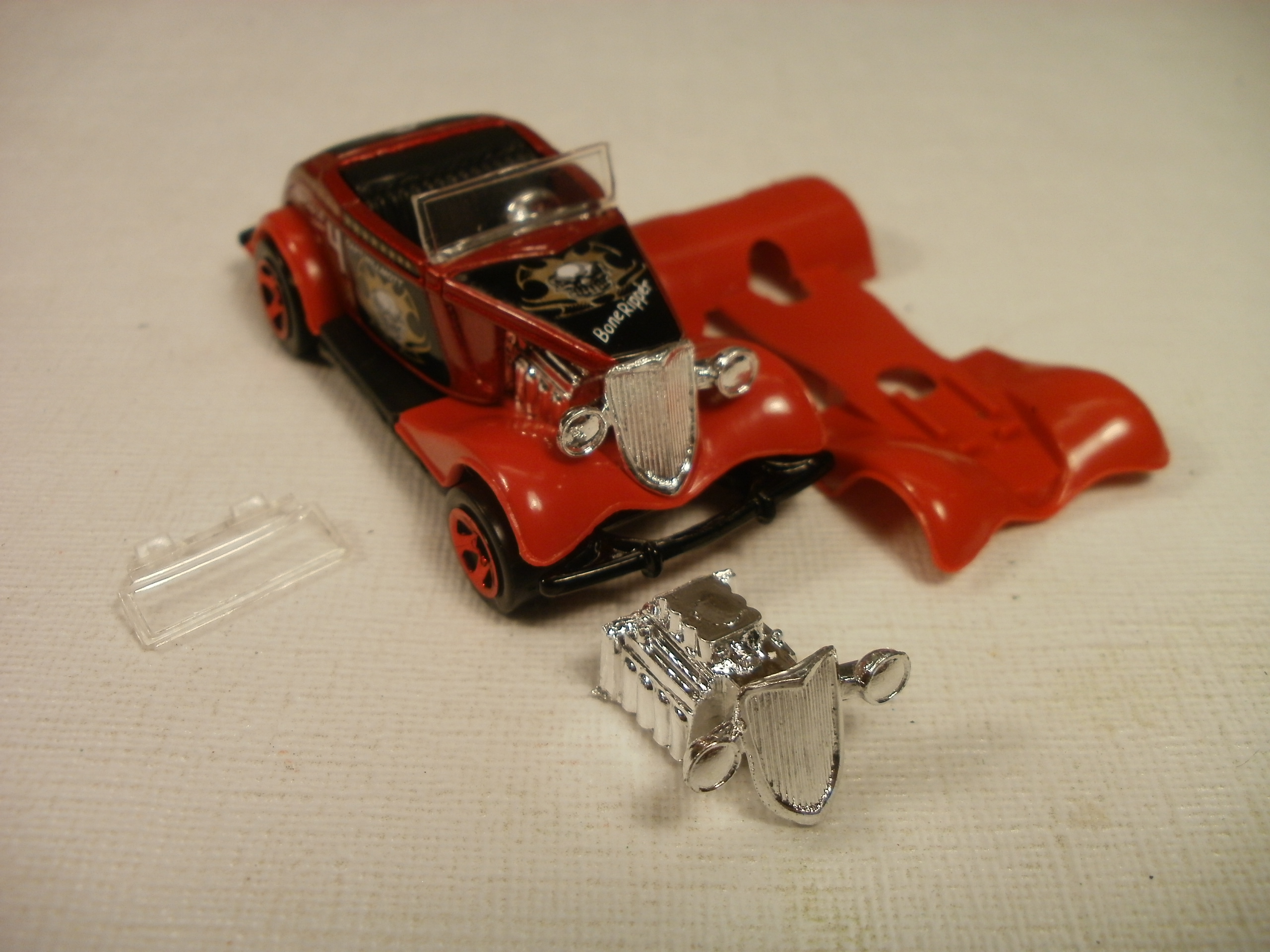

The 33-Ford has no exhaust, or engine scoop. But it comes with plastic fenders, grill, and headlights.
[attachment=19941]

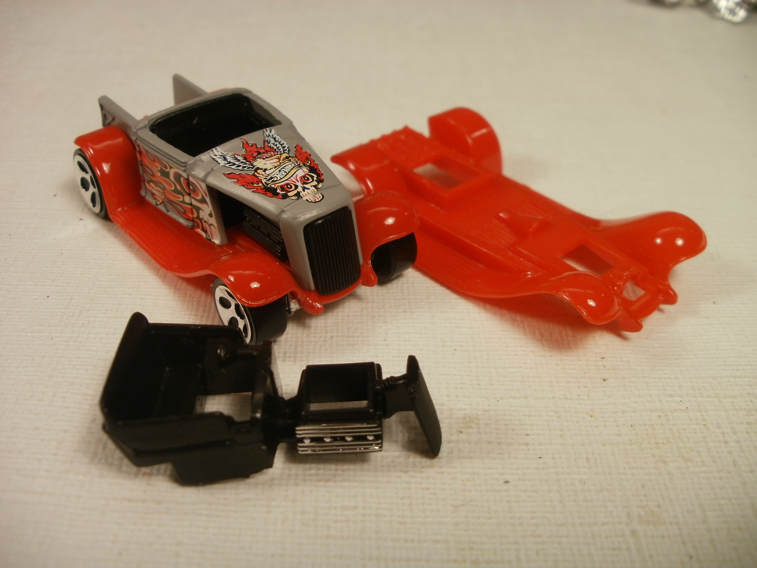

The Hooligan comes with nice flat-head V8 cylinder heads. But they likely need to be modified to change the head angle. Odd casting. Nice fenders again.
[attachment=19944]

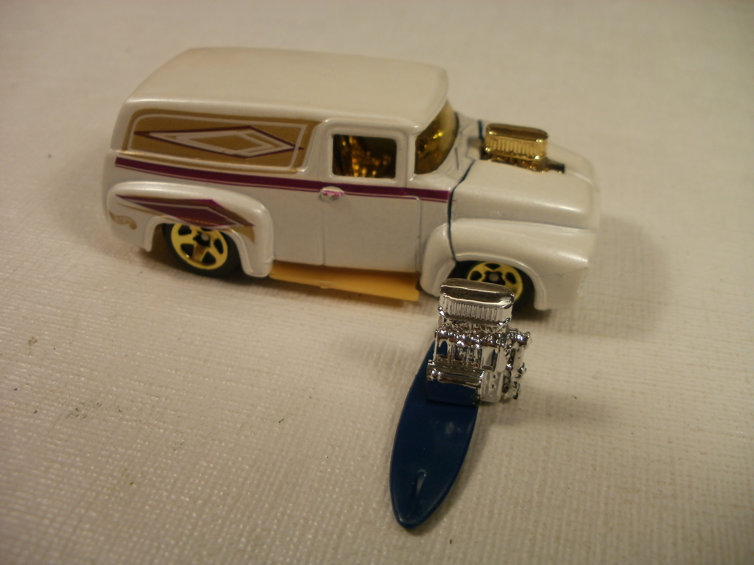

The 56-Ford panel truck comes with a really nice air cleaner mounted on a blower in both chrome, and gold chrome.
[attachment=19946]

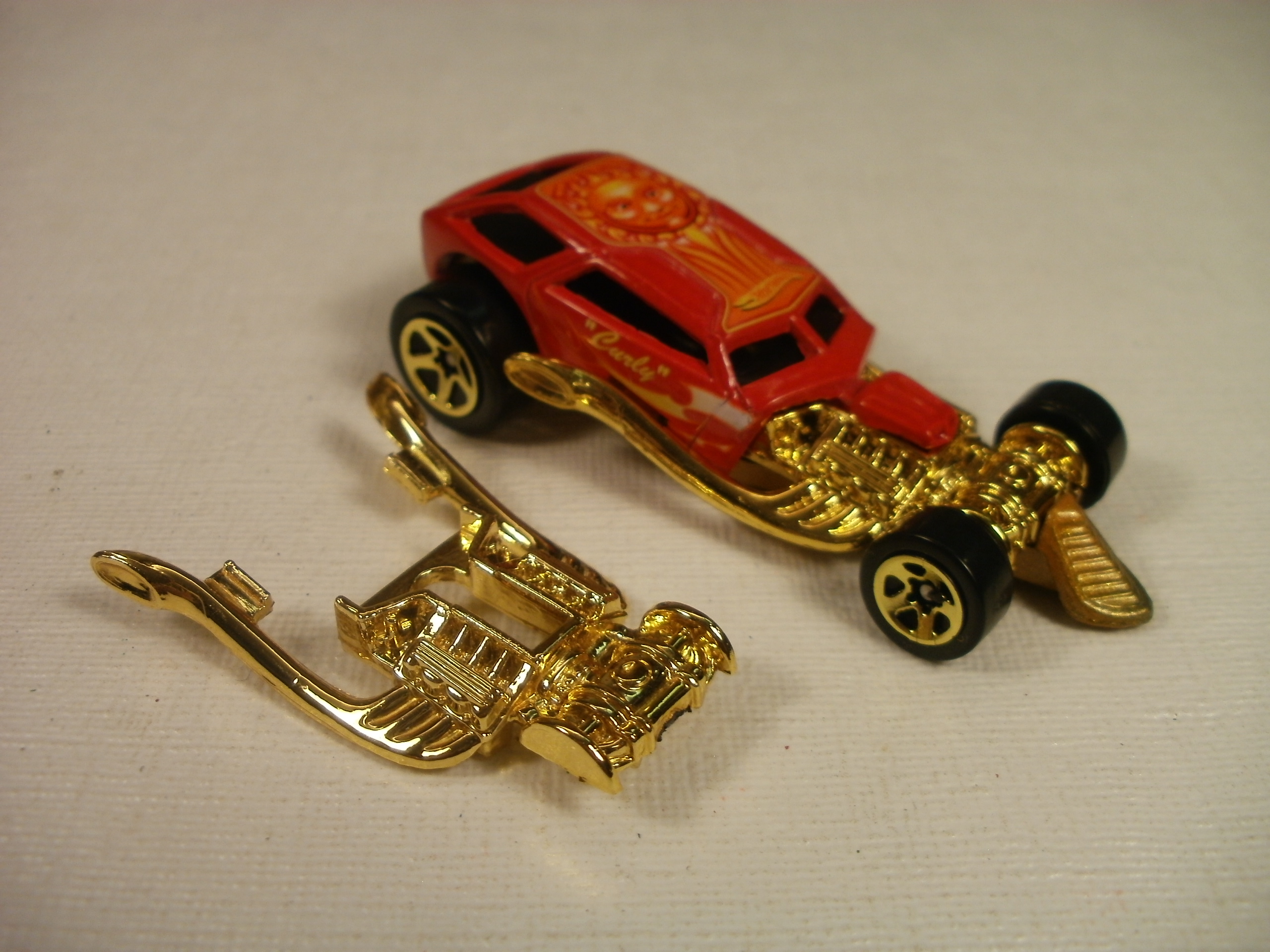

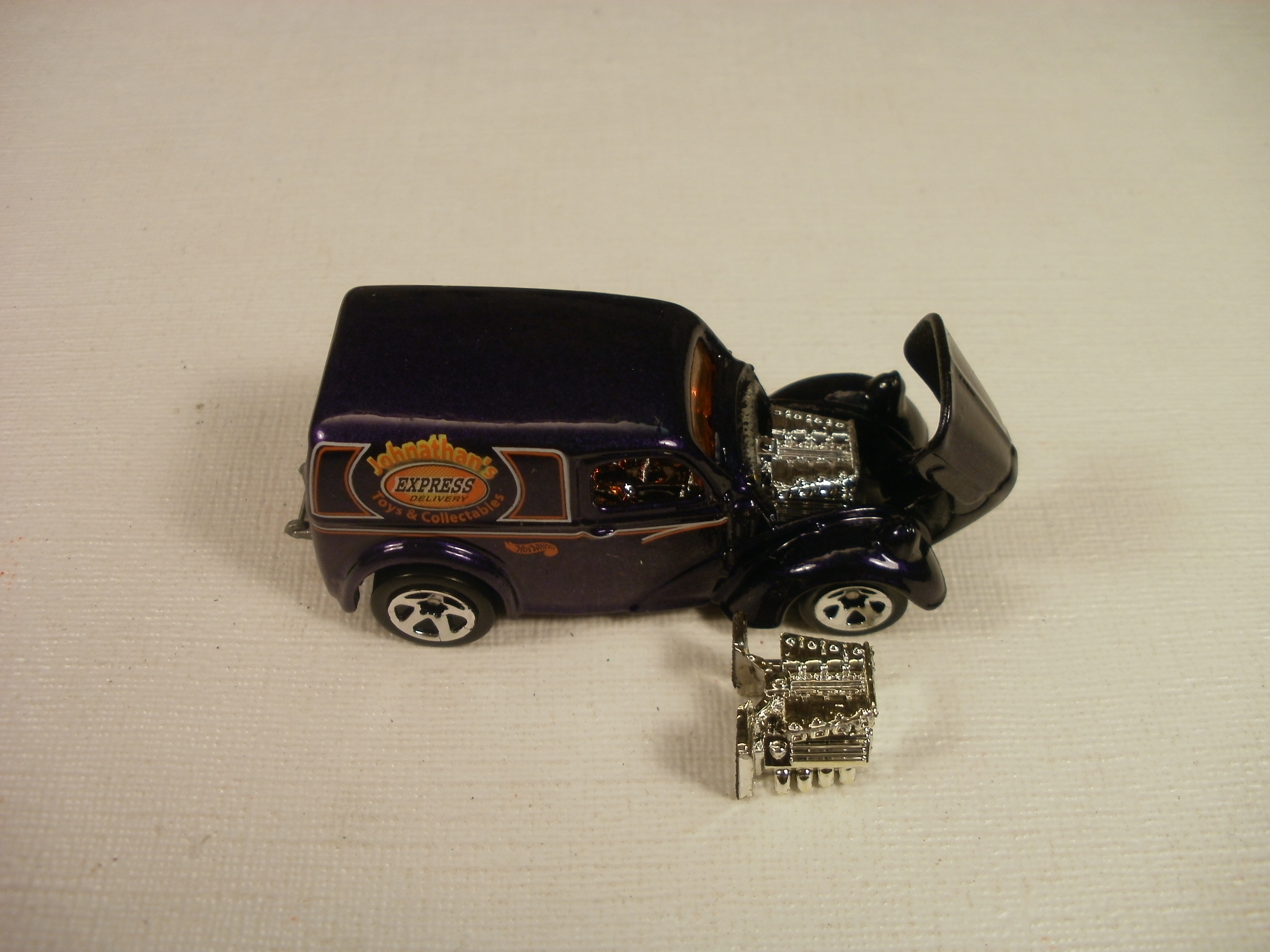

The Anglia had a very cool gem hidden under the hood with 8-square intake runners.
[attachment=19947]

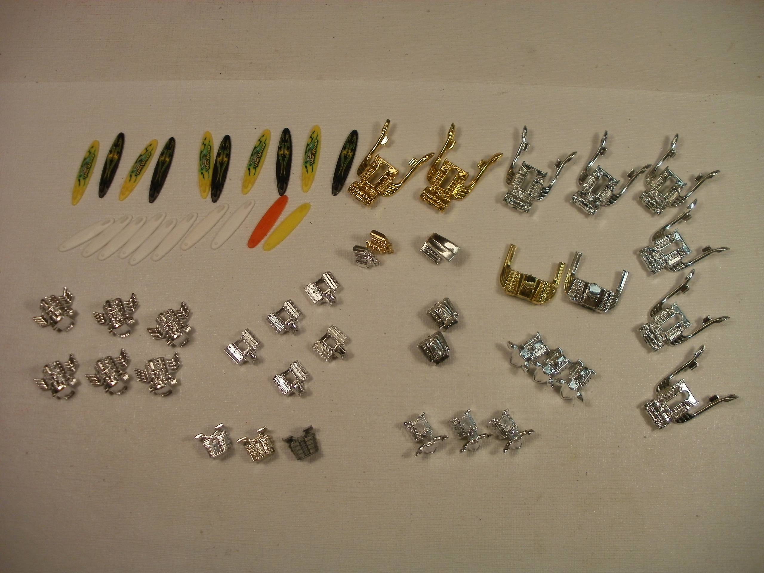

Welcome to Ken's Engine Shop! (And surf boards)
[attachment=19948]
Some of this may end up as door prizes for the next HO proxy. Anyone interested?

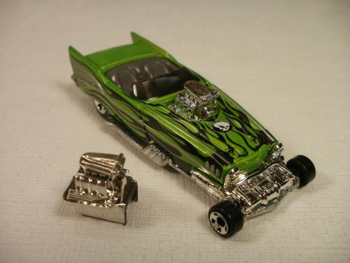

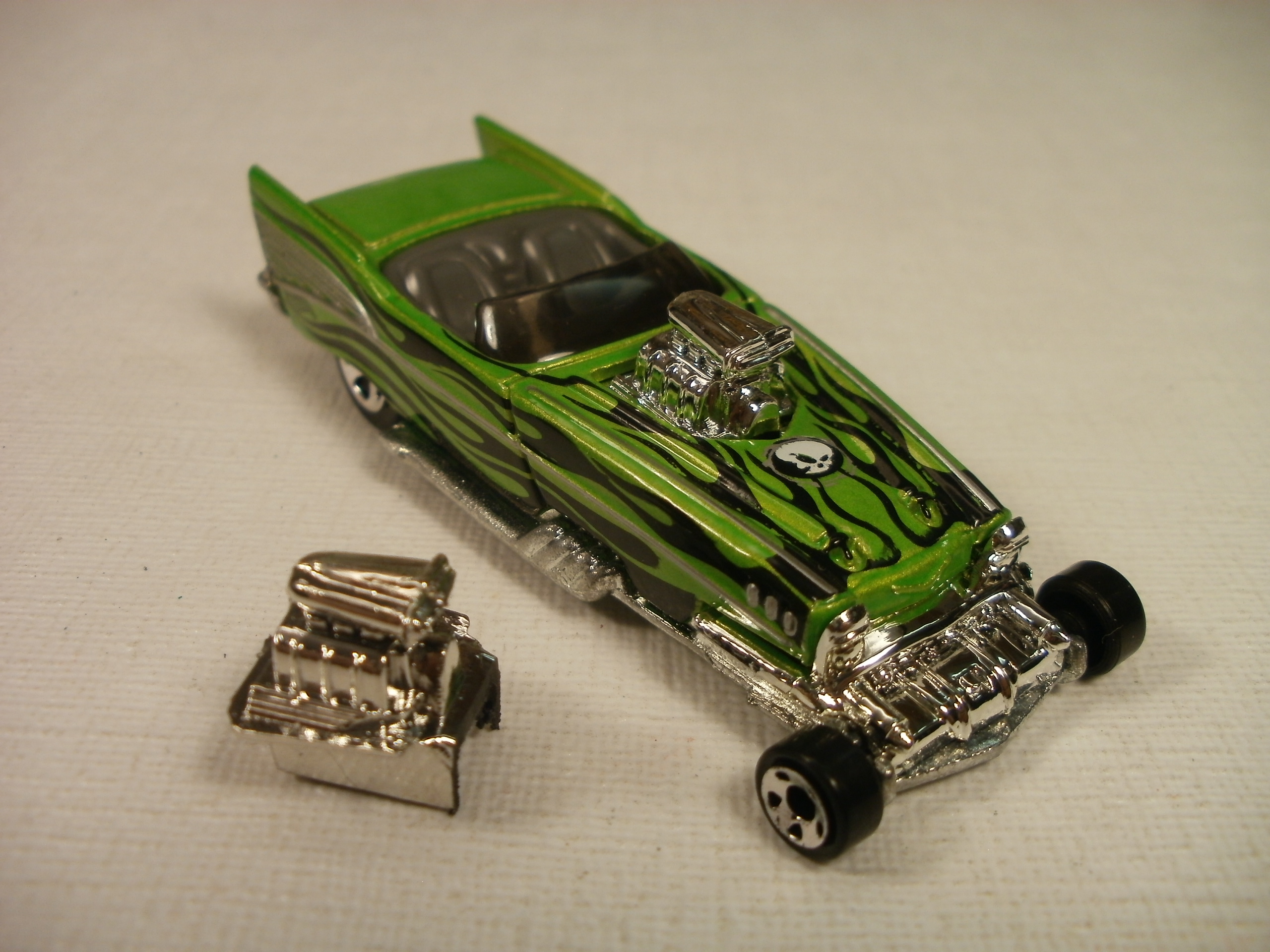

My humble apologies. I forgot to add this car. It's called a 57-Roadster. It has a nice blower and scoop.
[attachment=19949]

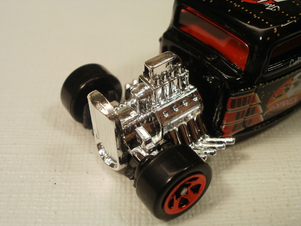

RE: Harvesting Hot Wheels parts for HO cars - Model Murdering - 2nd-Jan-22
Thank you for the needful things Ken. They're a key component for my scratch builds. I'll work them in here and there. Over time HW's has pretty well discontinued making the nifty chrome bits. They're often styled incomplete, or integrally mated in with the diecast part.
With builds starting down on the frame rails, it's nice to have a bit of gumball treasure to bring things right.
