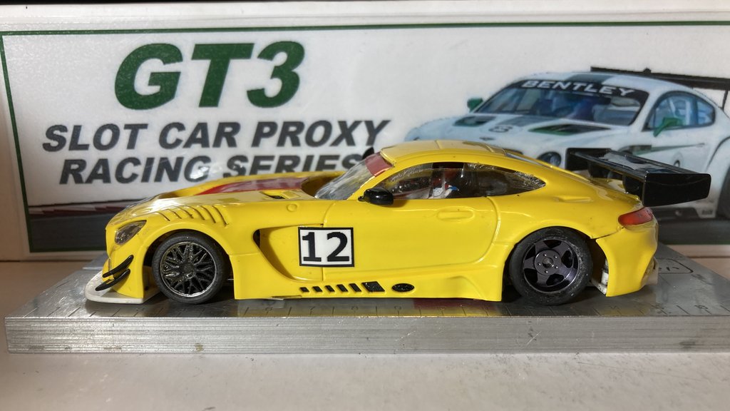

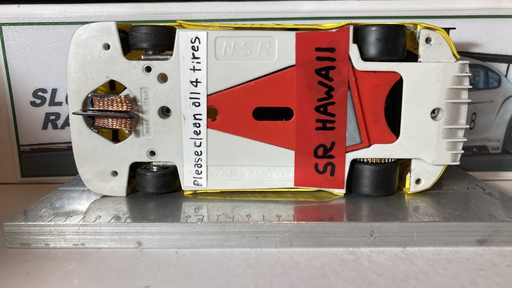

SR Hawaii #12
Body: NSR Mercedes AMG
Chassis: NSR
Guide: Slot.it
Configuration: Anglewinder NSR Pod
Motor: NSR Shark 28
Gears: 11/35
Front Hubs: Slot.it
Rear Hubs: Staffs
Front Tires: NSR
Rear Tires: NSR Supergrip
[Image: 149517-F5-21-FD-4-E55-99-B2-ABF50-DCF497-D.jpg]
[Image: 07490-D43-320-A-4-E02-9-BF8-75-DC19-B4-F719.jpg]

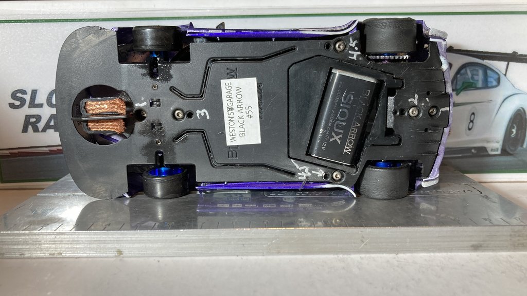

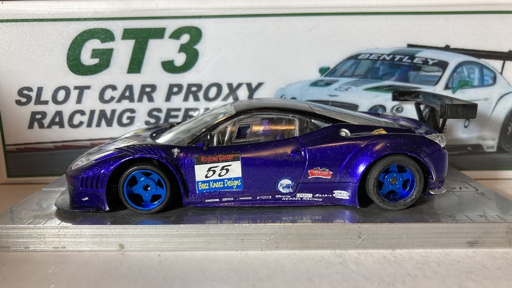

Weston’s Garage #55
Body: Black Arrow
Chassis : Stock BlackArrow
Motor: 22,000 (NSR) (B/A) Long can
Gears: 13/30
Suspension: Blue hard springs (B/A)
Front Hubs: Staff 15x8
Rear Hubs: Staff 15x10 air
Front tires:B/A zero grips
Rear tires: NSR 5230 super grips
Guide: Black Arrow
Braids: NSR
Tune: WestonsGarage
Paint: Westons Garage
Decals: Westons Garage
[Image: C6780-FEB-0695-4028-9-DC3-A52-DD47697-EA.jpg]
[Image: 08571454-4-F35-48-BC-8682-ED4-BB4-D56225.jpg]

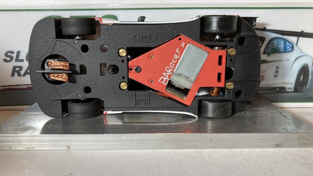

BARacer #68
Body: Scalextric Aston Martin Vantage GT3
Chassis: Slot.it 3DP
Motor: Scaleauto S-Can SC-0008b 20k
Config: Scaleauto AW pod
Pinion: 11
Gear: 29
Ratio: 2.64
Guide: Slot.it CH85
Front tire: Slot.it Zero Grip
Front hub: Staffs aluminium BBS 16.9x8.5mm
Rear tyre: NSR Ultragrip
Rear hub: Staffs aluminium BBS 16.9x10mm
[Image: 0-CFE3-FD0-1-DE4-4-C1-D-AEA4-9-C825-C1-B8447.jpg]
[Image: DC45636-F-46-AC-4011-AEA1-DEB5-F5-F176-E5.jpg]

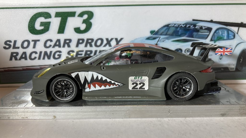

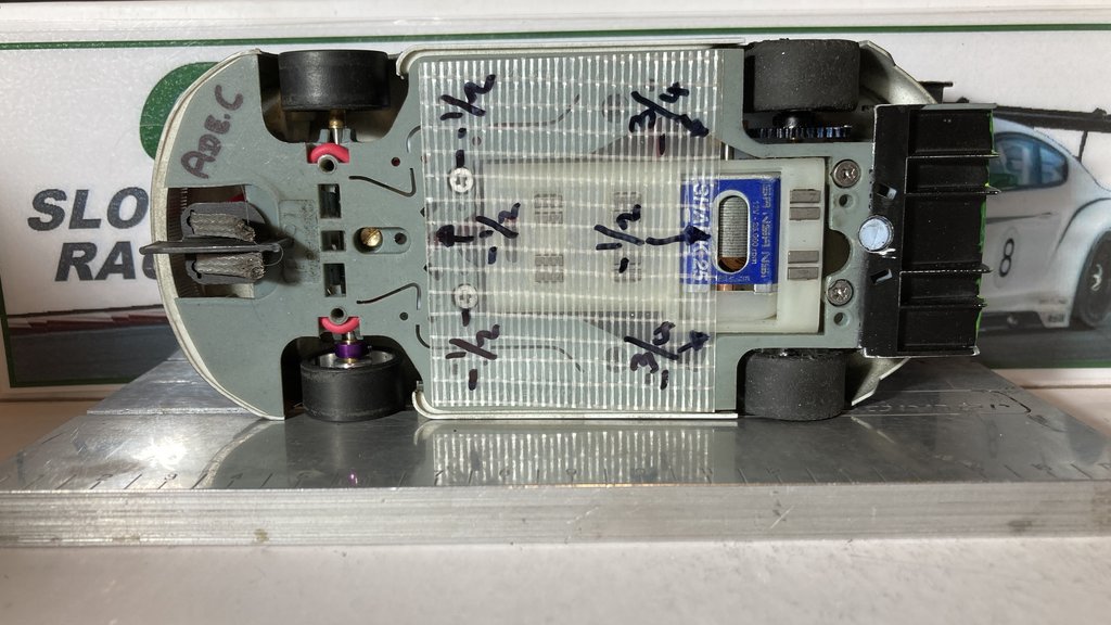

ADE. C #22
Body: Scaleauto Porsche 991.2 RSR
Chassis: Scaleauto grey
Guide: Slotting Plus
Configuration: Sidewinder
Motor: NSR Shark 25
Gears: 11/32
Front Hubs: Scaleauto
Rear Hubs: NSR
Front Tires: Scaleauto
Rear Tires: NSR Ultragrip
[Image: DC7-A4-EE0-6-AB4-4534-B89-D-BB555-B7-E0928.jpg]
[Image: 210-CF1-AC-9795-4-CAD-B9-AA-588-FCACB344-A.jpg]

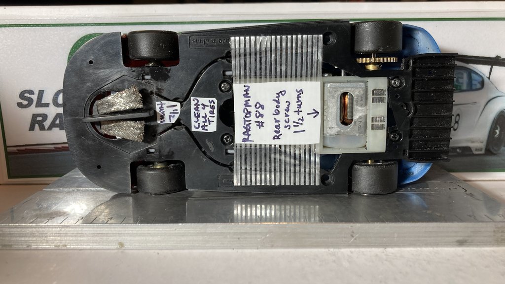

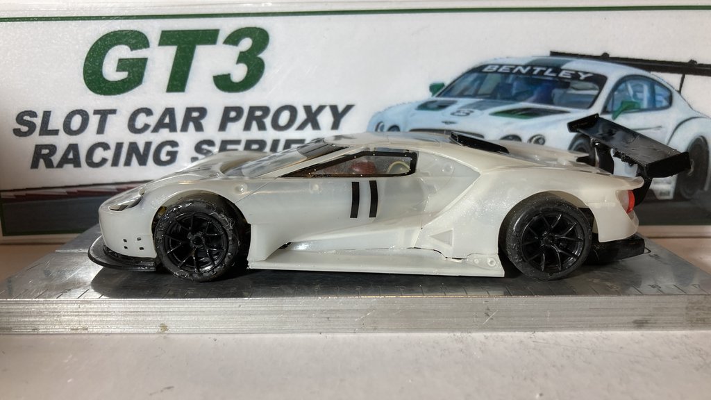

Ragtopman #88
Body: Sideways Ford GTE
Chassis:Sideways/Slot-it
Guide:Sideways/wood
Configuration:SW 1.0mm offset
Motor:NSR 28K
Gears:11/35
Front/Rear hubs: CBD racing 15X8 and 15x11
Front tires:Thunderslot
Rear tires: NSR Ultra
[Image: 9-D49-DC90-1-C4-C-4204-9716-284-E0-DBACE38.jpg]
[Image: 85818472-1351-49-AF-8-E34-E122562-D5130.jpg]

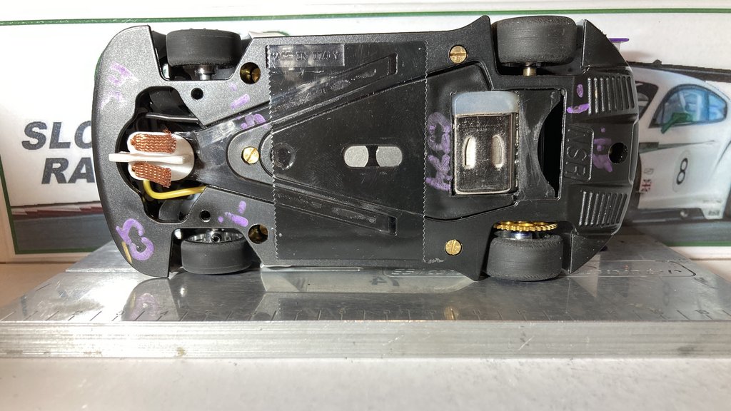

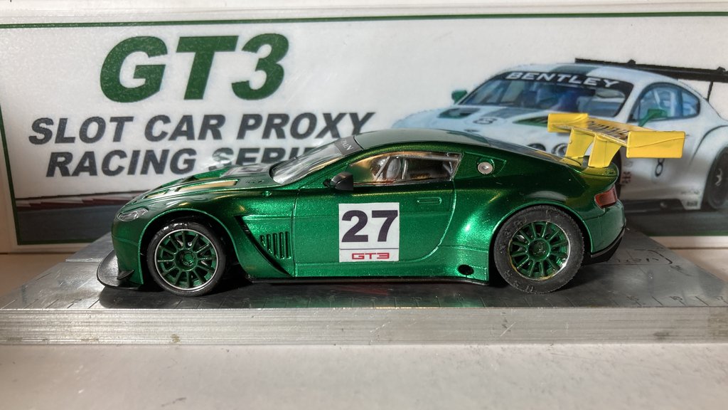

53BN1 #27
Body: Aston Martin Vantage
Chassis: NSR Black
Guide: NSR stock
Configuration: SW NSR Pod
Motor: NSR Shark EVO 25
Gears:11/32
Front Hubs: NSR 8 x 17
Rear Hubs: NSR 11 x 17
Front Tires: NSR coated with nail polish
Rear Tires: NSR Supergrip 12 x 20
[Image: 1-A614365-B645-4-B05-9-F66-E74-F39-B0924-C.jpg]
[Image: 2-E8-BACD1-1-DF4-44-C7-B7-ED-3842675622-C7.jpg]

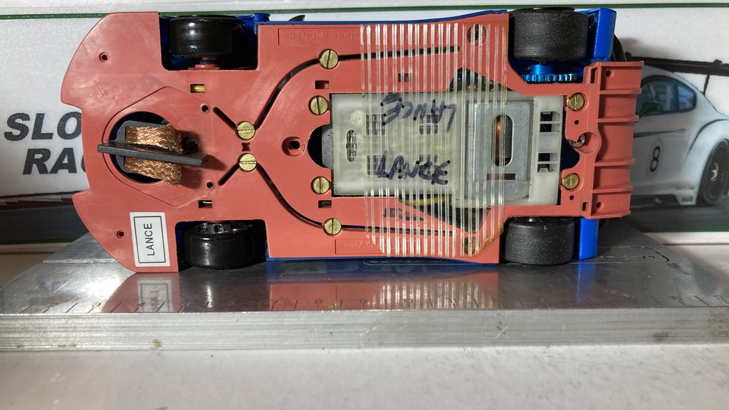

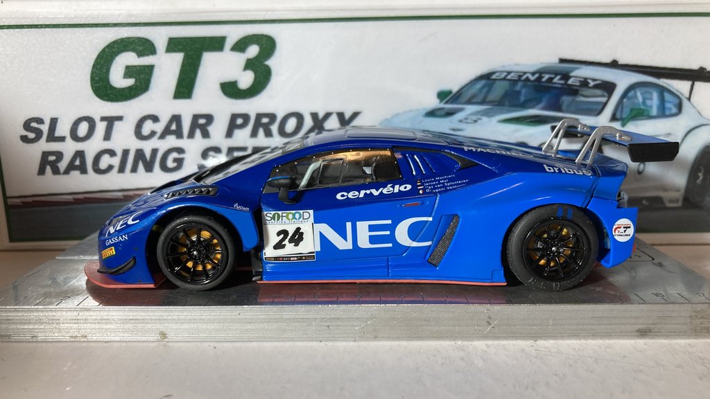

Lance #24
Body: Lamborghini Sideways
Chassis: Sideways Red "hard"
Configuration: Sidewinder 1mm offset Pod
Motor: NSR 30K
Gears: 11/34
Front Hubs: Independent axle
Rear Hubs: CBD 15x10
Front Tires: NSR zero grip front coated
[Image: F2-D5-F22-F-E94-D-424-E-BFBE-3-D1-F7-BDA9764.jpg]
[Image: 9-BB53844-46-D9-4-BA6-92-EA-C3-FE9-BC0-FF9-D.jpg]

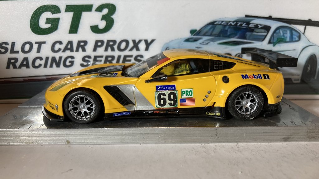

Austin #69
Body: NSR Corvette C7
Chassis: NSR Black
Motor: NSR Shark 28 Evo
Gears: 11/32
Front Hubs: NSR
Rear Hubs: NSR
Front Tires: NSR
Rear Tires: NSR
[Image: CC202968-D689-4701-B820-8-FAD2-FA7-F923.jpg]
[Image: E6-ACB064-CD27-42-F2-A972-1-F7-FF8-F79708.jpg]

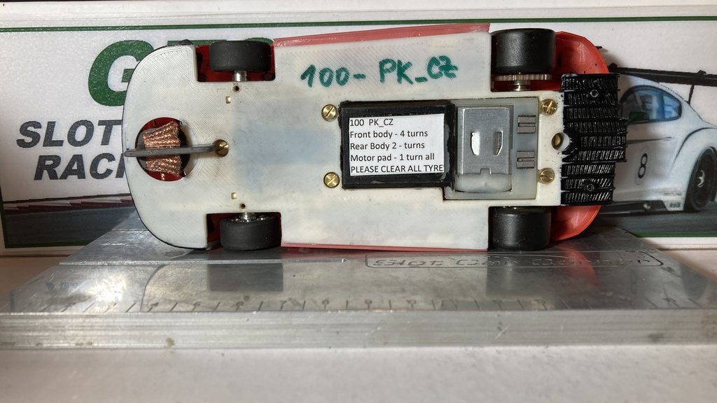

PK_CZ #100
Body : Sideways Ford GT
Chassis : Own 3D FDM
Guide : Sideways wood
Motor : Slotit 29k
Gears : 10/34
Configuration : sidewinder Slotit pod 1mm offset
Front hub : NSR
Rear hub : JEEMARTIN 16 x 12
Front tires : Zero Grip Slotit
Rear tires : Scaleauto F1 AS25
[Image: C1547367-A2-DD-487-E-9107-250-D94-F8-B19-C.jpg]
[Image: F9-F1261-F-3-E7-C-4421-8533-50-E1-E3-A60130.jpg]

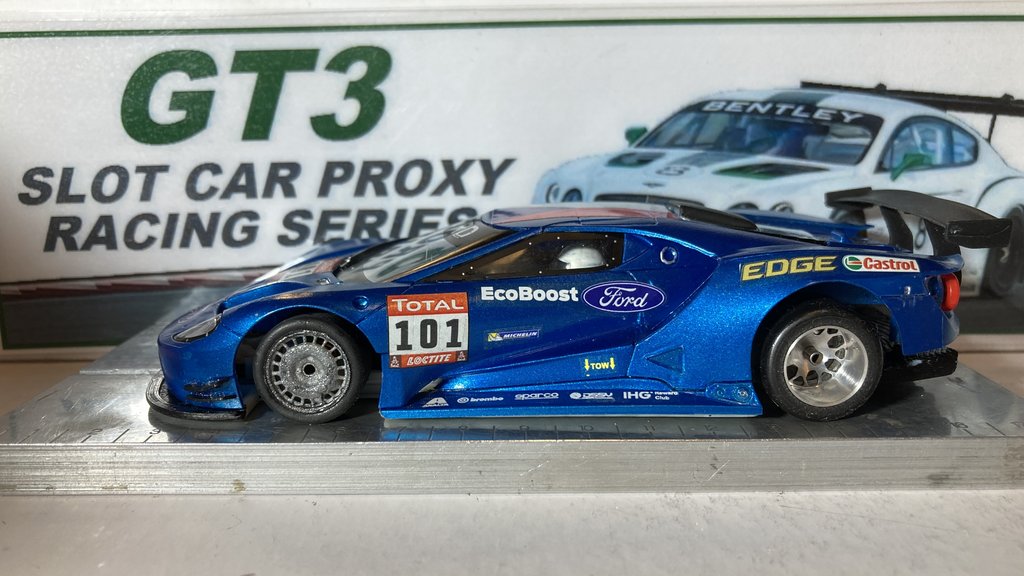

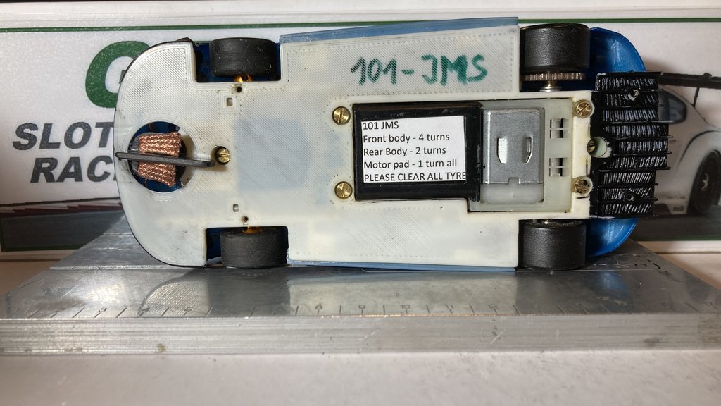

JMS #101
Chassis : PK_CZ 3D FDM
Motor : Slotit 29k
Gears : 10/34
Front hub : 3D Black Arrow
Front tires : Zero Grip NSR
[Image: AB67-E86-F-0506-4-B1-D-89-C5-4-AA2-C99-DA349.jpg]
[Image: 61743848-75-F0-425-B-B8-AB-D24-E2-F9-F33-BD.jpg]

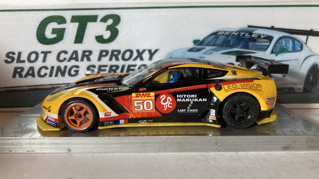

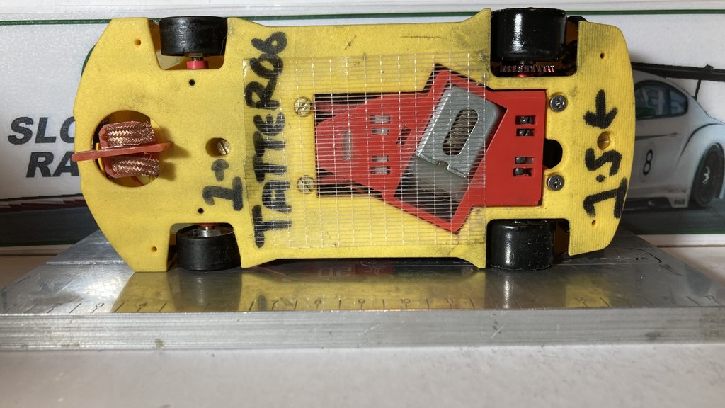

Tatter06 #50
Body: NSR Corvette C7R
Chassis: Amato 3D for Slot.it Pod
Guide: Scaleauto
Configuration: AW Slot.it Pod
Motor: NSR Shark 25
Gears: 11/30
Front Hubs: MR Slotcar 16.5
Rear Hubs: NSR air 16
Front Tires: Slot.it zero
Rear Tires: BRM F15
[Image: 5-F60-CA6-D-1593-49-FA-8754-AD9531496140.jpg]
[Image: B85-DD462-39-B0-4-BF4-94-AB-1-BFA1-D56-E88-A.jpg]

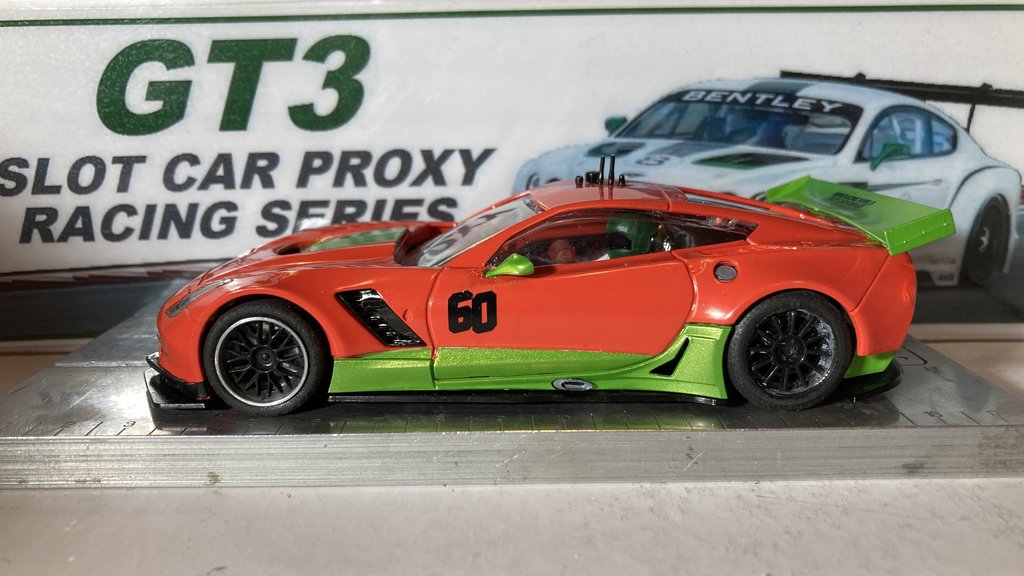

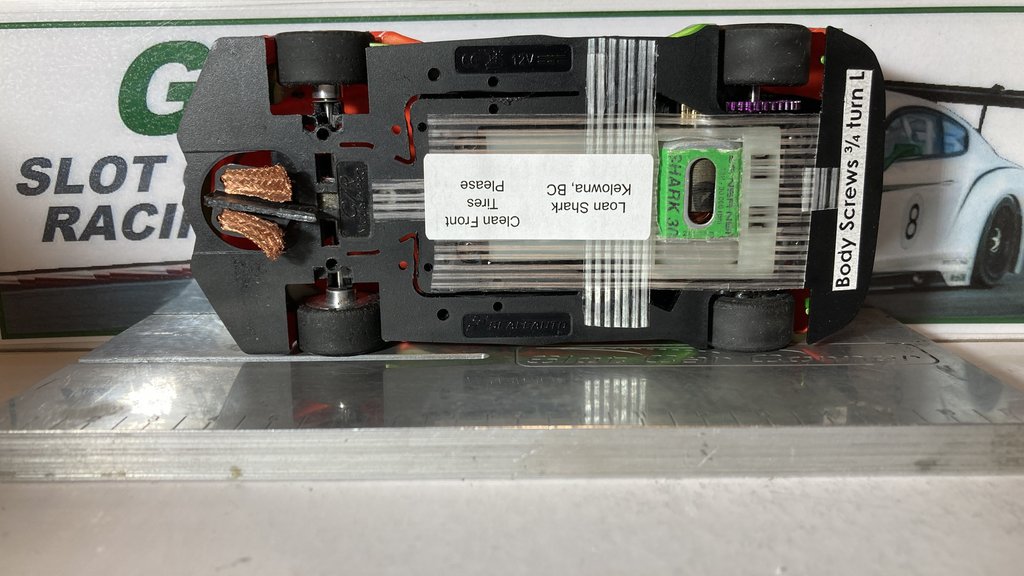

Loan Shark #60
Body: Scaleauto C7R white kit, lexan interior and windows
Chassis: Scaleauto black with cut rid stiffeners
Guide: Sloting Plus EVO wood guide, NSR racing braid
Configuration: SW Slot.it 1mm offset pod
Motor: NSR Shark 30k, glued
Gears: Slot.it 11/36
Front Hubs: Scaleauto 15x10
Rear Hubs: NSR 17x10 air hubs
Front TIres: NSR Supergrip 15x10, untreated. Need to be cleaned.
Rear Tires: NSR 5215 Ultragrip 20.5x11.5
Weight 81 gms, lead under front axle and in pod.
Location: Kelowna, BC, Canada
[Image: 2-DBC195-D-26-DF-4-E90-9750-EE5-FB43-E9-E74.jpg]
[Image: 5467-F499-BB12-40-DA-B348-191-A9391-E4-AA.jpg]

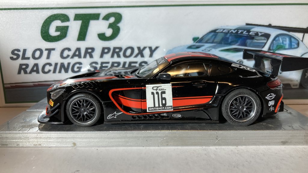

Woodcote #116
Chassis: NSR Black
Guide: NSR Wood
Motor: NSR Shark 25 Evo
Gears: 11/32
Front Hubs: NSR 17x8
[Image: B6423-DE5-5-E87-4-CB8-8-CD0-F28-E6-E81-BB1-F.jpg]
[Image: F268-A7-FD-4-F3-D-4-C0-F-84-B9-69-B9-F93363-C2.jpg]

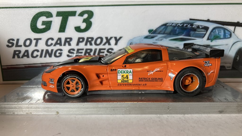

Lez #54
NSR Corvette
Motor:NSR 25K
Gearing:11/31
Front wheels:NSR
Rear:NSR Ultra
Guide:Custom made
Chassis:Lexan custom made
[Image: C8-A2-B85-A-DAC2-4306-9-FEC-D13-A004-C48-B2.jpg]
[Image: 30910-CED-6-C9-F-4-A84-BD64-2-F551-BB841-FC.jpg]

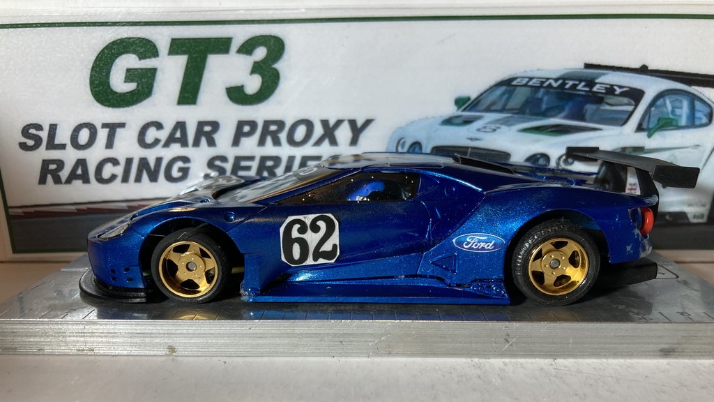

Pepsi 62 #62
Sideways GTE,
NSR 25K FC130 in Sideways hard AW pod.
11/27 gearing,
Staffs 15 x 10 air wheels
rear with Thunderslot TS004 glued and trued,
15 x 8 Staffs with NSR zero grips,
Lexan interior
[Image: 72-C01451-E2-CA-4943-8-D56-FB4-D421-FA374.jpg]
[Image: 4-A103-C25-78-AA-402-E-93-A2-D127660-AC613.jpg]

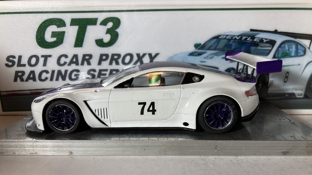

CJ74 #74
[Image: 45-CE8447-074-F-485-C-834-B-72-CDAC973-F47.jpg]
[Image: AB38-EEF0-0164-4-C9-B-B9-E9-5-AFBF4343-D5-D.jpg]

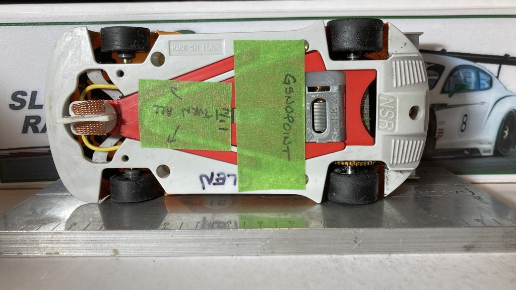

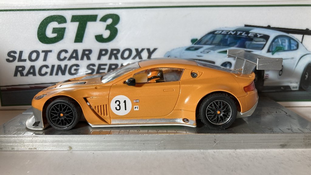

GSNOPOINT #31
Body: NSR ASV GT
Chassis: NSR white "hard"
Guide: NSR wood
Configuration: Sidewinder NSR Pod
Gears: 12/34
Front Hubs: NSR
Rear Hubs: NSR
Rear Tires: NSR
[Image: 8-D565-BB3-0-F98-4-FBF-8758-D0-A53218-F73-F.jpg]
[Image: 6-D09-E792-0050-4-FE6-8-B70-426-E20-B13769.jpg]

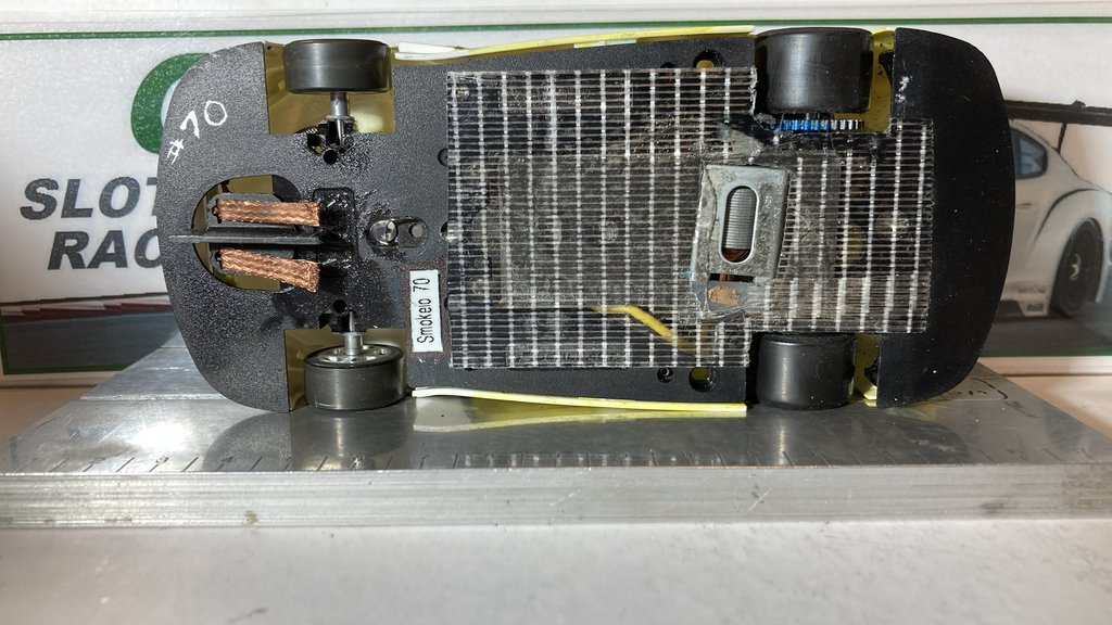

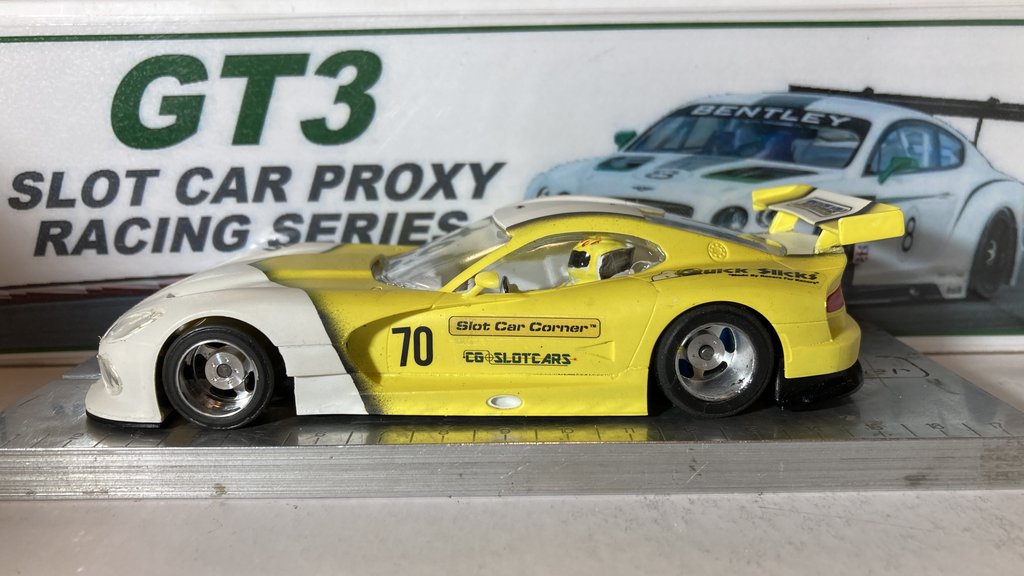

Smokeio #70
Body: Scaleauto Viper (Not a Dodge)
Chassis: Scaleauto hard
Guide: I forgot... Scaleauto???
Braid - NSR Soft
Configuration: Sidwinder
Motor: NSR Shark 28
Gears: 11/34 NSR/Slot.it
Front Hubs: CBD 15x8
Rear Hubs: CBD 15x13
Front Tires: Slot.it zero grip coated in polyacrylic
Pod - CG Slotcars
Pod Hardware - Slot Car Corner
Lead wires - Slot Car Corner
Tape- CARGOFAST Racing Strapping Tape
Oil and Grease - Slot Car Corner Oils
[Image: F5-C8-D400-FEA7-4-ADC-B15-B-D2-BCD62-AA3-B2.jpg]
[Image: F2-A44-EA6-9-BB9-410-F-BDB6-170-D9-A462-DA9.jpg]
