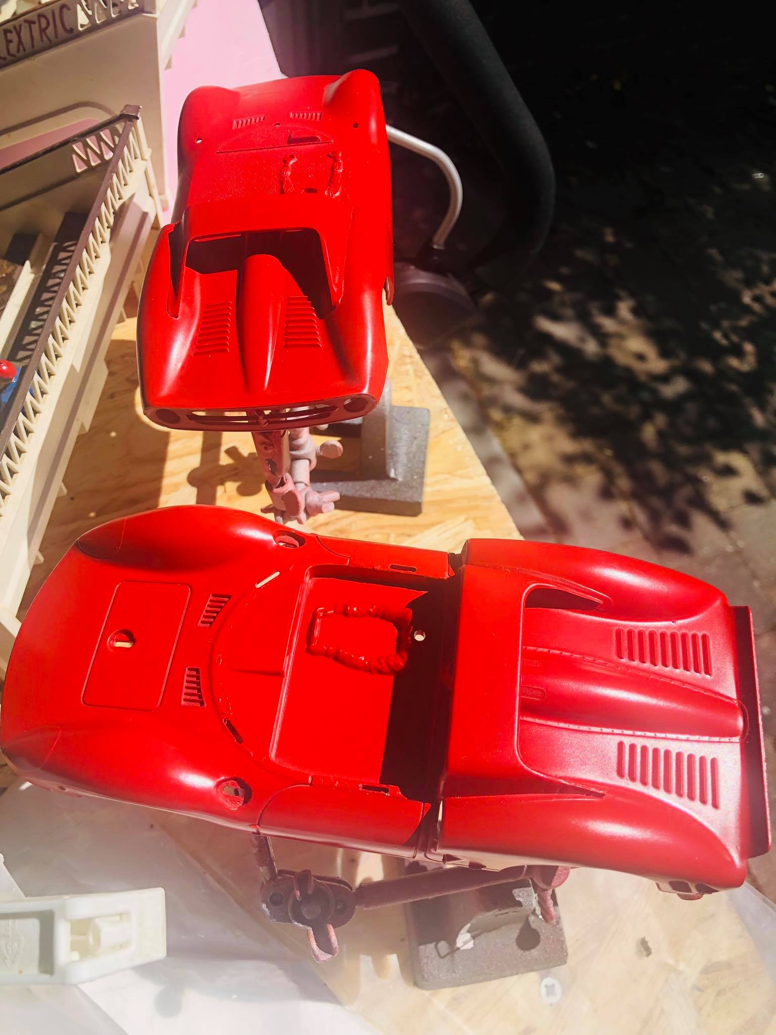

Painted up 2 x 1/24th Ferrari 275 P2 bodies. One is Atlas and one is a mint unused Tamiya car I bought recently.
[attachment=17183]
Tamiya top Atlas bottom.

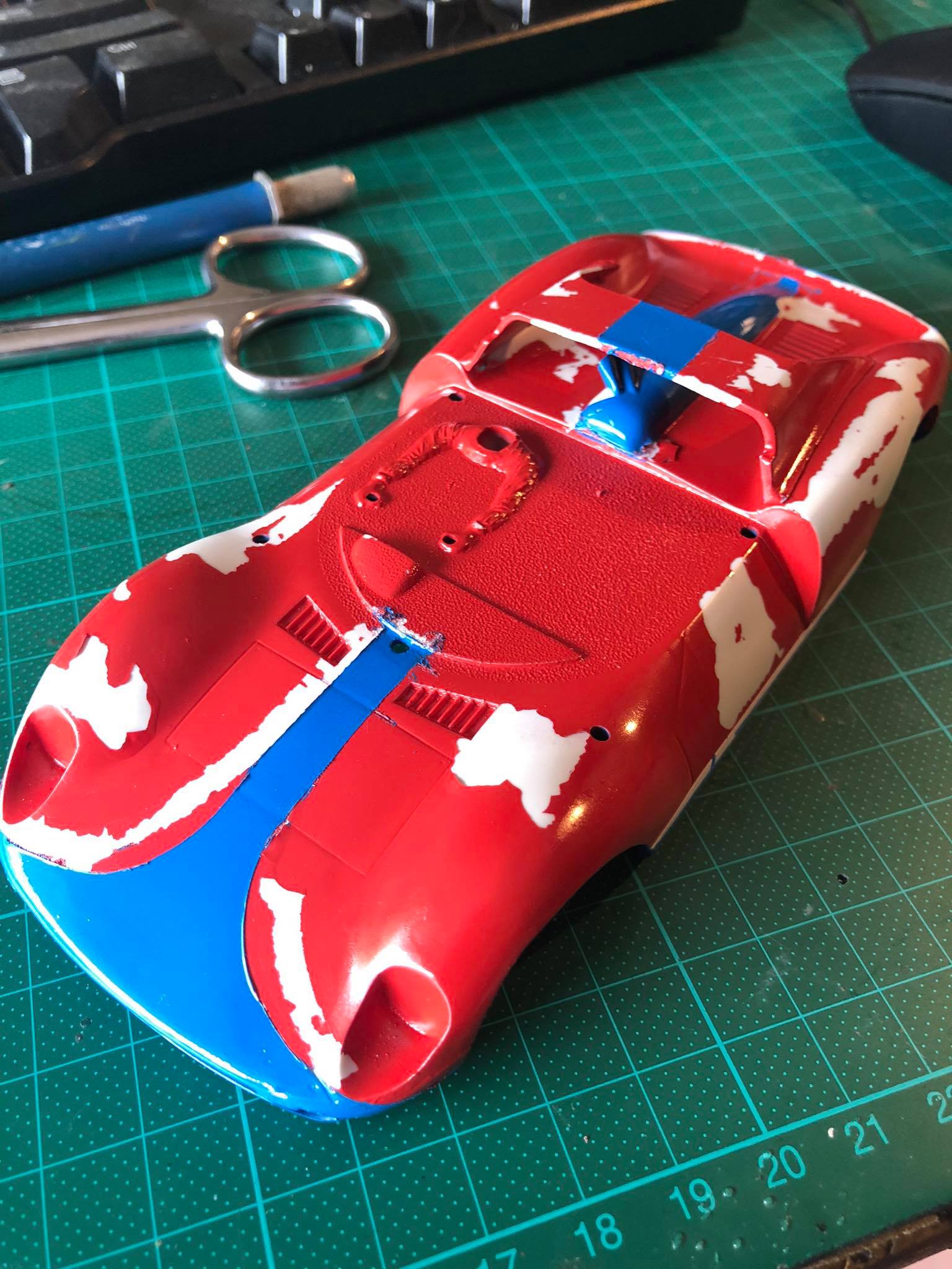

This happened when removing the tape: All paint peeled back to body base.
[attachment=17184]
I did this about 48 hours after red paint, and about 1 hour after blue paint - as I normally do. - This has never happened before.
I have now stripped it back, sanded body for grip and re primered. But I want same colour scheme but and scared to do same process again.
Should I change tape? Wait longer after red paint?  It has been primers now for about a week.
RE: Paint Issues on plastic - Suggestions? - Nico - 20th-Aug-21
The primer did not bond to the body
Did u wipe down the body with a 1200 grinding paper after cleaning the body before using the primer?

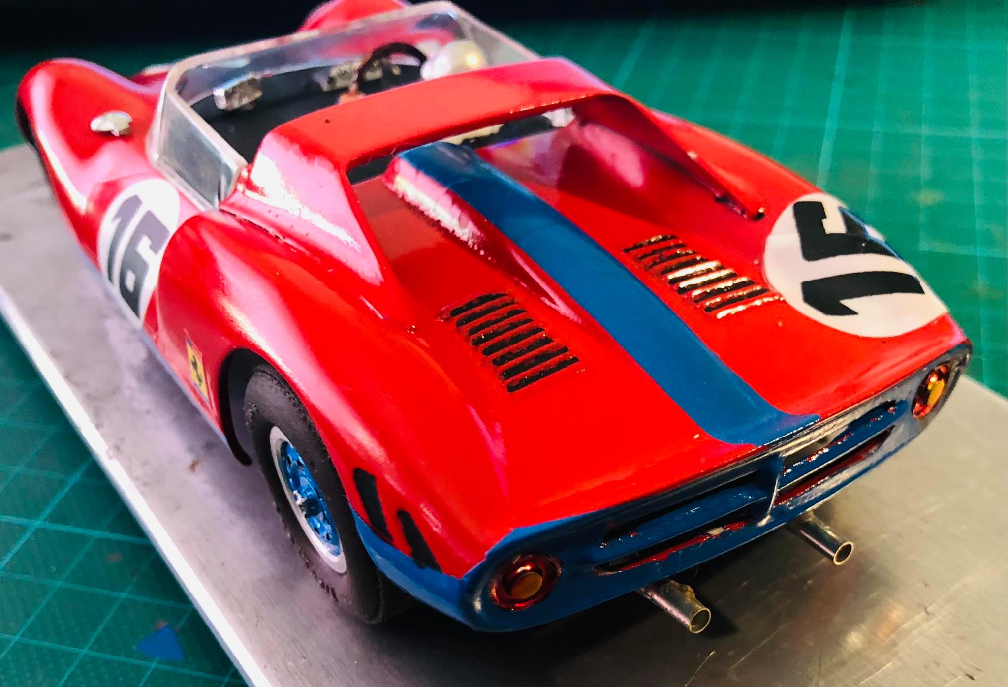

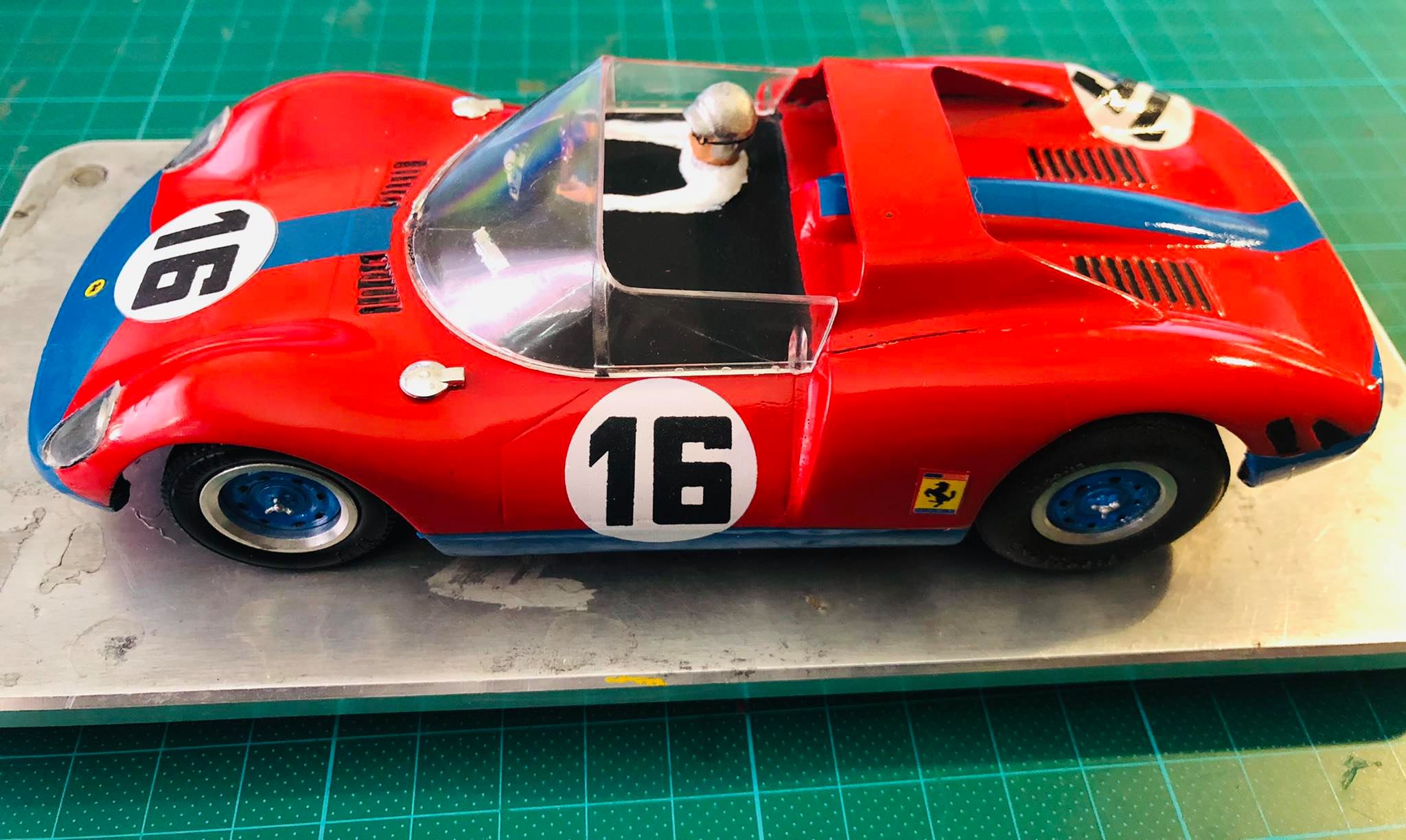

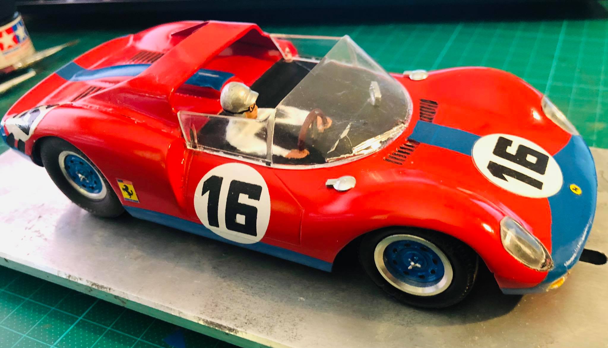

RE: Paint Issues on plastic - Suggestions? - Anthony B - 24th-Sep-21
After Joels brilliant idea, I have finished off this car - looks quite good Cool Rofl
[attachment=18109]                     [attachment=18110]
                        [attachment=18111]
