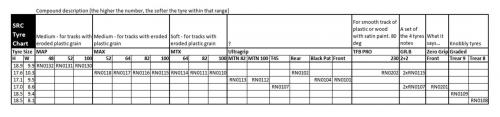

Thought I would have a go at deciphering the range of SRC tyres by categorising them by size and compound...
[attachment=13992]
There are still what appear to be some very subtle differences between compounds, with perhaps some newer ones duplicating legacy ones still available.
Not sure I have unlocked the mystery yet!

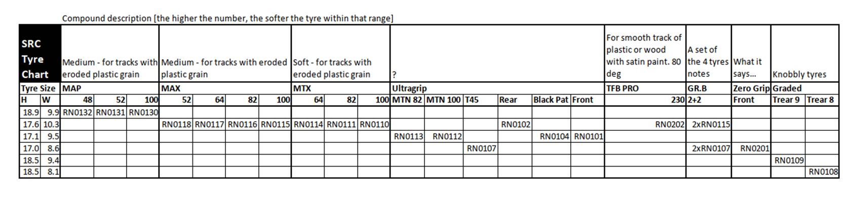

RE: SRC Tyre Chart - rallyhub - 14th-Apr-21
Hi Jeremy,
Here is some more information from SRC about their tyre range:
MTX are virgin rubber tyres.
Black Pat tyres MAP and MAX are rubber compound with paraffin tyres.
The difference between them; Max tyres are waxed for wear delay.
RN0201 and RN0202 are composed of polyurethane.
I hope this will make your tyre choice easier.

RE: SRC Tyre Chart - BAracer - 14th-Apr-21
Thank you Hub.
I saw those descriptions on the website but was not sure whether they were technical terms or oddities from the translation into English. I will update the Chart accordingly.
On the basis that they take their cars so seriously, I was thinking that their tyres might also be little hidden gems that might offer benefits to my other cars and offer an alternative to the usual Slot.it/NSR choice.
