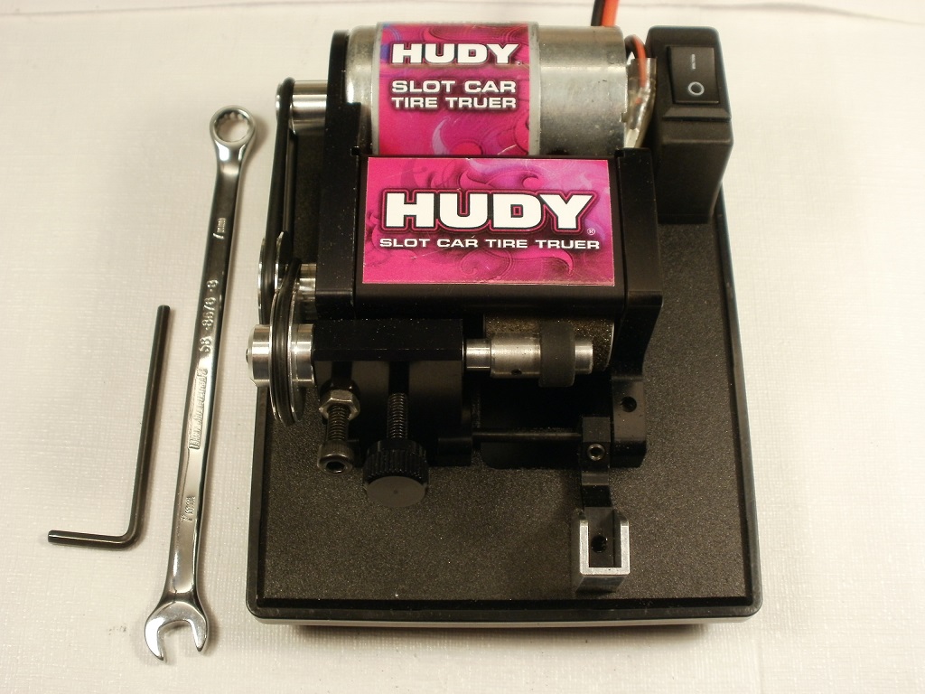

New Hudy HO Tire Truer - KensRedZed - 9th-Apr-21
[attachment=13961]
RE: New Hudy HO Tire Truer - BAracer - 9th-Apr-21
So that looks like mine, but is that a different tyre mounting axle to my 1:32 scale 2.38mm one?
RE: New Hudy HO Tire Truer - KensRedZed - 9th-Apr-21
Jeremy,
Same tire truer as yours. It had to be modified to move the tire post closer to the grinding wheel.

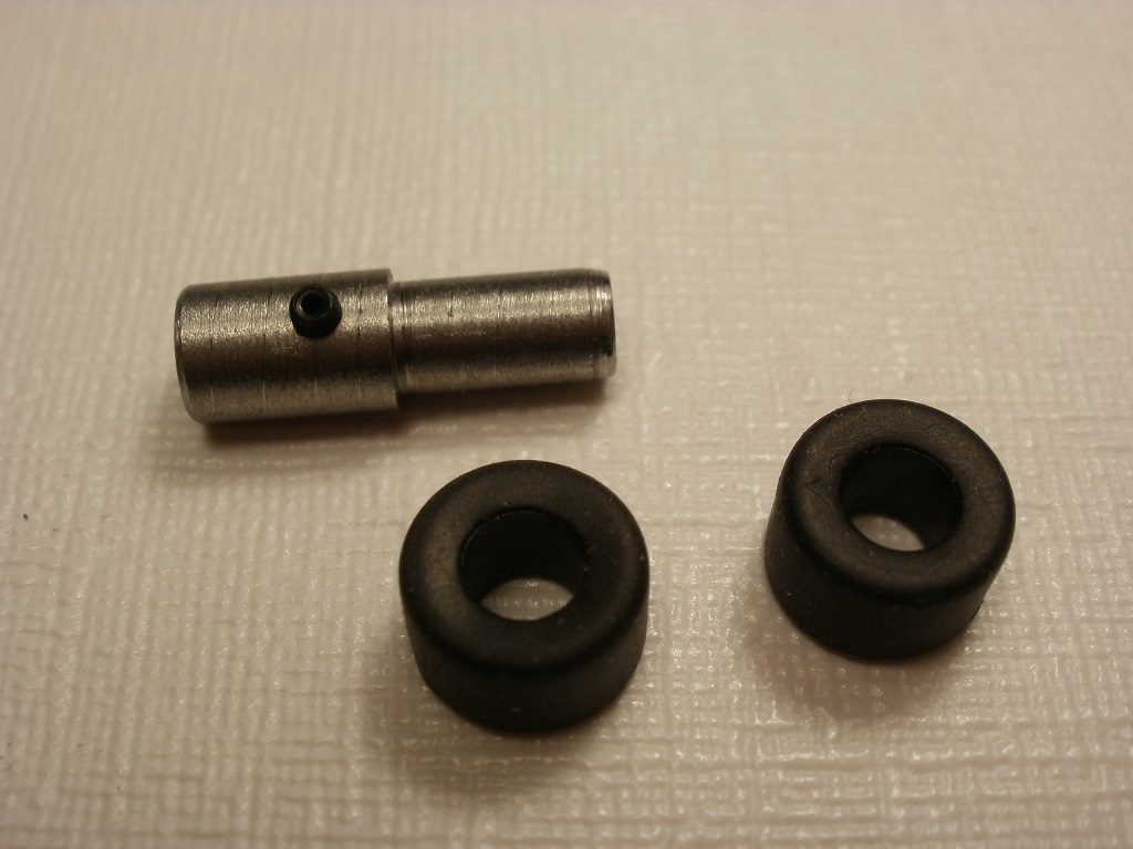

This is the adapter for Tuff Ones tires.
[attachment=13967]
These are custom made. The trick is making sure the 3/32 reamed hole has zero run-out to the outside surface. Or you just create more problems than you solve.
You also need to make them slightly larger in diameter to fully grab the tire.
