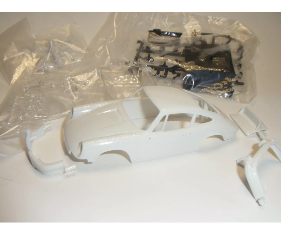

After the Frankencleanertruck semi build, I’ve now ordered another to have a crack at
I’ve gone for the MRRC 911 RS kit below
[attachment=13733]
I made a right mess of the paint job on the Franken, so does anyone have any tips on how I can get a showroom finish on this?
Also, does anyone know what chassis would be best to mount it on
Thanks
Rob

if you are looking to make a competitive track car you have 2 main options for a chassis.
1. The modern way is a made to measure 3d chassis
https://www.shapeways.com/product/KG2PZ4TNZ/3d-chassis-mrrc-porsche-911-inline
These can sometimes be sourced in Europe which lowers the postage cost
2. The old school way is an adaptable chassis like the slot.it HRS2.
http://mre.co.uk/catalogue/slot-it-hrs2-rtr-inline-chassis-p106495.html
Using hrs2 is a bit more work because the body is not typically mounted by the body posts.
The link above is the complete hrs2 kit but you can buy just the chassis and use your own running gear.
My entry to this year's winter rally proxy was HRS2 based.
The old-old school way is to use a brass chassis.
I'm afraid I don't have any experience on brass chassis construction.
Alan
RE: Another build - need some tips please -
autoavia - 30th-Mar-21
You could probably use a Penelope Pitlane or RS Slot Racing brass chassis
A PCS chassis will fit but I am not a fan of the cjhassis although you might be quite happy with it.
Amato Slot Car Design, who are in the Traders thread, make an adjustable 3D chassis which could probably be made to fit
There is a 3d chassis specifically for the car in the link below but it isn't cheap
https://www.shapeways.com/product/KG2PZ4TNZ/3d-chassis-mrrc-porsche-911-inline?optionId=168272646&li=marketplace
There are probably other alternative 3d printed adjustable chassis as well.

Thanks for the really helpful replies everyone.
I’ll probably go for the shapeways chassis, cost isn’t that bad to the uk.
Re paint tips - patience isn’t my greatest strength (hence the shite paint job on the previous attempt) but I’ll give it a go on this nine as I’d like it to be as good as possible.
Should I sand between each coat with wet/dry or after all coats have been applied?
Rob
