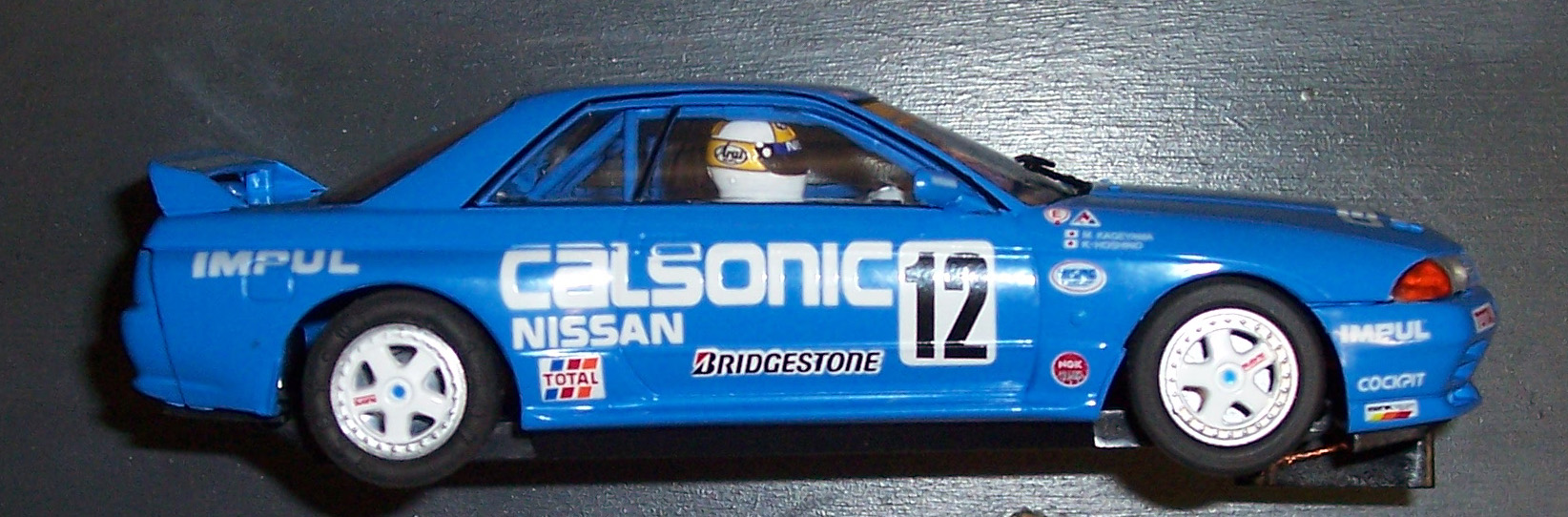

The driver is a bit odd. He is nicely decorated with helmet and overalls both carrying sponsor logos but is way too tall. His helmet is jammed against the roof above the roll cage and the poor chap would suffer severe injuries in a rollover.
[attachment=13127]
It looks near scale and the sponsor livery seems to be spot on but I am not entirely sure that the colour is 100% accurate as it it is a lighter shade of blue than expected. Colours can be deceiving on web photos of the real thing but they look to be a deeper shade than the model. Here is a comparison shot with the Takata/Scalextric Calsonic 250Z which is more like the colour I would expect:
[attachment=13102]
Slot.It are usually pretty good with colours though so I could be completely wrong about it.

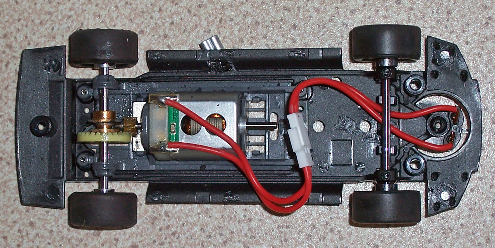

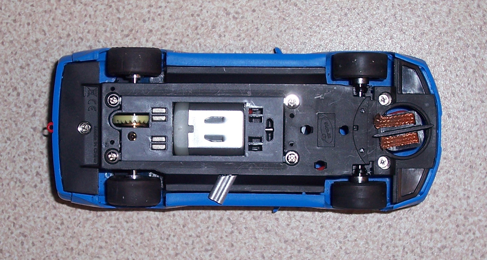

All mechanical parts motor, gears etc are identical to the current DTM cars but the chassis is slightly different in that it is stepped rather than the usual flat ones. The wiring harness also has a white plug and socket arrangement which I assume is to enable easy digital chip fitment.
[attachment=13105] [attachment=13107]

The track is a couple of mm narrower than the DTM Merc and it is two grams heavier. The stepped chassis would indicate a slightly higher centre of gravity so my initial thoughts were that it wouldn't be as fast as the Merc but I was very pleasantly surprised when I gave it a run.
After minimal preparation (oiled the relevant bits, slackened the chassis and pod screws, changed the standard tyres to F22s and ran it in for half an hour) it instantly put in consistent 5.4 second laps on my 50ft track with no trace of any nasty handling characteristics. Pushing the envelope got it down to low 5.3s and this is almost identical to the performance of the Merc. Ever so slightly faster in fact. At the extreme edge of my limited talents it would roll rather than snap sideways like the Merc but I try not to go there too often. Straight out of the box this is a really superb bit of kit and you can't say that about several other slot cars on the market. A few tweaks and modifications would no doubt improve it further for serious competition but for home use it is near perfect. Well up to Slot.It's usual standards and an object lesson in slot car manufacture to some other makes I could name.

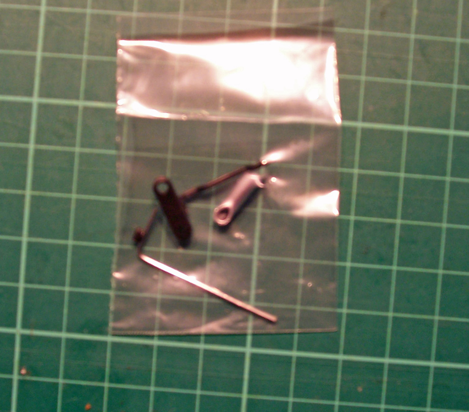

The usual bag of bits under the plinth contained a couple of grub screws/allen key for the front axle plus a black bit of bent plastic and a silver pipe thing. No idea what they are for, anybody know?
[attachment=13106]
RE: Slot.It SICA47b Nissan Skyline GT-R #12 JTC - rallyhub - 8th-Mar-21
Nice review, Brian. Thumbup
I think that grey pipe can replace the existing twin pipes.
Maybe Nissan has used both exhaust types for their racing Skylines.
The black strip with bended part is a part for fastening a digital decoder.
The other parts are not clear to me.

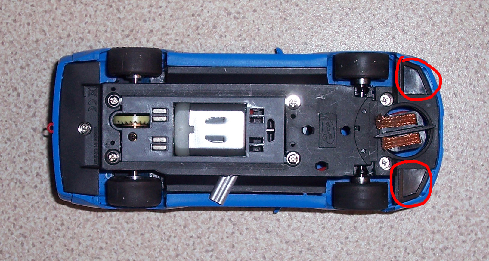

RE: Slot.It SICA47b Nissan Skyline GT-R #12 JTC - Savage GT - 9th-Mar-21
[attachment=13172]
Those.
on mine set so I don't use them, you would need smaller front wheels and/or have them tucked right up into the arches.
But they do add a tiny bit of extra weight below the axle line, every little helps  Rofl
RE: Slot.It SICA47b Nissan Skyline GT-R #12 JTC - CMOTD - 9th-Mar-21
This is what I know as a slider. [attachment=13180] Tastes a lot better than bits of plastic.
I thought those things on the chassis were fixed in place but now discover that they are removable - you learn something every day in this hobby. Is this a new thing? What exactly do you do with them once you have taken them off?
