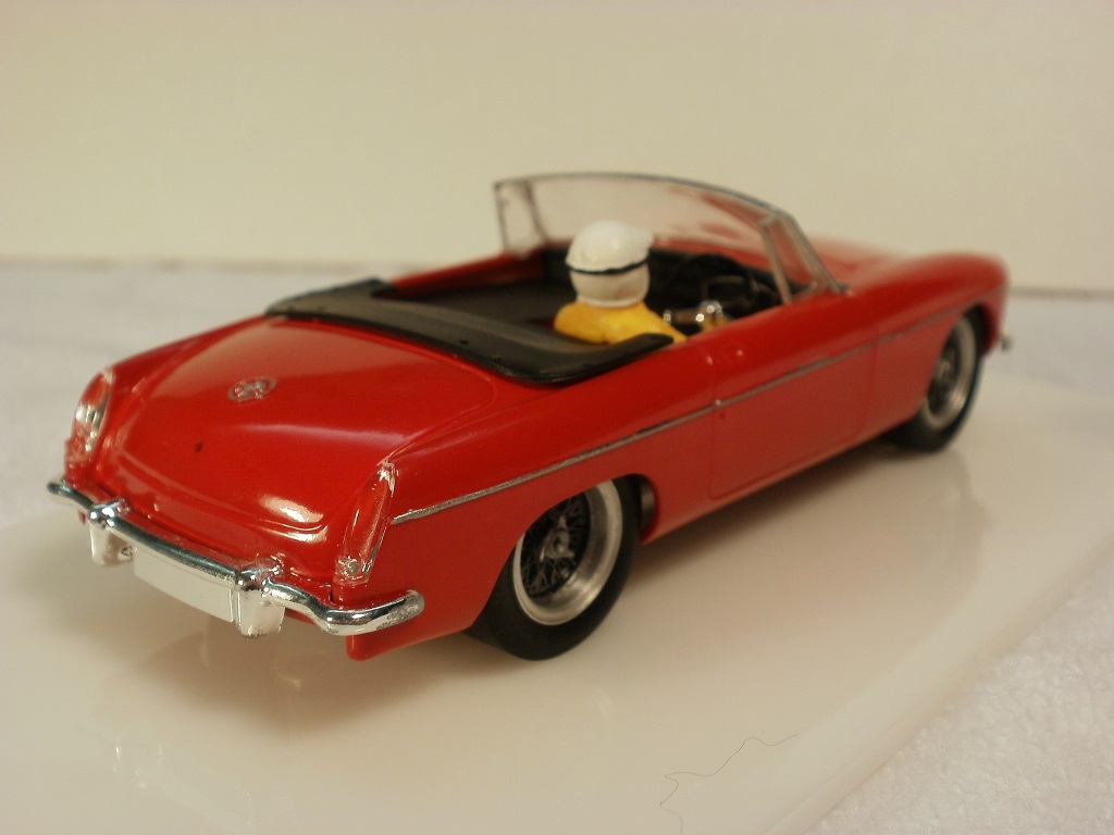

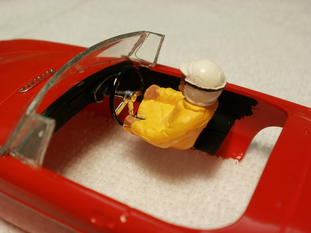

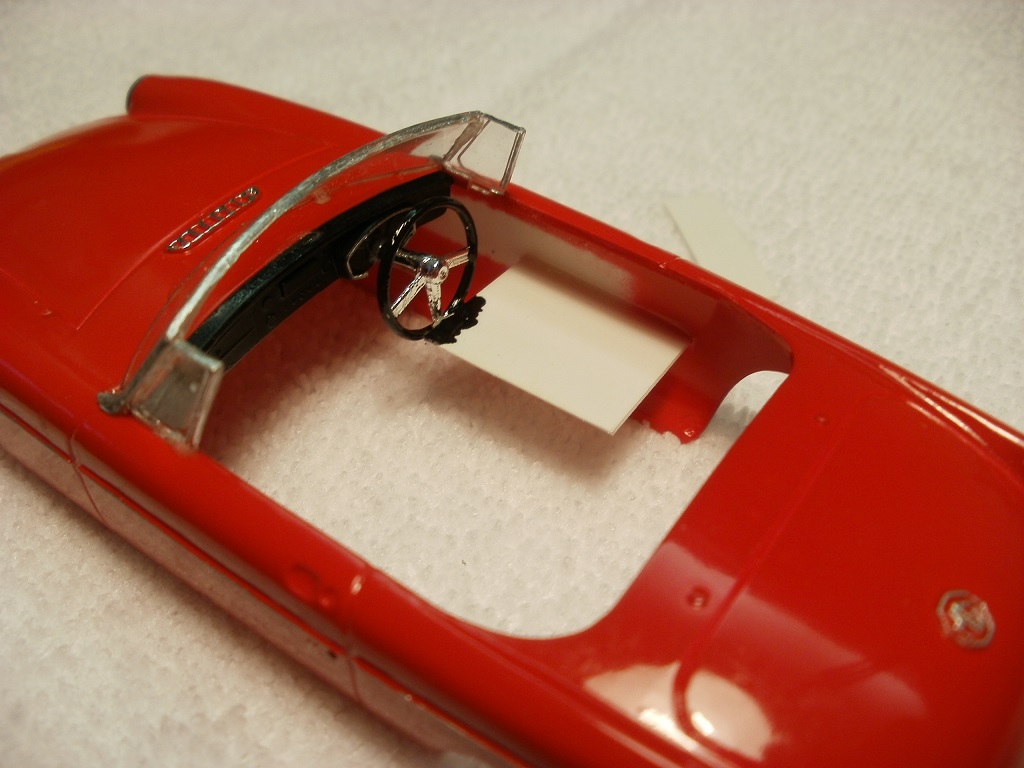

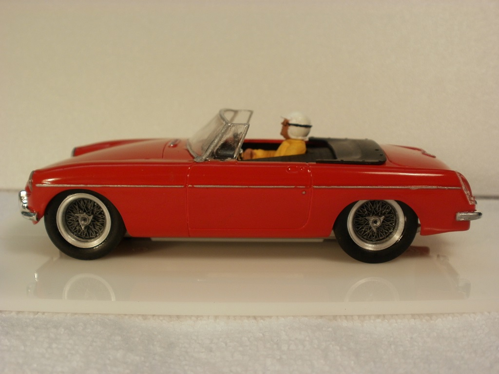

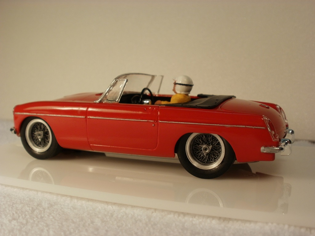

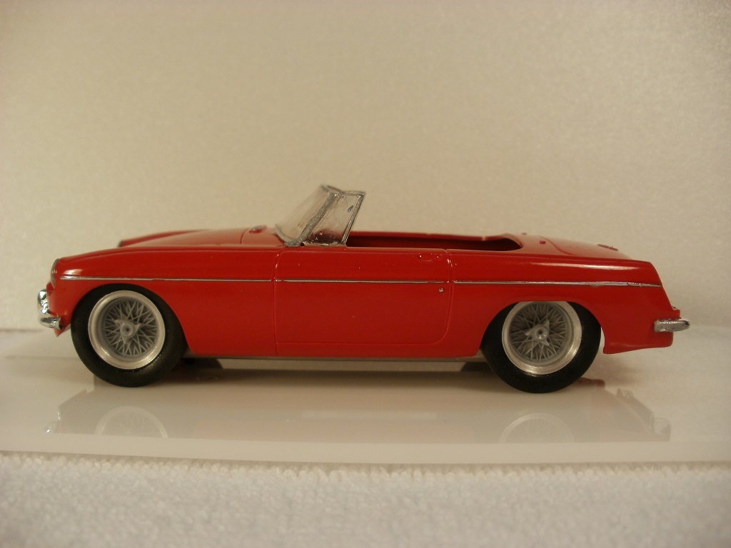

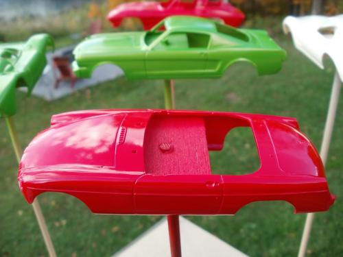

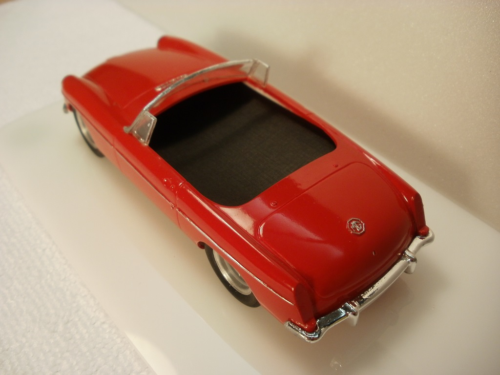

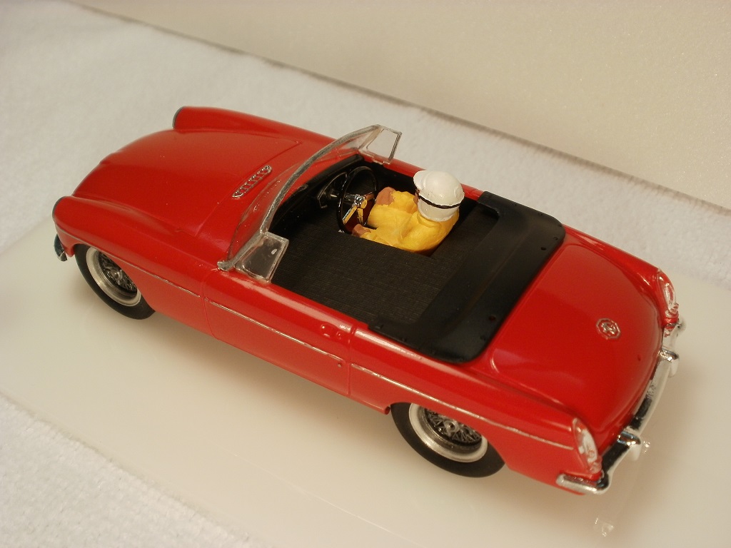

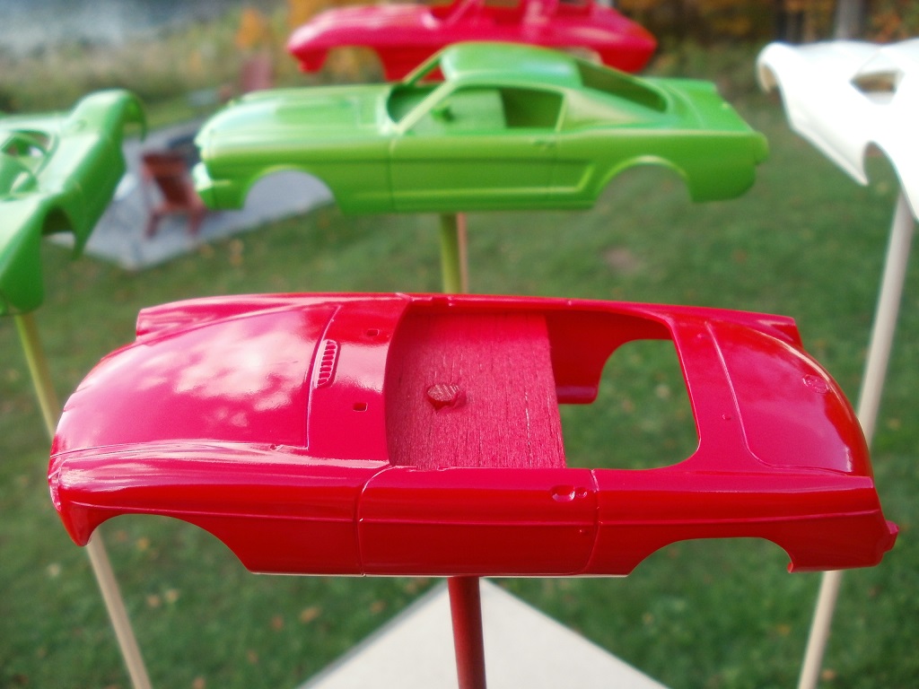

I know that British sports cars are not very popular on this forum. But, I thought I would post this build anyways just in case at least one person likes these cars.  Thumbup
I like converting Airfix static kits into slot cars. They are often a bit narrow. But they look nice when completed.
[attachment=11595]
[attachment=11596]
[attachment=11597]
[attachment=11598]
[attachment=11599]
[attachment=11600]
Interior coming together.
[attachment=11601]
[attachment=11602]
[attachment=11603]
[attachment=11604]
[attachment=11605]
[attachment=11606]
[attachment=11607]
[attachment=11608]
[attachment=11609]
I was not very happy with how the clear head light and tail light lenses came out. Or the chrome body molding. I need more practise and a steady hand. It keeps me humble.

RE: MGB Sports - KensRedZed - 18th-Jan-21
Thank you very kindly, Jason and Rallyhub.
I agree the width of this car is accurate to the length.

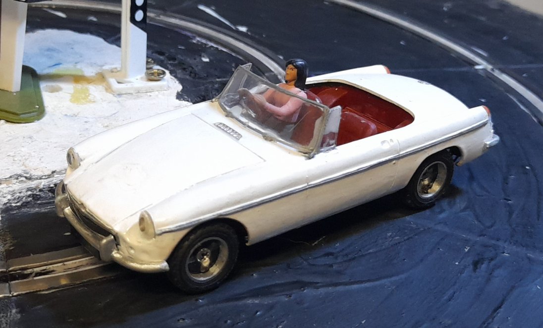

RE: MGB Sports - Scuderia_Turini - 18th-Jan-21
" British sports cars are not very popular on this forum"
Might be some truth in that, but everybody on the planet loves an MGB (surely?)

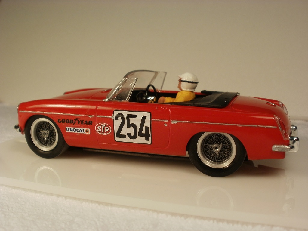

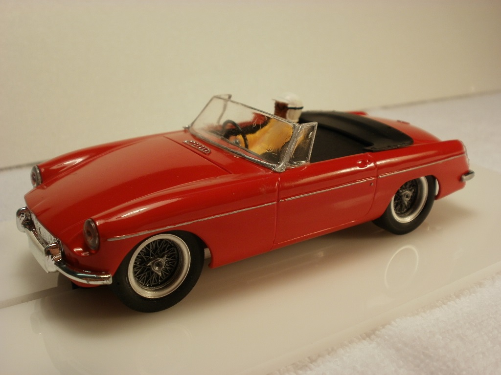

Mine is below,
[attachment=11615]

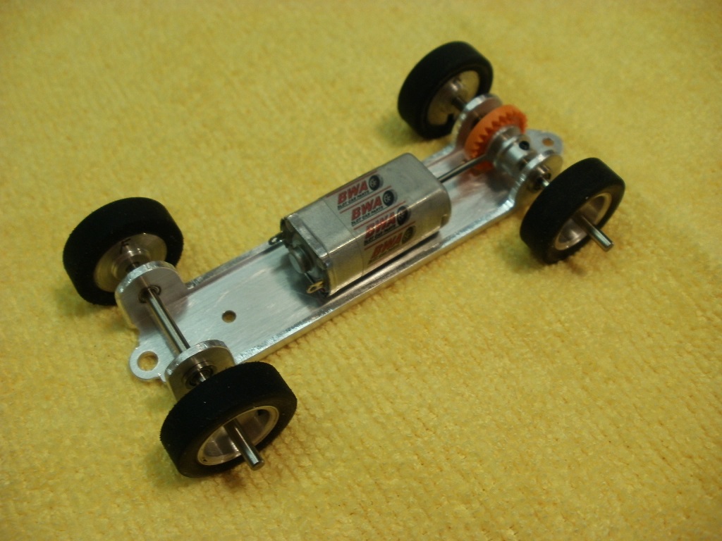

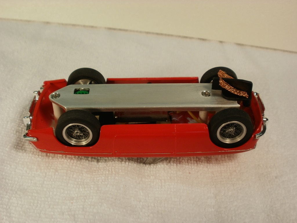

Looks great Ken, what wheels and tires did you use?  How is it on the track?
Nice looking car Leo.  Thumbup
Thank you kindly, Bob.
The wheels are from Colin Sparks of RS Slot Racing in the UK.
http://www.rsslotracing.com/parts.htm
Tires are urethane from DArt Hobbies in Canada.
http://www.darthobbies.com/
If I were to build the car again. I would use slightly smaller wheels. Leo has the right size wheels on his car.

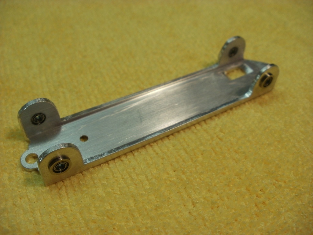

It handled like a poopy roller blade and flew off the track like crazy at 62-grams. Its handles like a dream now at 75-grams. There's no substitute for putting 13-grams of lead 1mm off the track surface. What a difference.
RE: MGB Sports - 73emgee - 19th-Jan-21
(18th-Jan-21, 09:47 PM)KensRedZed Wrote:  The wheels are from Colin Sparks of RS Slot Racing in the UK.
Ken - Do you know what part#'s you used for the wheels and tires???
Thanks
RE: MGB Sports - KensRedZed - 19th-Jan-21
Hi Bob. Glad to help.
The aluminum wheels are RS Slot Racing part# RSW001.
Tires are called "D7" club tires.
I put these on a lot of sports cars.
The plastic wheel inserts are sold separately, and are available from either supplier.

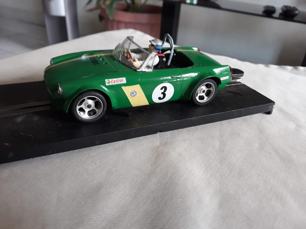

RE: MGB Sports - steveaca - 19th-Jan-21
Here's mine.
