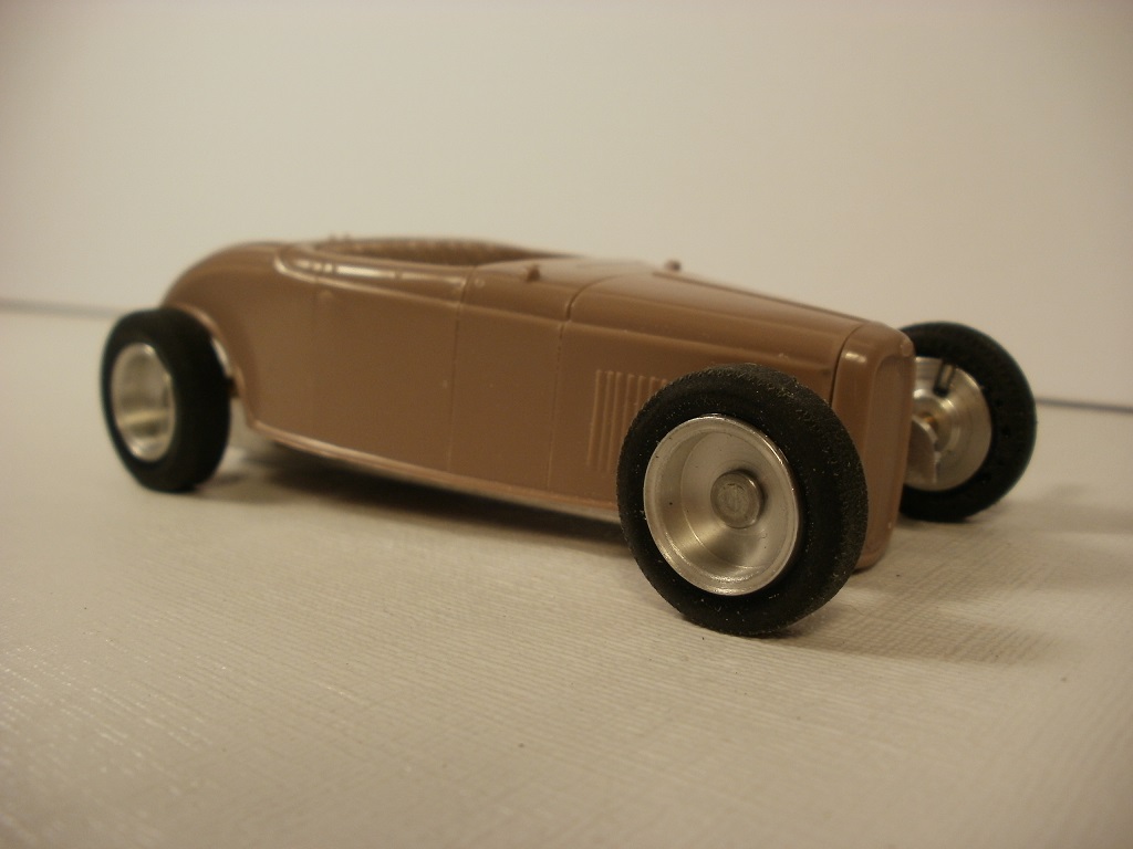

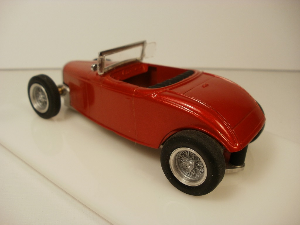

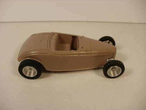

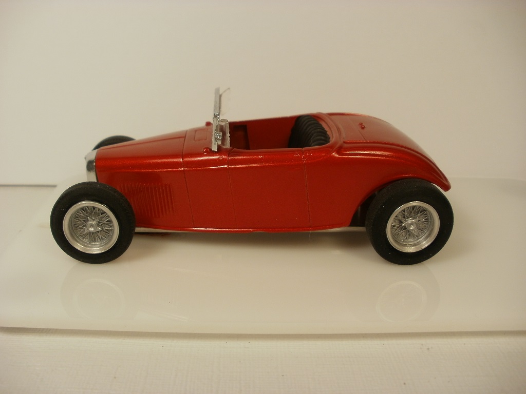

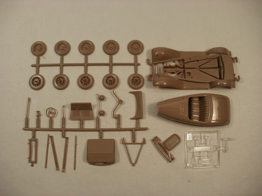

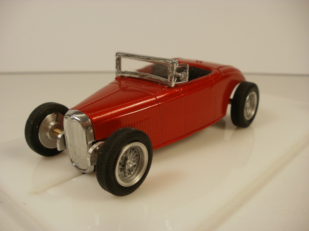

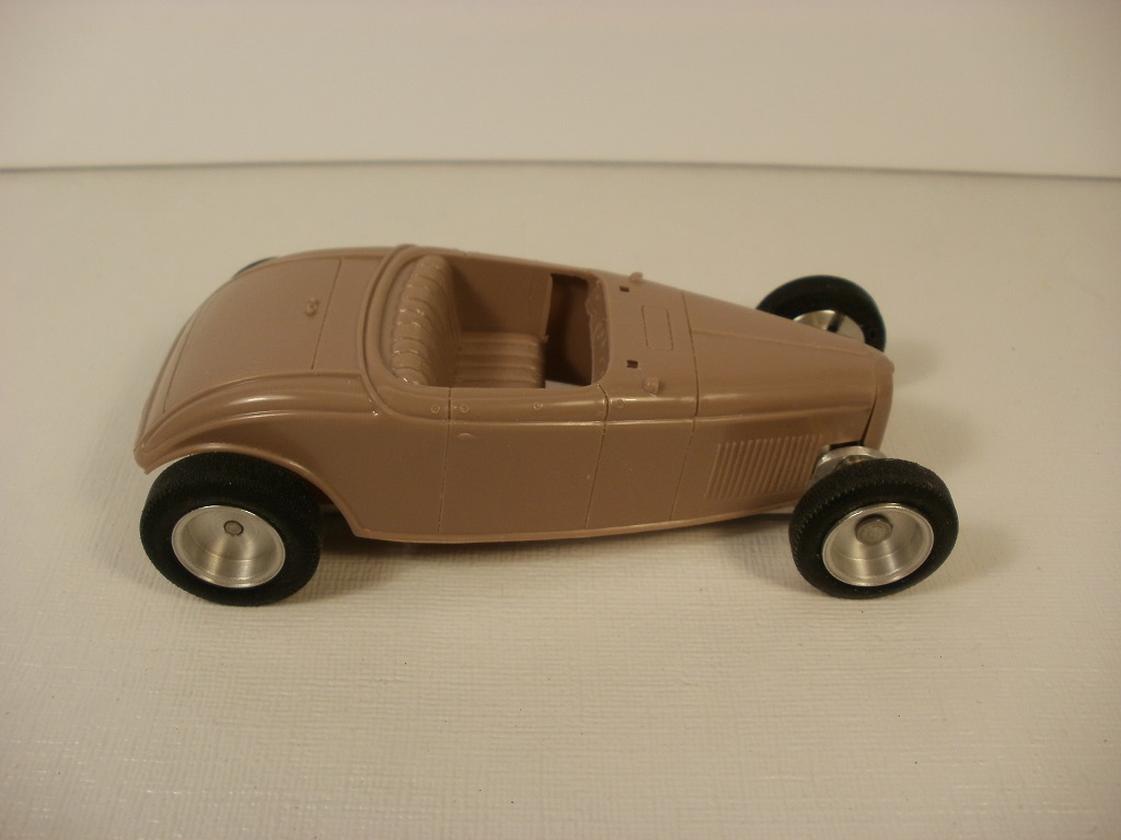

This typical 32-Ford Hotrod started out with a Lifelike dollar store kit.
[attachment=10120]
[attachment=10121]

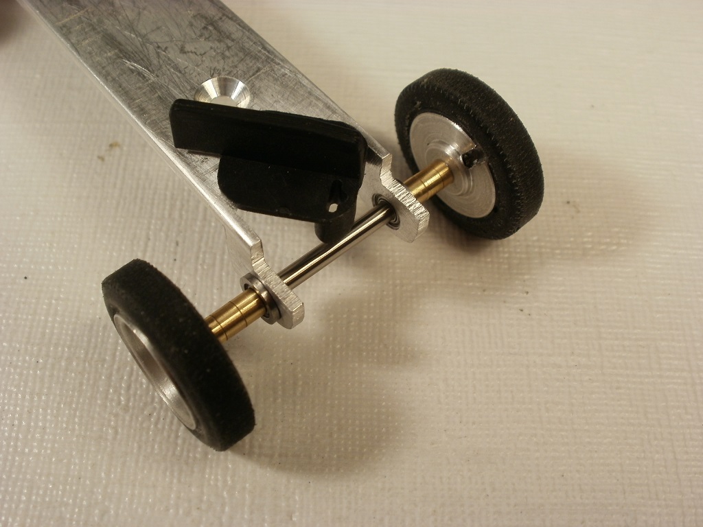

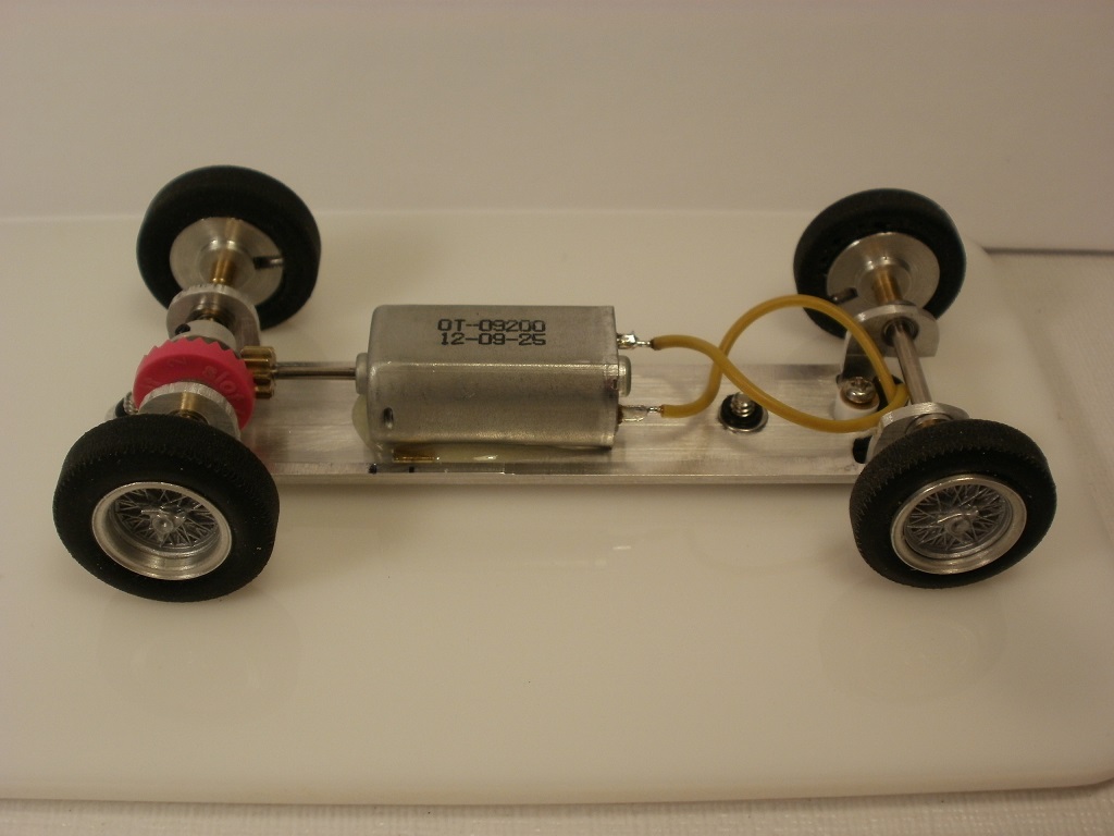

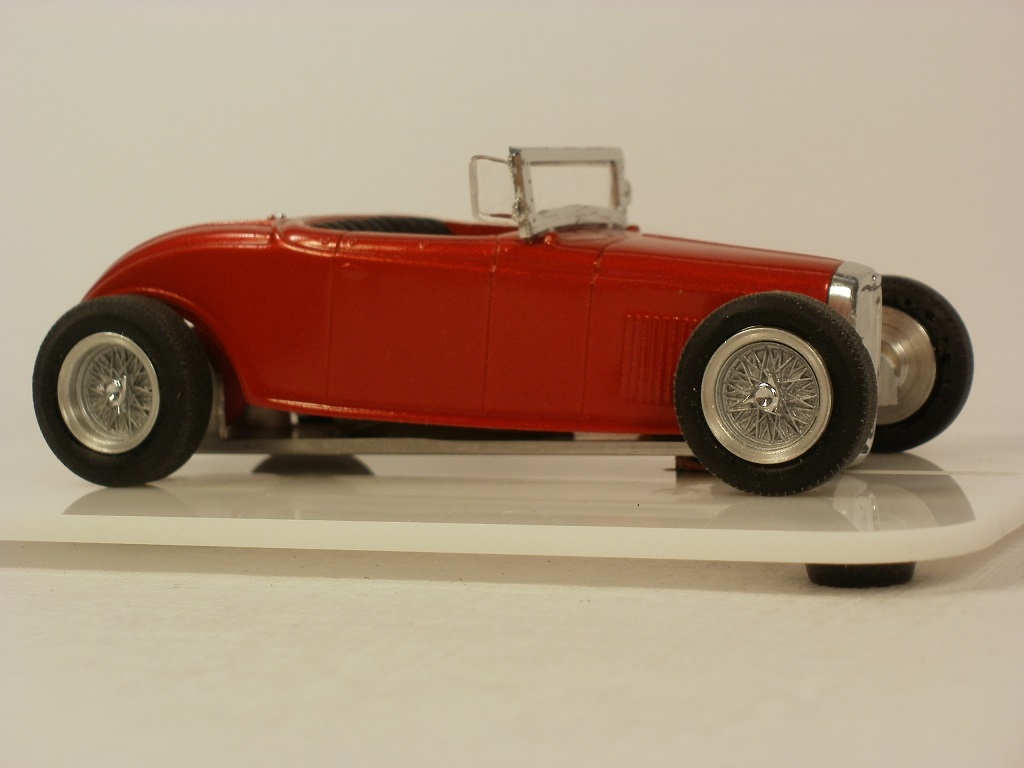

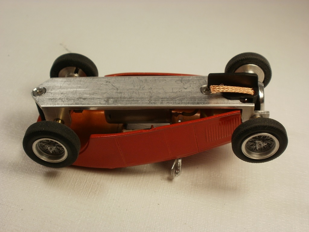

I'm going to start this off with an apology. This was one of my first builds. It has many mistakes. The main one being that I didn't realize the track width limitations before staring this car. The body is too wide to fit between the rear wheels so I had to jack the back of the car up much higher than desired. It exposes the chassis too much.
But on the bright side. The only rules in our club for the Hotrod class is wheel size (14x5), track width (52mm), and motor (BWMS 050 - 14k slimline slow motor). Anything else goes.

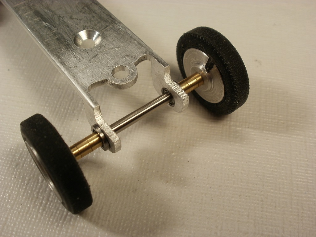

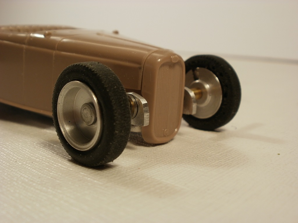

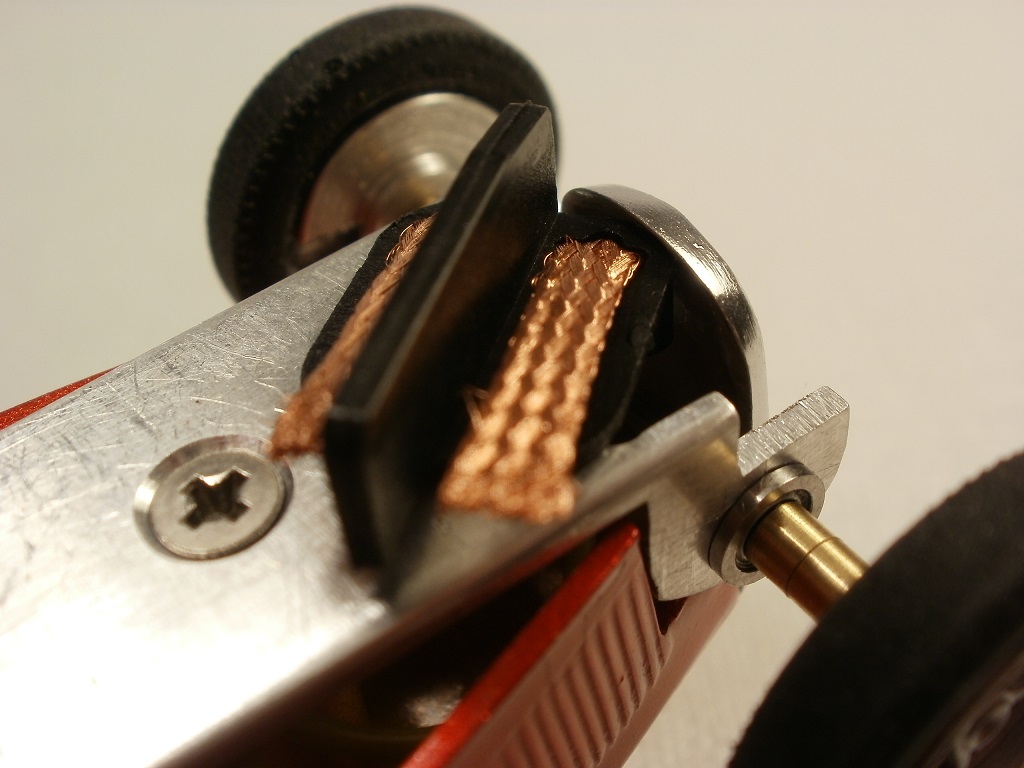

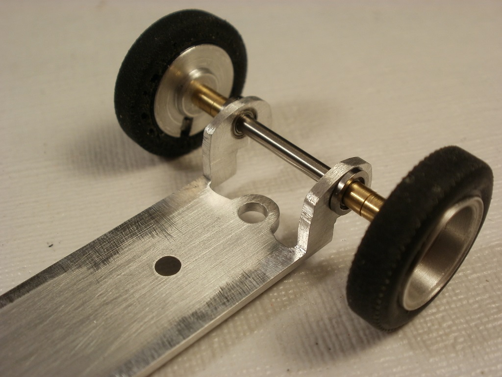

I made the chassis with a specific goal in mind. All the other Hotrods in our club have the guide exposed and sticking way out in front of the body. I plan to hide the guide so it looks like it isn't even there. That meant putting it behind the front axle (ouch). Winning races was obviously a secondary thought.

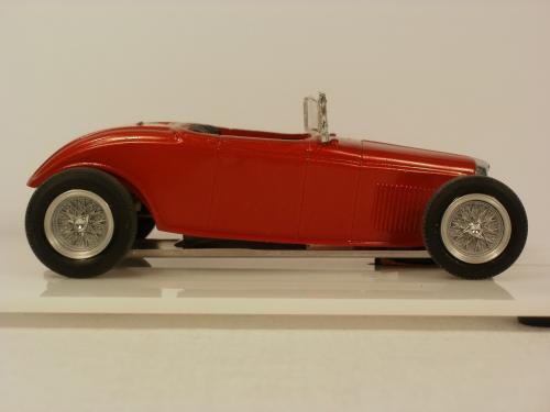

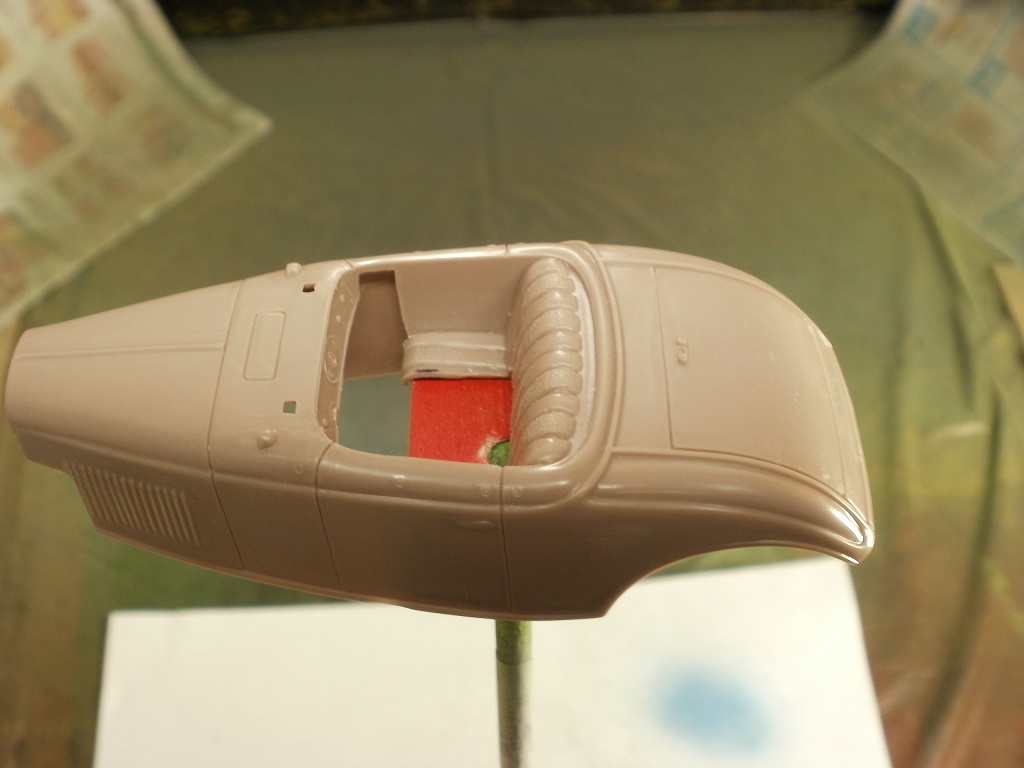

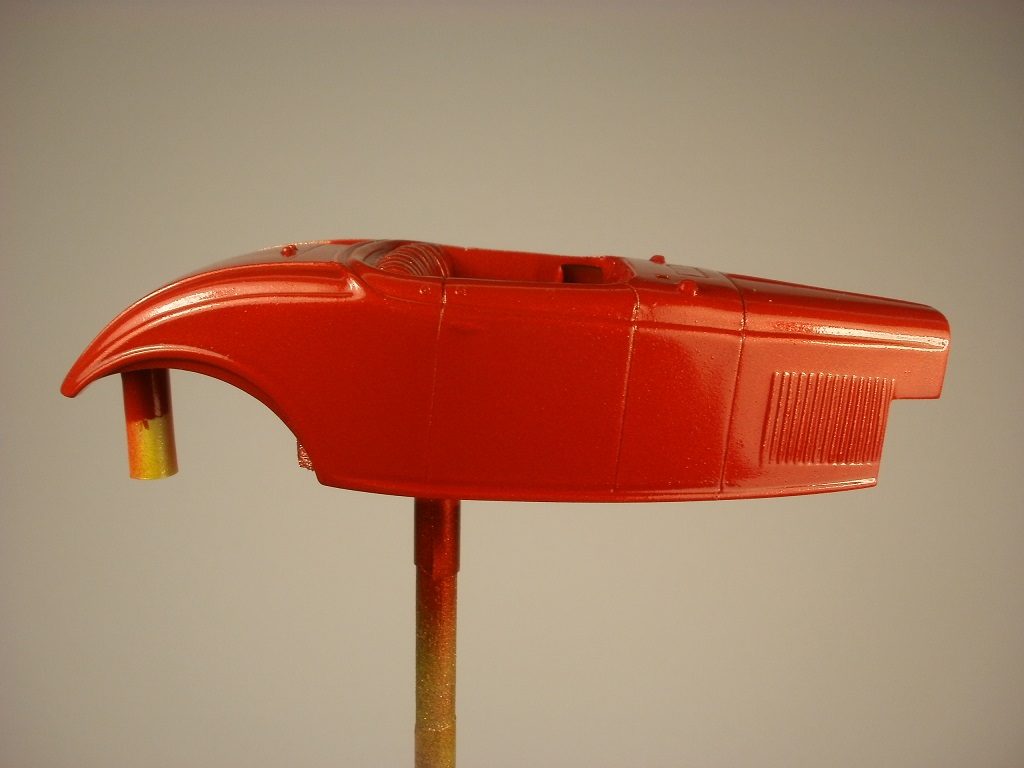

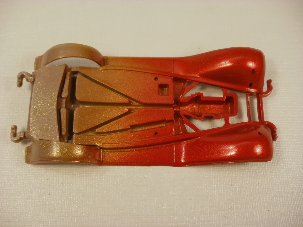

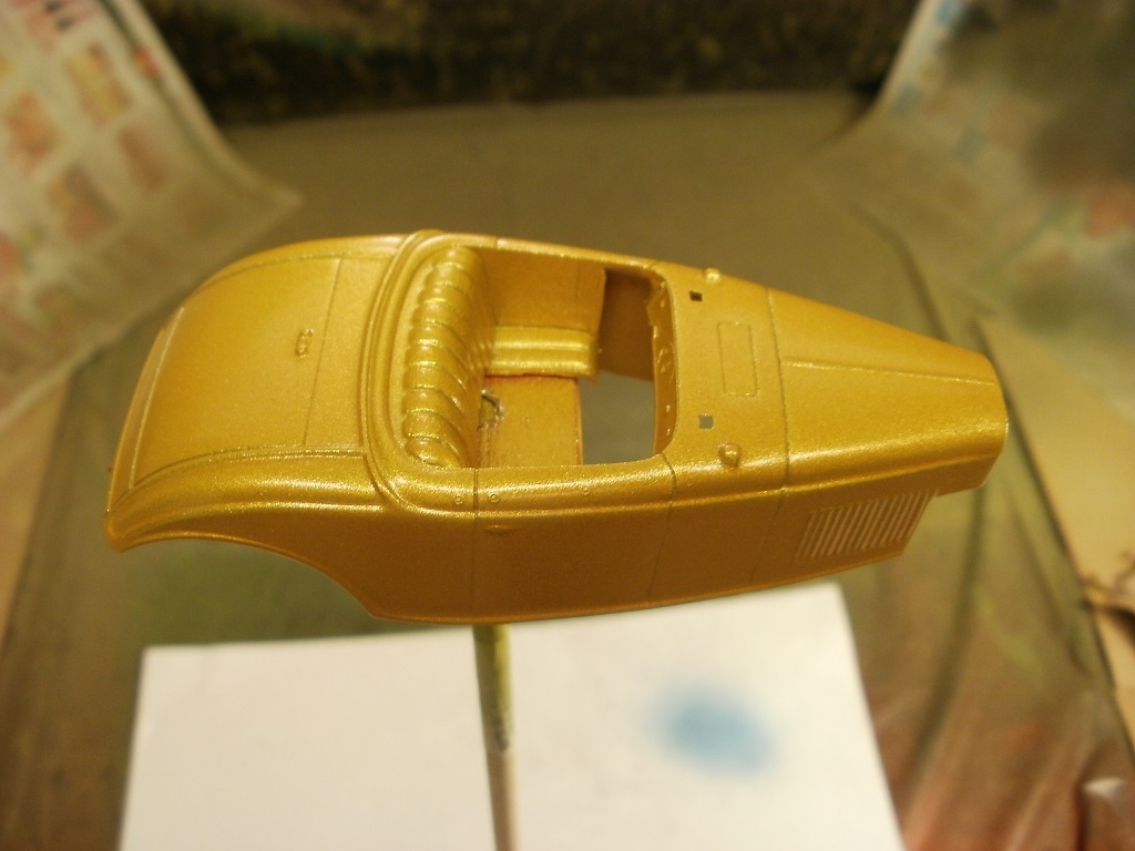

The colour of my dad's car was a simple red. I chose to experiment on this Hotrod with a base-coat/clear-coat candy apple red. I sprayed the chassis as a test in base gold followed by clear red.
[attachment=10129]
Looks good enough to try on the body.
[attachment=10130]
[attachment=10131]
[attachment=10132]

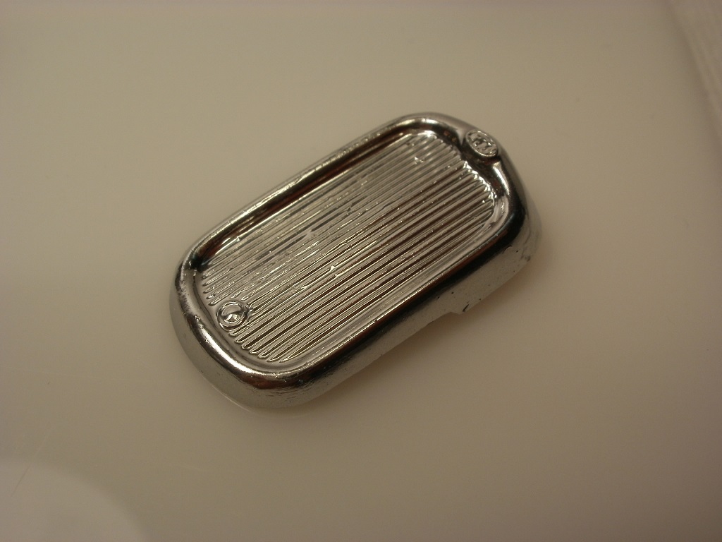

A 2mm Molotow chrome pen did wonders on the front grill! Truly an impressive invention.
[attachment=10133]

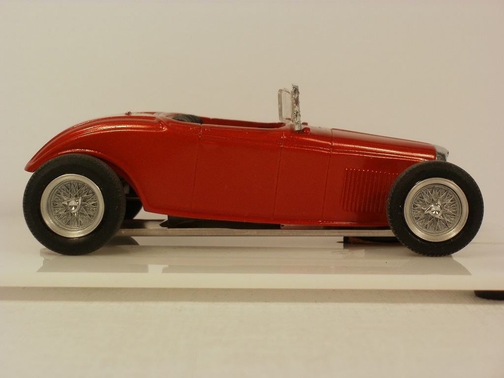

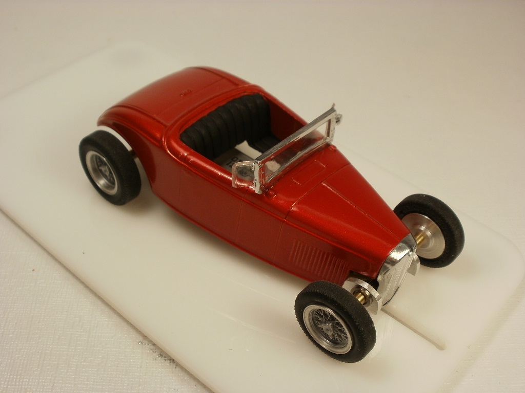

The parts are coming together.
[attachment=10134]
[attachment=10135]
[attachment=10136]
[attachment=10137]

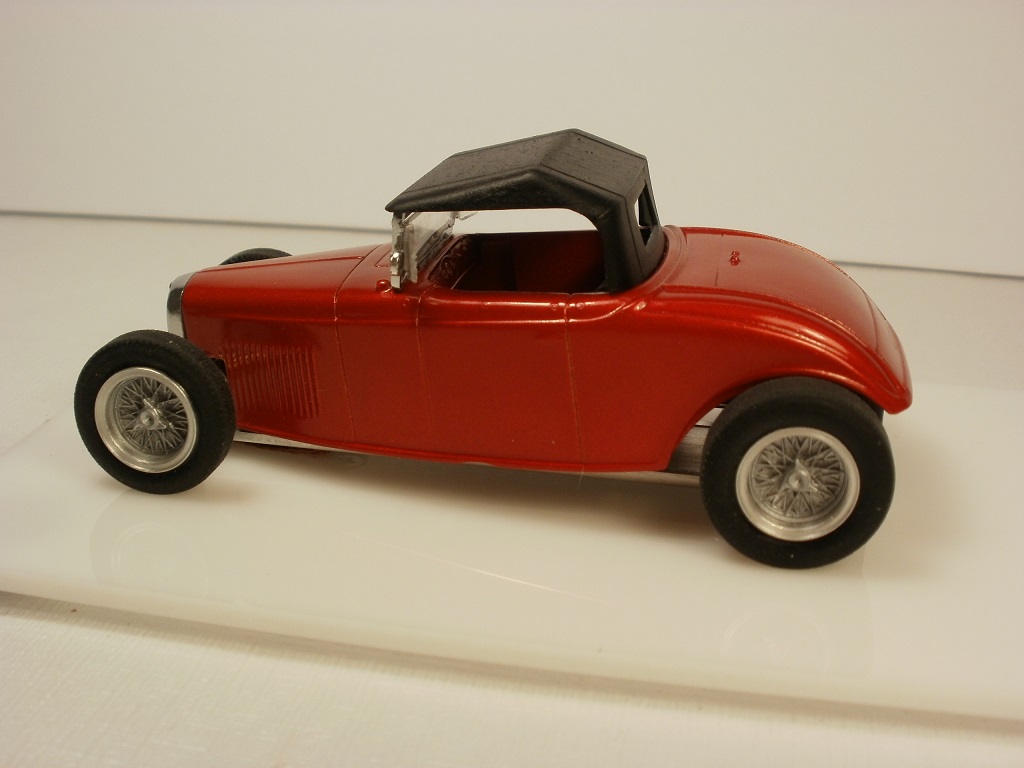

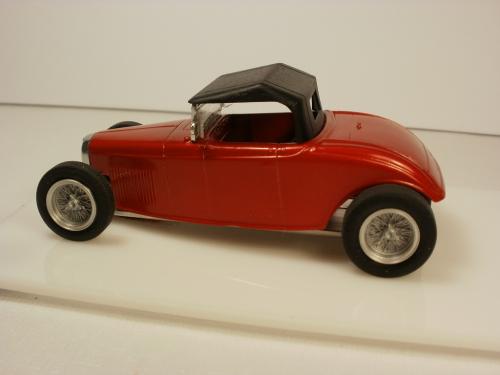

The roof is just sitting in place for the photo. I didn't want it there for the race.
[attachment=10138]

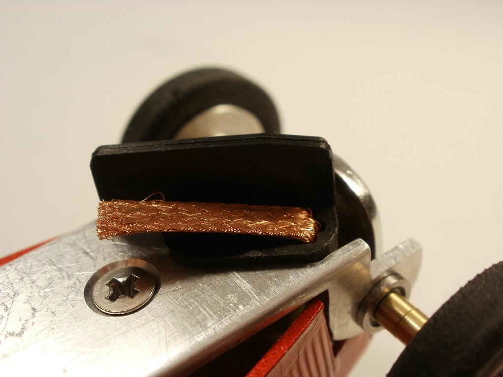

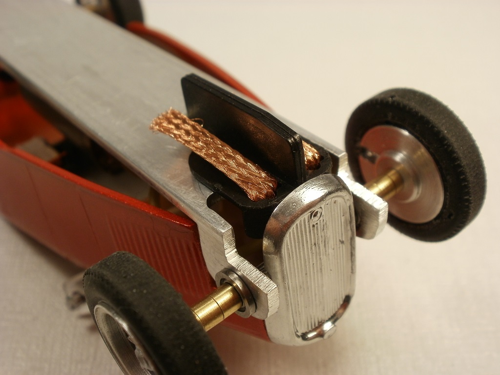

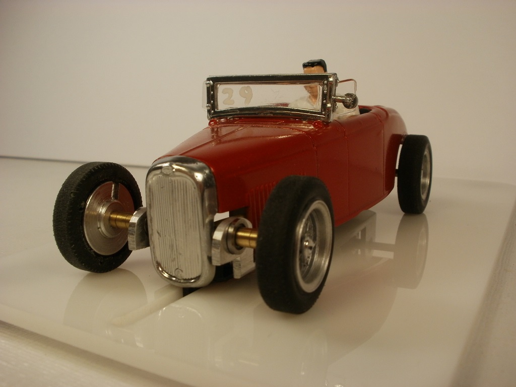

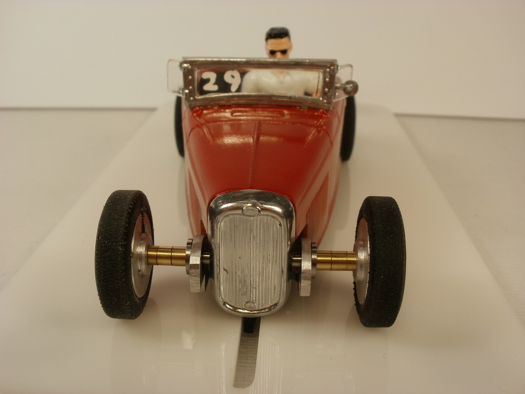

I had to use a dremel to hollow out behind the front grill in order to get full movement from the guide. The distance from the guide to the grill is barely thick enough for a thin sheet of paper. It could not be closer. But the guide is almost completely hidden. Mission accomplished.

Does having the guide where it is really effect the drive that much?
RE: 1932 Ford "B" Roadster Hotrod - KensRedZed - 10th-Feb-25
(10th-Feb-25, 04:29 PM)Tibbs Wrote:  Thats beautiful Ken.
Hi Tony,
I humbly thank you.
Having the guide behind the front axle tends to drag the front tires around the corners. It's harder to get the back of the car to slide. It prefers to roll out instead. A bad idea unless you want to hide the guide.
