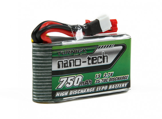

I don't have the SCP3 (yet), but have browsed the user manual. The max dimensions the manual recommends for the battery are 45 x 28 x 10mm. The Turnigy Nano-Tech Plus 750mAh 1S 70C Lipo Pack that is illustrated in the manual is 54 x 31 x 8.4mm - too big!
There is an older, almost identical Turnigy pack (Nano-Tech, but not 'Plus') that measures in at 43 x 24 x 9mm - I wonder if this is the one Slot.it used? The SCP3 was in development for a while. Here's a pic...
[attachment=9852]
There don't seem many around. I found one on eBay here. A Radio Control specialist retailer is going to be the best bet - either to source that older Turnigy Nano-Tech pack or something else that will fit.

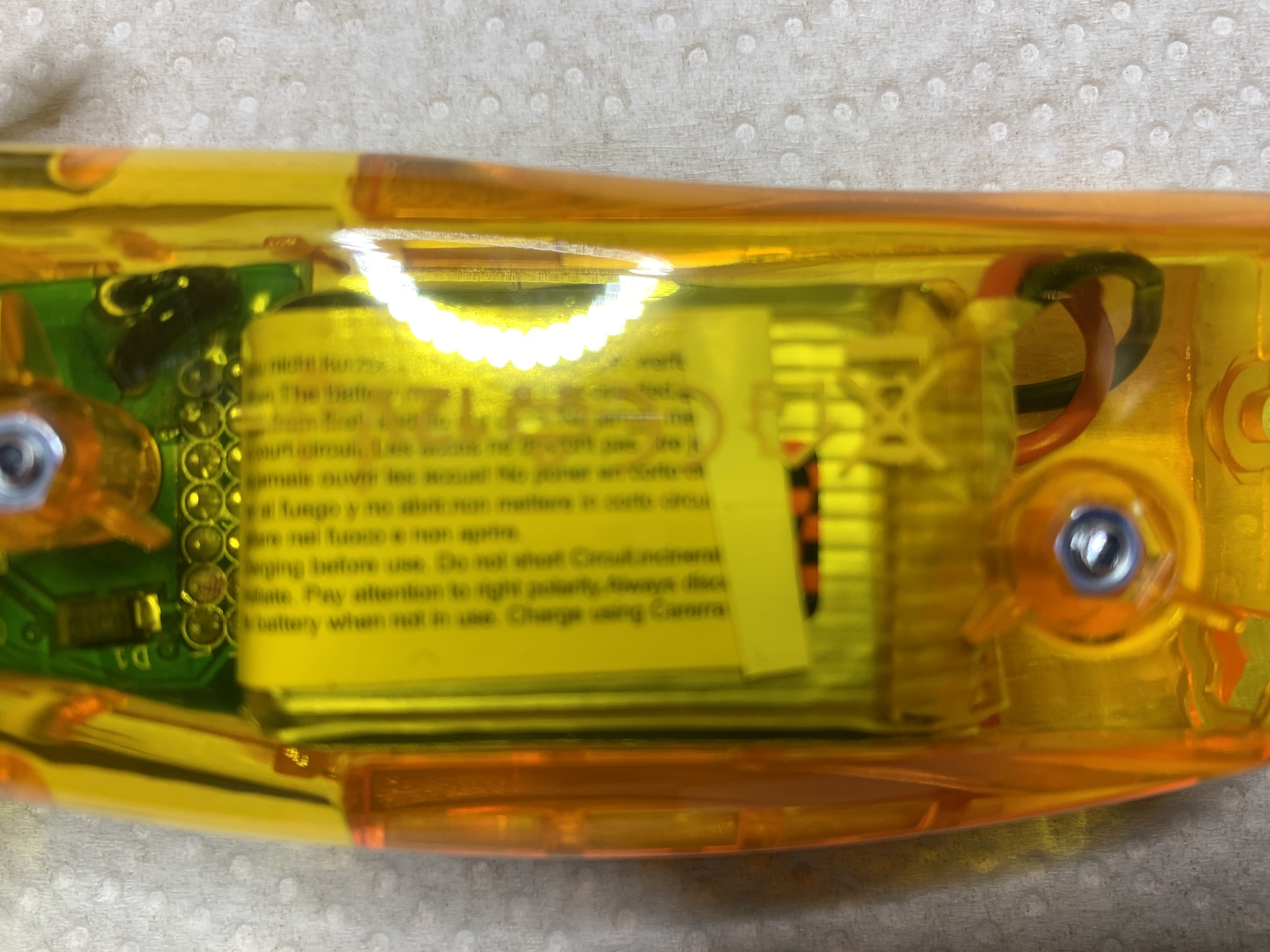

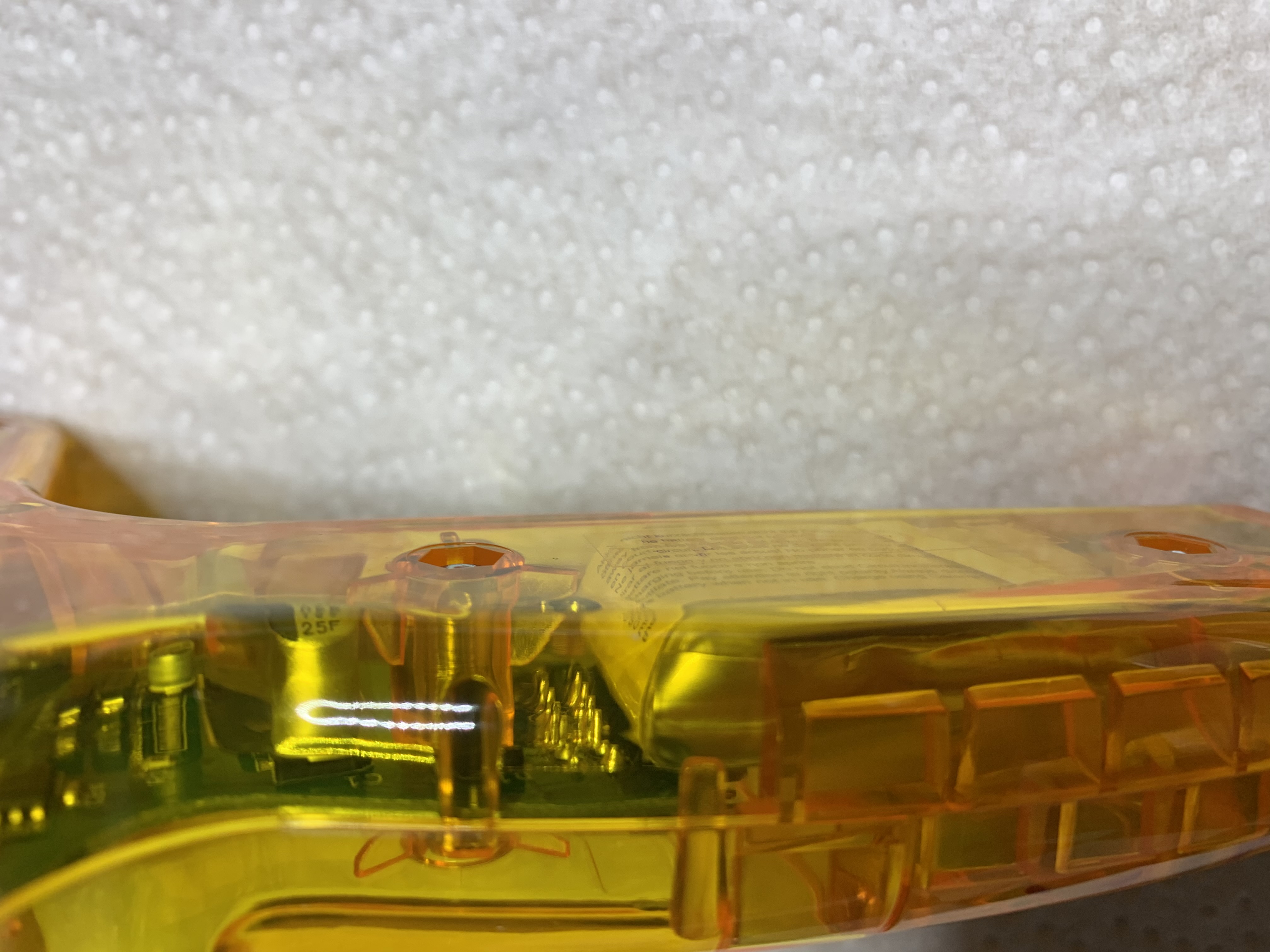

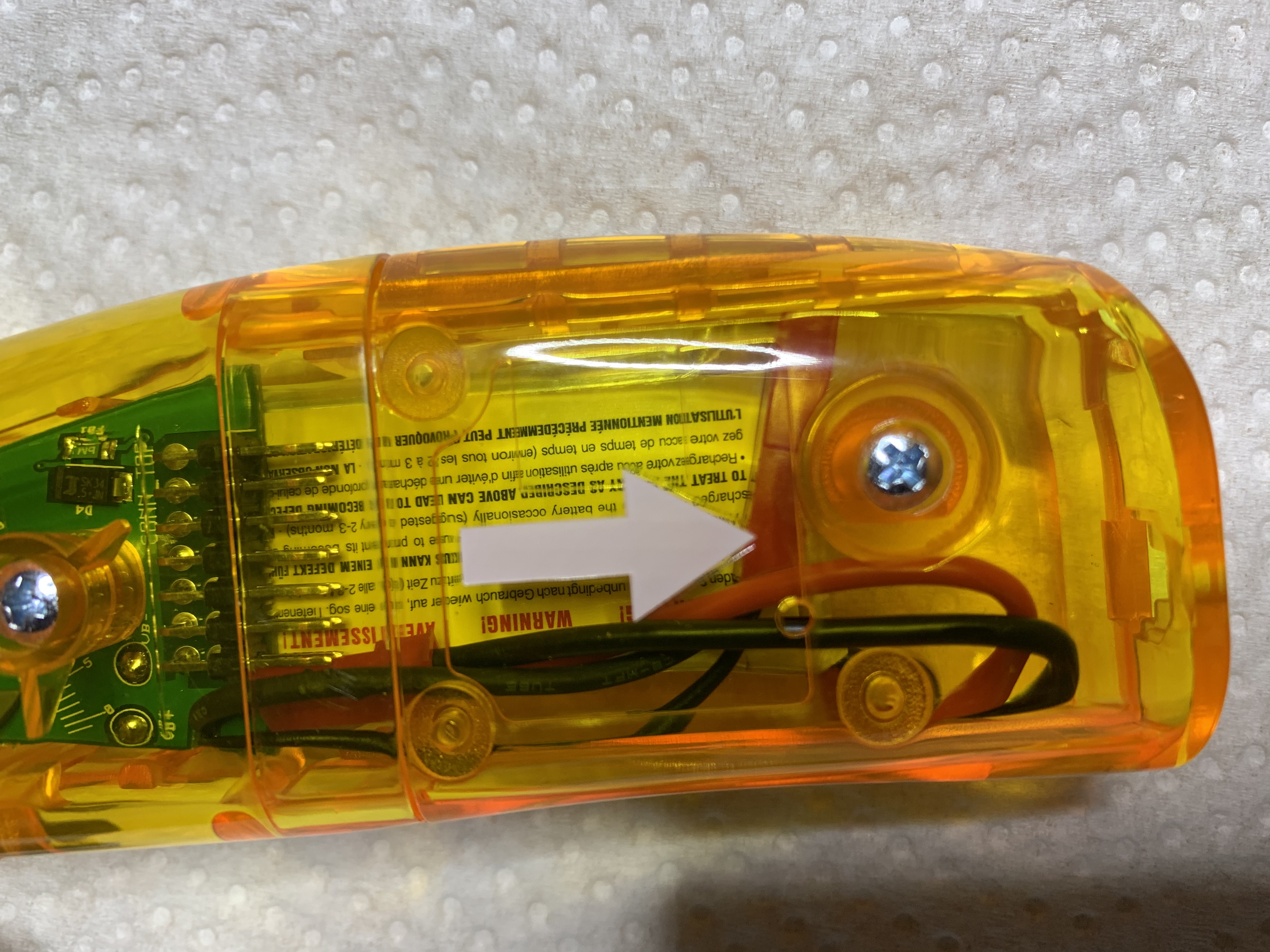

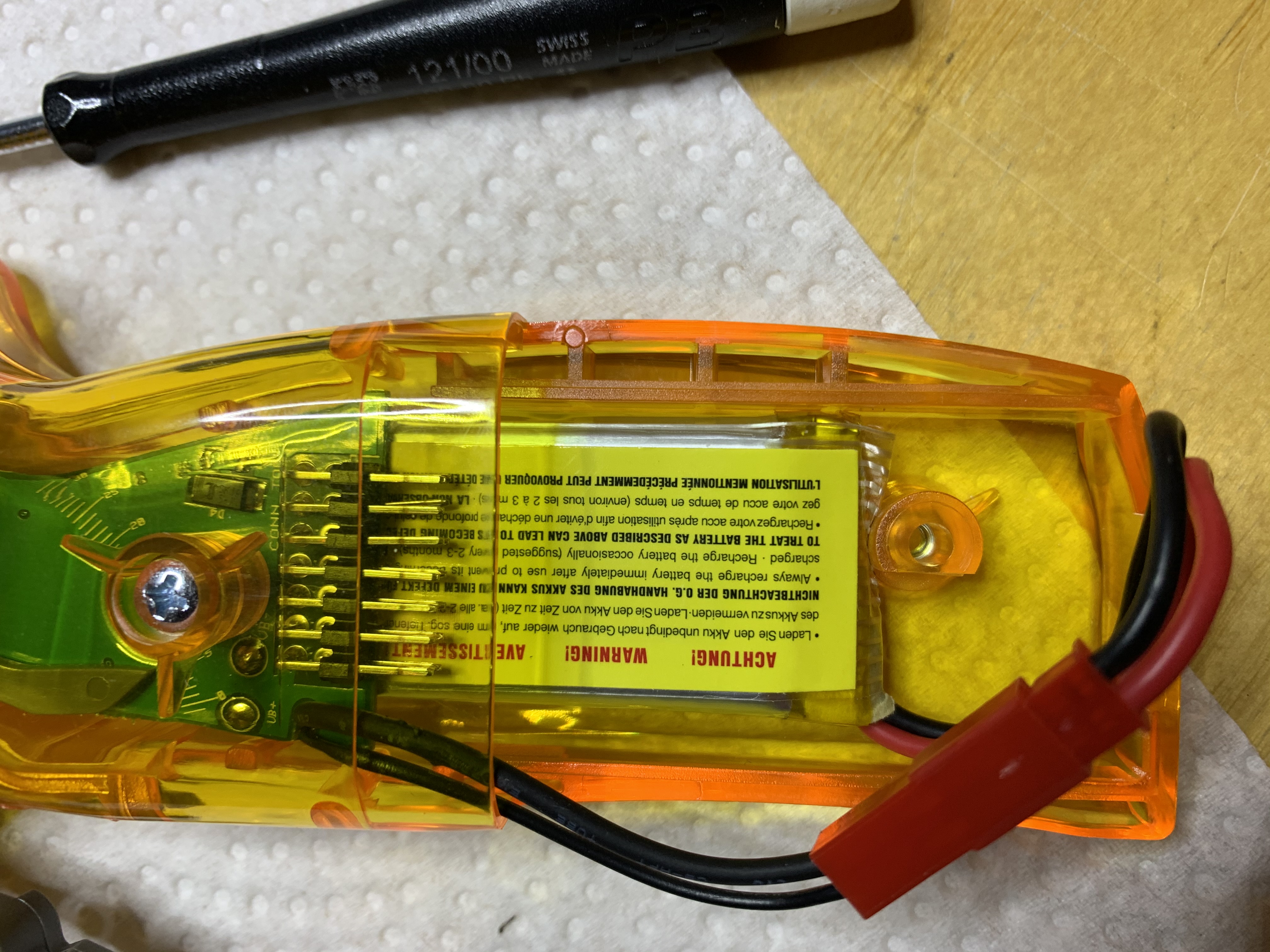

RE: SCP 3 battery - Henk - 4th-Nov-20
Here are the pictures, excuses for the delay.
As I wrote it is a standard battery for a Carrera wireless controller, you should be able to get one thru the normal resellers.
[attachment=9950]
[attachment=9949]
[attachment=9951]
[attachment=9952]

(30th-Oct-20, 01:38 PM)woodcote Wrote:  I don't have the SCP3 (yet), but have browsed the user manual. The max dimensions the manual recommends for the battery are 45 x 28 x 10mm. The Turnigy Nano-Tech Plus 750mAh 1S 70C Lipo Pack that is illustrated in the manual is 54 x 31 x 8.4mm - too big!
This is exactly what happened. I just looked at the picture and didn't read the fine print of the new dimension.
