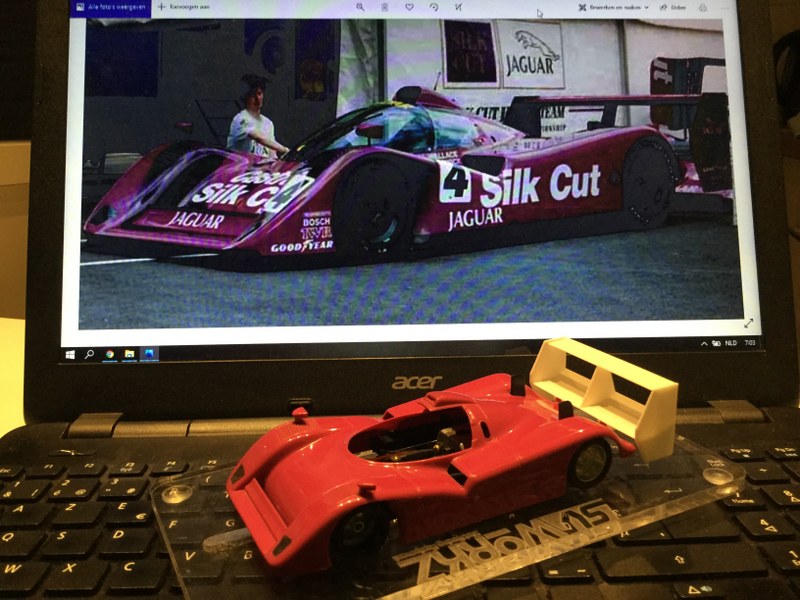

[attachment=9601]

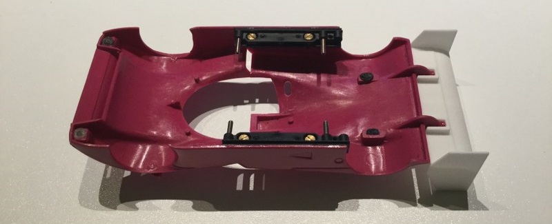

[attachment=9662]
A bit heavy yes, but this gave me a mission on how to drop the weight without actually using any tool to thin the body out,
and to get as close to the required min. 21gr. body weight (club regulations).
The only thing that was removed from the body were the 4 SRS body clips that hold the body and chassis together.

For that last piece on the list I turned to Steven (SV workz), and asked If he would design a 3D model to get printed.
As the original SCX rear spoiler weight about +/- 5gr.,  the 3DP model was only about +/-2gr.
That saves about +/-3gr. less weight hanging behind the rear wheels, which will definitely improve handling.

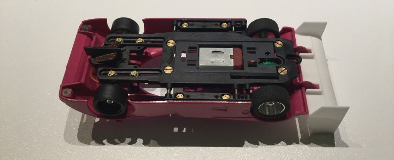

As allready written above, the chassis will be a stock slotit HRS inline chassis with all the mechanical parts of a regular Slotit Group C car.
Nothing fancy this time, I did use the Slotit "SICH57B" chassis to body kit, as this will give the option that the body can move/float a bit.
Instead of using the original delivered mouting pins that come with the HRS chassis.
[attachment=9663]
[attachment=9664]
