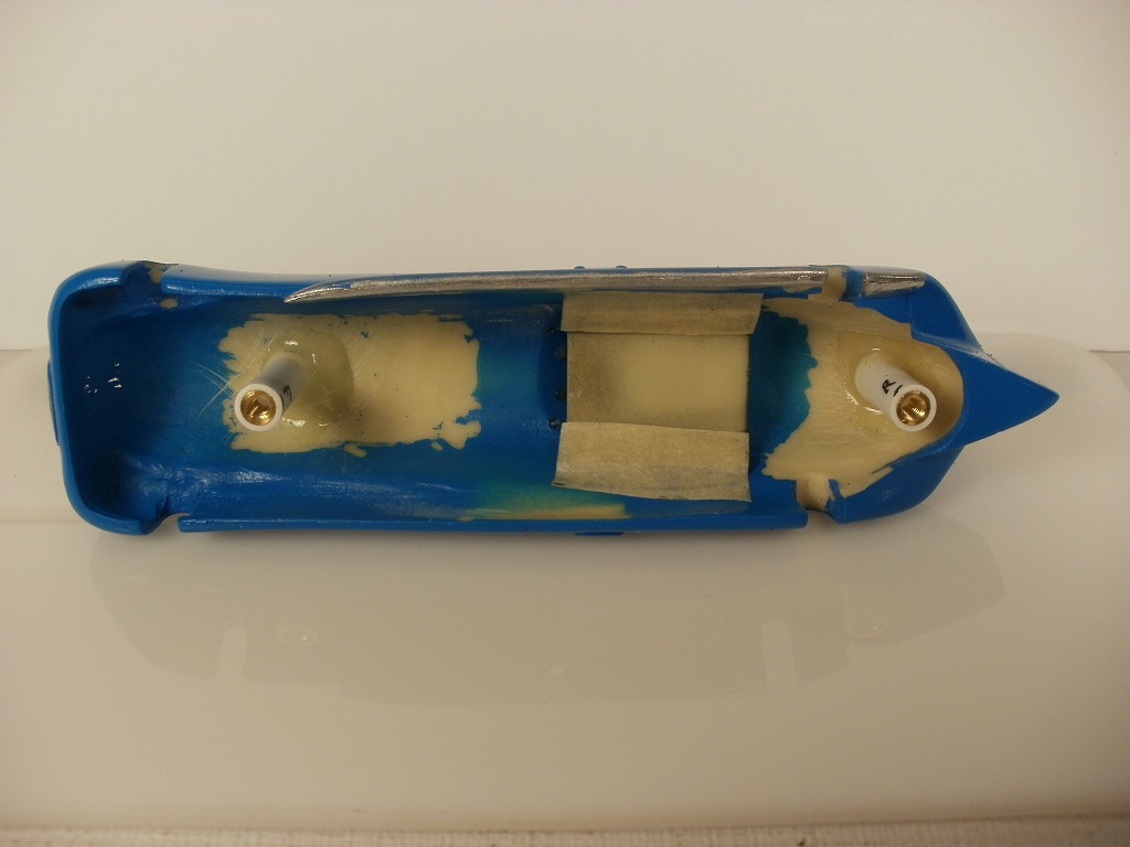

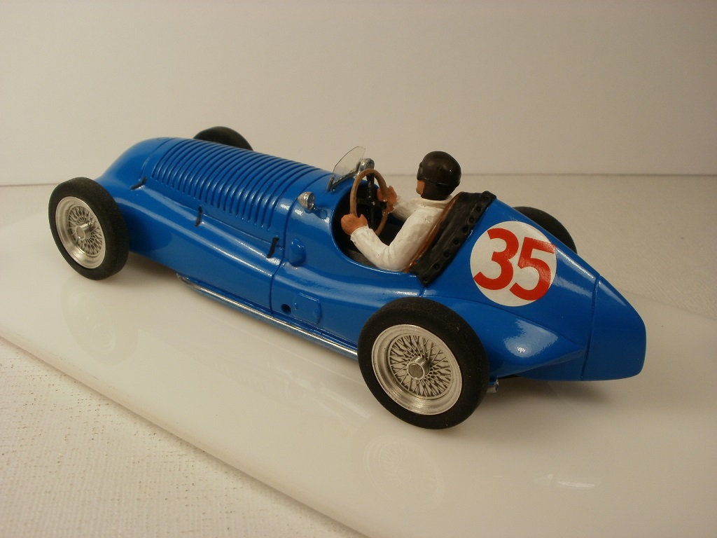

I second Gordon's suggestion. I bought a good quality 3M masking tape that is so sticky, it sticks until you choose to remove it.
This is a resin interior taped into a resin body. All my interiors are taped in.
[attachment=8853]
[attachment=8854]
