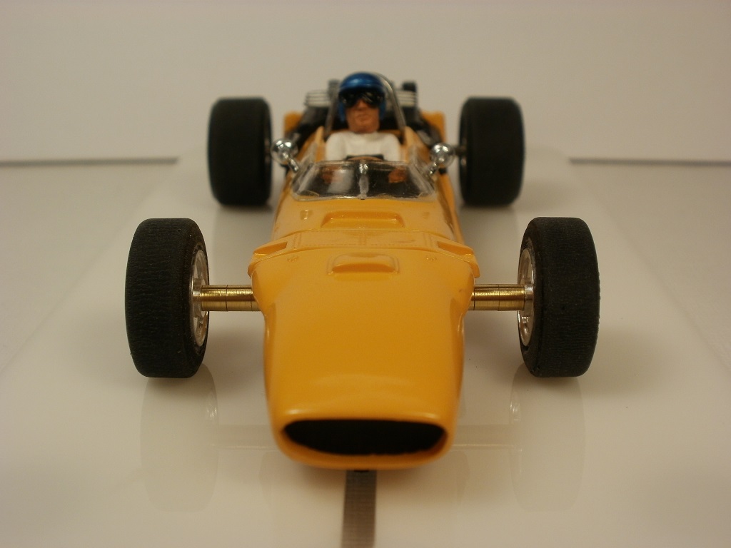

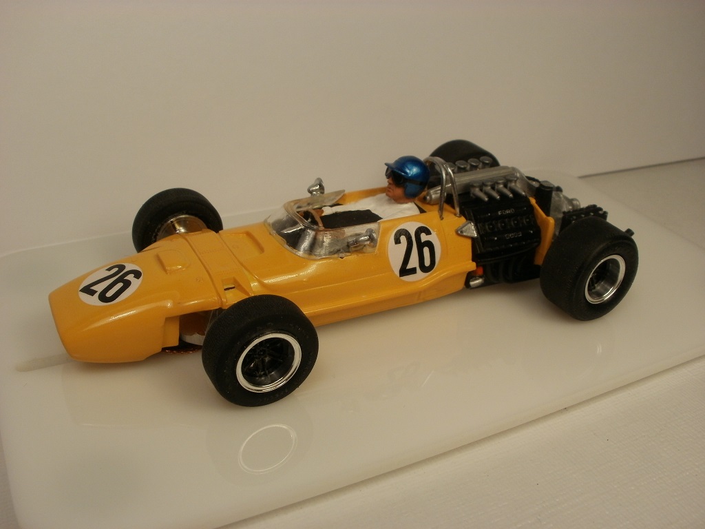

This is a fun class of car to drive in our club. The 3.0L GP class with a Scalex 050 motor is fast and loose.
All Matra's were light blue. They must have run out of blue paint that day... This one is Tamiya Camel Yellow.
[attachment=8726]

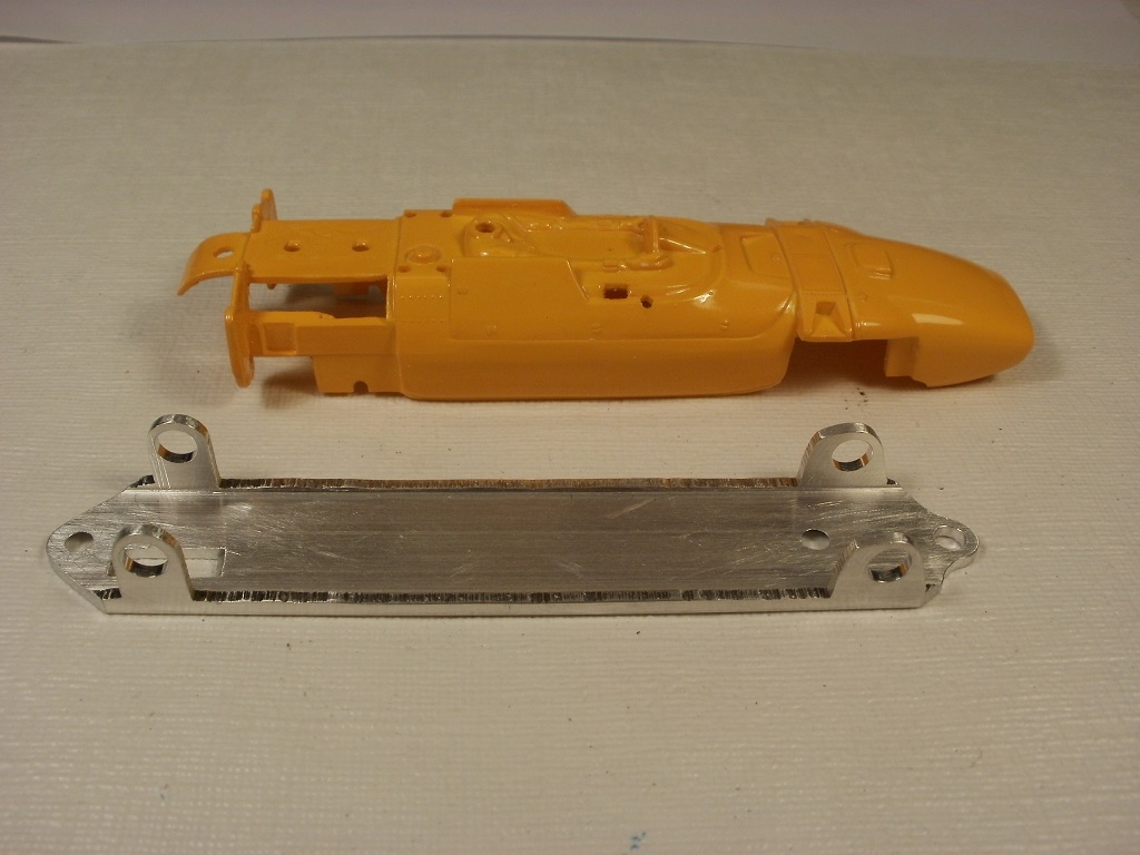

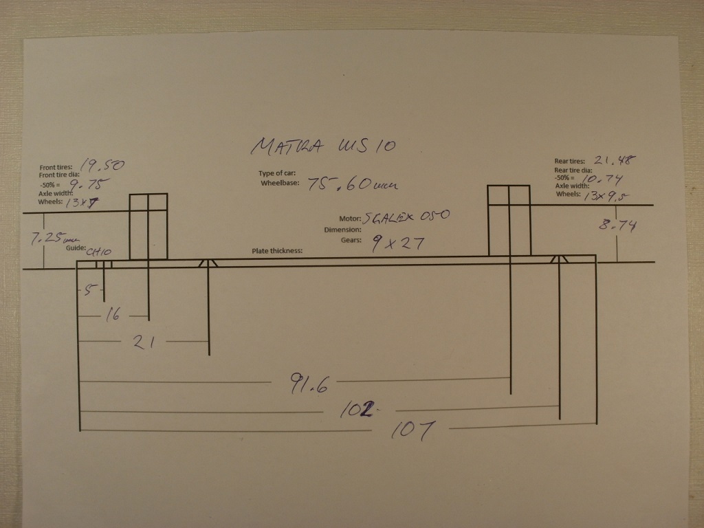

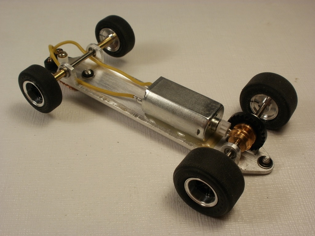

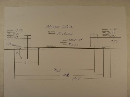

Plans for the chassis.
[attachment=8727]

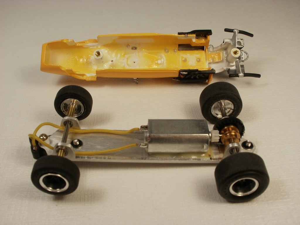

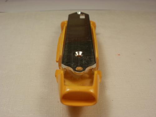

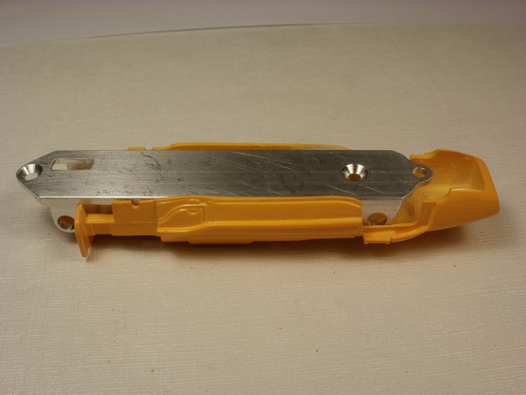

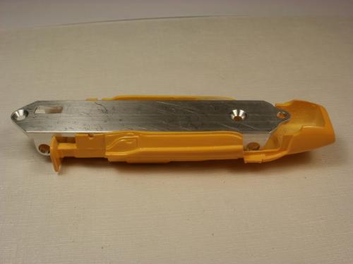

The chassis completed and test fitted.
[attachment=8728]
[attachment=8730]
[attachment=8731]

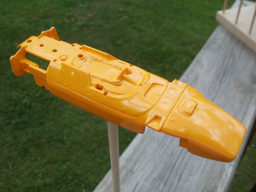

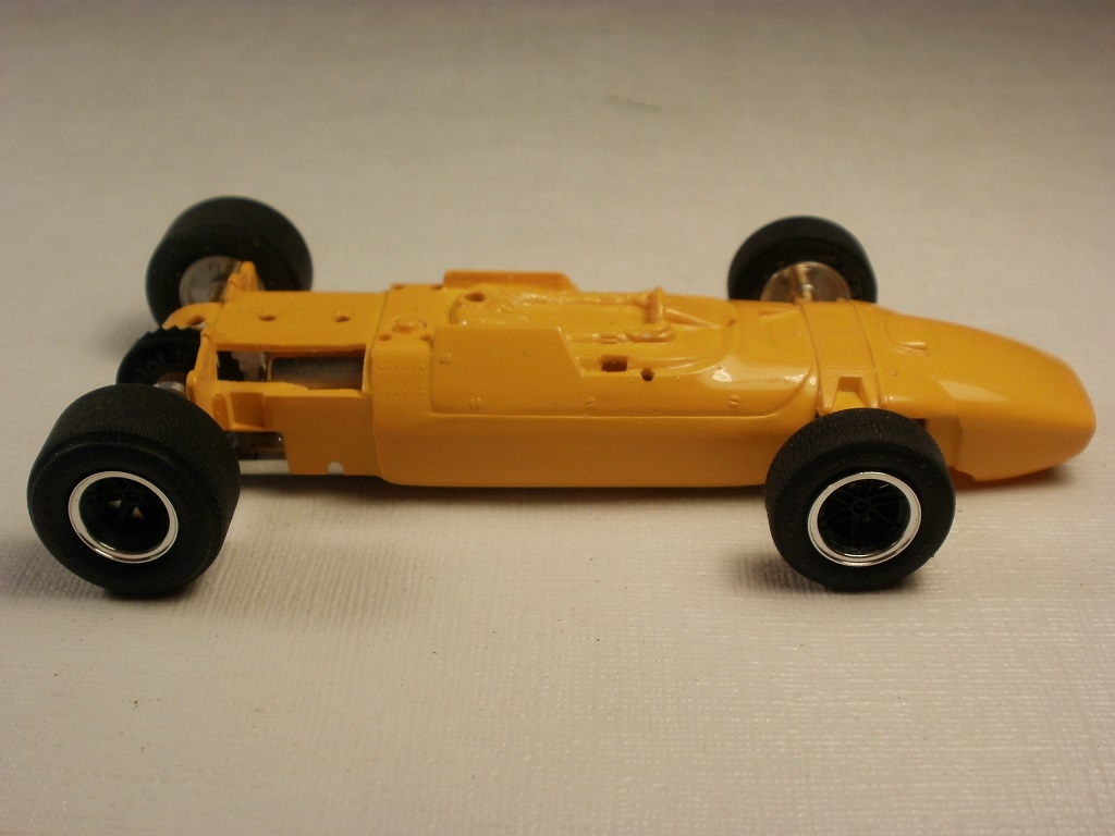

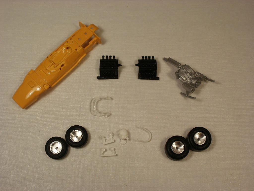

Body, engine, and transmission painted. Tires and wheels glued and trued.
[attachment=8729]

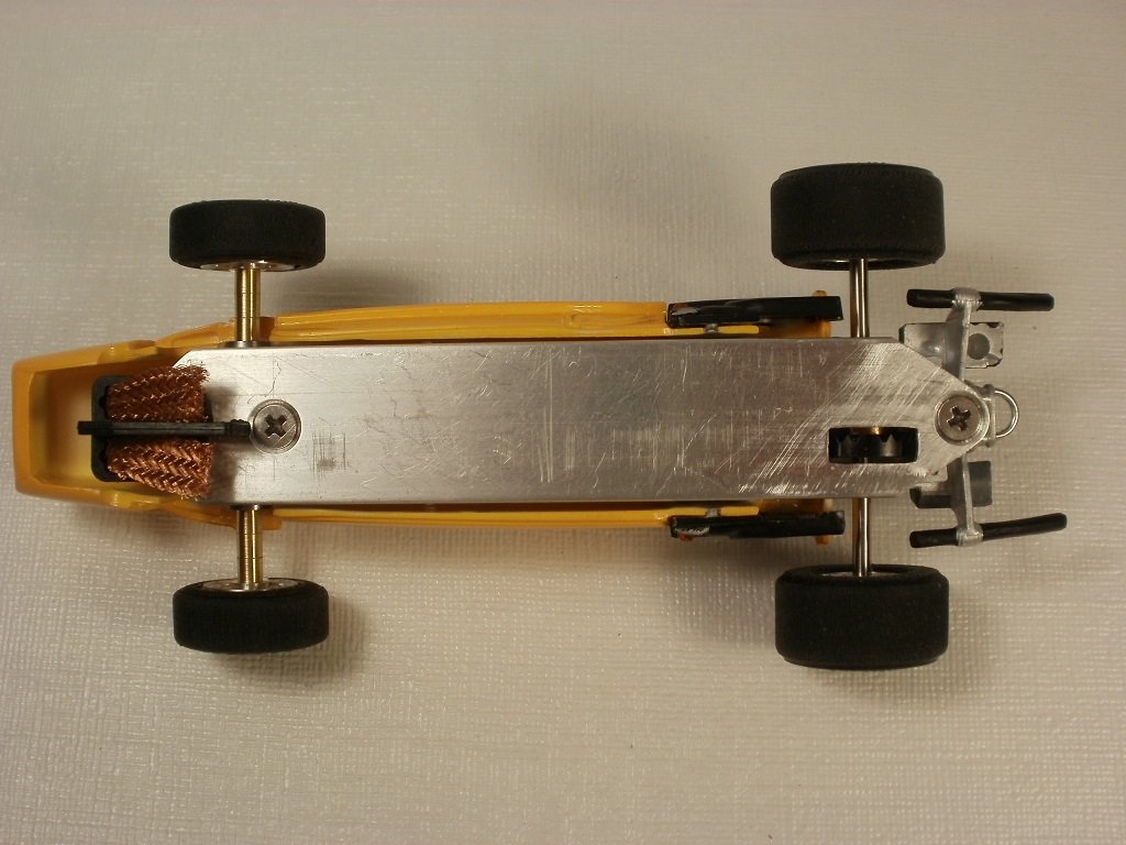

Chassis assembled.
[attachment=8732]

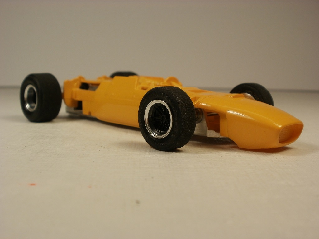

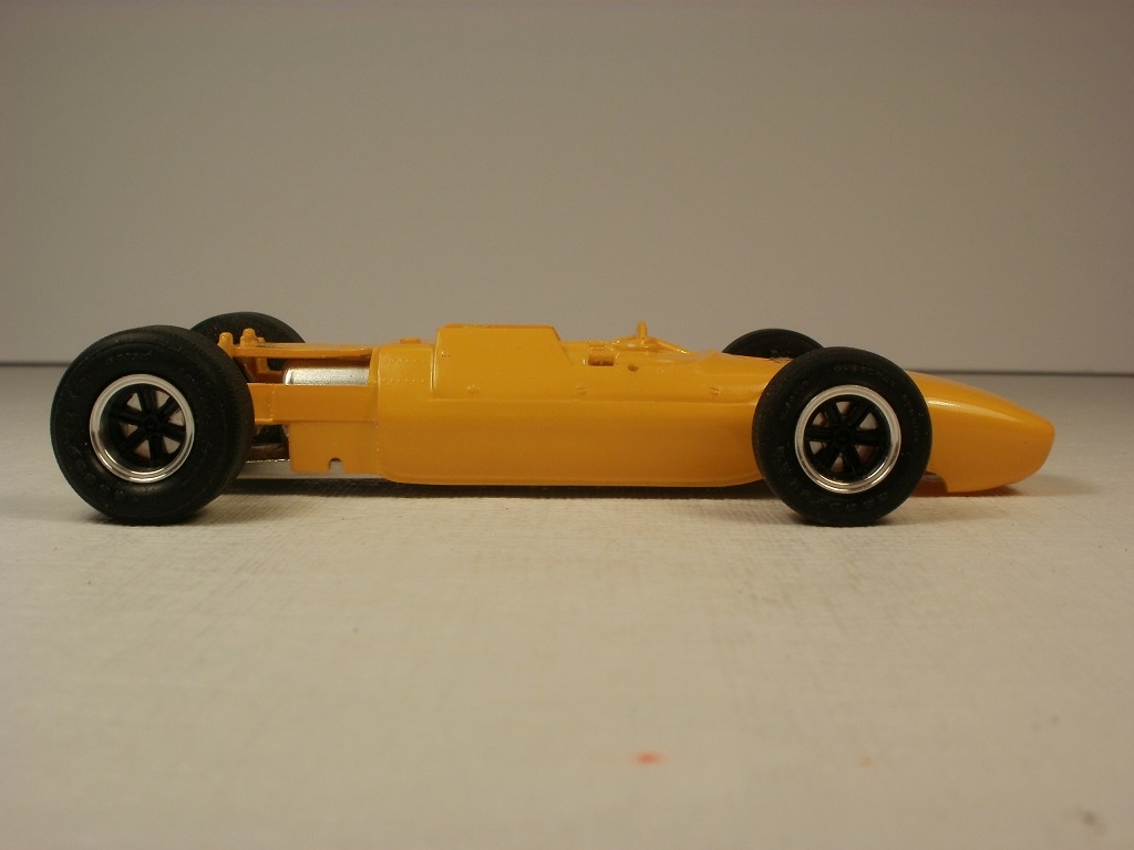

More test fitting.
[attachment=8733]
[attachment=8734]
[attachment=8735]
[attachment=8736]
[attachment=8737]

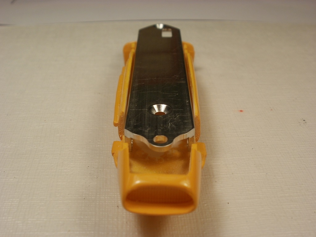

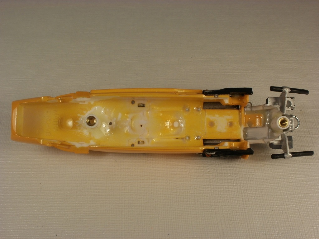

Underside showing the body posts and assembled body from the inside.
[attachment=8738]
[attachment=8739]
[attachment=8740]

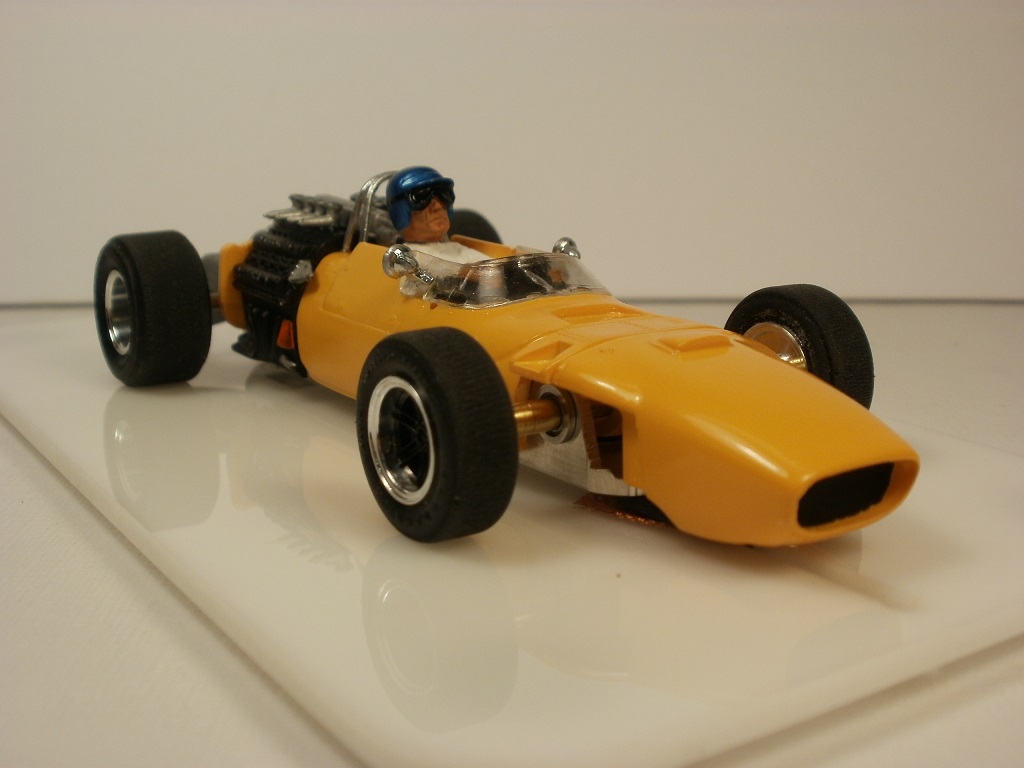

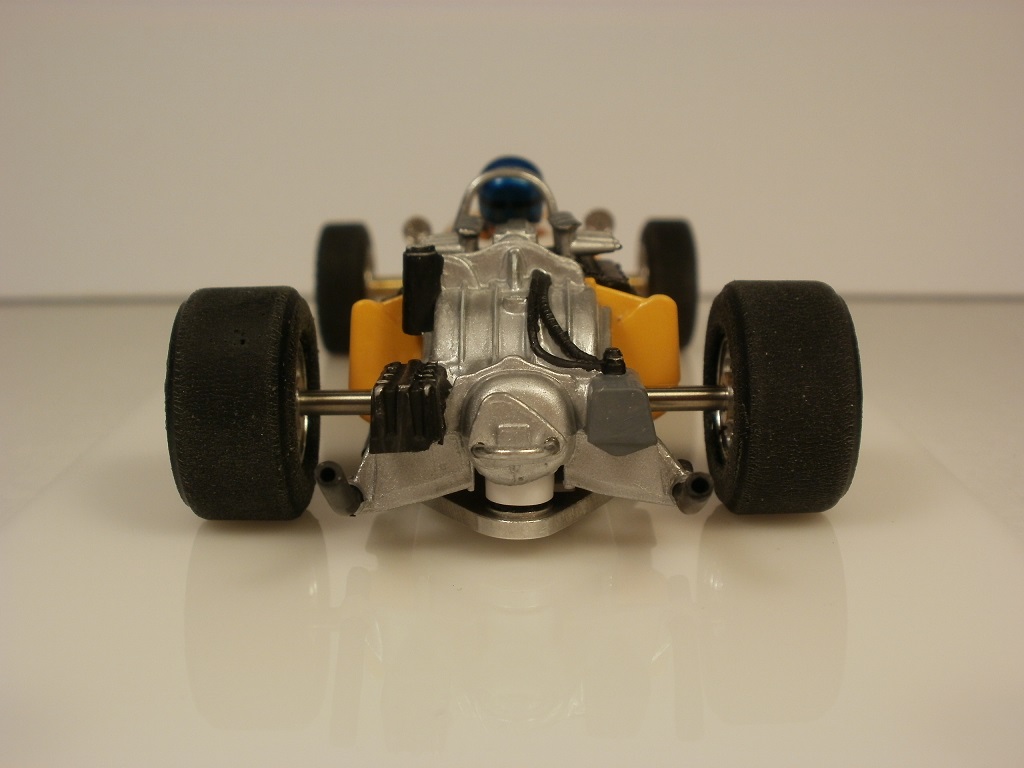

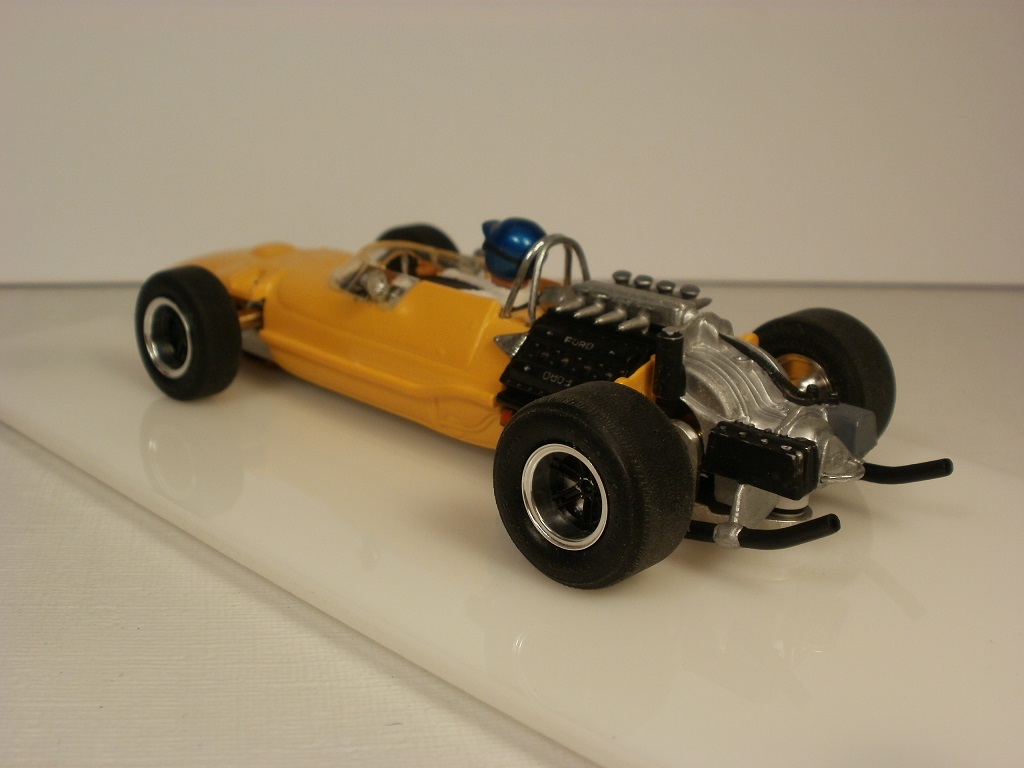

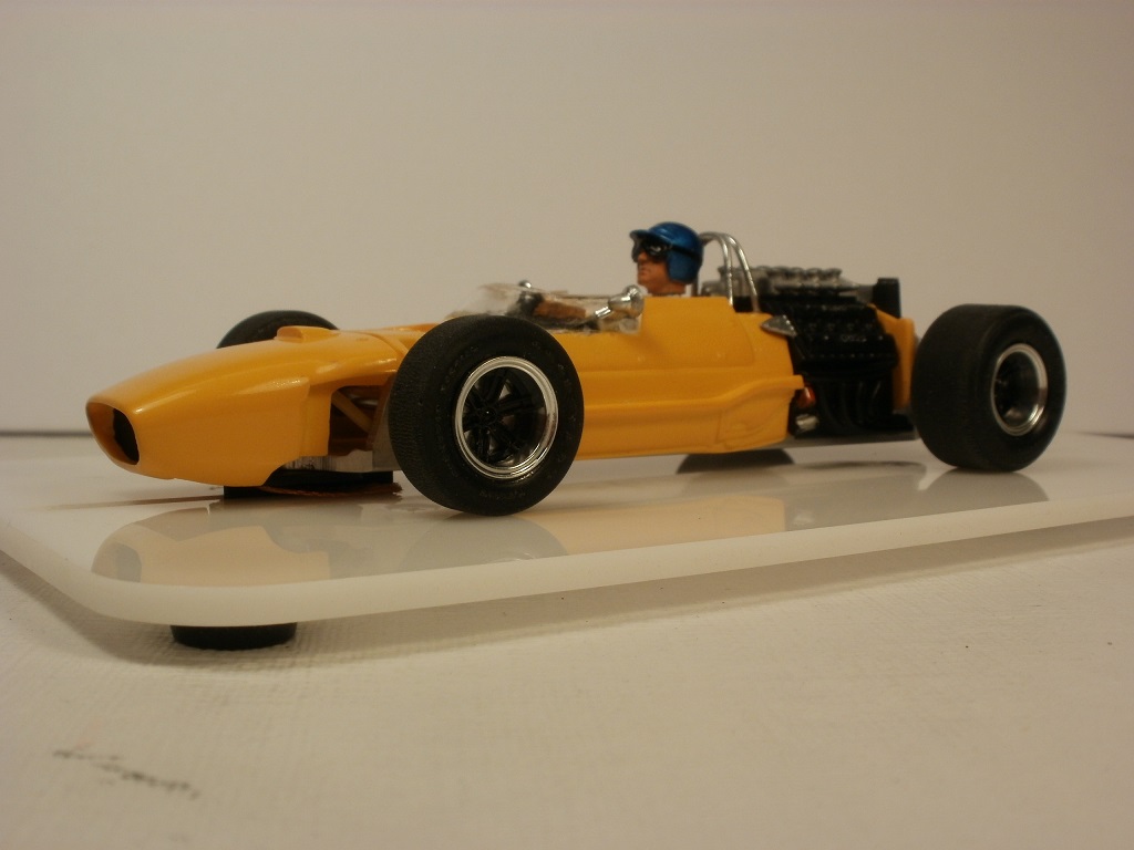

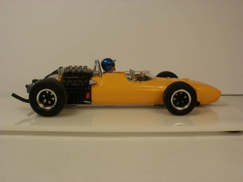

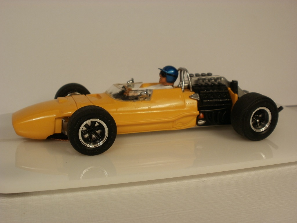

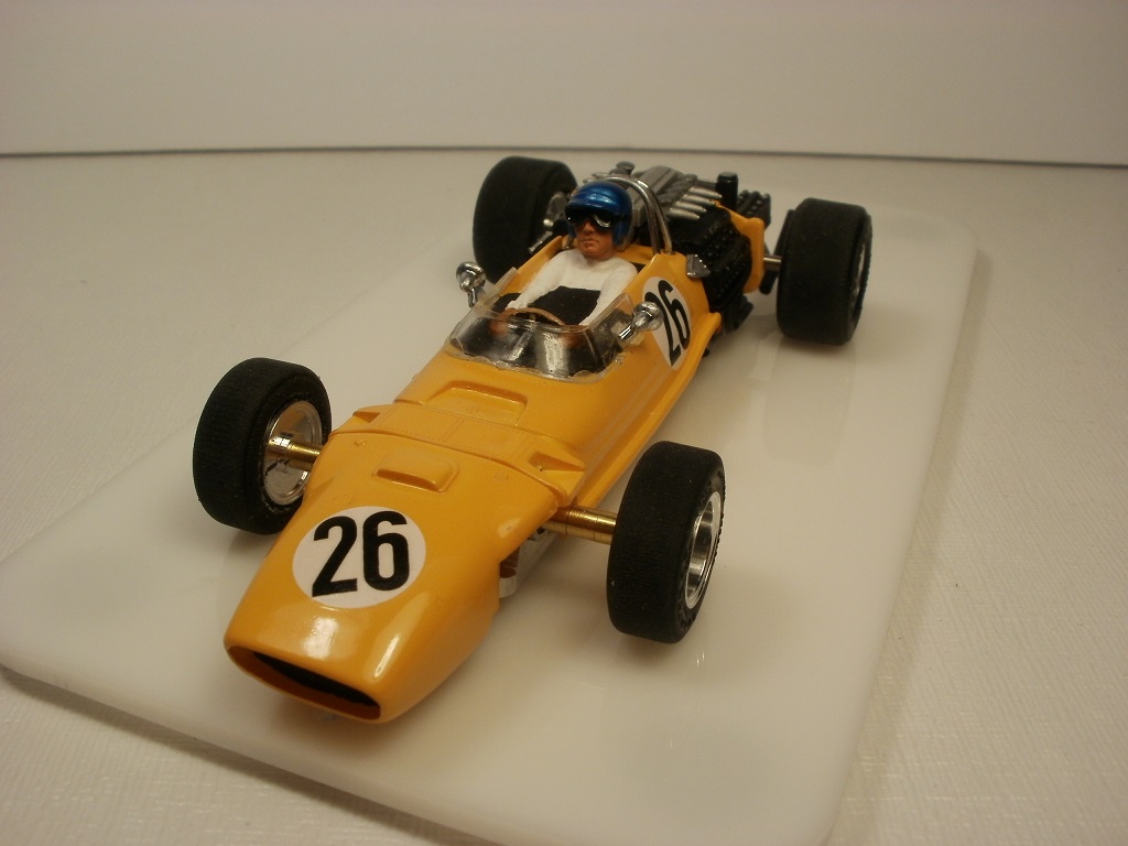

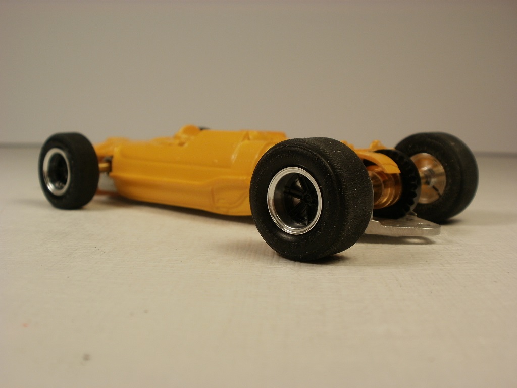

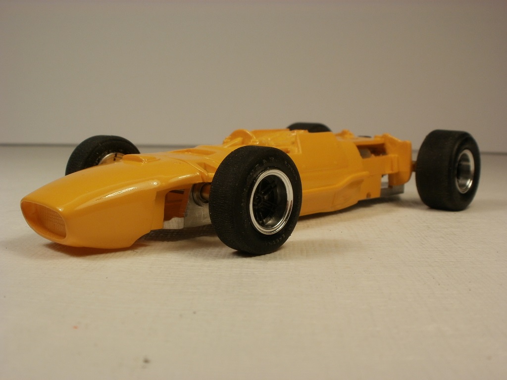

The car is ready to run.
[attachment=8741]
[attachment=8742]
[attachment=8743]
[attachment=8744]
[attachment=8745]
[attachment=8746]
[attachment=8747]
Numbers added. Thank you very kindly for looking.
[attachment=8748]
[attachment=8749]
