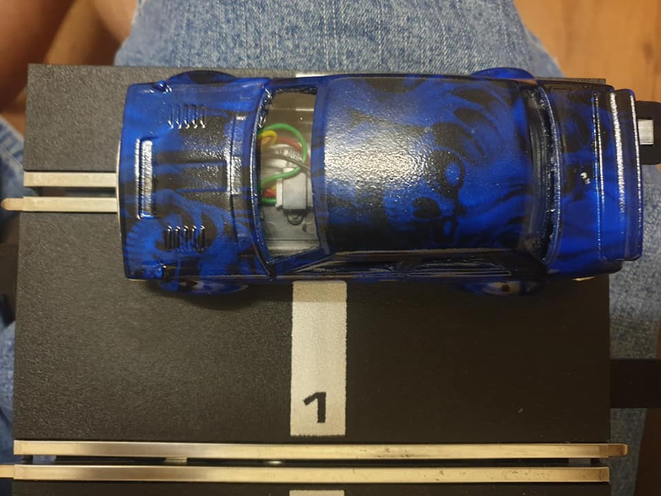

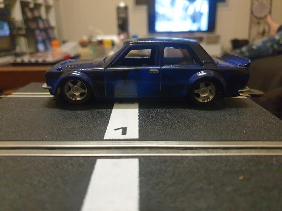

Hydro-dripping is great if you simply want a colour or pattern on your slot-car but aligning it to match the body lines is very challenging. I have seen models painted with Tartan patterns but never seen one with the pattern square and straight.
RE: Hydro-dipping -
Johnno - 6th-Jul-20

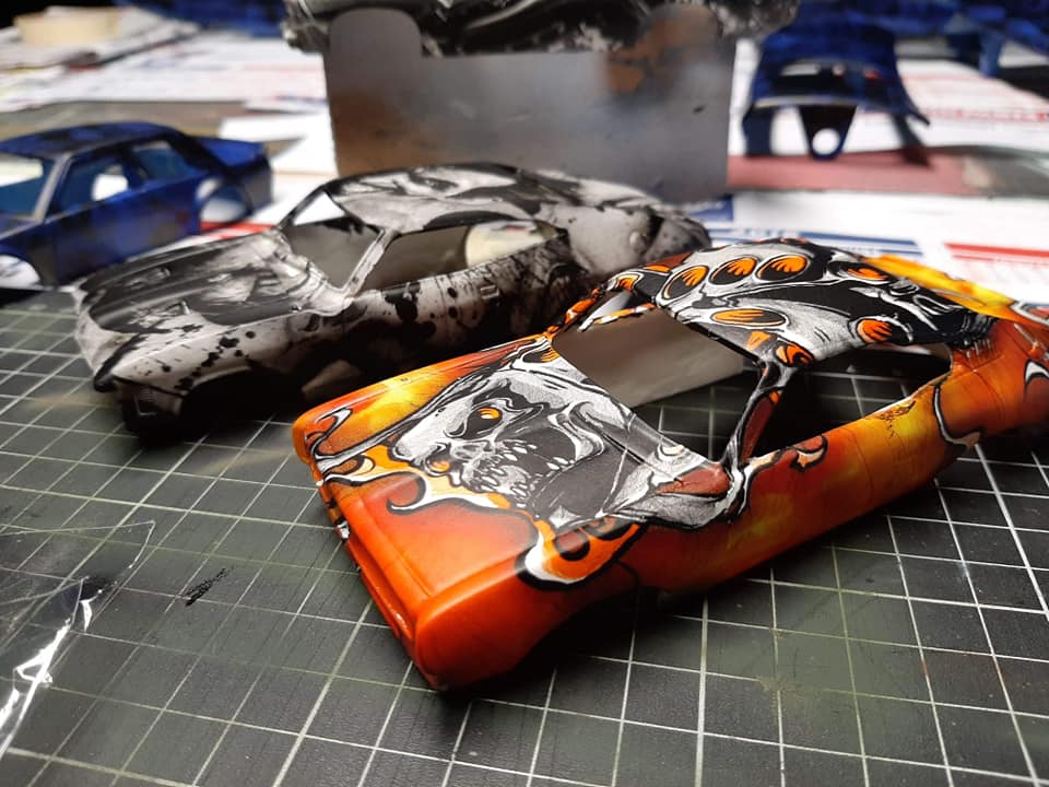

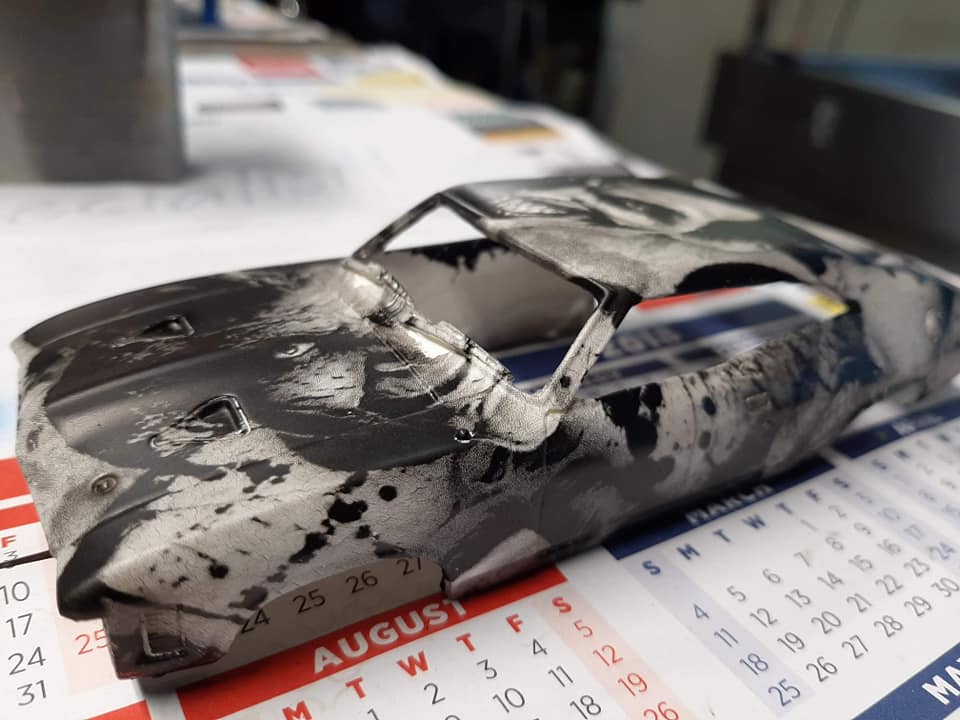

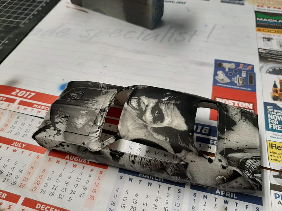

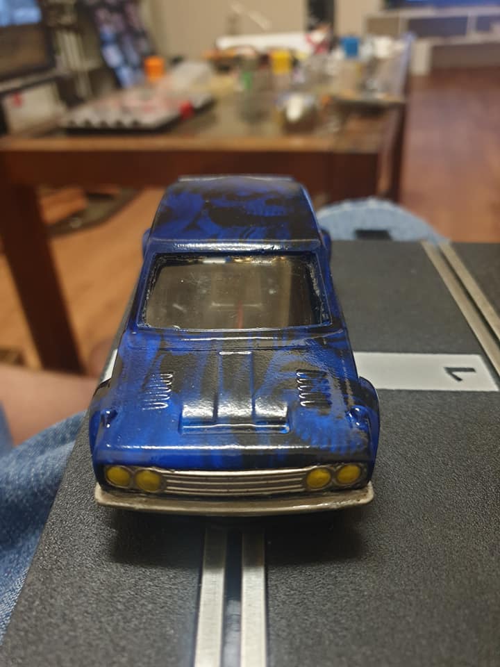

Leo, I think that is the idea behind the whole hydro-dipping scene, to get those wacky paint jobs. I'd say hydro-dipping is similar to that of the Rat Rods or even Air Brushing as we see on TV shows such as Counts Kustoms.
A few examples of what can be accomplished by Hydro-dipping. Images by Ben Dalriada Matheson on Facebook:
https://www.facebook.com/groups/252867758736189/
images remain property of Ben Dalriada Matheson.
[attachment=7413] [attachment=7414] [attachment=7415] [attachment=7416] [attachment=7417] [attachment=7418] [attachment=7419] [attachment=7420] [attachment=7421] [attachment=7422]

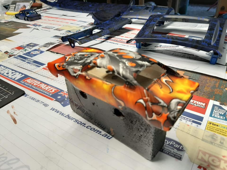

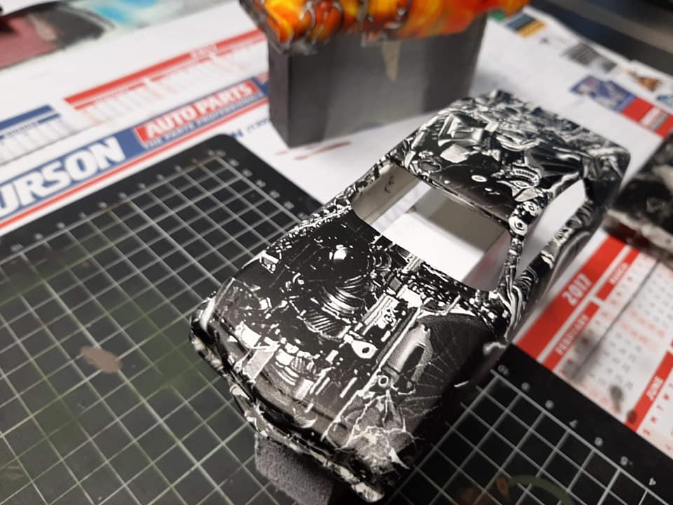

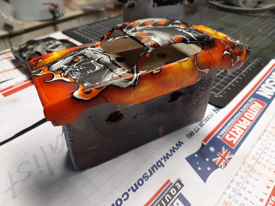

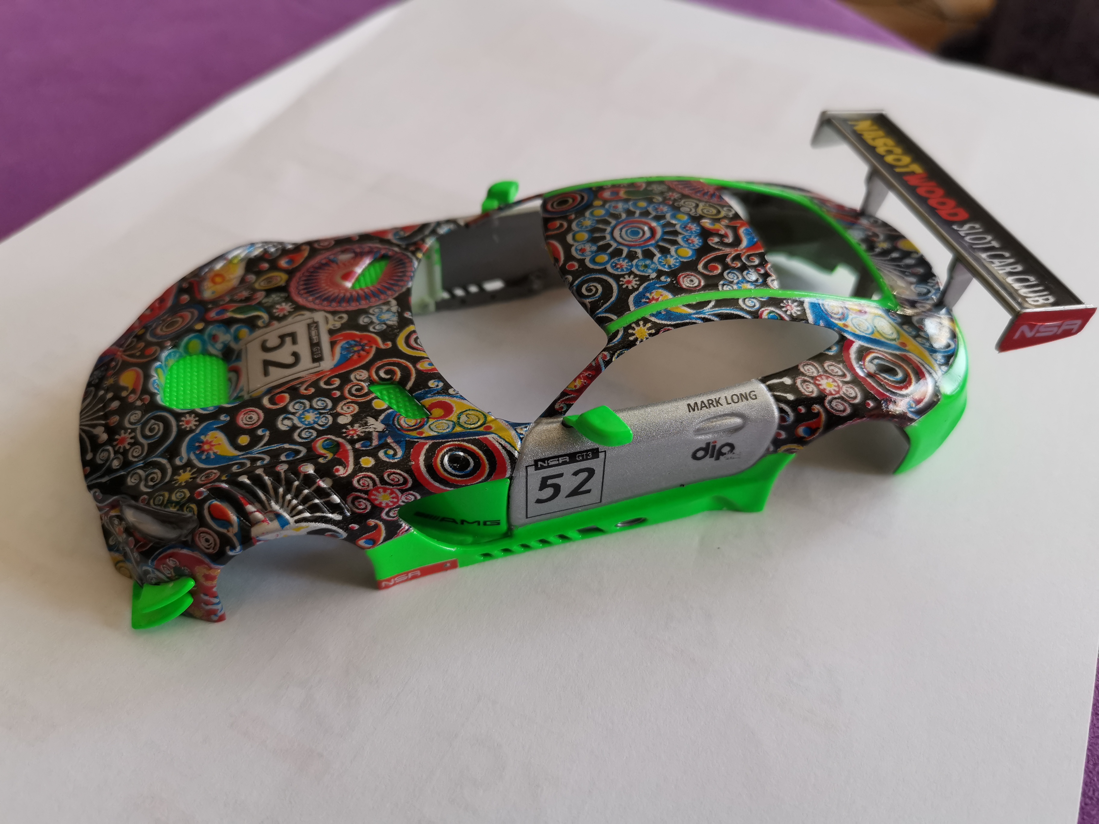

155Stick - 9th-Jul-20
You can also mask area's off so they don't get dipped.[attachment=7505]
RE: Hydro-dipping -
DPJ - 9th-Jul-20
(9th-Jul-20, 04:03 PM)155Stick Wrote: You can also mask area's off so they don't get dipped.
Wow that's a busy livery! How'd you do that one?
