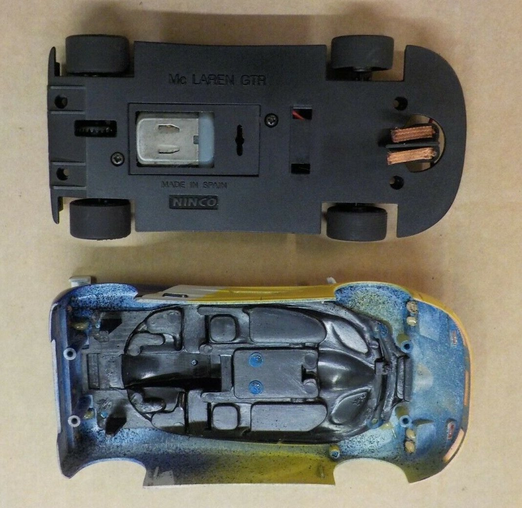

The Ninco NC1 is a short can, can-end drive motor. These are used in some proxy race events and can be replaced with an equivalent known as BWA S-Can motors.   However, the BWA motors are not generally available anymore.

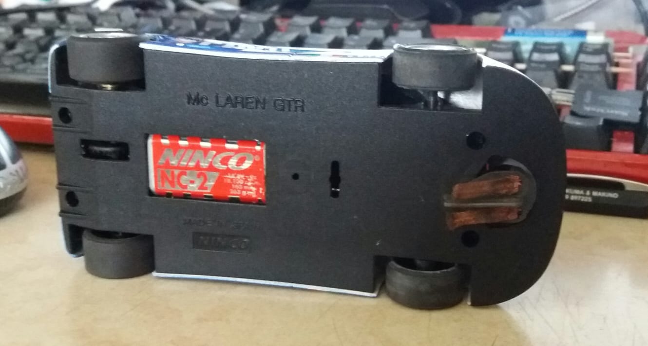

However, my Ninco McLaren F1 has a long can Ninco NC2 motor with no pod.  I don't know much about these cars so don't know if they had differing types of chassis.  Is your car's chassis identified as for the GTR?

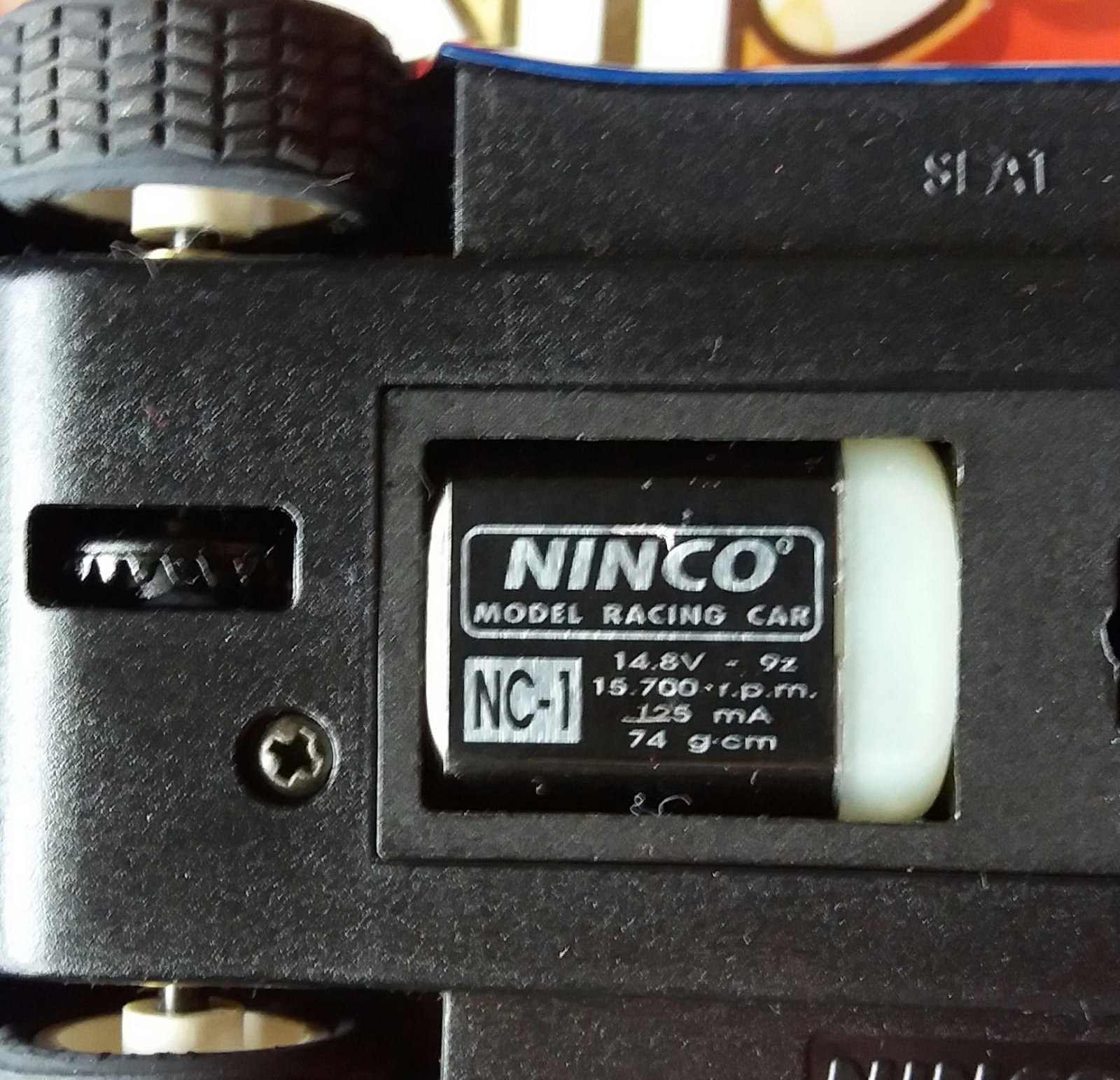

I just found an F1 GTR on Ebay that has the motor pod and short motor.
[attachment=7214]

Same chassis as per your second picture with the removable pod. The original car was a Gulf No33 I believe which was a rather battered purchase and in its own right is my favourite go to for some home racing fun. Having upgraded so far it is so much quieter & smoother but deserves a better motor. Car has been completely resprayed.
