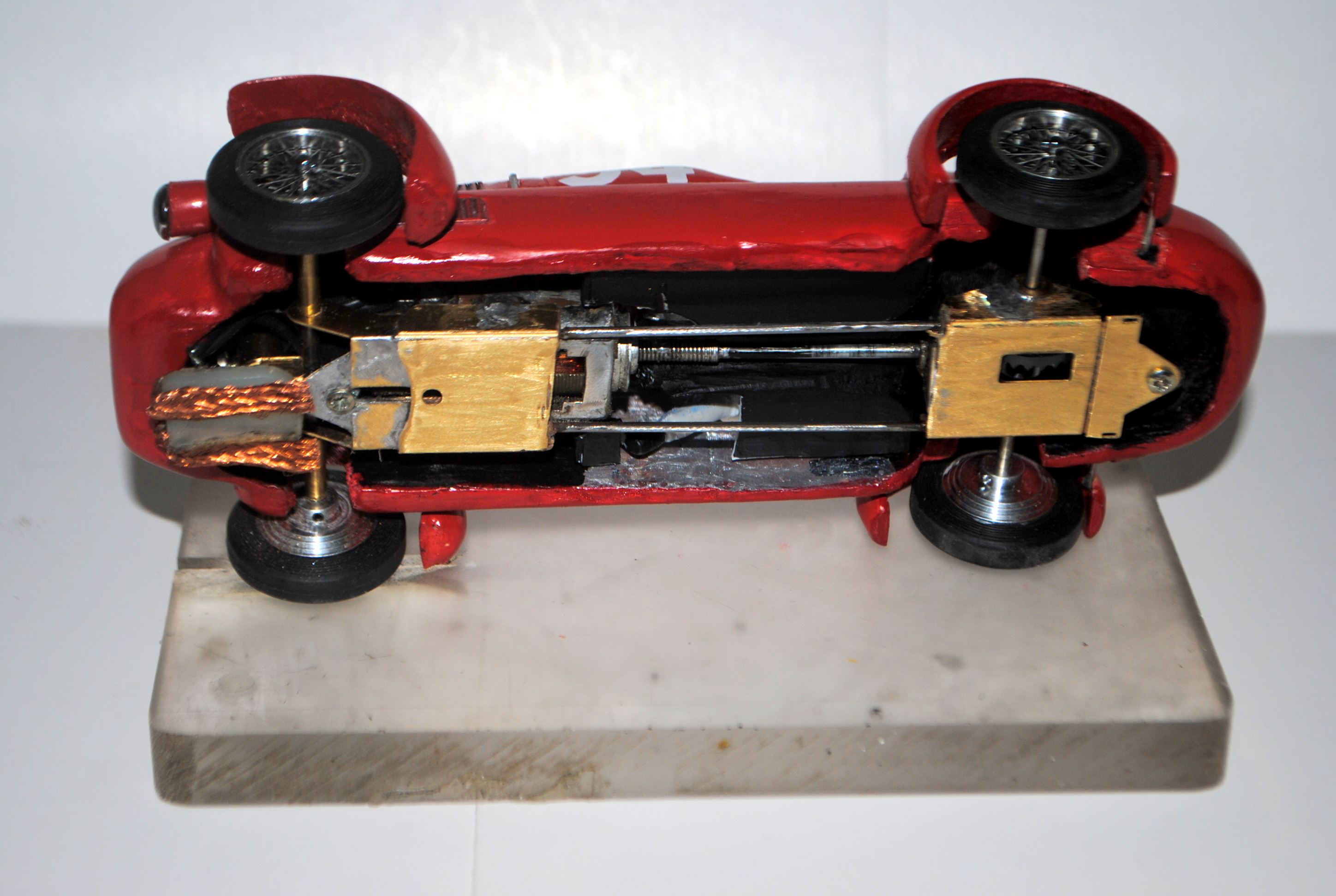

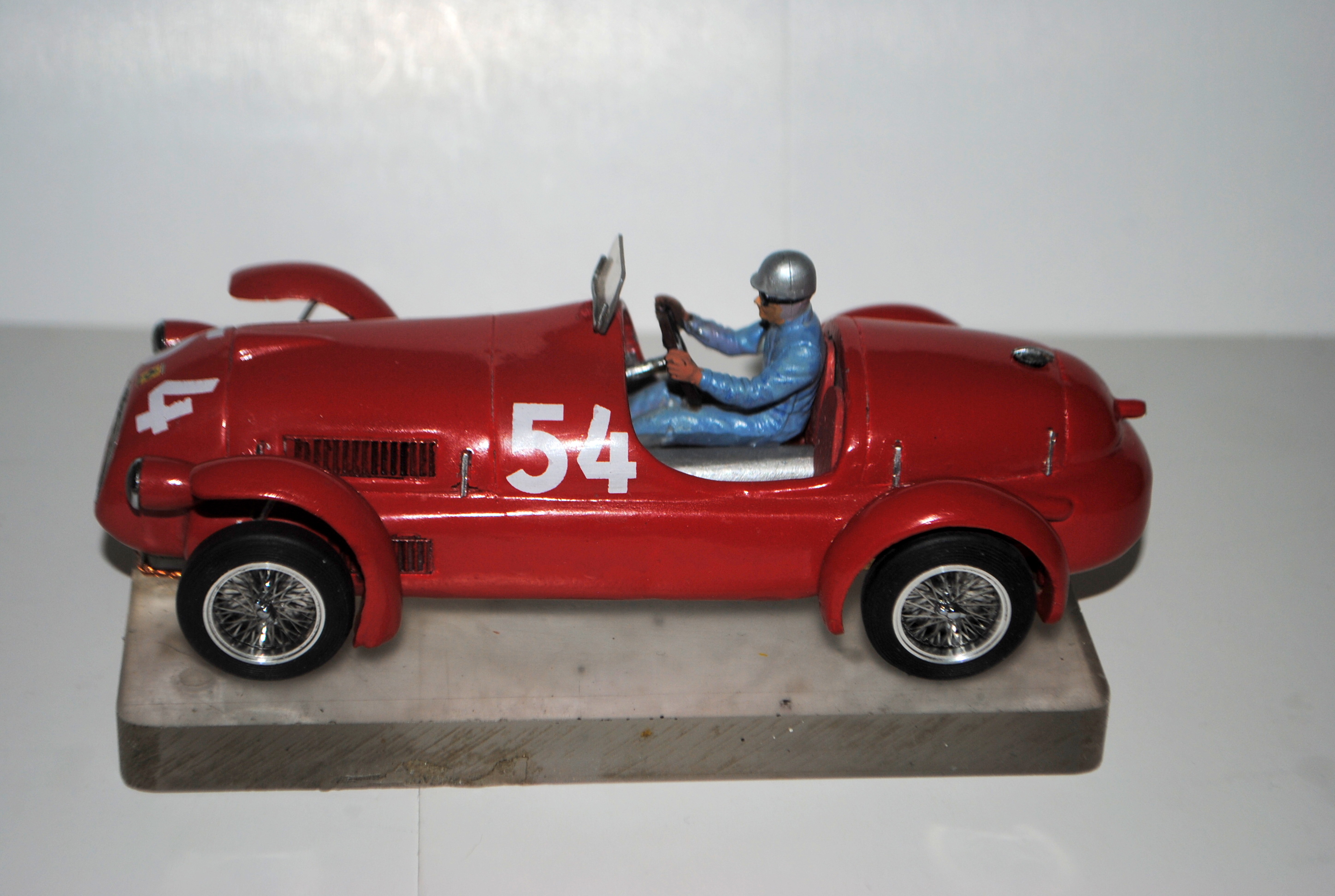

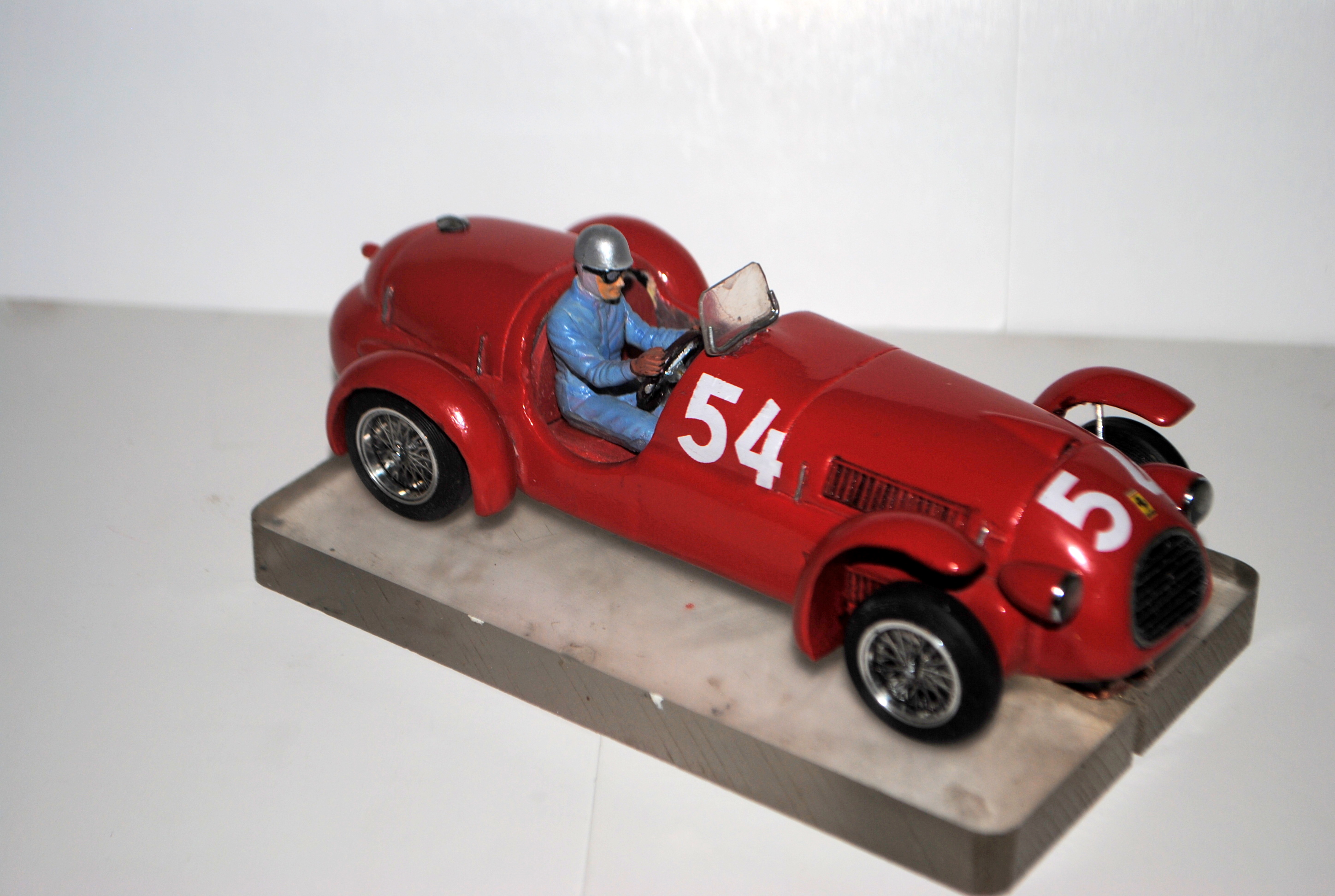

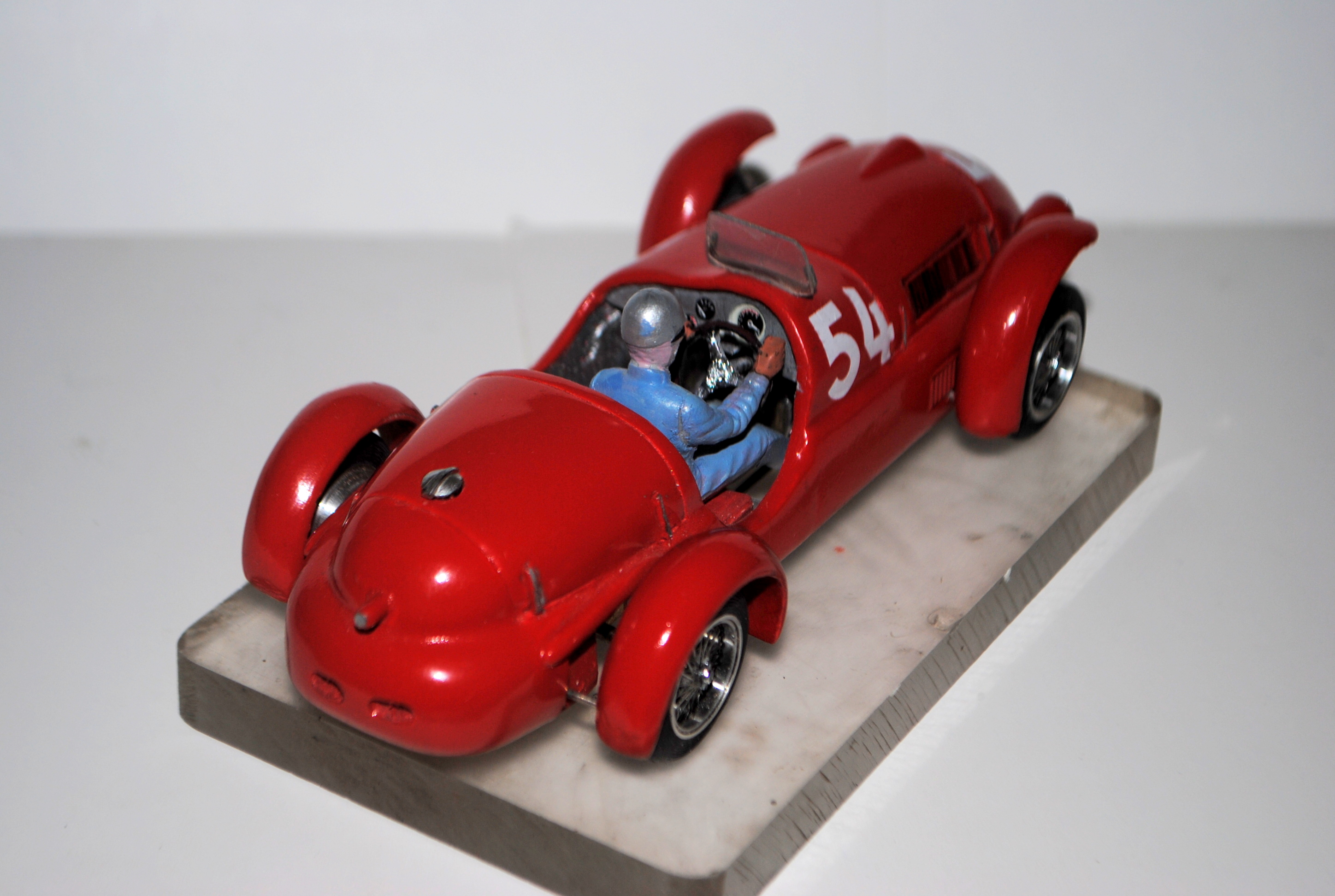

1/24th Slot Car
Gordon gave me this body a couple of years ago and it has sat in my to do shelf since then. With this current enforced lockdown, decided to get it out.
As Gordon had done a superb job on the interior as well, it would have to be a FWD car. As I wanted to use as much vintage equipment as I could, I deci9ded on a 13 UO as there really was not a of of space there. I used the Fly FWD idea of a spring holding the 2 shafts together and built a rear bearing holder to centre the pinion to the contrate.
At the moment, it has modern replacement wheels designed for the e old Scalextric Bentley/Alfa which fit quite nicely and kinda look the part.
I hope my small homage can testify to Gordons superb artistry.

RE: Ferrari 166 S (Spyder Corsa) - Gordon Steadman - 25th-Apr-20
I'll let you off the numbers as you've done such a nice job Thumbup
Great to see it done, how does it go?
RE: Ferrari 166 S (Spyder Corsa) - Anthony B - 25th-Apr-20
I need to find Urethane tyre as they are rubber so it slides - also need a little weight in the rear !!
I will bring it to Bordo in Dec ;)
Yes
One hopes!
