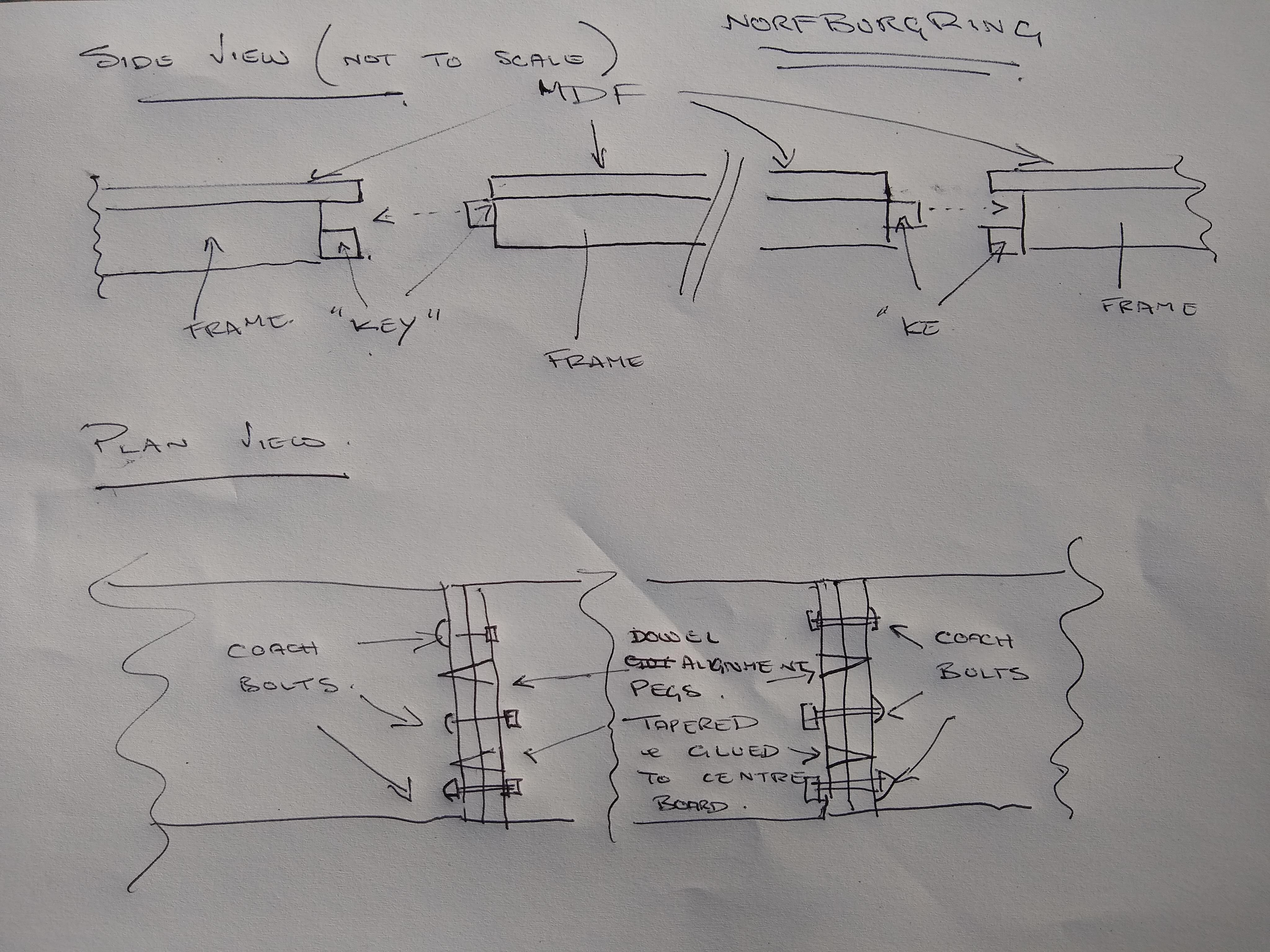

RE: Norfburgring Joins -
PloughJockey - 5th-Feb-20
Hi
Attached sketch shows how the joints align and are locked in place. The dowel pegs are slightly tapered at the ends to gain initial rough alignment and guidance, so when the coach bolts pull the boards together the dowel tightens, this brings everything true.
If I was doing this again I would use hardwood for the interlocking battens rather than the pine I used.
As the copper tape wraps over the edge of the MDF board the achieves continuity but this is not reliable so I back this up with additional multi pin plugs between each board.
[attachment=5528]

RE: Norfburgring -
john roche - 5th-Feb-20
Thanks for the sketch. I've rewired my track and am considering the best way to join and dismantle it. It was previously fixed but we are considering moving house so I want it to be portable.
John
RE: Norfburgring -
PloughJockey - 6th-Feb-20
Hi John
A second time round I would use hardwood for those battens as it would be less prone to distortion. I used 4 pin aviation plugs and sockets as they can be locked in place. I wish I had opted for 90 degree bend as they would stick out less. I originally had Molex connectors but ditched them as they too difficult to get apart.
Good luck with the build.
