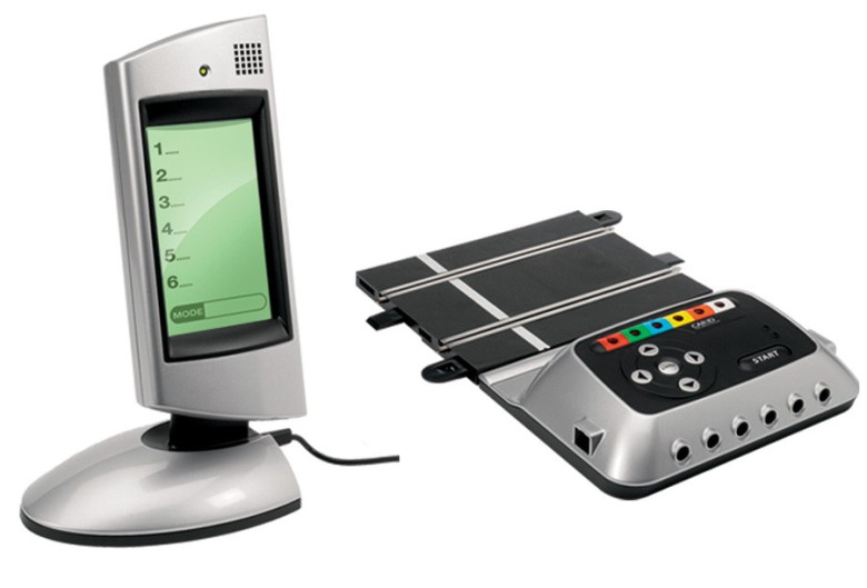

On its own, the APB is not that easy to use and is expensive. What you get for £165.99 is the powerbase and an LCD tower...
[attachment=5488] [attachment=5489]

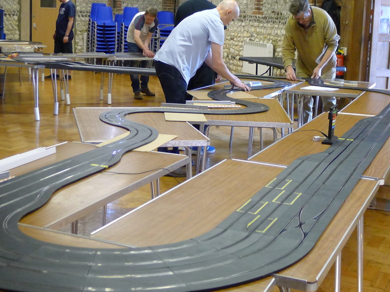

Before I go on to look at software options, there is another piece of hardware that is recommended - pit lane sensors. Although not essential - ARC Pro does not have them and that's not the end of the world for me - they do add an extra feature to the APB digital racing experience. With the sensors, the digital race management programs can sense when a specific car is in the pit lane, slow that car to the pit lane speed limit and open the pit menu automatically (if this feature is chosen).
There are two options for Scalextric Sport Digital pit sensors, Riko Rocket's Pit Pro Deluxe (and the original Pit Pro) that is based on a highly-modified Pit Lane Game; and the Smartracing Smartsensor. Pit Pro Deluxe is available from Riko's website (
www.rikorocket.co.uk/products/pit-pro-deluxe) and costs £100. Smartsensor costs 75 Euros and is available from
smartracing.dk in Denmark. We use Pit Pro at WHO/digital...

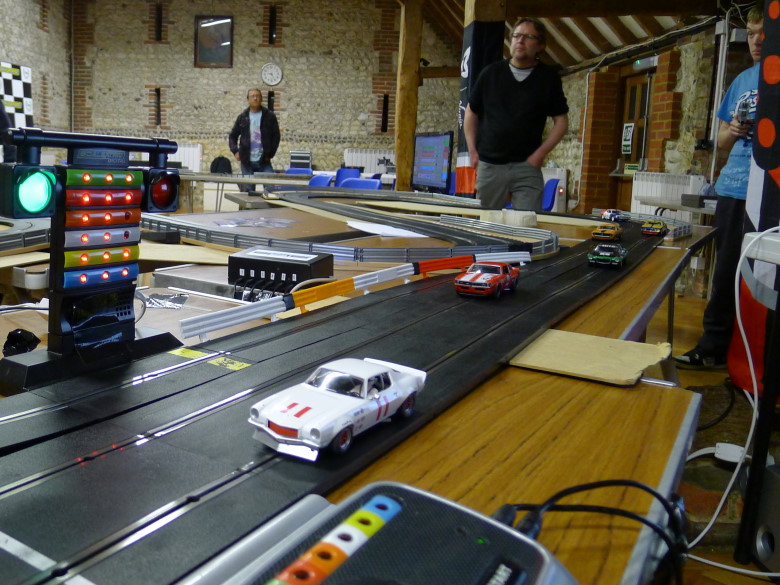

[attachment=5491]
You can see the pit-entry sensor located at the yellow line by the Pit Lane Game tower on the right of the picture. If you follow the pit lane round, you will see the yellow line to indicate the pit-exit sensor. Not only do the sensors add to the detail of the digital simulations, most software programs offer some excellent pit lane sound effects!

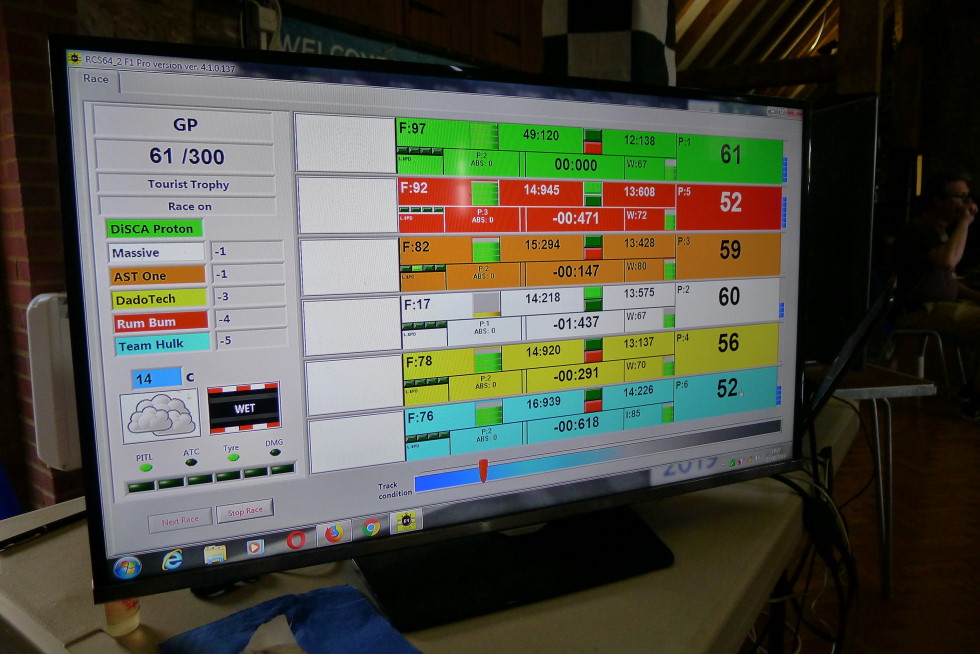

Race Control System 64 (RCS64) - a program developed specifically for the APB by Martin Schmidt and Marcel Minnaard. In addition to a fuel simulation, RCS64 offers tyre choices, variable weather conditions, simulated grip, brake fade, plus a damage simulation. It is an immense piece of software with huge scope for the sort of user-customisation that still gets me very excited. Three years of using RCS64 has taken our digital racing to a level where we can deliver scale versions of actual motorsport formats - most famously, perhaps, our BTCC race day, but also some fabulous GT3 and Trans-Am racing.

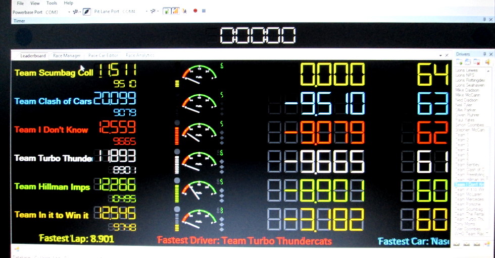

Perhaps because of the complexity of the software, RCS64 accentuates some of the problems with digital simulation racing - there is just so much information to process. As well as driving fast, you have to negotiate up to five other cars, planning and executing clean overtaking manoeuvres. You need to be aware of tyre wear, weather conditions and fuel consumption - and plan pit stops accordingly. That's why we adjust our formats to introduce simulations gradually on our Wednesday evenings and use plenty of team and pairs racing where co-drivers can relay data from the RCS64 screen and call the driver into the pits - just like the team radio in real motorsport events.
[attachment=5492]
As you can see, the screen is full of data. It really is a full-time job for the those not driving to study and make judgement calls. A recent Trans-Am pairs race was won because the non-driving teammate could see the track drying more quickly than usual and made a brave call to change to hard compound tires before everyone else. Not that we use all the simulations in every race - less is often more. Our BTCC races have no pit stops - although the tyre wear on the soft (option) tyre means the car becomes difficult to drive by the end of the race. If you get the simulation settings just right, RCS64 is so excitingly and wonderfully realistic. I have produced some guides to using RCS64 on the WHO/digital website:

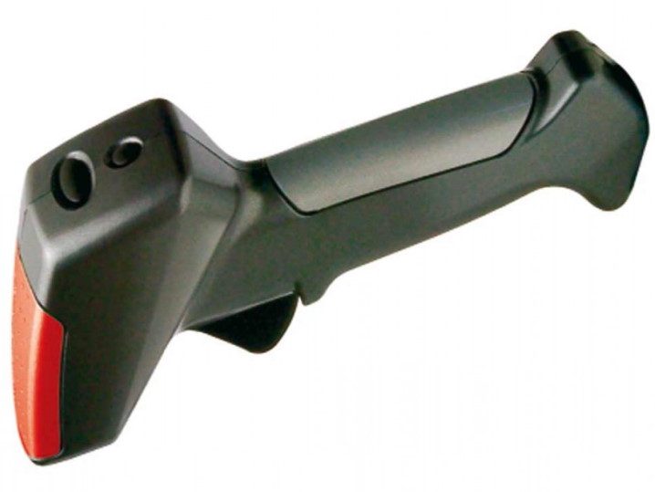

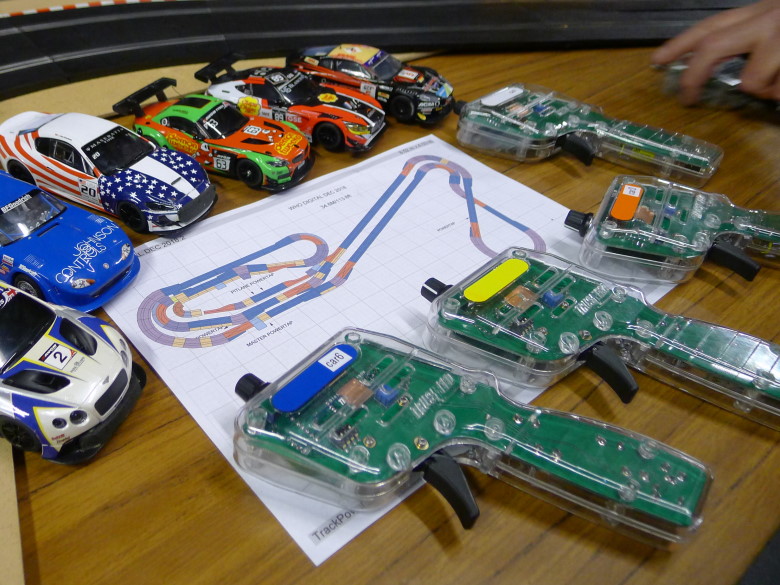

The original Scalextric Digital Controller (C7002) which plugs into the APB looks like this...
[attachment=5495]
They are nice and chunky, with a big brake button above the smaller lane-change button on the back of the handle. Interchangeable 'caps' match with the colour on the powerbase the car is connected too. The spring in the controller is way too stiff, but these can be easy swapped for a softer one - if you have access to a friendly hardware store, or you can try Parma springs. The controllers also succumb to wear and tear. Cleaning with contact cleaner from time to time does help, but we did get through quite a few controllers at the club. The other issue is that the cables are quite short and 2.5mm mono jacks extenders aren't always of the best quality - better than six people standing on top of each other though.

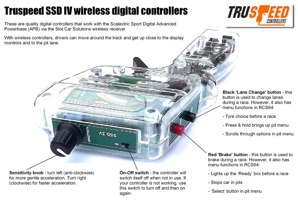

- Truspeed SSD III wired controller (www.truspeed.co.uk) - cost £45 each and are a direct plug-in replacement for the Scalextric controller. These look and feel very much like the Truspeed analogue controllers - well made, adjustable spring tension, sensitivity control knob, plus lane change and brake buttons for digital racing. They come with a 1.6m cable.
- Truspeed SSD IV wireless controller (www.truspeed.co.uk) - cost £57 each, although currently not available. These work with the Slot Car Solutions wireless receiver box (£85), which plugs into the APB. The layout of the controller is the same as the SSD III and they can also be used as plug-in wired controllers with an optional cable.
- Slot.it SCP2 Controller with Scalextric C7042 cartridge (Pendles here on sale at £79.99). This is another direct plug-in replacement for the Scalextric controller. The SCP2 is a high-quality wiperless controller that is used by analogue and digital racers - having interchangeable cartridges to work with different systems. It has huge potential to customise various performance settings. The SCP2 will only work with the APB using the E-3V3 cartridge. The reference for the controller + APB cartridge is SCP201dz1.
- Scorpius Wireless Controller (www.scorpiuswireless.com) - cost $119 each. A Scorpius Wireless Dongle ($79.95) fits into the USB port of the computer - the controllers communicate with the dongle and control the cars via the race management software (SSDC, RCS64, PC Lap Counter etc). Nothing is plugged into the APB, so cars can only be run with the race management software active.
After considering the options, we decided our controller upgrade at WHO/digital would be the Truspeed SSD IVs and the SCS receiver box...
[attachment=5498]
The controllers themselves are a huge step up from the standard C7002 throttles. The wireless aspect is brilliant - our events take place in a large hall, so being able to walk around and choose an ideal driving position is perfect. Most of the controllers have required only an occasional clean and change of alkaline batteries. A couple have had problems that we've sorted successfully with help and advice from Steve Hills at Truspeed - excellent customer service.

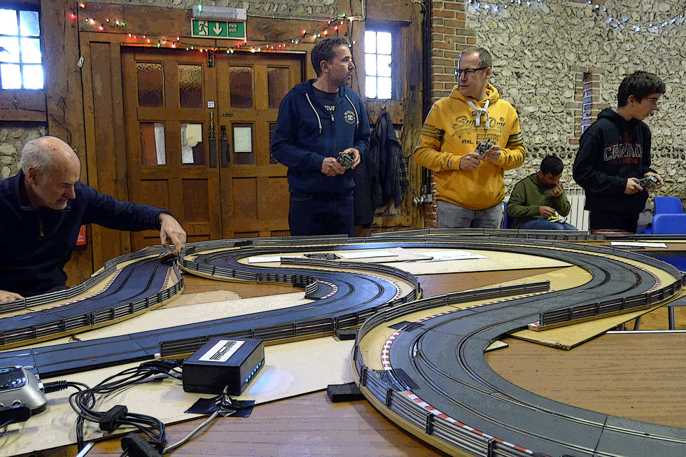

This is a graphic we produced for our racers and Steve has used on his website...
[attachment=5497]
The SCS box has performed well for us - so long as it is positioned near the middle of the room. Our hall is about forty foot long, and we found reception could become marginal beyond twenty feet, probably not helped when batteries get a little low. Here's the SCS box in front of some WHO/digital racers and just next to the APB...
