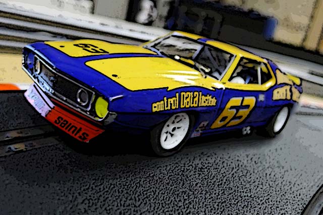

[attachment=5442]
One example is my WHO/digital Trans-Am - a Scalextric AMC Javelin. Over two years (eleven races), Ash and me have developed it to be one of the better cars on the grid - but it certainly wasn't to begin with. I ended up adding more weight, moving the weight around and eventually taking some out. I now tend to use tungsten putty as it is easy to add, remove and move. The car worked better on some tracks than others, so it was about making it a better all-rounder and also learning how to adjust our driving. It was a lengthy development process, but worth it with two wins last season and pole position ten days ago.
