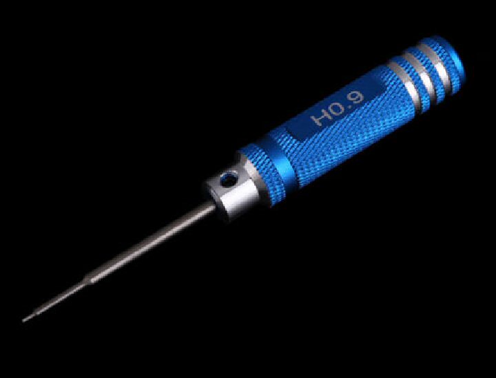

[Image: hexM2.jpg]
Likewise in the larger M2.5 size, we are offered 1.27mm and 1.3mm. I haven't really seen any difference, and due to the
larger dimensions, I suspect that for all practical purposes, they are interchangeable.
Any of the cheap RC tools seem to be fine.
