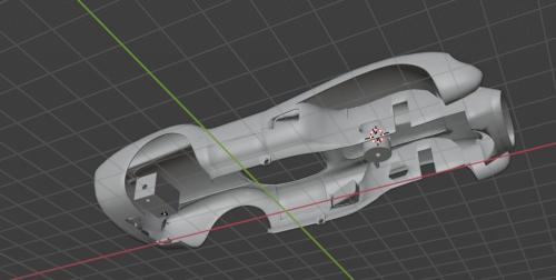

RE: What cars have you built and latest bodies from 3DP - AlexisGaitanis - 11th-Nov-22
I just finished a Ferrari Testarossa
[attachment=27170]
the chassis is very simple,pod designed specially for slim motor because there is not much room in front .
[attachment=27171]
[attachment=27172]
Everything,except motor axles wires screws and braids,is home made,either 3d printed or vacformed
It was the best file i have printed so far,with the body removed
[attachment=27173]
and the body with body posts added
[attachment=27174]

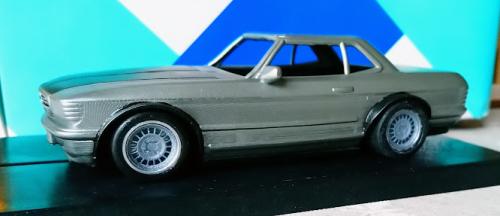

RE: What cars have you built and latest bodies from 3DP - Kevan - 11th-Nov-22
Mercedes 450SLC.
[attachment=27186]
[attachment=27187]
[attachment=27188]

RE: What cars have you built and latest bodies from 3DP - Kevan - 23rd-Nov-22
(11th-Nov-22, 12:55 PM)JMay Wrote:  Interesting chassis Kevan, what does the top side look like.
            JMay.
Hi John,
Yes an interesting experiment. I've built two like this, one for a Mini and this Merc. It's a lot more work to get finished compared to a rigid chassis, to be honest there isn't any performance gain so I've gone back to the rigid chassis for future builds.
I'm currently working on a '65 Mustang for the Rally Slotting Proxy and that's got both types but the flexy pan chassis isn't going to be used as two centreline body posts and a floating bodyshell seems to handle better.
