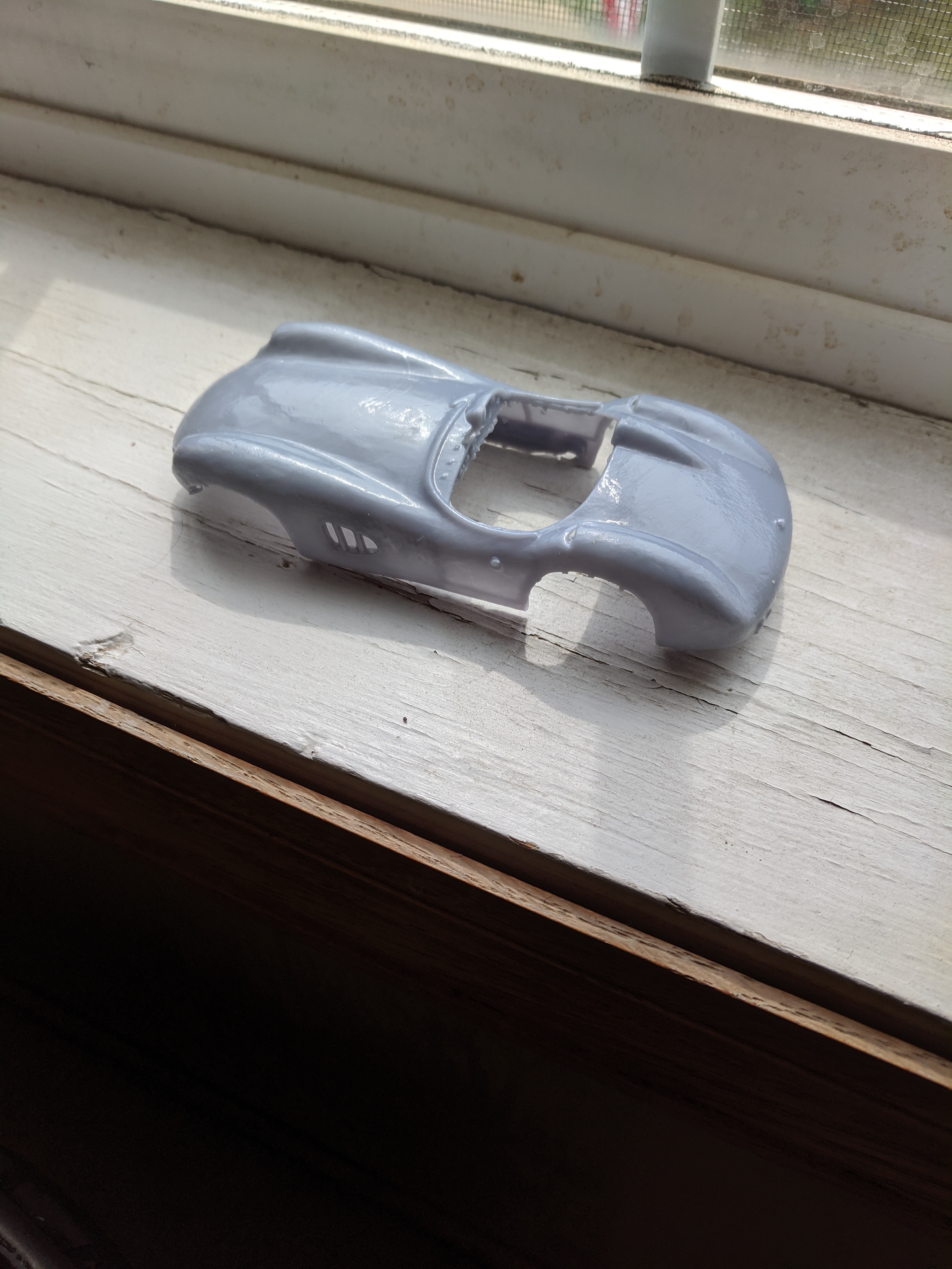

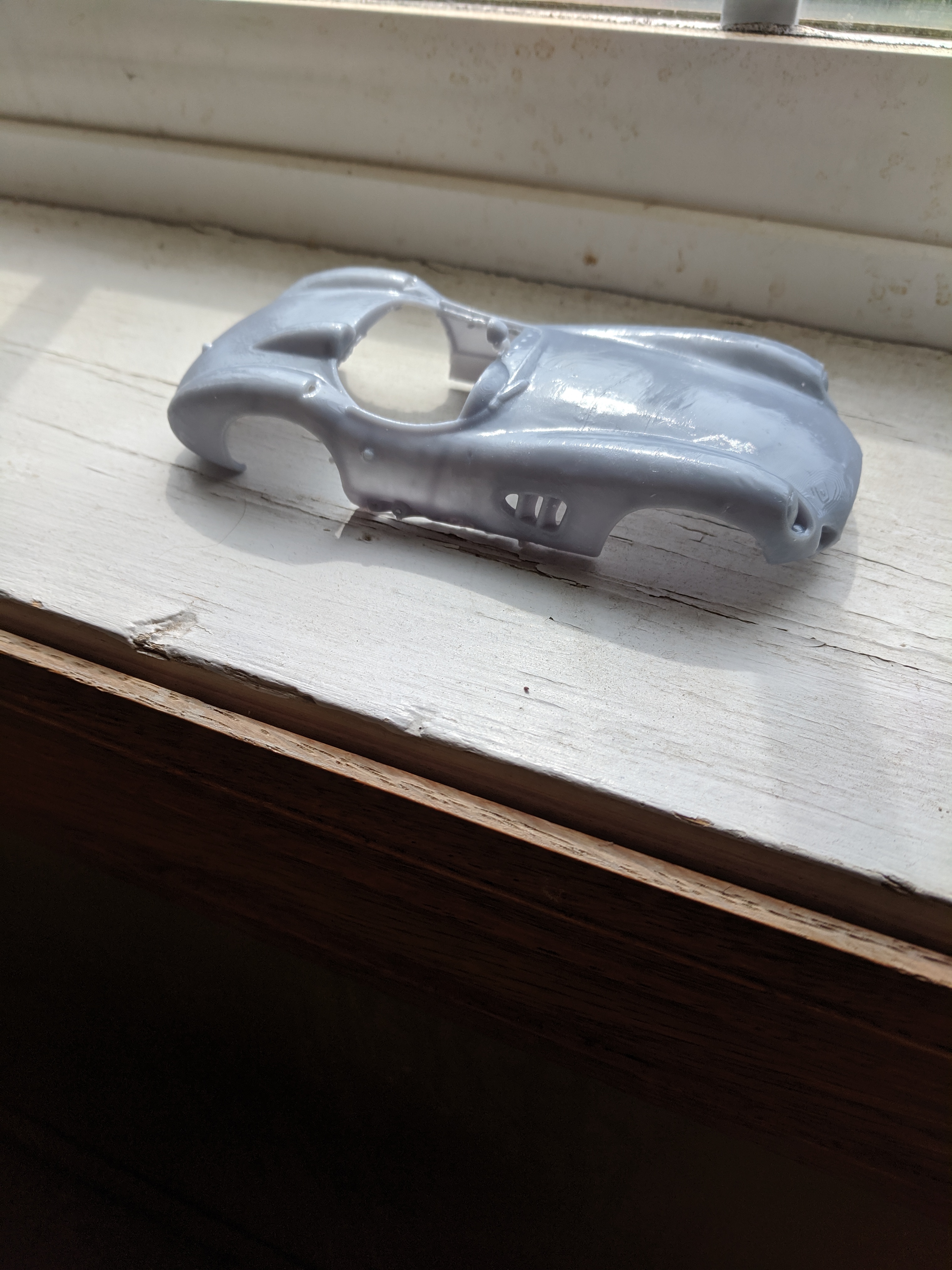

Aston Martin DBR1:
[attachment=24657]    [attachment=24658]    [attachment=24659]

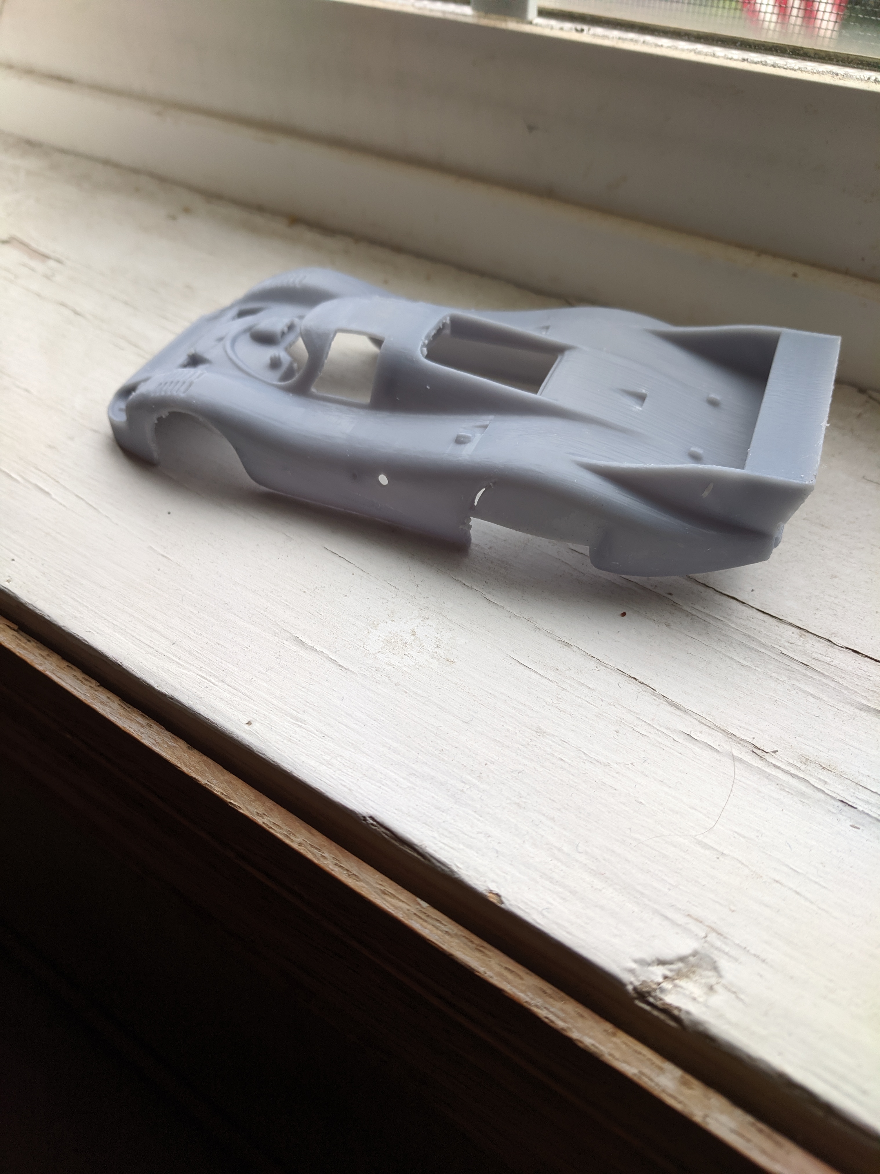

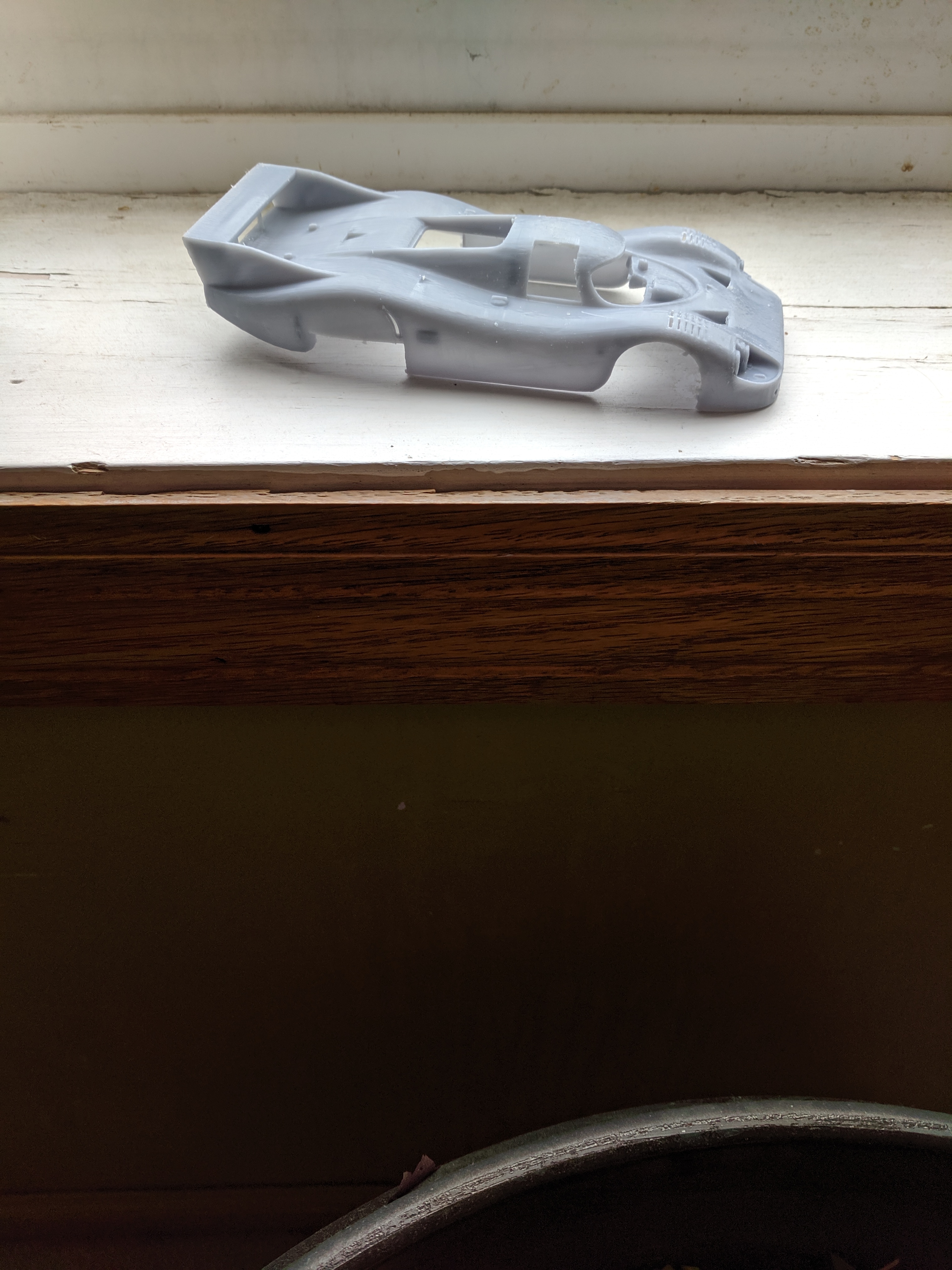

And the 1971 Porsche 917LH:
[attachment=24660]    [attachment=24661]     [attachment=24662]

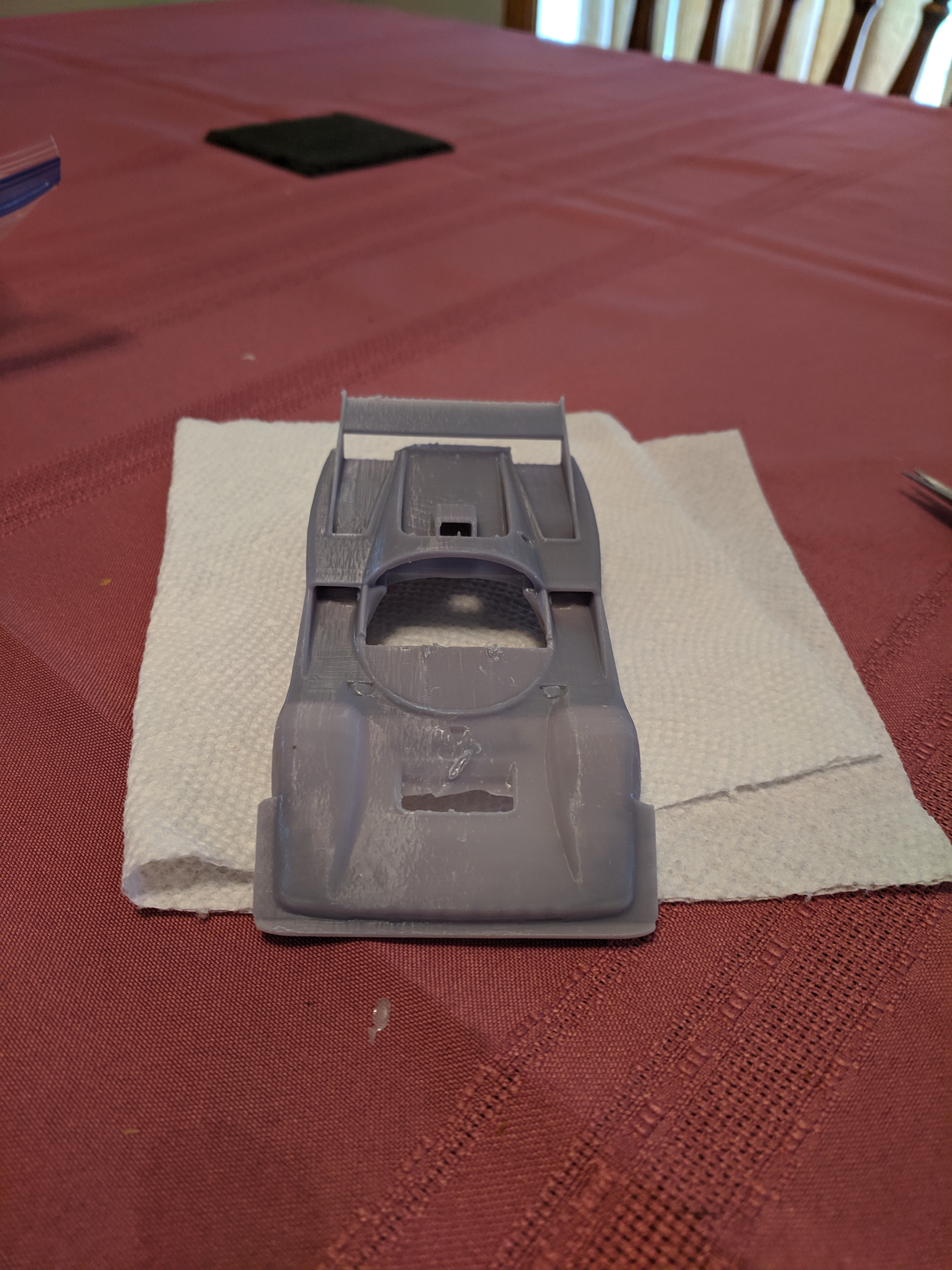

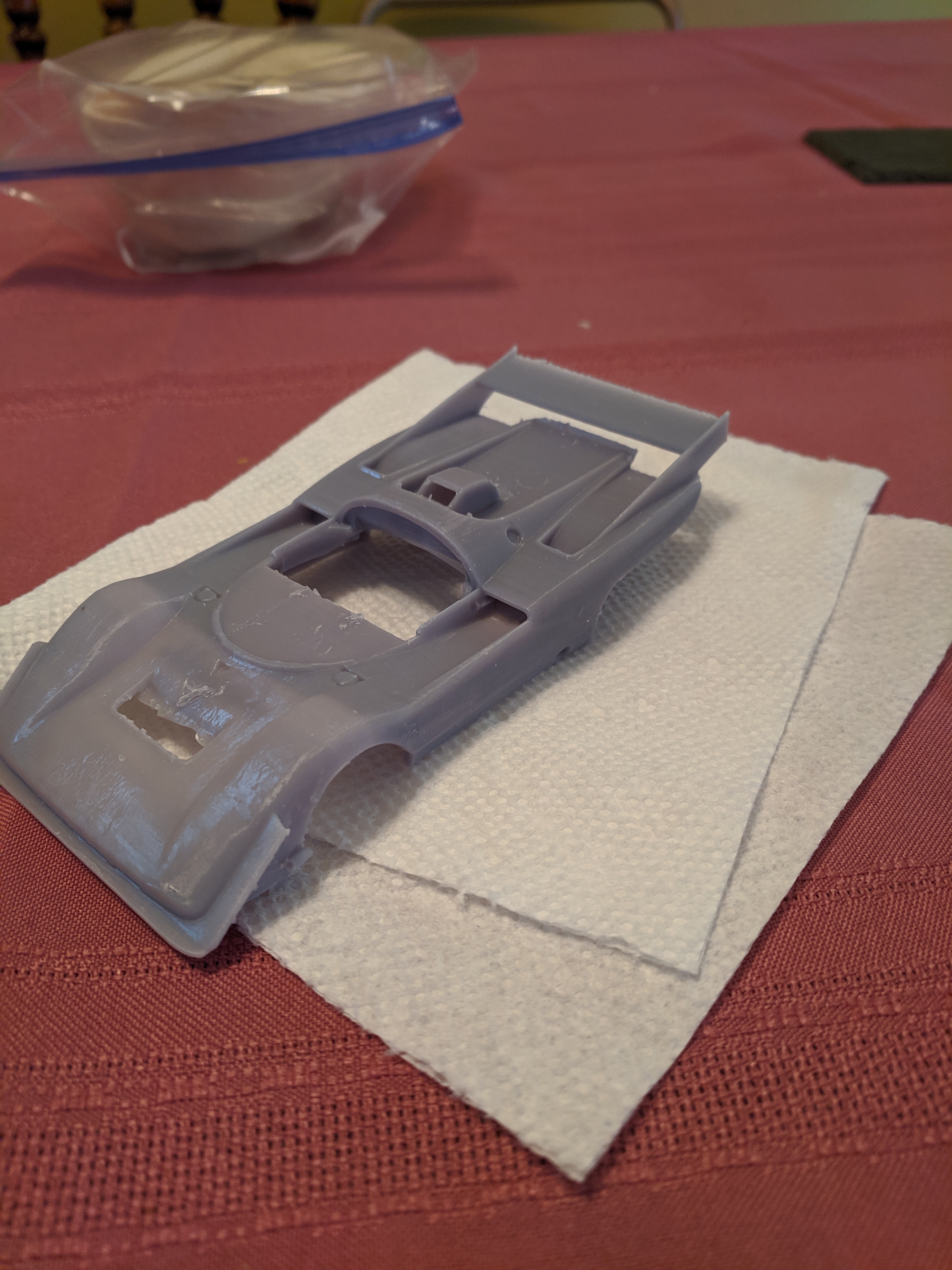

My modifications to the 512M file to create the Muller 512M Spyder.
[attachment=25098]
[attachment=25099]
[attachment=25100]
Using the Anycubic Tough.
