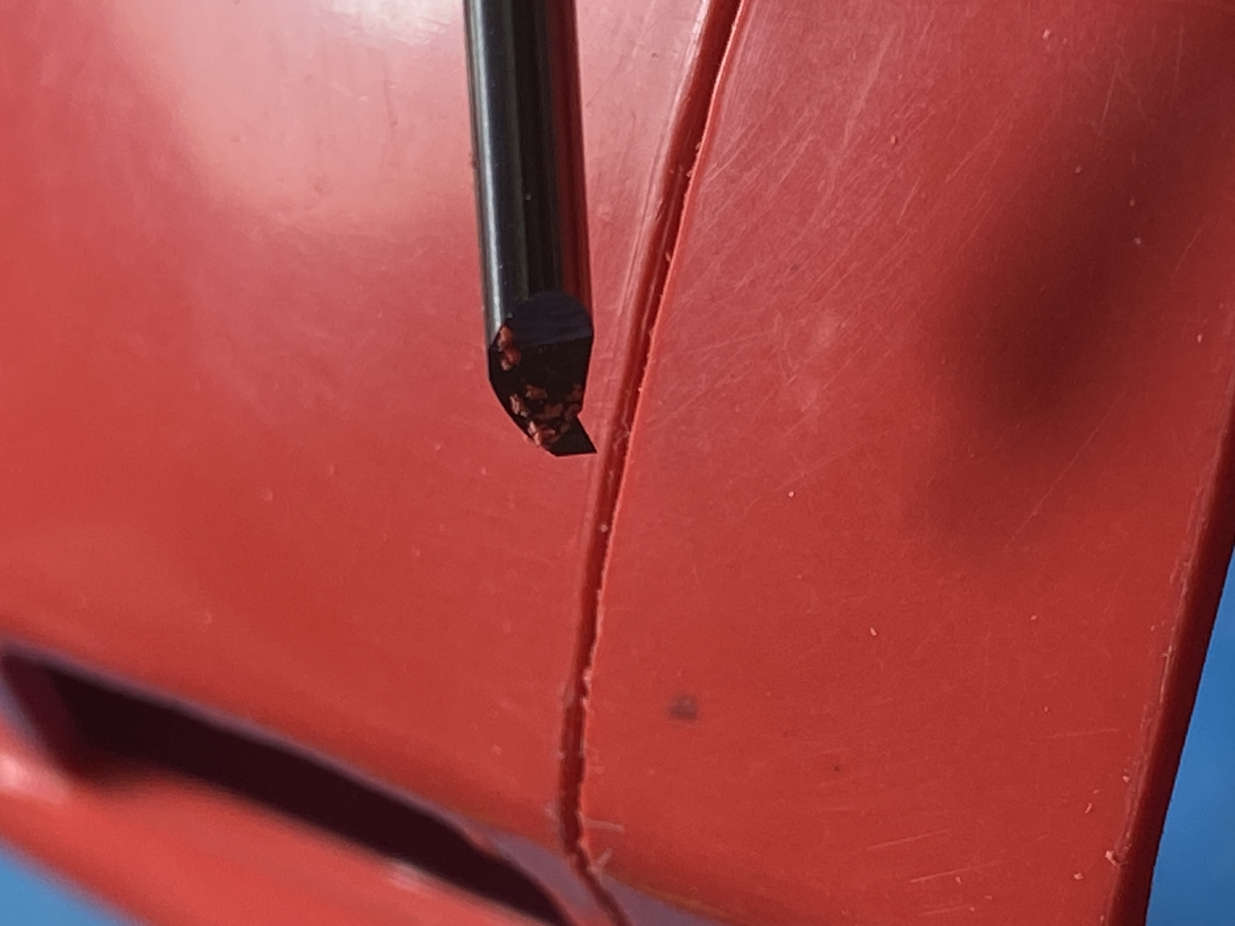

Could you please post a close-up of the end of that tool you made to score through the plastic
RE: Ferrari 250LM - Tibbs - 16th-Oct-24
(14th-Oct-24, 12:42 PM)Anthony B Wrote:  Fantastic work and learning loads - thanks so much for keeping the updates flowing here!!
PS - I looked for my first ferrari with the poor brass chassis - sadly it is no long with me - must have passed it on a few years back!!
Someone is lucky to be holding that in their collection Thumbup
RE: Ferrari 250LM - Tibbs - 17th-Oct-24
(16th-Oct-24, 07:22 AM)Kevan Wrote:  Could you please post a close-up of the end of that tool you made to score through the plastic
I'm not sure I can get much closer Kev with out distorting the pic.
It's a Tamyia fine engraver and it goes into a pin vice.
I'll try and take another pic.
RE: Ferrari 250LM - Kevan - 17th-Oct-24
I just googled 'tamiya fine engraver' and all became clear  Thumbup

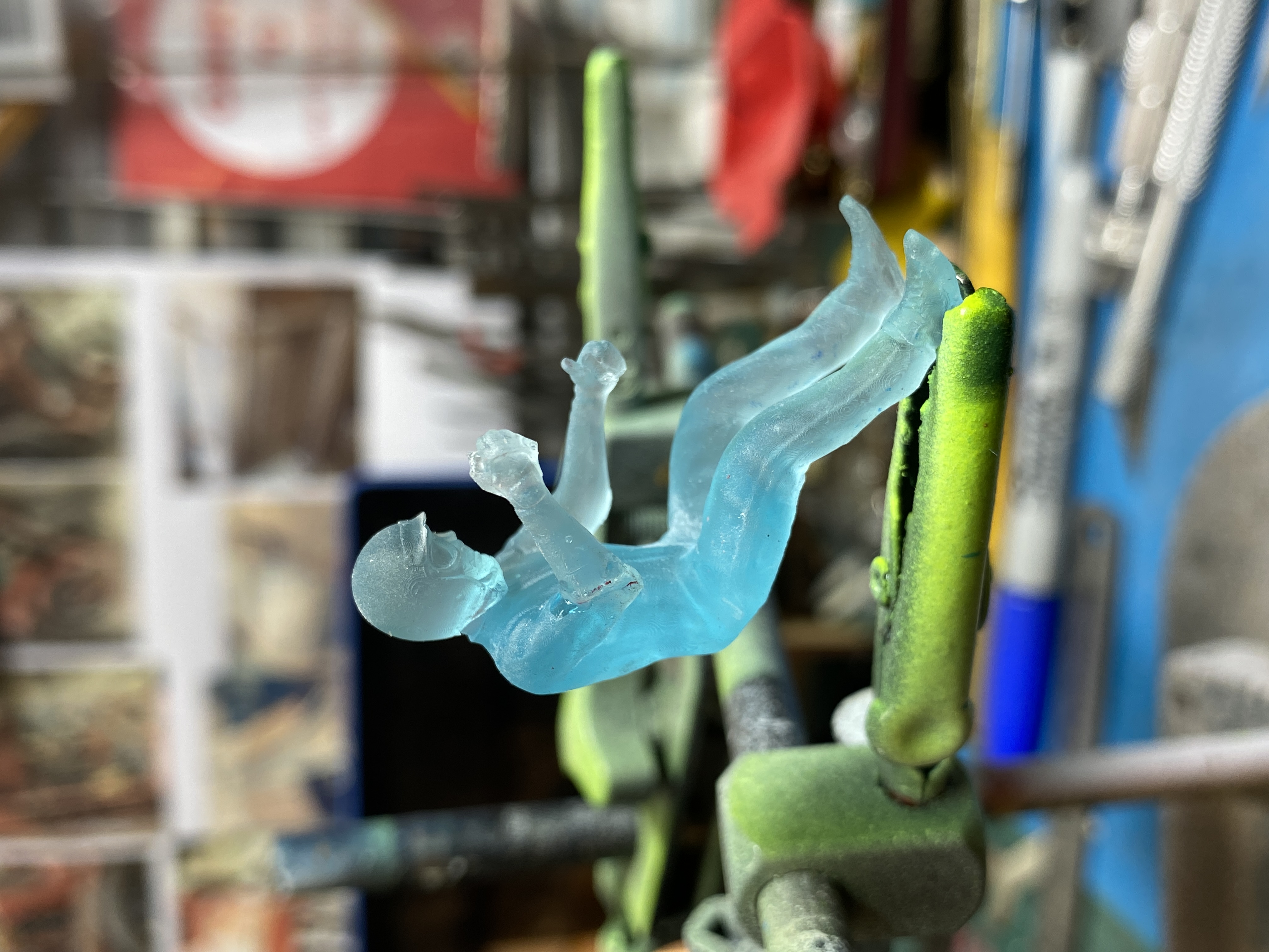

I've got the drivers door closing on a tiny magnet, I'll have to look up how to post a video again as I've forgotten.

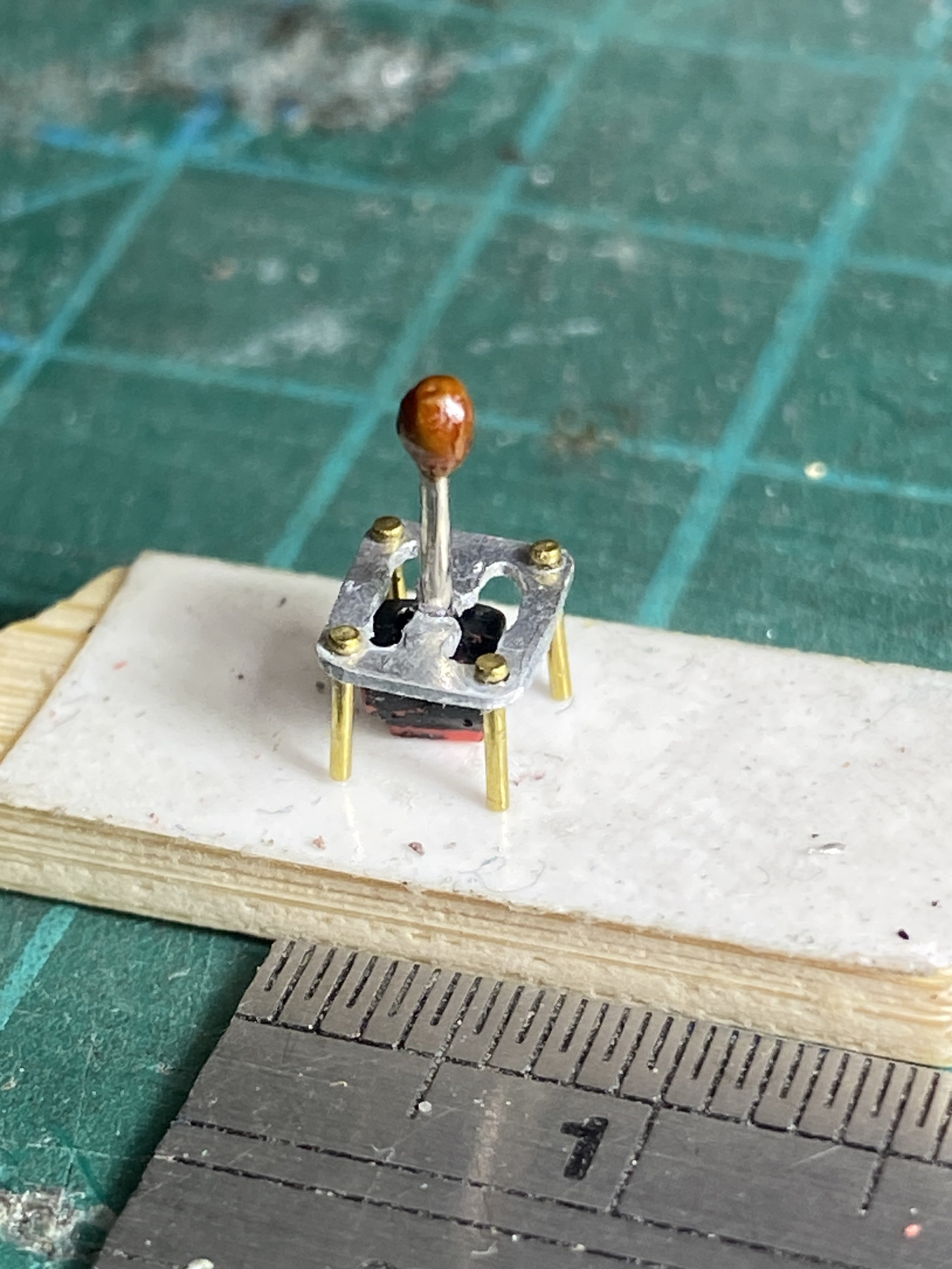

I've got the driver painted up and cut and moved his arm so he's sort of waving out the window, the dash is all scratch built and steering column and gear leaver.
