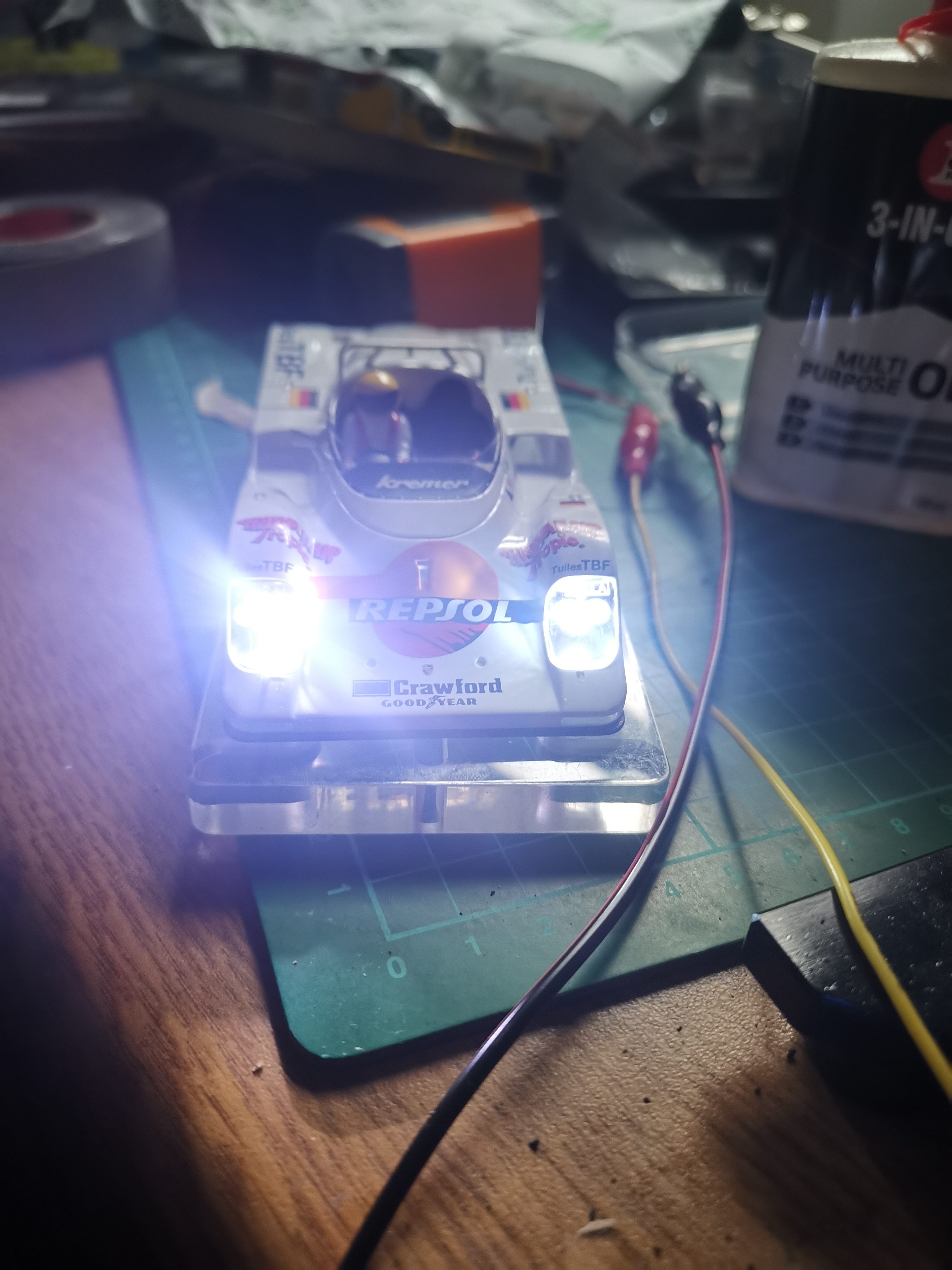

(14th-Jun-21, 06:32 PM)Graham Wrote:  All fitted with lights  Idea
Oreca has lights. A zmachine quad yellow set
The oreca is a a reworked survivor of a DiSCA event.
The other 2, i'll rig up something but probably not a  full set.

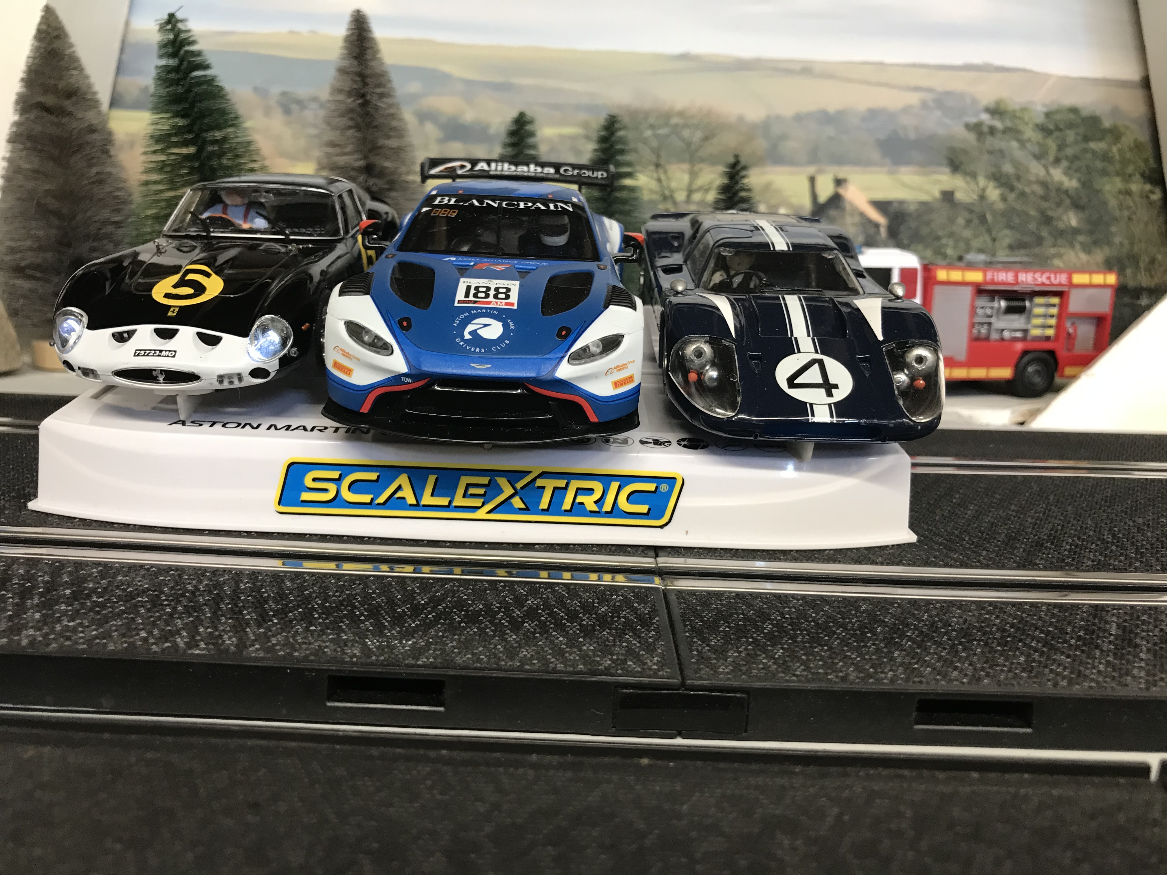

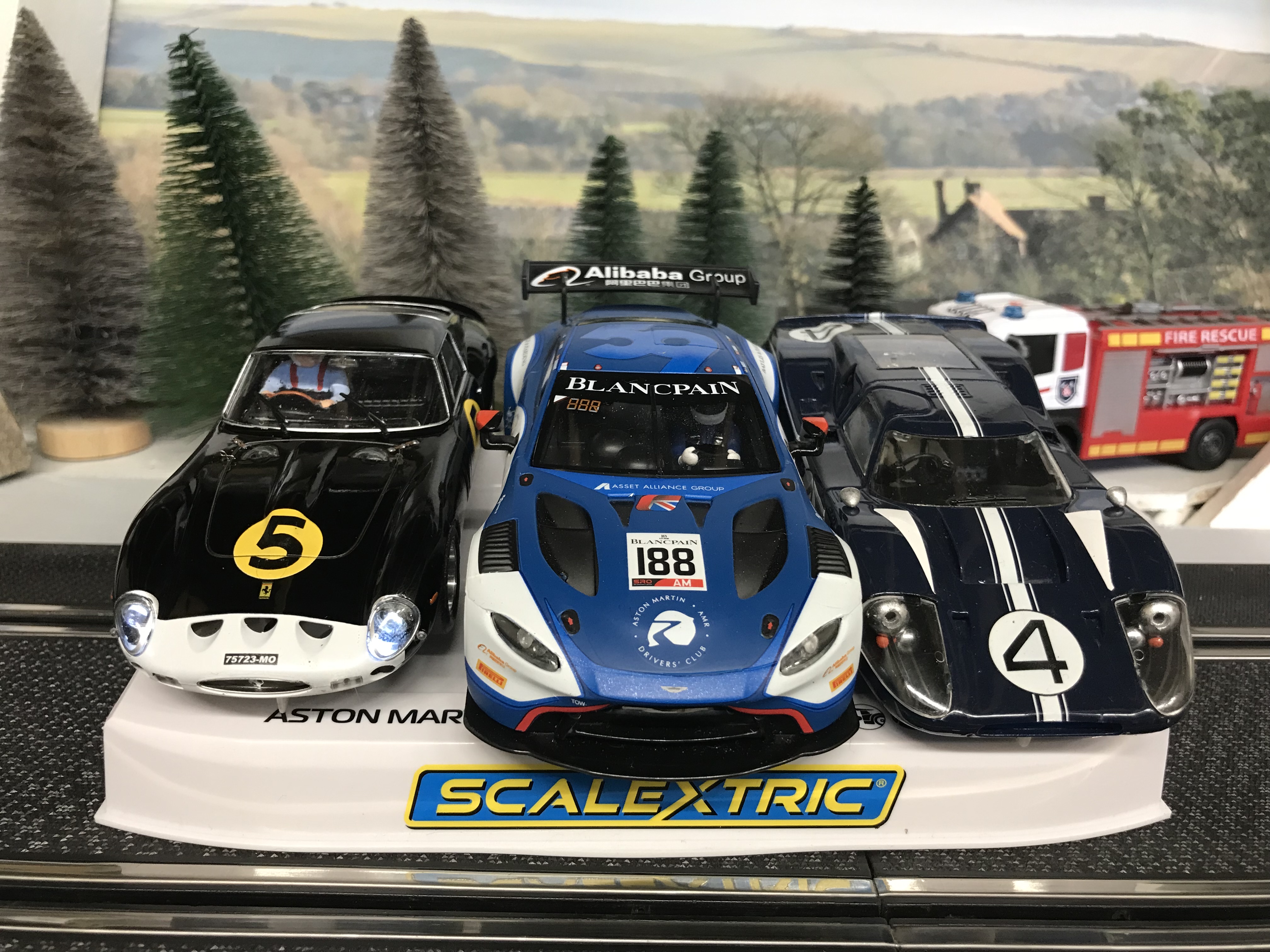

paul.cooper.22@googlemail.com - PaulCooper - 5th-Aug-21
[attachment=16757][attachment=16758]Hi all
Just a quick post to say I have built up my three for the event see attachments.
First time I fitted lights too, so was an interesting task. ??
I had the z sets on a old car which I fitted to the Ford, they were a doddle to fit the only issue I had was to drill a hole in the headlights to secure the led bulb.
The Ferrari I went with the slot it pack, oh boy was this challenging, first select the right soldering tip and connect . But the biggest issue was getting space under the arches and with the long trailing connectors I had to really think about the angle and when to cut down ( best after soldering ) but overall I am pleased with the results and the task has increased my understanding of fitting lights.
