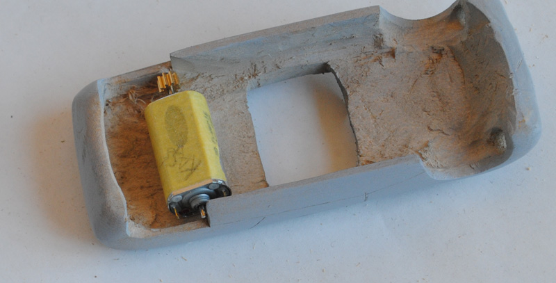

RE: Lotus 23 SALT - Carver - 22nd-Apr-20
Here is a pic of the underside of the shell to show what space there is. Outside width is now correct, inside it can be made wider.
[attachment=6243]

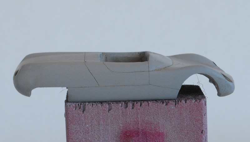

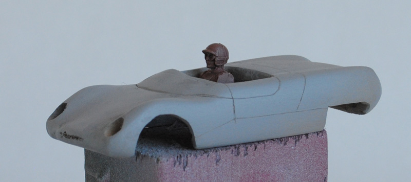

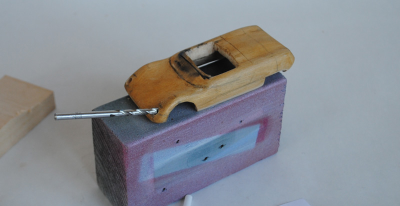

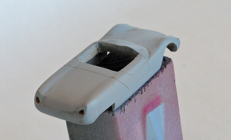

Meanwhile, work on the body goes on.
Having sanding it down to the right dimensions. I give it a thin layer of primer to better see what more there is to do.
[attachment=6244][attachment=6245][attachment=6246][attachment=6247]
So far it is all lime-tree. Next will be to work on the front and the tail. For the grille area, I will use styrene. The weight at present is 10g.
Carver

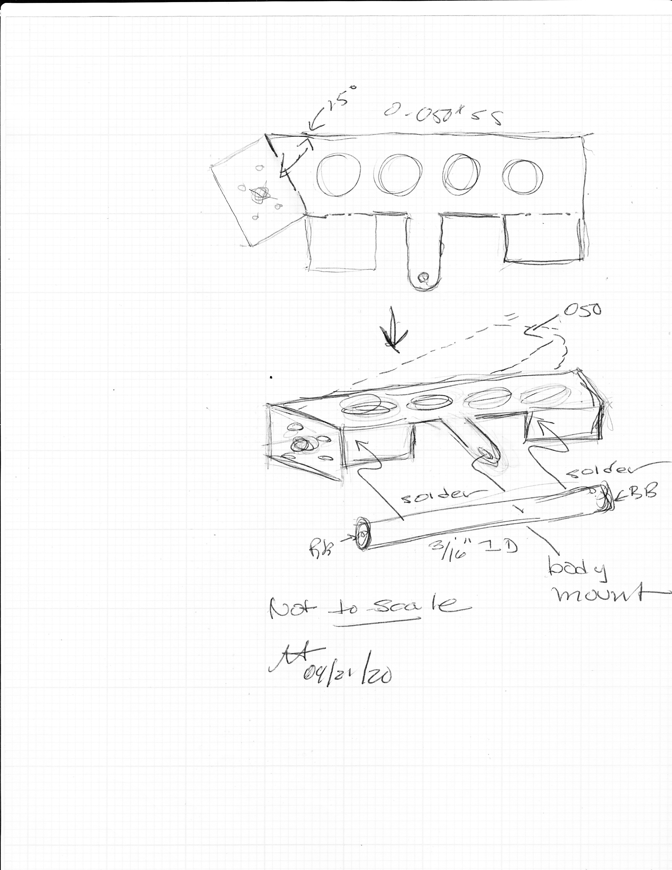

RE: Lotus 23 SALT - Ecurie Martini - 23rd-Apr-20
Latest thoughts: Push the angle winder approach a little farther;  A motor "harness" to couple motor to axle. provide a rear body mount and use a "bolt-in" motor fastening so it can be changed out without rebuilding the chassis:
[attachment=6256]
0.050" stainless steel sheet cut and bent per sketch:
pluses: no soldering to motor, 3/16" ID axle carrier tube will accommodate ball bearings (in hand)
minuses: added weight
unknowns:  motor/axle connection sufficiently rigid?  Will it fit? (next step is scale dwg) Fabrication - cut, saw & file or laser cut (?$?)
Feels good to have something resembling progress instead just meandering in circles.
Comments & suggestions please
EM
