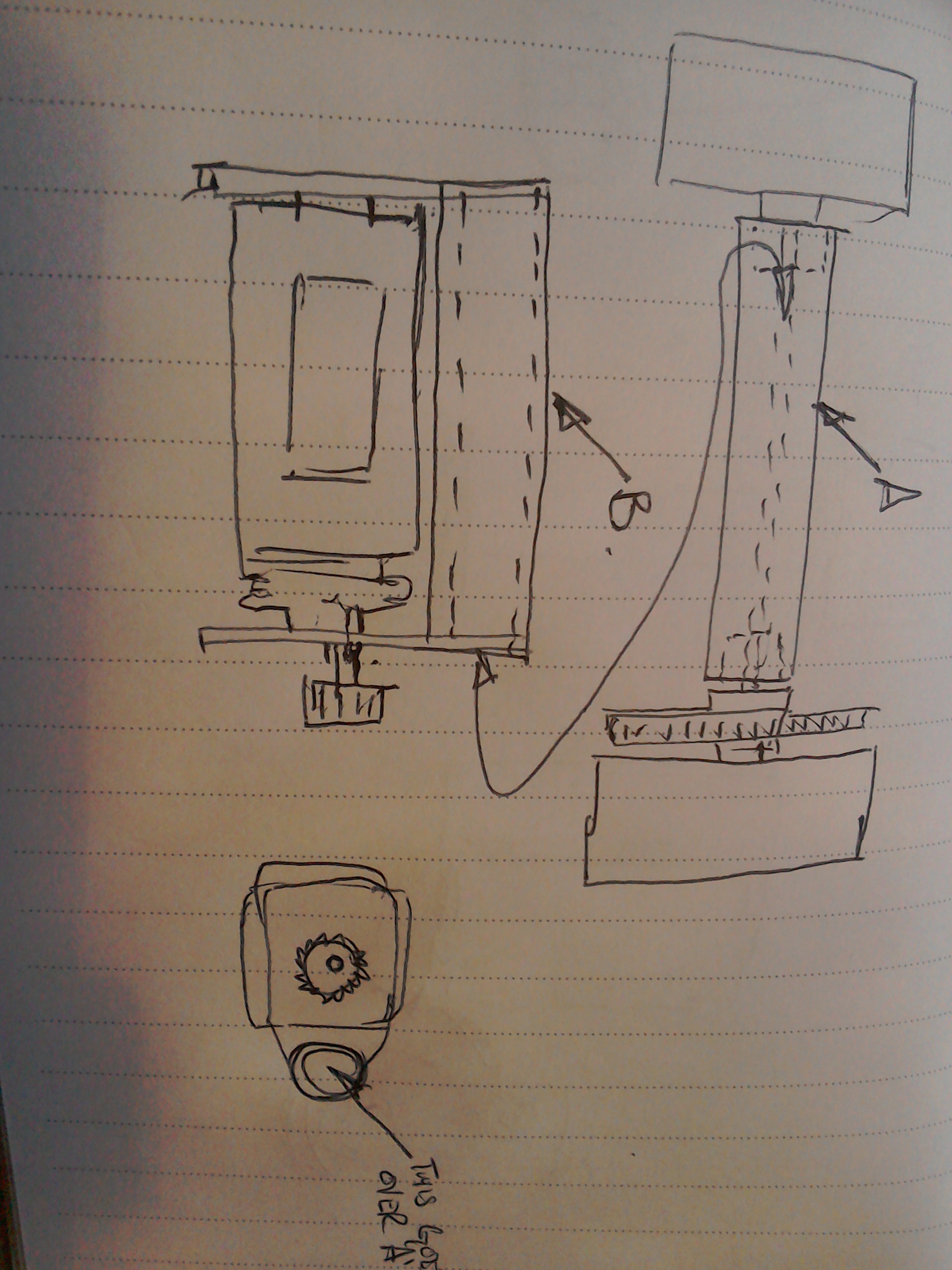

Hi DVD,a bit of a sketch ,it might helpĀ  Wrench
Steve
