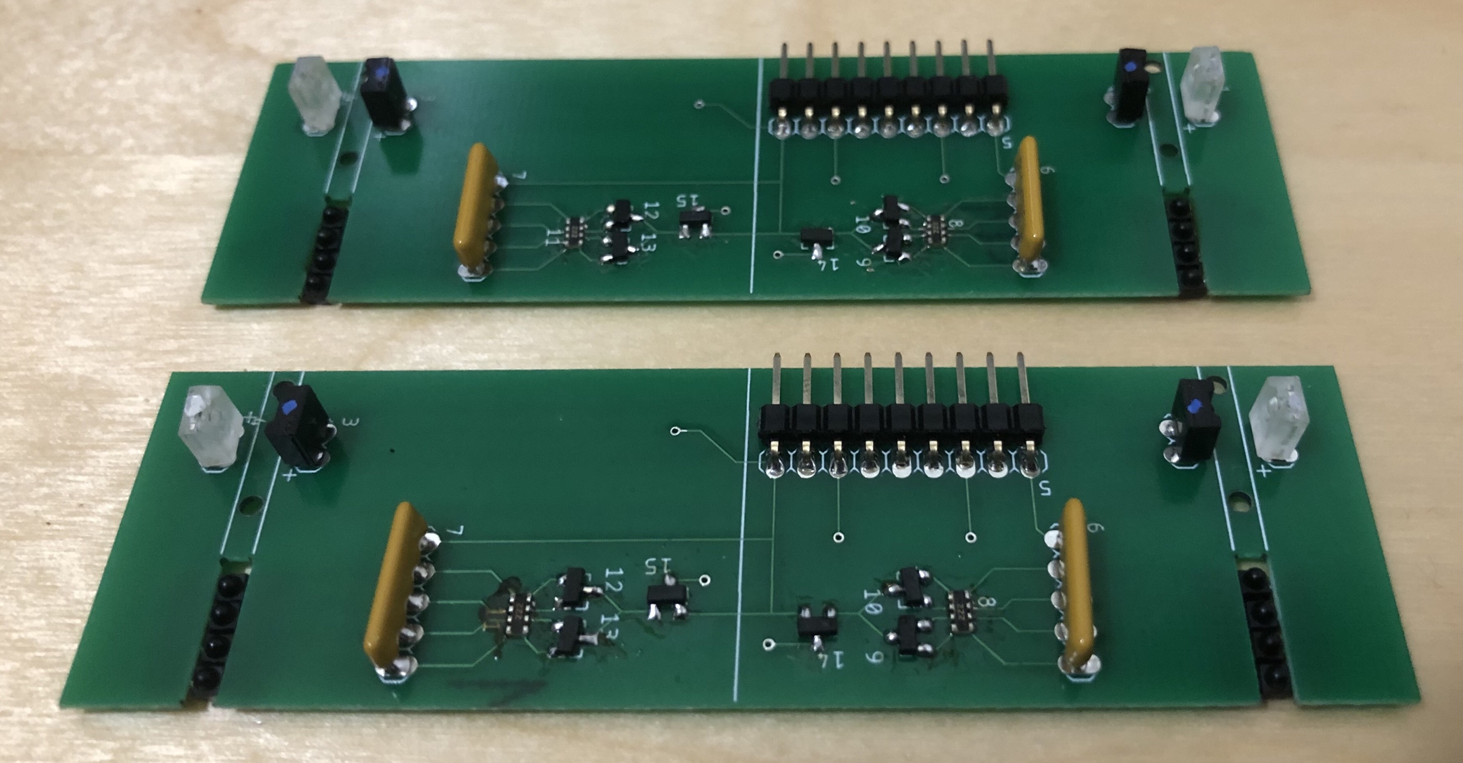

RE: ARC PRO+ is it time for a fully loaded version? - Dr_C - 23rd-Sep-20
[attachment=8886]
Two of the new sensor boards designed and assembled over the past few weeks and which are designed to integrate with above approach.
