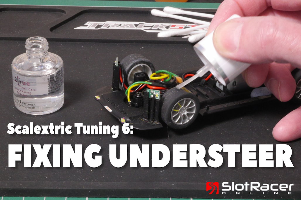

Reducing Grip
We spent a lot of time in Part 5 increasing the grip of the rear tyres to fix the Mustang’s oversteer. Here we’re going to decrease the front end grip to fix understeer. In theory, a slot car rides on its guide at the front and rear wheels at the back – a triangle. The front wheels only act as stabilisers to stop the front of the car tipping. When the front tyres stabilise the car, we don’t want them to grip or ‘dig in’ as that will upset the stability of the car. We just want them to stabilise any tipping – that’s why we reduce the grip.
There are many ways of doing this, but the method I prefer is painting the tyre surface with two thin layers of nail varnish. I can’t say I know a lot about nail varnish, but what I use was from the pound shop – ‘high-gloss’, clear and comes with a brush in the cap. I paint it on sparingly, let it dry to the touch and then apply a second thin coat. Just the tread of the tyre is important, the side walls don’t matter.
[attachment=45887] [attachment=45888]
After the second coat had completely dried – about 45 minutes – I returned the Mustang to the test track and a two minute run gave me a score of
27 laps and a best lap time of
4.19 seconds. The balance of the car was right back in the sweet spot.

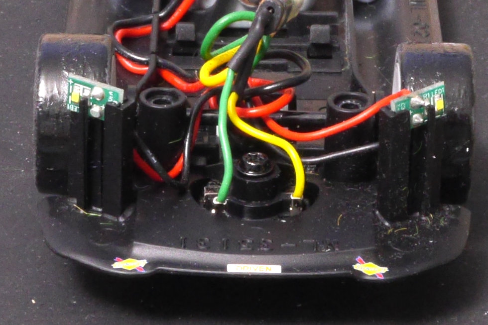

Adjusting the Guide
There are two really important things about a slot car guide: it must rotate freely and the blade should sit as deeply as possible in the slot. If the guide doesn’t turn or the blade lifts up, understeer will be a problem. In Part 2 we looked at checking a new car to make sure everything was moving freely and pre-profiling the braids to get the guide blade sitting low. Just now we made sure the front wheels weren’t lifting the guide at all. Now let’s look at the guide itself.
The Scalextric Quick Change guide has a few issues, one being that it can be a bit ‘floppy’. Ideally, the guide should only move in a circular motion, not pivot front and back and side-to-side. The problem is that the flanged screw sits about 1-2mm above the guide socket in the underpan. The guide can be tightened a little by sanding the top of the guide stem so the flange of the retaining screw sits snuggly on the underpan. This is best done with the guide removed from the underpan. Be careful not to pull the wires – feed them out gently from the inside.
[attachment=45889] [attachment=45890]
By adjusting the screw, you can now adjust the tightness of the guide – you want it to rotate nicely, but wobble as little as possible. It’s not a perfect fix, but can improve stability going into a corner. For the Mustang, it felt good – a two minute run with the ARC app gave me a score of
4.26 seconds.

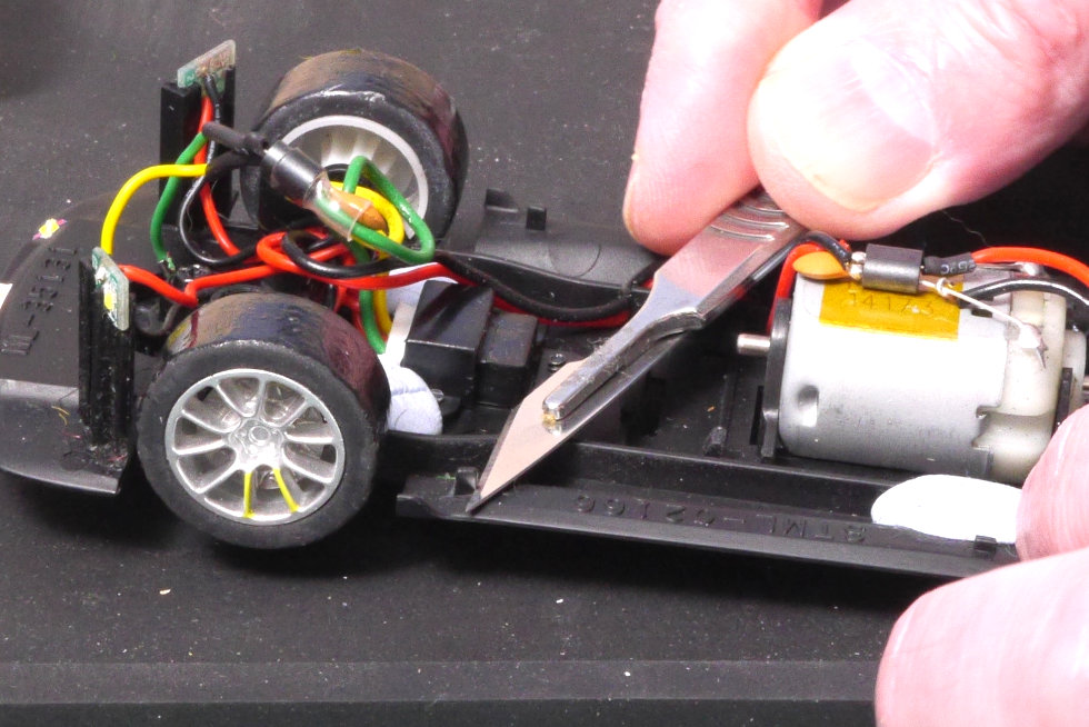

Inside the Mustang, there are braces from the interior to the rear axle and motor – and a large tab on the right side of the underpan. Four small tabs on the underpan hold the body on the side sills and two tabs on the body hold the rear light board, plus one each for the two separate headlight boards. All these tabs and braces will be removed to cut the connection between body and chassis.
[attachment=45902] [attachment=45903]
There’s one final thing to look at – the body posts. On the Mustang, the three body posts (two front, one rear) sit on top of corresponding stubs on the underpan. These stubs have a small flange to hold the body post in place and will limit any side-to-side and front-to-back float. Those flanges need to come off – either by sanding or trimming with a scalpel. If you are racing in a group or at a club that has rules, check you can do this. There may be a rule against lowering the car (ie trimming down body posts), but removing material from the chassis to aid body float may be acceptable. If in doubt, ask.
[attachment=45897] [attachment=45905]
With these modifications complete, the Mustang reassembled and the screws loosened as before, I had a car with surprisingly good body float. A two minute run on the SL6 test track gave me a score of

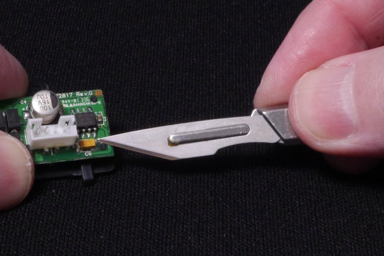

Another thing I noticed, is that
the rear light board sits very close to the body post and the wires have clearly got caught and squashed between the body post and underpan stub. That won’t help body float. You could simply remove the rear lights to free up the rear post. I don’t want to do that – and rear lights are required for my club racing – but what I could do later is de-solder the wires and attach smaller gauge wire to the rear side of the board, taking them out of the way of the body post.
[attachment=45904]

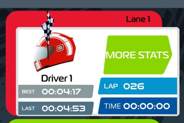

First, I need to set a benchmark time. The Mustang is as it was at the end of Part 7 – all standard parts – plus a fresh scuff of the tyres. A two minute run on my Jadlam SL6 test track gave an impressive
27 laps and a best time of
4:17 seconds – we do have a pretty good car now. Don't forget our first two minute run at the start of Part 2 - 15 laps and a 6.96 second best lap. Can we go even faster?

Does it make a difference? A test run on the Jadlam SL6 test track gave me a smooth handling car with good acceleration on the long straight and none of the wheel hop. The car sounded quieter under acceleration, suggesting less movement and better gear mesh. So I’m happy. A two minute run wasn’t spectacular –
20 laps and a best of
5:55 seconds. That was slower than last time, but everything I drove today was well below par. Blame the driver.

Once fitted, I always check the wires at the front do not stop the front axle rotating; the chip doesn’t interfere with the cockpit to prevent body float; and the Ferrite Man (see
Part 1 – Parts of a Slot Car) is fully isolated from the motor can.
[attachment=45968] [attachment=45969]
I also check that the LED is not poking out the bottom of the underpan too far – it shouldn’t be anywhere near touching the track. I check this on my acrylic set up block by passing a strip of plastic (1.2mm thick) under the car. In the case of the Mustang, the plastic strip lifts the front of the car up when it passes under the LED – it’s too low. This means the end of the lens will get worn and that might stop the LED communicating reliably with the track sensors. Scalextric have given us lovely low and flat underpans recently, but the chips are still designed for older cars that sat higher.
To fix this issue, I remove the chip from the car and very carefully slice off the two plastic retaining lugs at the front of the chip. I then pop the circuit board off the front plastic legs, so it is angled up – the tip of the LED moves to a position flush with the bottom of the flap. The board should stay in this position without adding any glue, spacers etc. The angle can make re-fitting the plastic plug into the underpan a little tight, especially with the older chips with the large silver capacitor.
[attachment=45970] [attachment=45971]
