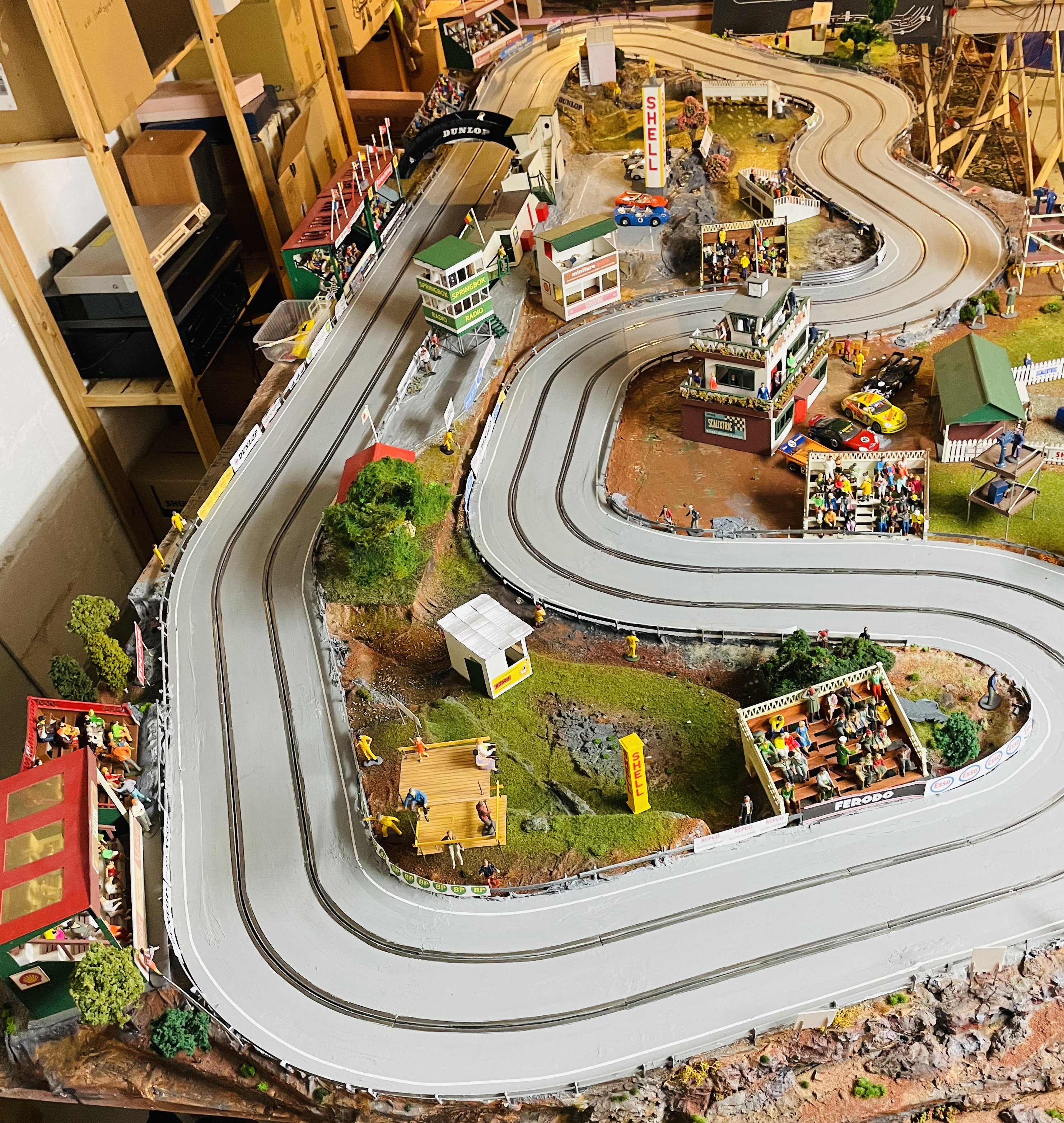

RE: New to Slot - Dumb first purchase for Dad! - Anthony B - 15th-Dec-25
I am a huge Revell fan and use their track for my home track
Look at eBay in your area and for sure you will find someone making the tyres. You beed tyres normally sold as fitting Monogram or Revell vintage cars. Pretty standard.
Pic of my track
[attachment=45226]
