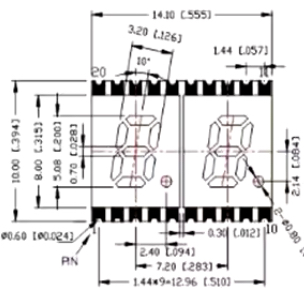

[attachment=37853]
Catering for all tastes - here is an image showing dimensions in mm.

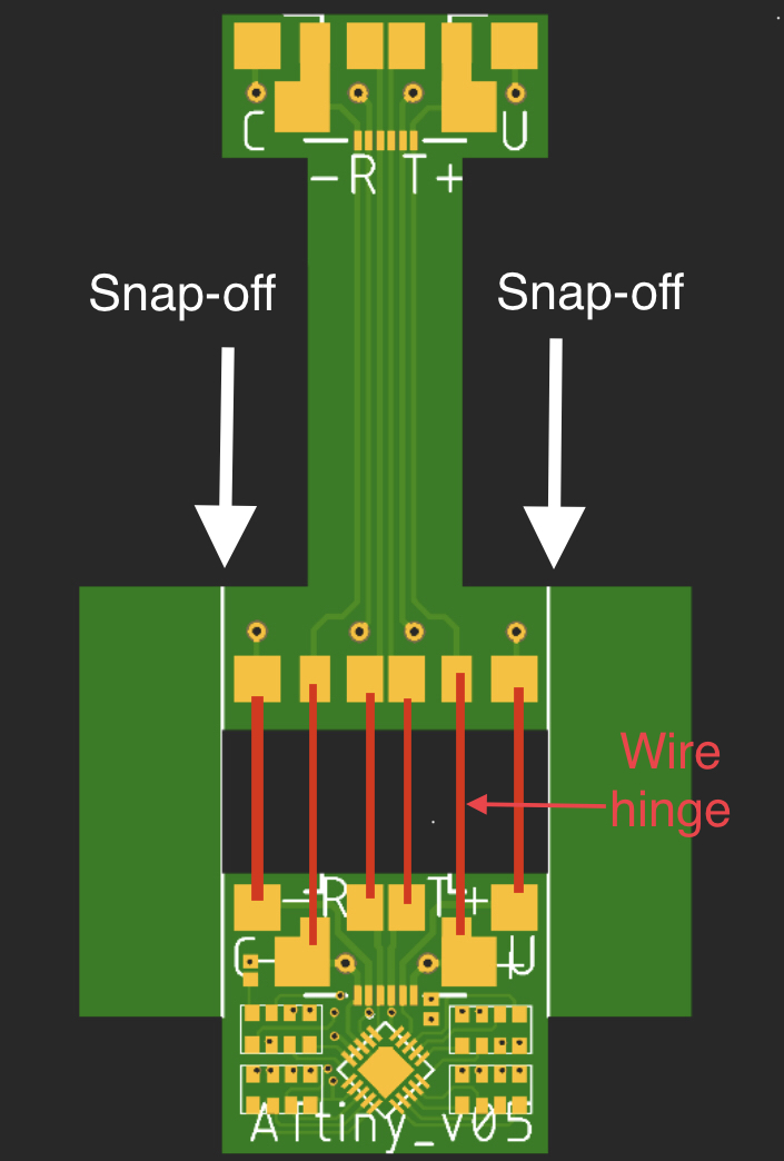

[attachment=37954]
Here is the proposed ‘two-board’ solution for simple mounting of the 2-digit windscreen display.
The board will be assembled as a single unit, the six hinge wires added, and then the two side-tabs will be snapped away. The hinge angle can then be adjusted to match the windscreen angle of the car. The upper section of the assembly is then hot-glued to the underside of the car’s roof.
This version of the main display board includes the following four in-car decoder connection options:
1/ ID reading from IR LED signal (current preference).
2/ ID reading from decoder via uart rx/tx
3/ ID reading from decoder via SPI bus
4/ ID reading from decoder via I2C bus
Meanwhile, the ATtiny is programmed via a single wire UPDI interface so a further option could be to hard-code the display via UPDI.
Next we need to see a race pack of AMGs on a starting grid with their IDs displayed on their respective windscreens.
c

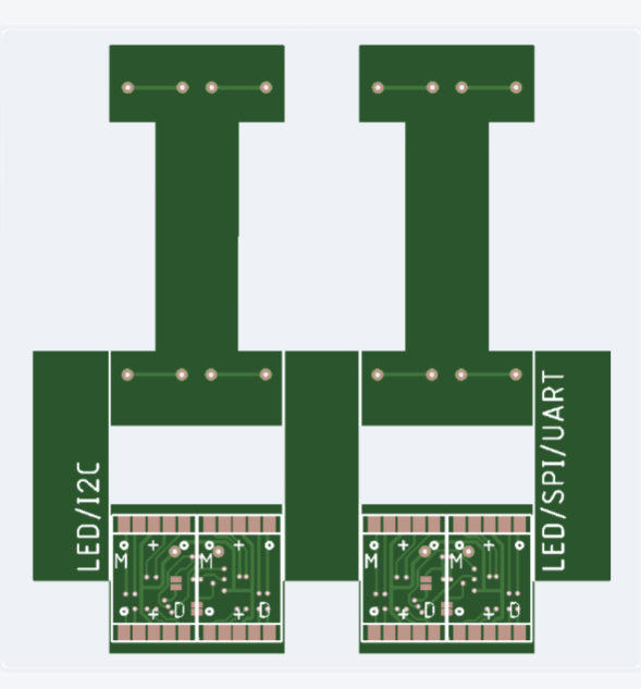

[attachment=37966]
Spot the difference?

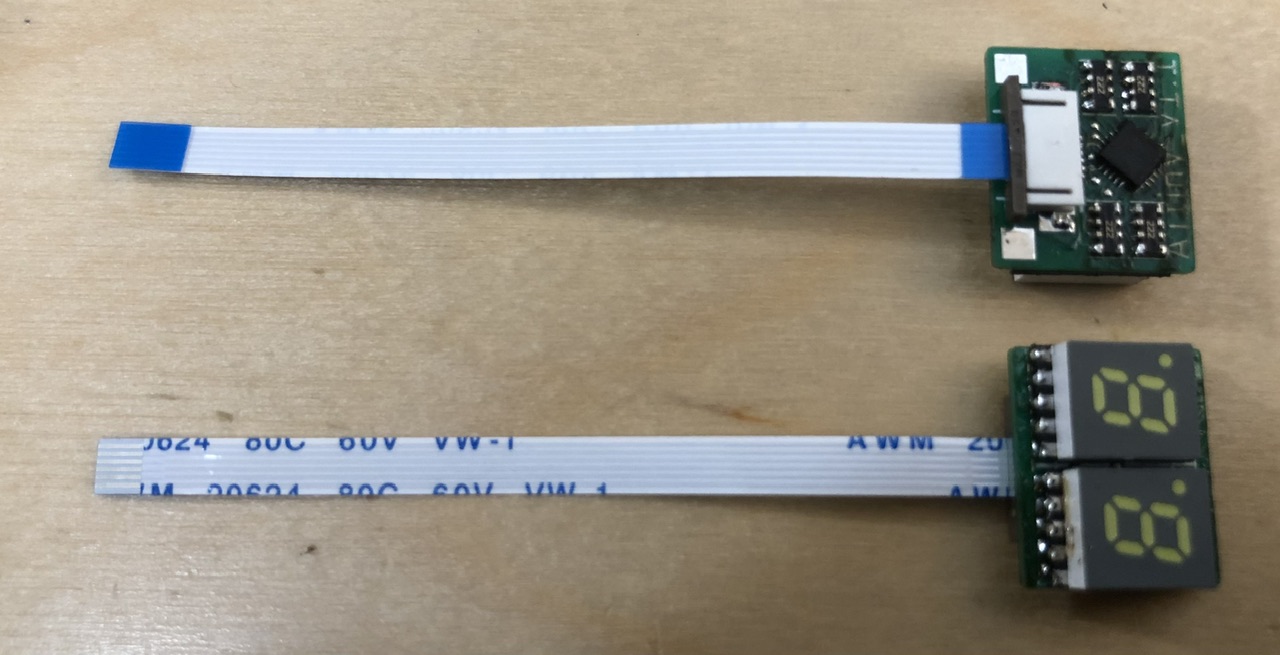

[attachment=37976]
While I wait for the two-part hinged PCBs to arrive I can press on with the display firmware. This is programmed using a UPDI (universal programming and debug interface) accessed via the FFC port.
The photo shows the early prototype hardware as per the 3D image shown in post #1 - a perfect platform for developing the firmware.
Six of these prototype boards will be fitted alongside SSD decoders into a group of Scalextric GT3 cars.
c

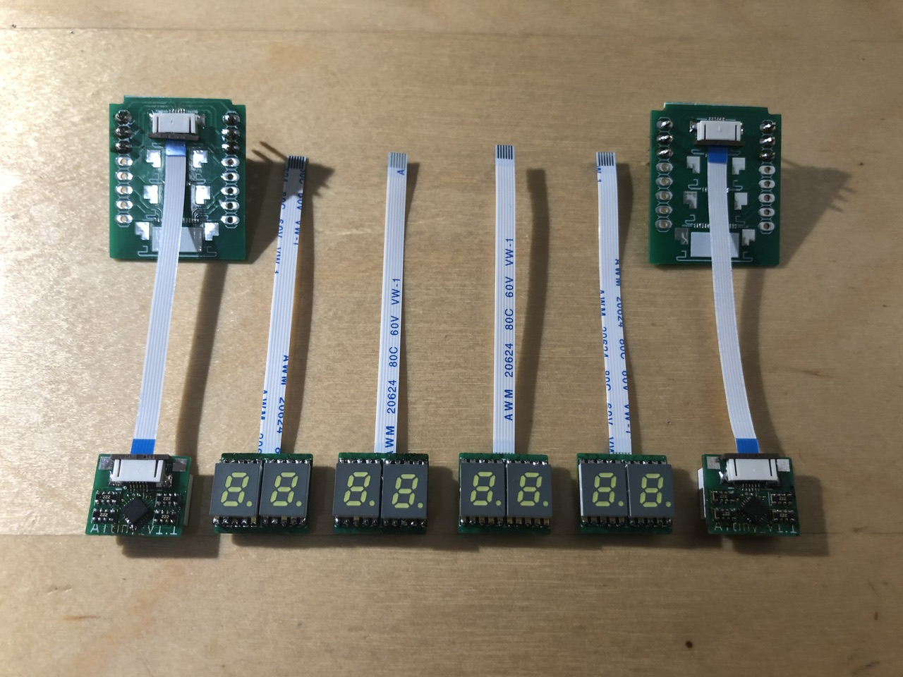

[attachment=38089]
RE: Windscreen digital read-outs -
Dr_C2 - 7th-Nov-24
The above hardware is now tested for fitment into a grid of six SSD GT3s. That said, all testing so far has been with the displays sitting on the test bench - not as yet in vehicles running at 1-10m/s.
It’s going to be interesting learning how readable these 5mm tall two digit displays are when cars are in motion.
Also, will the readability results be different for day-time and night-time driving? Likely yes - but let’s see :)
In this design all LED segments are either on or off (except when changing of course) i.e. the design avoids any type of display segment scanning. This should help with readability while the car is in motion.
c
