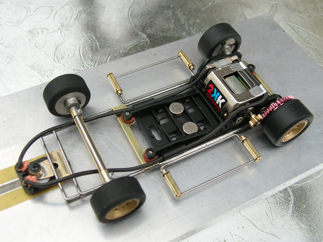

I built this one several years back.............basically a "U' shaped piece of .047 or .055 wire with a couple of brass cross straps drilled and positioned to accept a Slot-it pod.
This one has some hinged pans on it, and pin tubes ,as it ran under a pin mounted Lexan body,.......you obviously do not heed these.

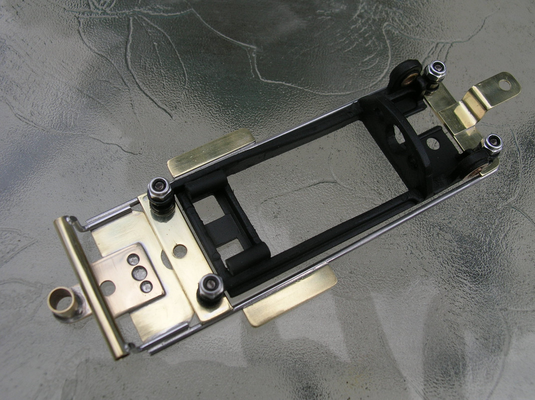

This is an inline version, this one with brass tabs for a body post/screw mounting syetem.
[Image: DSCN4295-copy.jpg]
This one also an inline,......but with longer/heavier pans soldered directly to the main chassis rail,........I would build without the pans initially, try the car, and add pans (if needed later). This also has a different method of attaching the front of the pod, which you do not need.

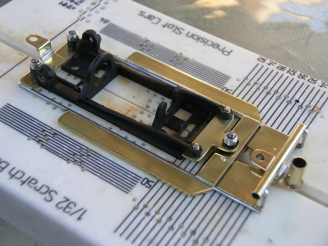

[Image: 2003-12-31-23-00-00-7-copy.jpg]
This is the clearest pic. of the basic chassis, again, you do not need the wire pans I have made for this one,......brass tabs/body post/screws will be the best for your styrene body.

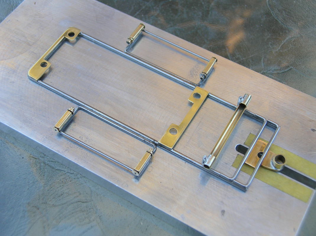

A wire 'U" with brass cross plates for mounting the pod.
[Image: DSCN4875.jpg]

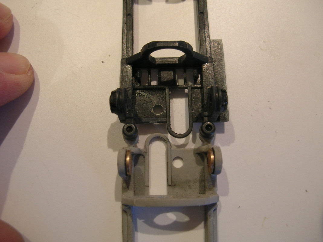

And,.......if you are pinched width wise, (the Airfix 250 is relatively narrow),.....you can modify Slot-it/Scaleauto pods to pick up a few mm in width
Cut the bushing cup "ears" off of the Slot-it pod, open the holes a touch and use some single flanged 3/32 x 3/16 oilites,.......these can be glued flange in or out, depending on how much room you need.............this pic. is obviously an inline,......works just the same on a SW pod.
[Image: DSCN4318-copy.jpg]

Hi Tony,..........forgot to include this pic. of the finished chassis from the above post
Chris Walker
The basic chassis plate shown above

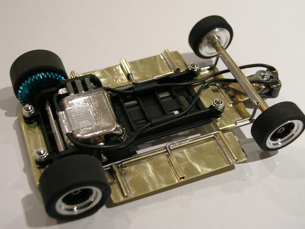

And the finished chassis,...sidewinder pod installed........this one a "magnet" car,  Cussing  with a Lexan body,  built for a customer......I don't mind a well done lexan body, but personally, I don't care for magnets.
[Image: DSCN4881.jpg]

Hi Tony, While the cut out axle tubes look cool, I generally don't bother on non magnet cars/chassis,.......on a magnet car, any reduction of weight does translate to quicker lap times, hence why it was done on the chassis pictured in the previous post.
