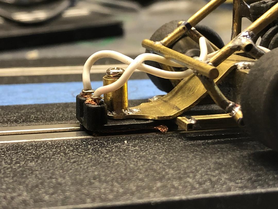

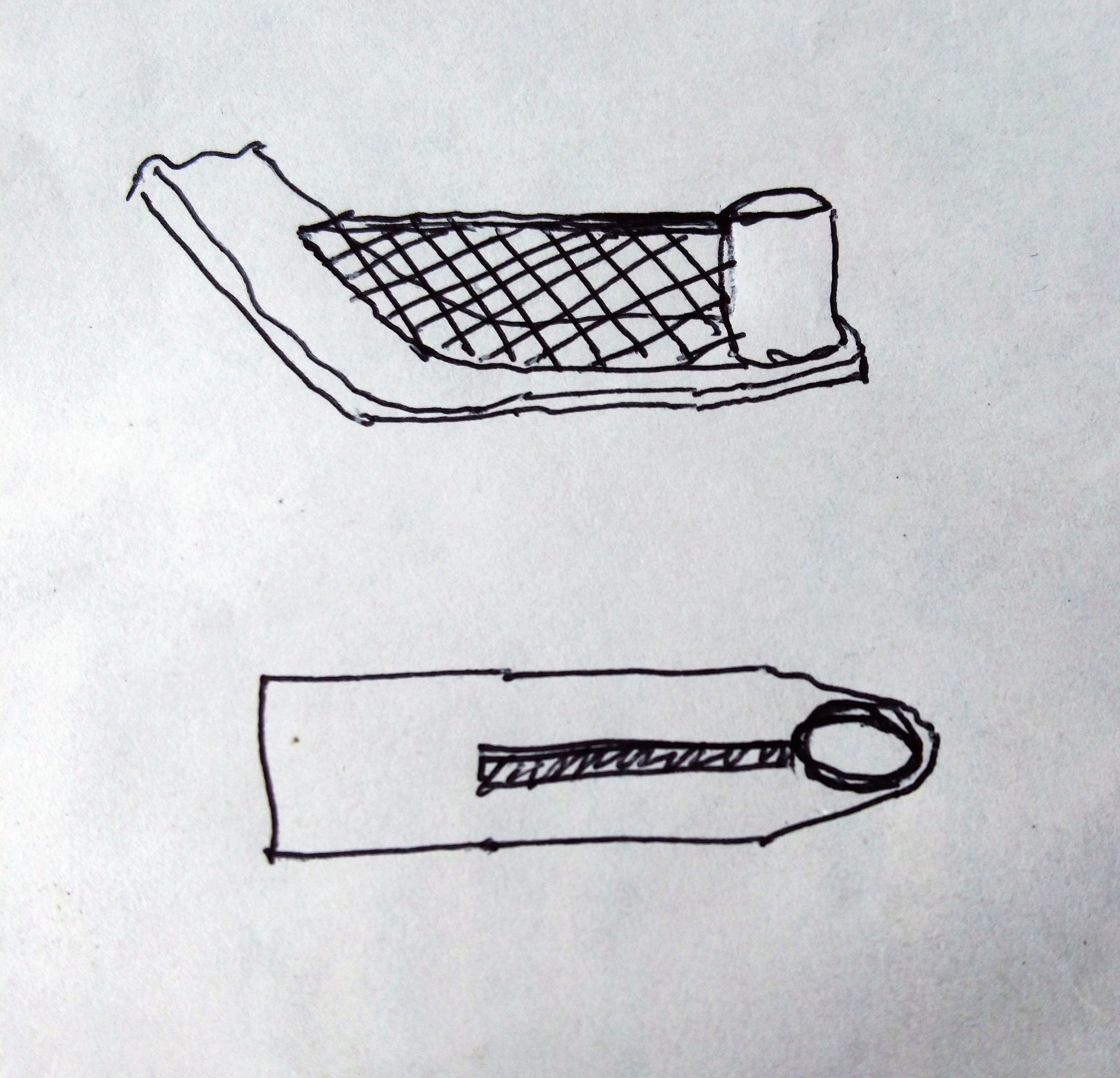

RE: Ryan Stone TQ Memorial Build - Kevan - 16th-Jul-22
[attachment=24947]
The other thing I'd change is the gap between the bottom of the plate and the top of the guide is possibly going to make the guide wobbly side to side, I like very little horizontal play on a guide post.
If that was my car I'd either solder another flat brass plate (with a hole) underneath...or move the whole thing down at 45° so the guide is right up to the plate when the front tyres are sitting on the track.

RE: Ryan Stone TQ Memorial Build - Tibbs - 17th-Jul-22
(16th-Jul-22, 01:02 PM)Kevan Wrote:  The other thing I'd change is the gap between the bottom of the plate and the top of the guide is possibly going to make the guide wobbly side to side, I like very little horizontal play on a guide post.
[Image: attachment.php?thumbnail=24946]
Thanks Kev, I see what you mean. I think I might add a plate under as I don't want to drastically change the guide tongue work above.
This is very helpful mate. Thumbup
