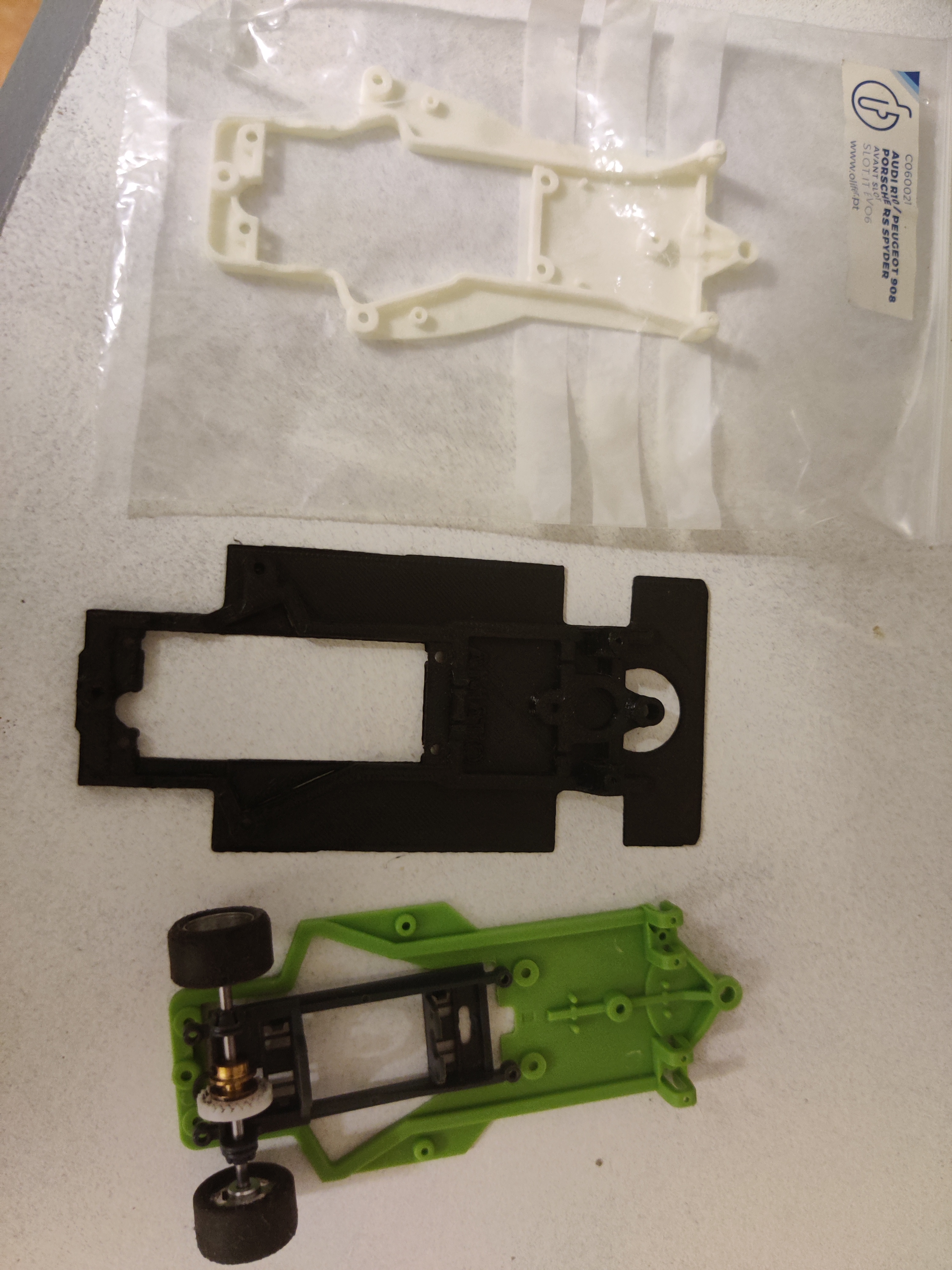

Below are the chassis I have for the r10, top to bottom, olifer 3dp for slot.it pod, amato 3dp for slot.it pod, avant slot hard.
As you can see the slot.it pod doesn't fit the avant chassis, pod is much shorter.
On the olifer and amato chassis a flat 6 will just fit in aw, but doesn't leave much room for body rock, a little spacer in between the chassis and body sorts it and doesn't look too bad.
Unless I'm missing something a flat 6 doesn't actually fit in either the plastic or alloy avant pods as they don't cater for the lower profile. Both pods seem to have a removable centre piece so maybe they released or planned to release something that would allow it to work.
It is open night tomorrow at the club so I will see what other people have done.
I just checked on my past builds and a avant 908 inline with a 25k scale auto motor was 2/10ths on a 7sec lap slower than my best mosler (25k scale auto aw) so not bad at all. The r10 should be basically the same. I might run out of time to build for tomorrow night but if I have a pod all set up with a black or orange flat 6 I could quickly throw it together in the olifer chassis.

Unless you race with magnetic motors and there's no magnetic limit I'd be putting a SW pod in the Olifer chassis with a Shark 25.  Fastest plastic chassis car round our routed club track is a Mosler in SW config (Evo 2 version is quicker than any that followed it).

It is possible and would be allowed in our rules, but it's just not an aesthetic I could live with. There would need to be a big spacer on the back screw leaving a really unsightly gap (2mm at a guess?) between chassis and body.

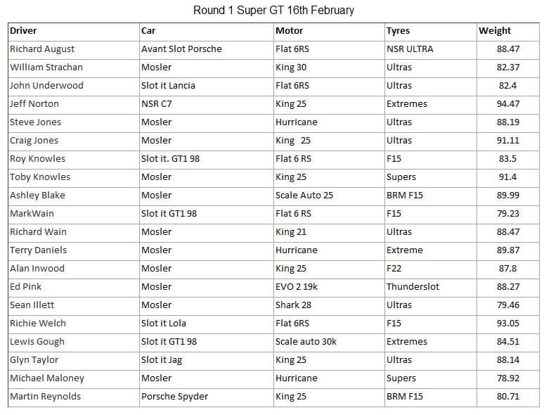

On another note no one runs SW motors, in open class they just get blown away unfortunately, below is from Wales and west open gt 2020, one SW in the whole field, guess where it finished!
[attachment=19551]
