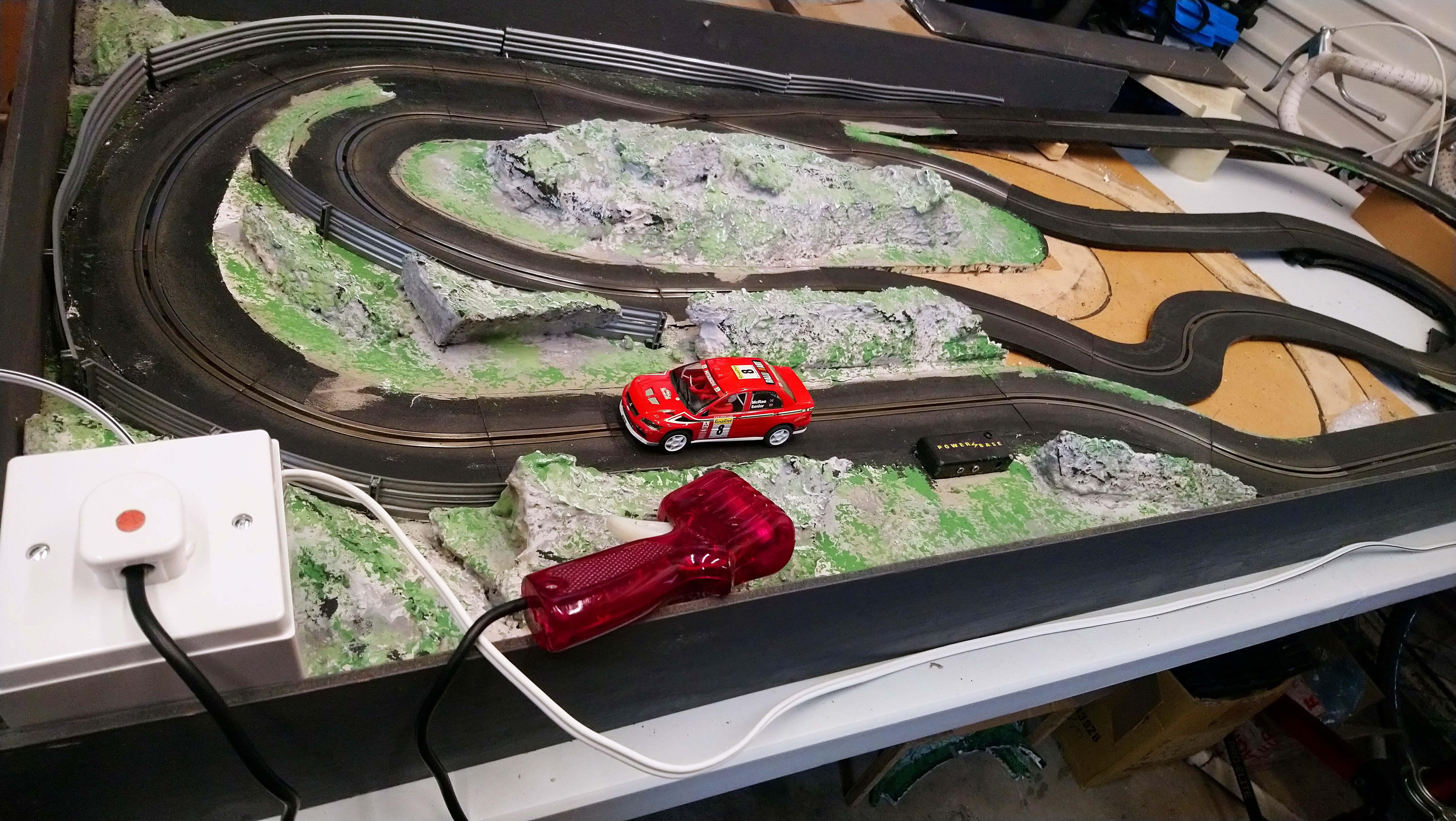

RE: Wiring your home track with UK club controller box - BAracer - 1st-May-21
All set up with my UK Club Controller Box for some weekend proxy car tuning...
[attachment=14336]
Armco barrier in place for protection!
Thank you Andy for the early birthday present!

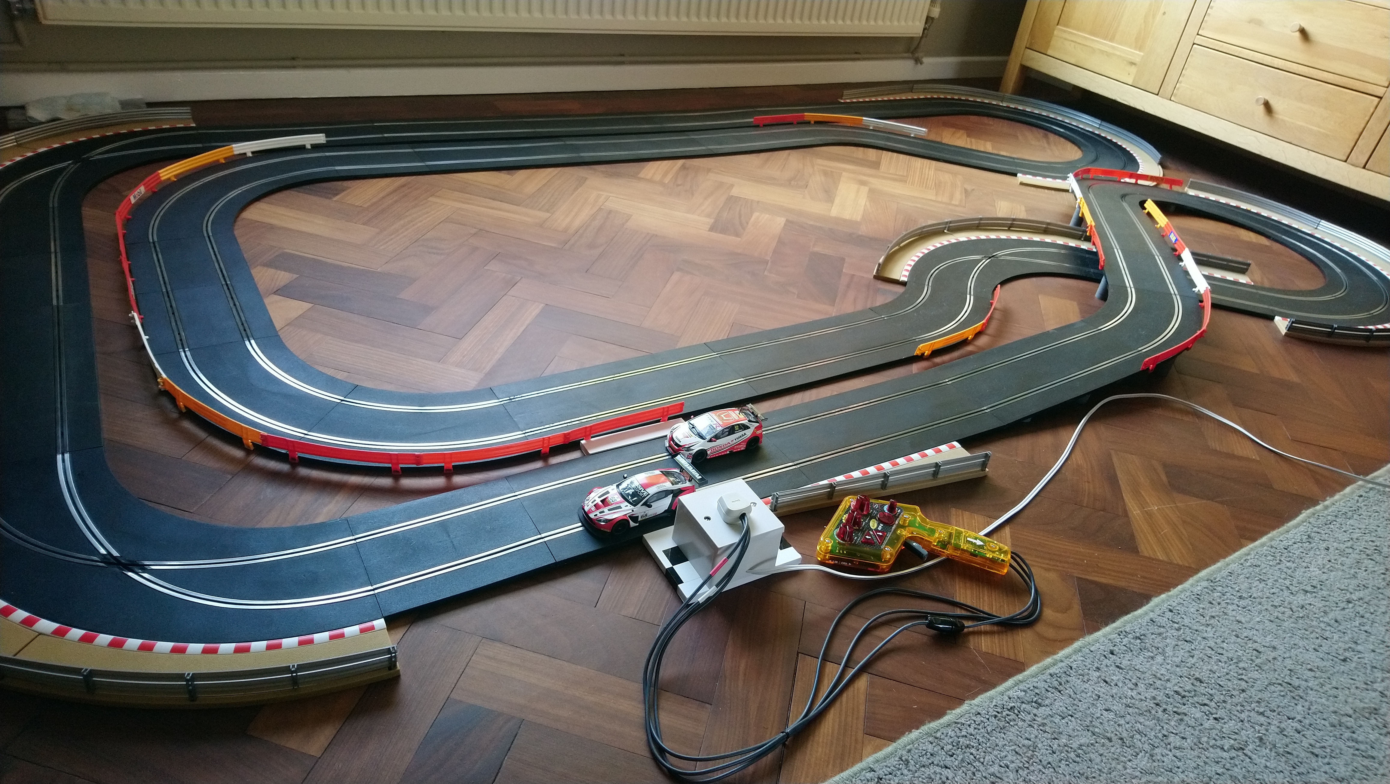

RE: Wiring your home track with UK club controller box - BAracer - 8th-May-21
And here is the result of my morning's effort...
[attachment=14525]
It's a temporary set up on the rally track at the moment, I'm going to introduce some inline sockets at the track end so I can reverse the track voltage and run the cars the other way round as well.
And it looks like it's a 60 ohm track when running standard Scalextric.
