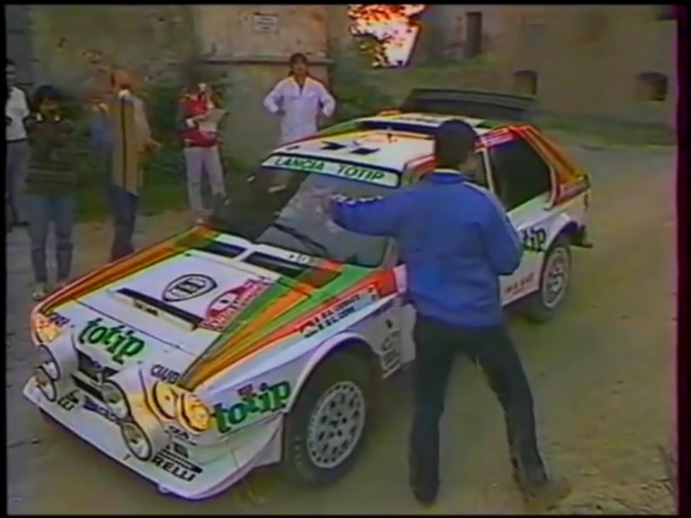

Talking of source material... the Sanremo rally takes place in two weeks time. It looks like most of the action will be streamed live by Primocanale and a preview run through every stage (plus extras used in the historic rally) are available in a playlist on the Primocanale YouTube channel here: https://youtube.com/playlist?list=PLde00V2nanISSY7_itHRMZRS5gm3l6LfU
Here’s a flavour...
That is pretty useful research material  Thumbup

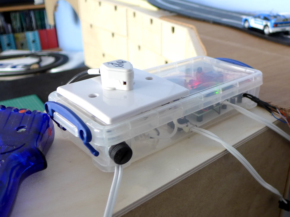

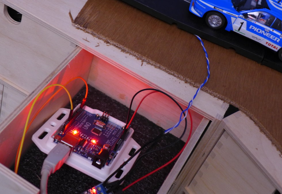

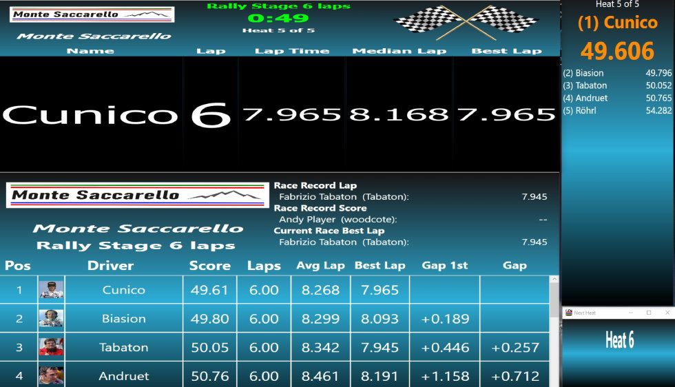

To help with that, I soldered wires to the second dead strip on the upper loop and hooked that up to an Arduino Uno clone so I can use Race Coordinator to time the runs (see here for how I did it). I have commandeered a drawer just below the dead strip to house the electronics...
[attachment=13756]
And it is all working very nicely...
[attachment=13755]
Times for the run down and up the hill (a 'lap') are now just under 8 seconds, plummeting from the original 10 seconds when I was using the manual DPDT switch and from just over 9 when I had the relay board with an automatic sensor at the top and manual button for the bottom loop. I can now concentrate fully on driving - and having very little run-off does force me to keep things neat. Those fast times are with a race-prepared Ninco Lancia 037, which is very well suited to the layout.

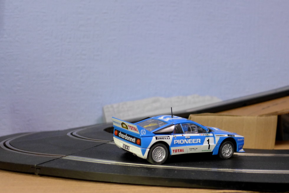

There's not a huge amount to show... but progress continues! Quite a lot of the benchwork has been fixed - apart the removable lower loop, which will be the final piece in the jigsaw, maybe not until some of the scenics have been started.
A lot of work and tweaking has gone into the hairpin at the bottom of the hill. The character has changed quite a bit...
[attachment=13915] [attachment=13916]
The adverse camber is still there, but the slope down in the middle of the corner is less severe. The kick-up from the hairpin is steeper (about 12 cms in 36 cms - or 1:3) and the drop from the exit of the corner to the pit lane 'Y' of the lower loop is more pronounced (10cms in 70 cms - or 1:7), which is the same as the middle section of the hill. The slope from the bridge to the start of the hill (ie the corner past the hillside village) is a gentler 1:20.
Those changes do give a different feel to the hairpin. It's still a challenge, but the initial gradient up the hill makes the climb much more satisfying than it was, even if the drop down within the corner isn't quite so spectacular. I have left a 1 1/2 inch screw in the inside of the corner that can be tightened or loosened to change the characteristic of the drop, until I get it just right.

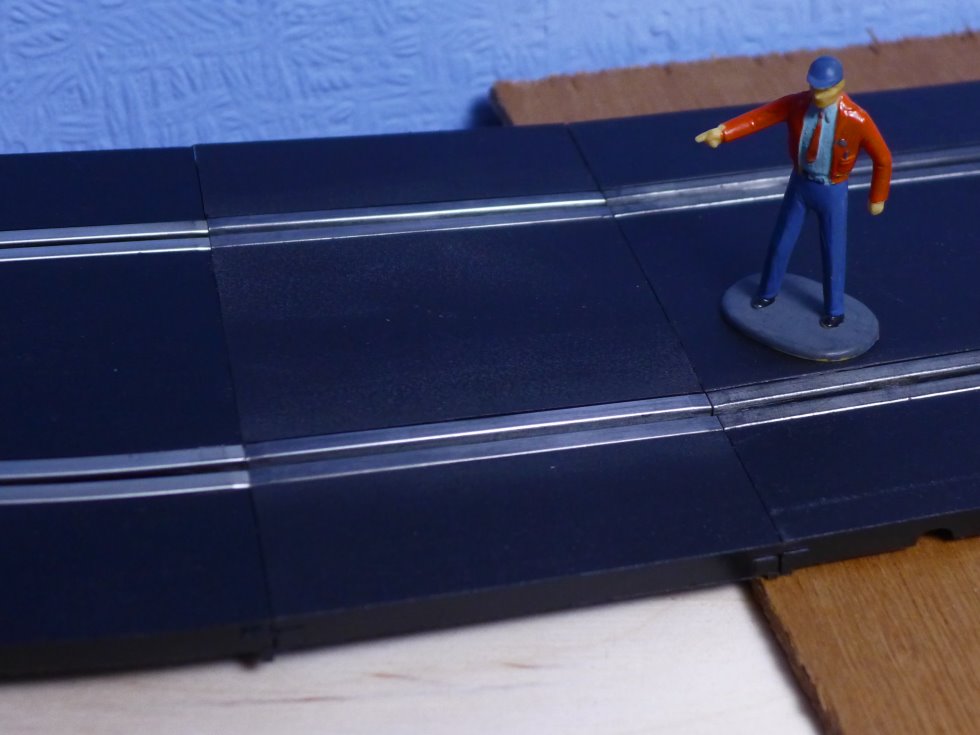

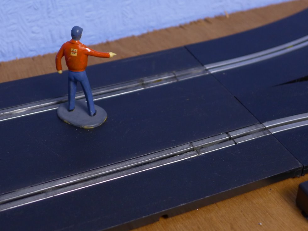

2) A big leap over hump (after the bridge) and a fast, light car can miss the deadstrip - and so doesn't trigger the polarity change.
That meant two necessary tweaks:
1) The hairpin is now 180-degrees, rather that 202.5 - so it goes straight, then a R3 and into the 'Y' of the lower loop.
2) I turned the deadstrip 1/2 straight 180-degrees to take the deadstrip to the end furthest from the 'Y' and also inserted a 1/4 straight before it - moving the deadstrip just over 6-inches further back. Of course, I had to re-solder all the power and data cables - but it's worth it.

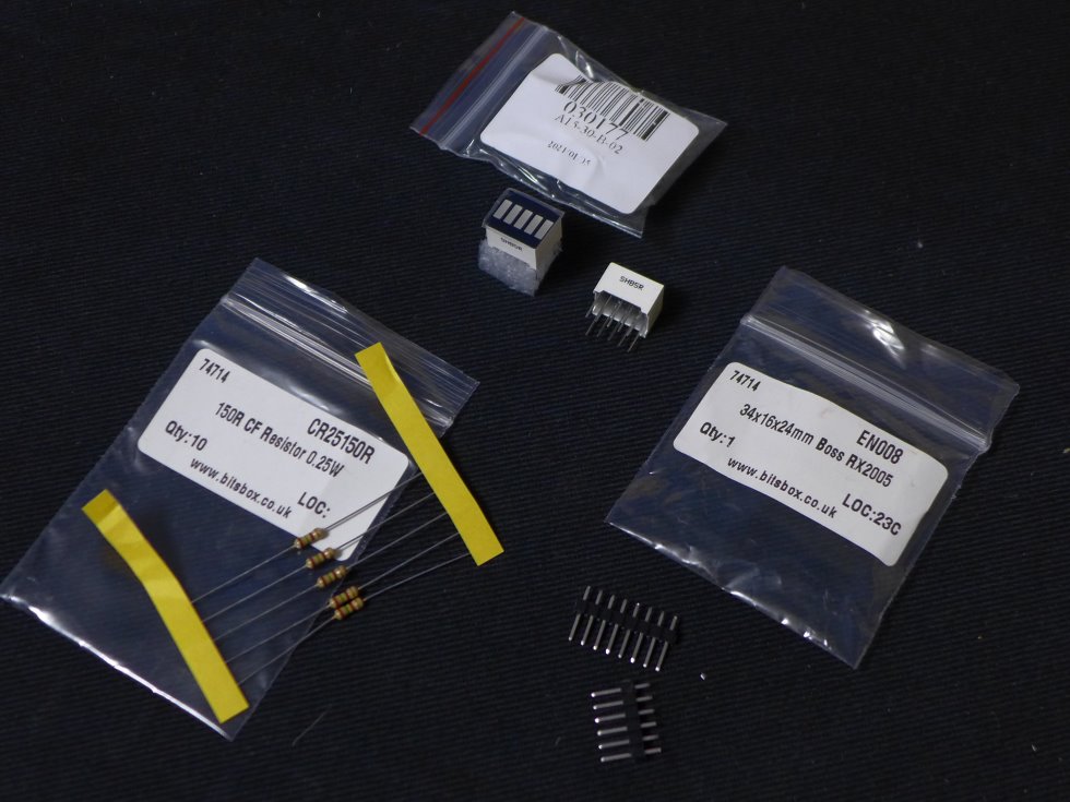

The parts list is:
[attachment=19172]

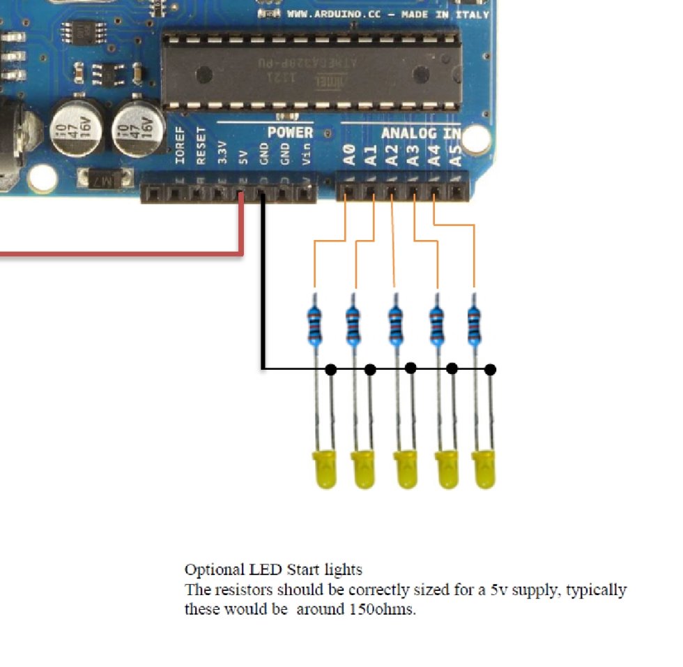

This is the diagram I used, which is in the 'Arduino Uno and Race Coordinator' pdf that is bundled with RC...
[attachment=19173]

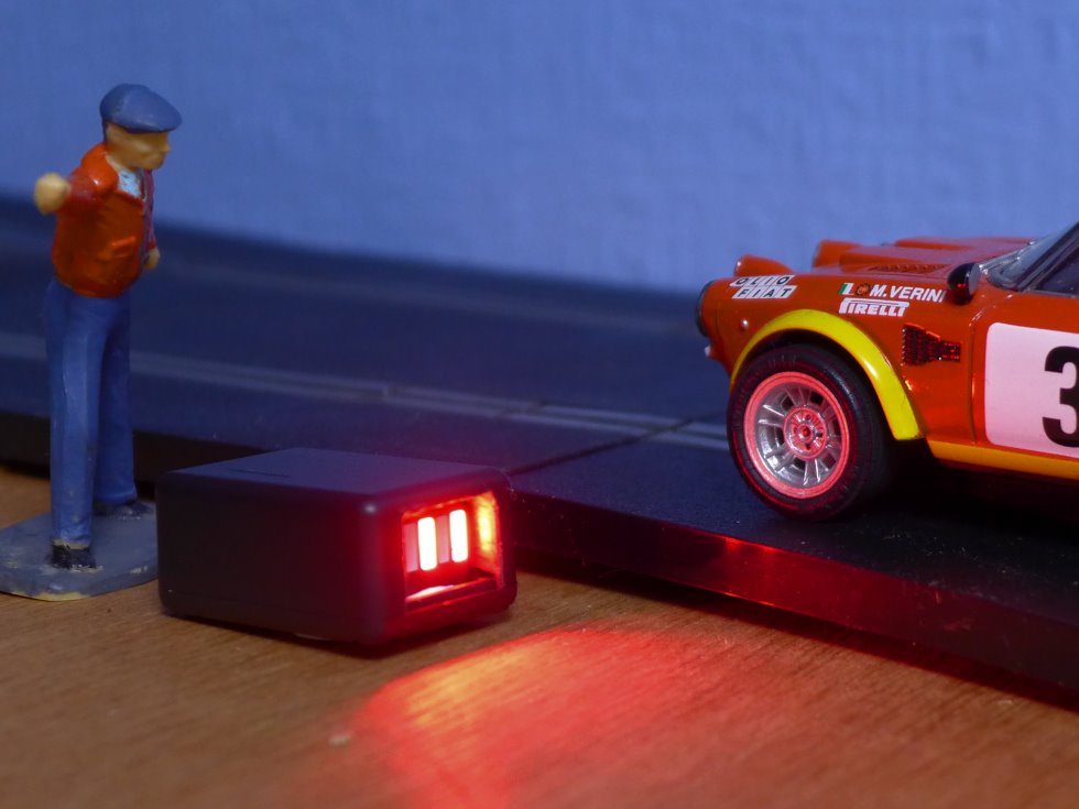

I bent the -ve pins together on the bar LED module and soldered a common ground wire to them - and this went direct to a GND socket on the Arduino, soldered to a single segment of the header strip. Each of the +ve pins had a separate wire soldered to it - and each went to the designated 'analogue in' sockets on the Arduino (A0 to A4), via a resistor and the header strip. This was quite fiddly - I ended up using the heatshrink on the end of the Cat 5 strand and over the resistor and then soldering 3mm of exposed resistor leg to the header strip. Flux and a low temperature iron was required.
It works nicely - three bars default (pre-race, yellow flag, end of race), then the countdown - and everything off when the race is running. I was going to start the box upright, but I prefer it lying down - and it's much easier to fit everything in the box like that! I've also changed my driving position to where I can admire the lights.
[attachment=19175]
