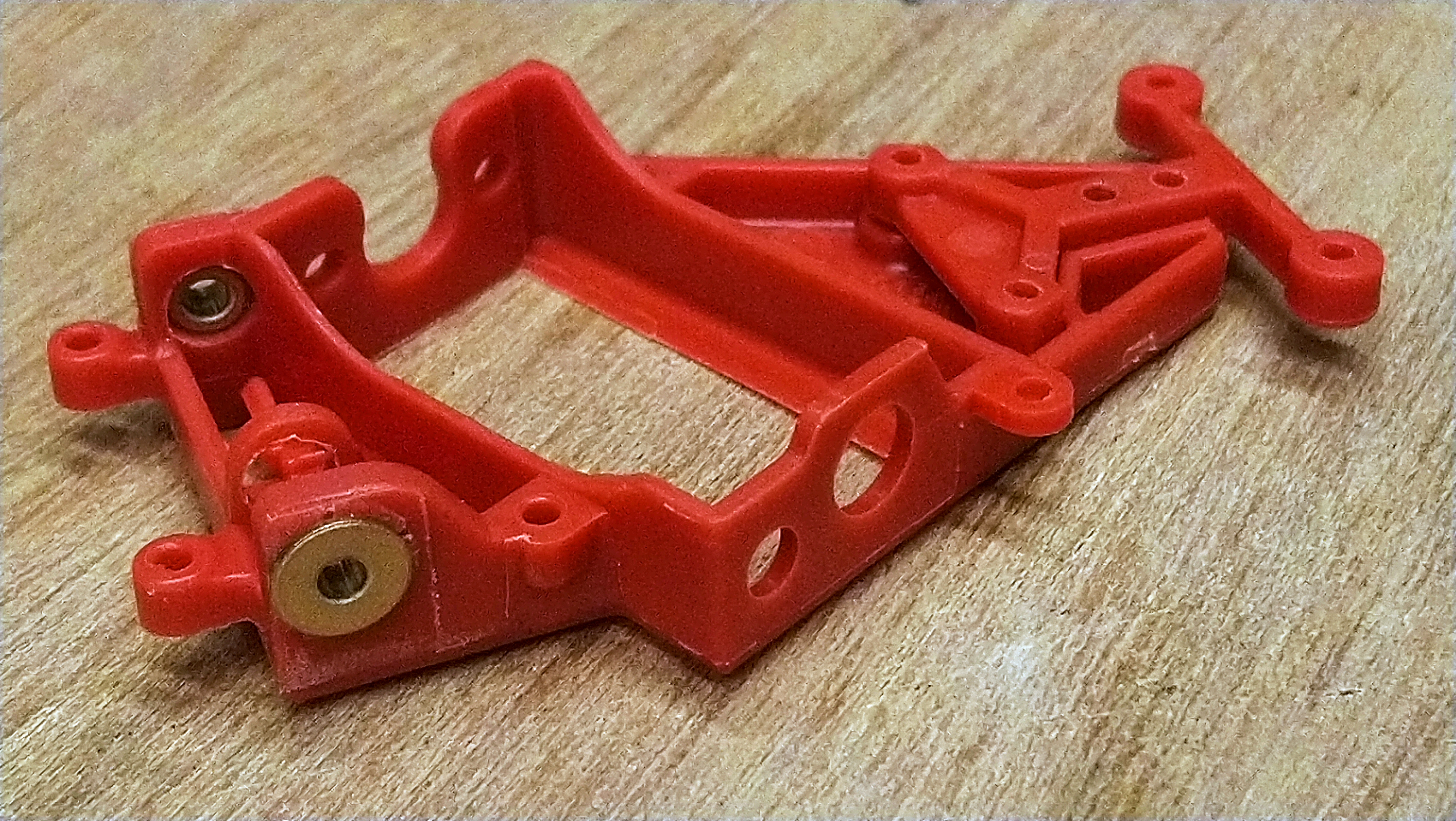

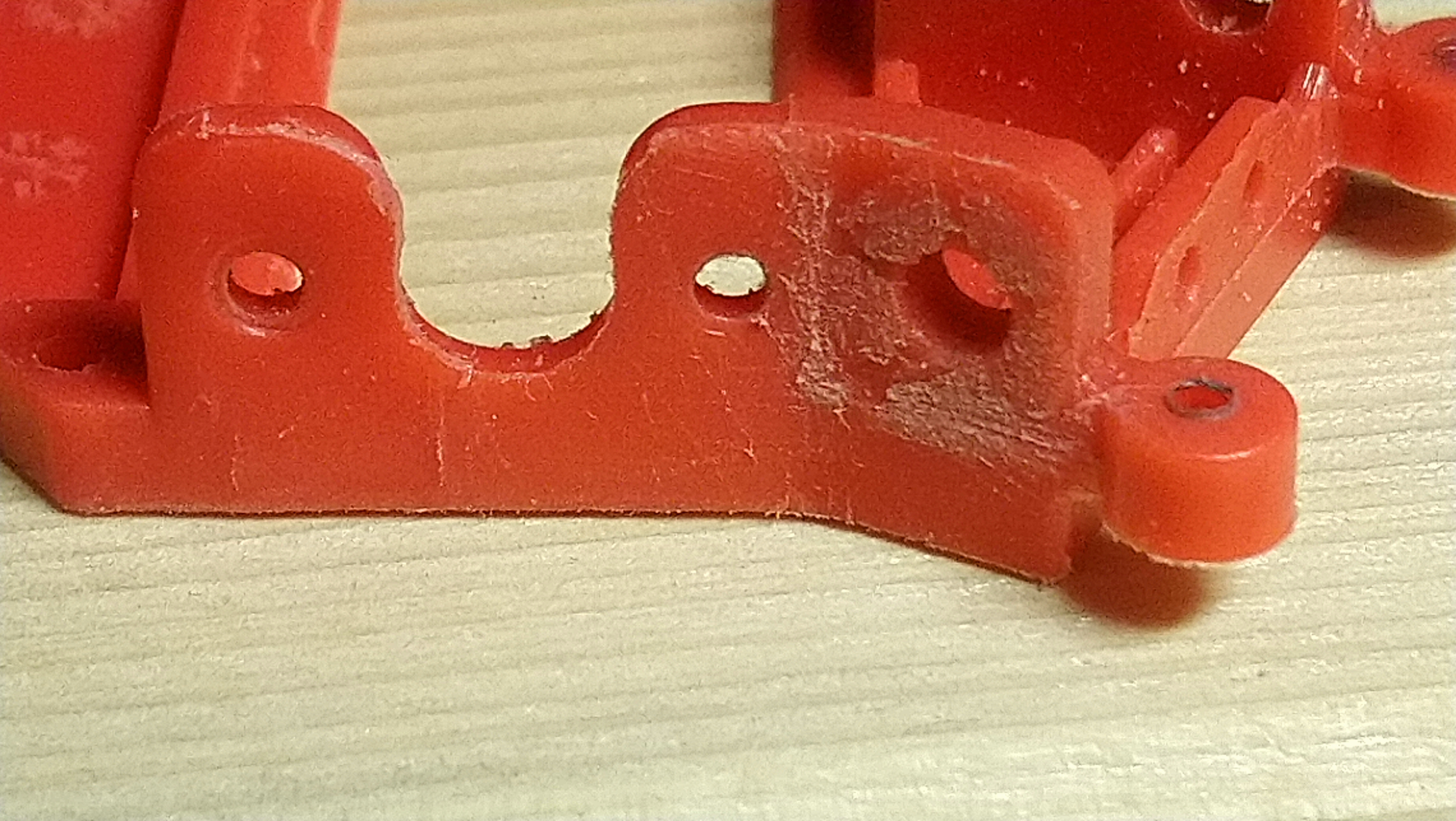

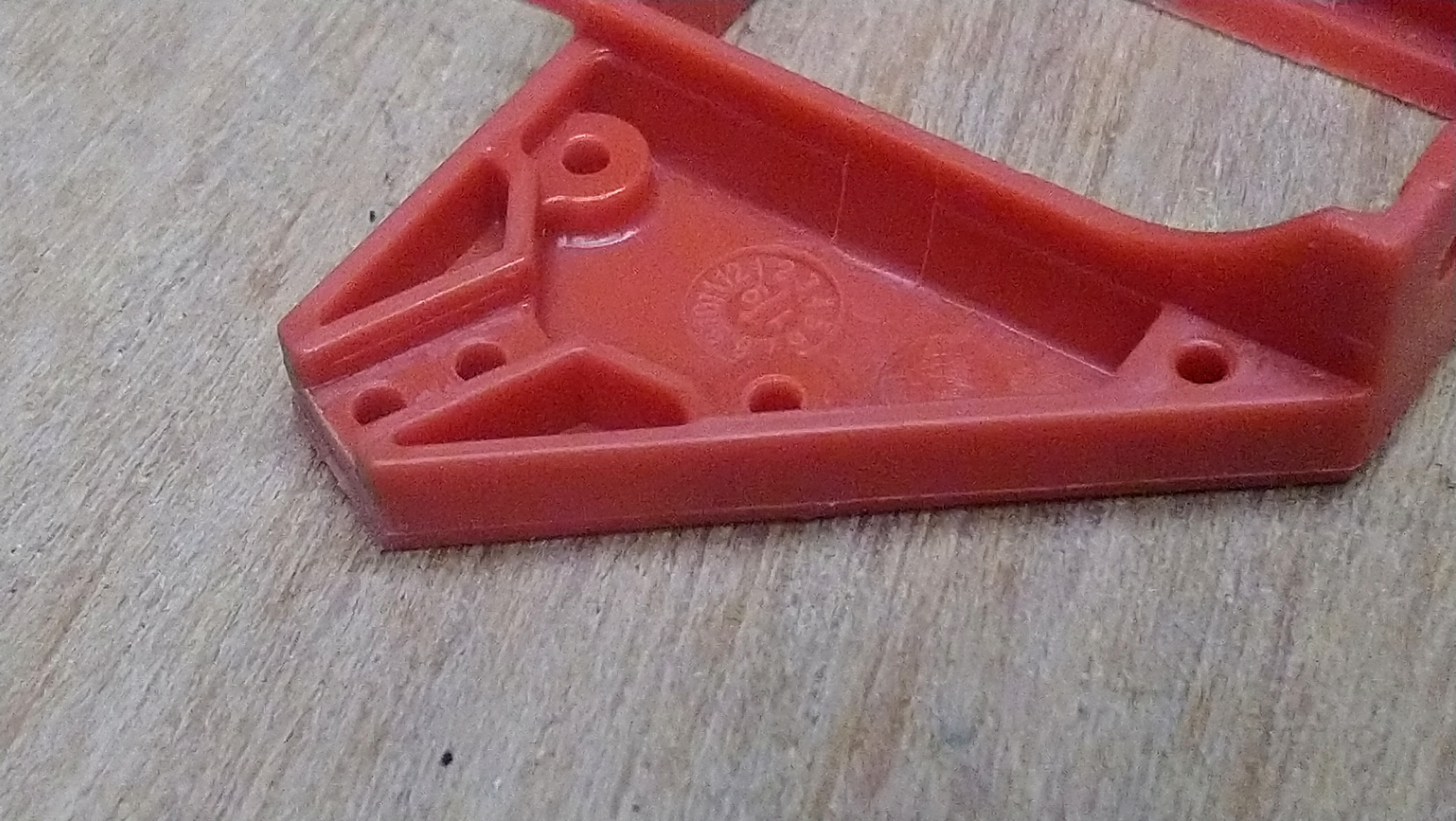

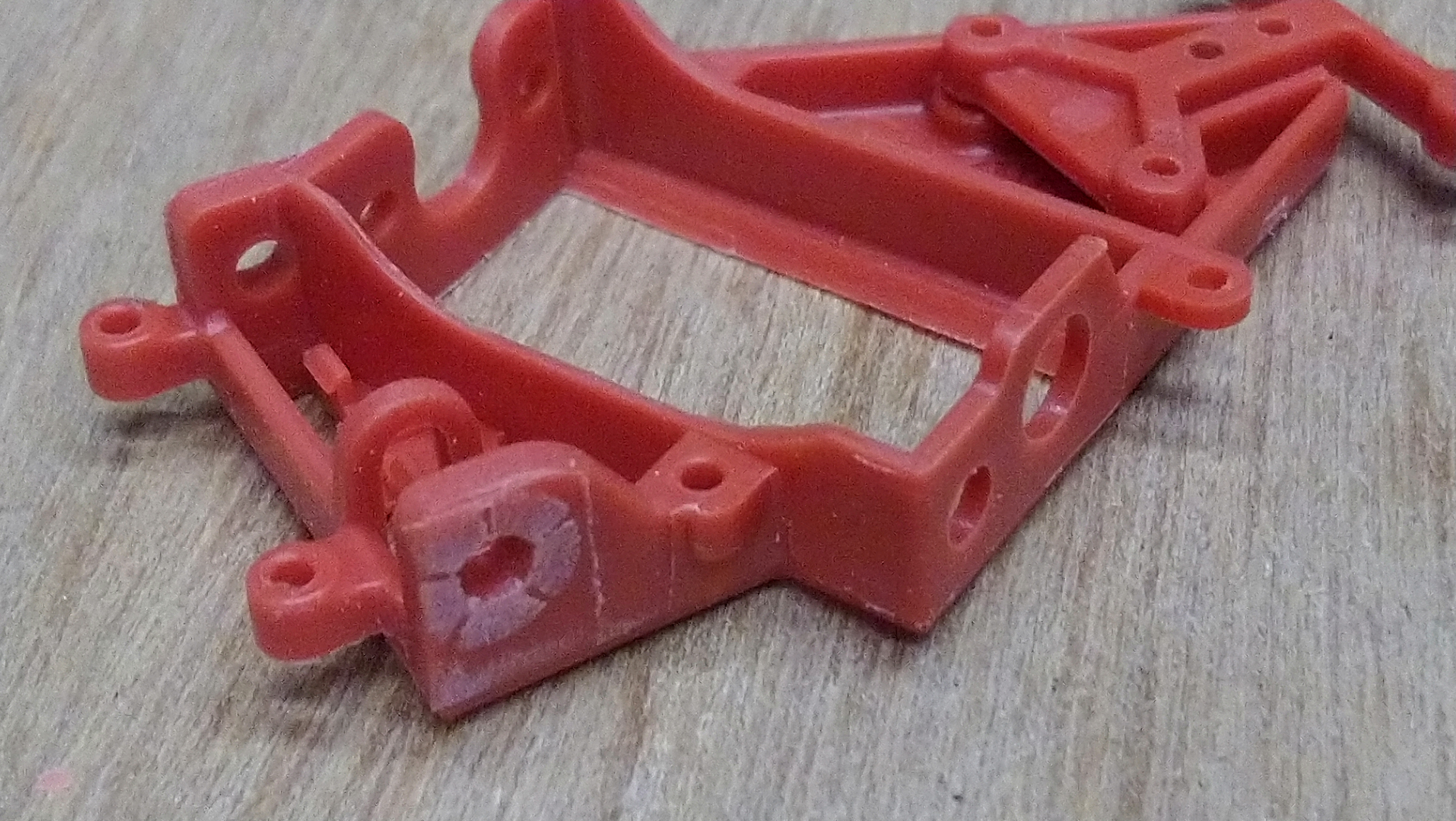

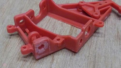

If axle bushings can be self-aligning, they can be self-mis-aligning, and the aim here is to reduce friction or the risk of binding as far as possible. So off with the self-aligning bushing claws...
[attachment=11401]
[attachment=11402]
...and on with the push fit (and to be glued later) oilite bushings...
[attachment=11403]
This was just a first dry fit test. A bit more rubbing down of the pod required to smooth off the last remnants of the claws.

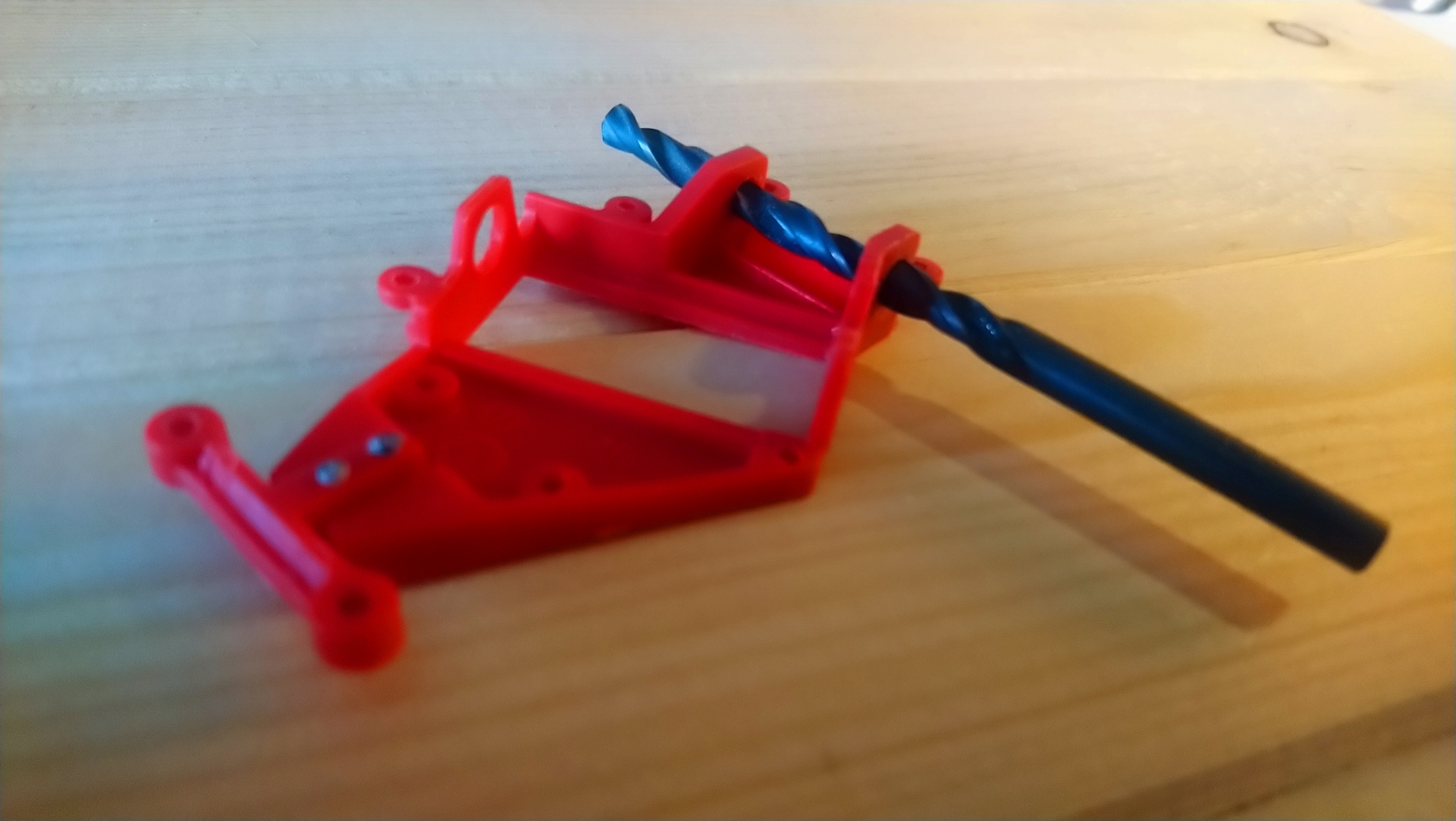

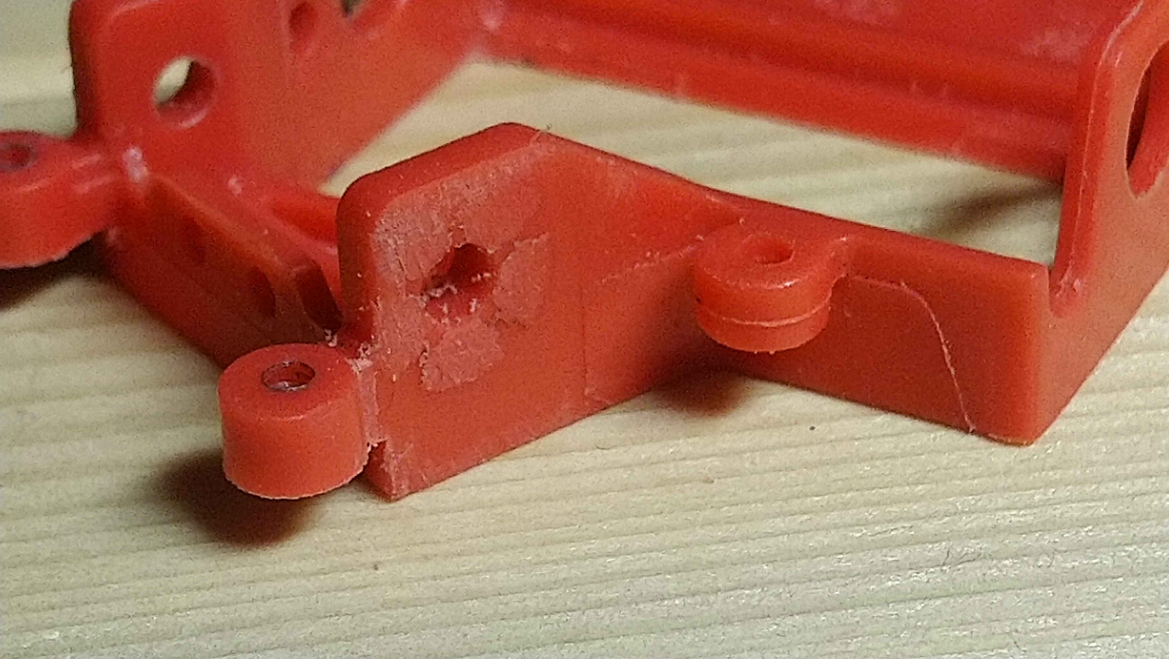

RE: HRW Championship GT3 Proxy 2022 Event Potential Entry - BAracer - 13th-Jan-21
An hour of running a drill through the bushing holes using my fingers seems to have got them lined up properly, as the axle now runs cleanly in the bushings when I push them in place.
[attachment=11432]

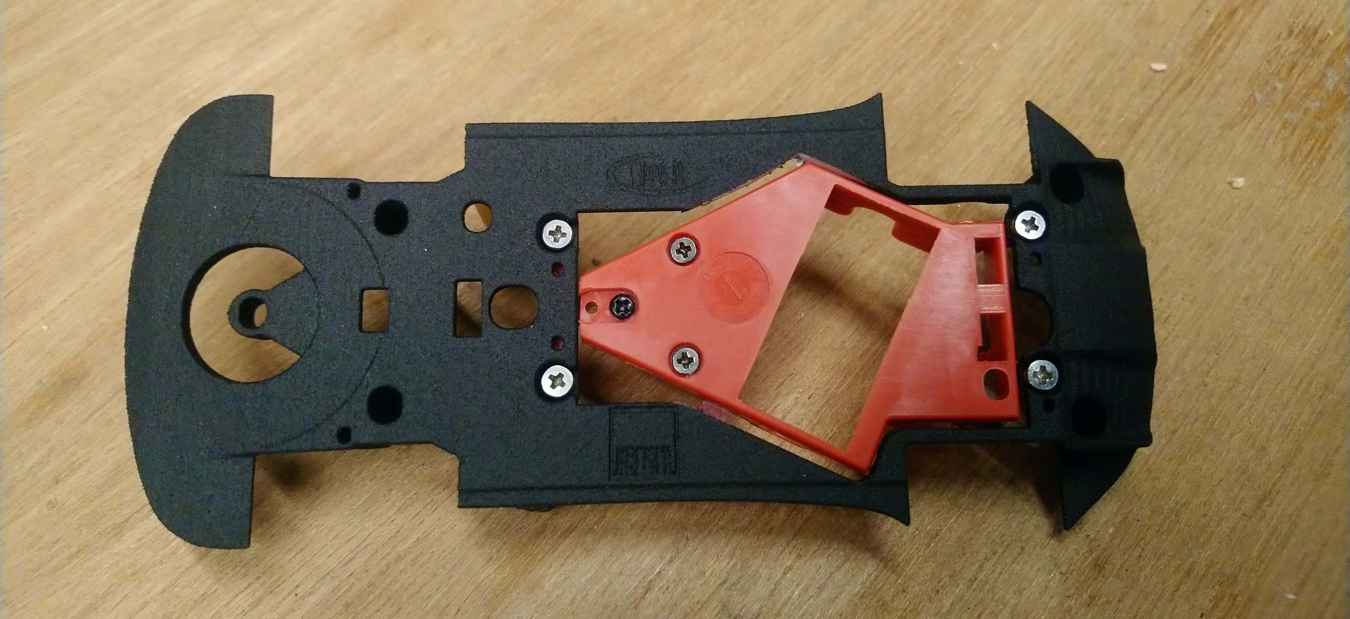

RE: HRW Championship GT3 Proxy 2022 Event Potential Entry - BAracer - 20th-Jan-21

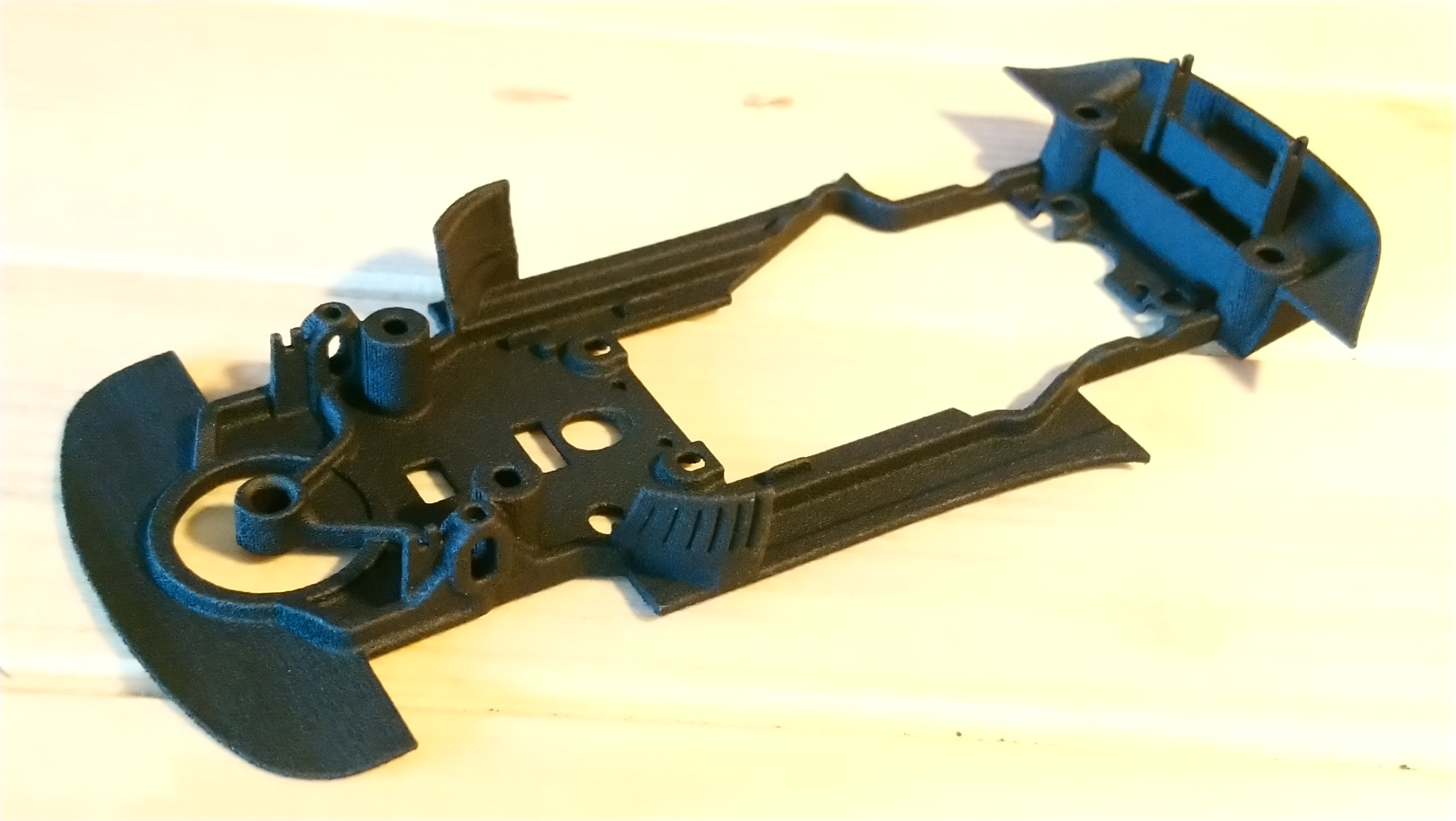

Just arrived in the post from Shapeways...
[attachment=11638]
Aligns perfectly with the body I will be running, but it will need a bit of fettling to get the Scaleauto pod to fit cleanly.

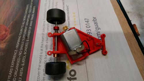

RE: HRW Championship GT3 Proxy 2022 Event Potential Entry - BAracer - 23rd-Feb-21
As I like to say to people at work "It's always quicker the second time"

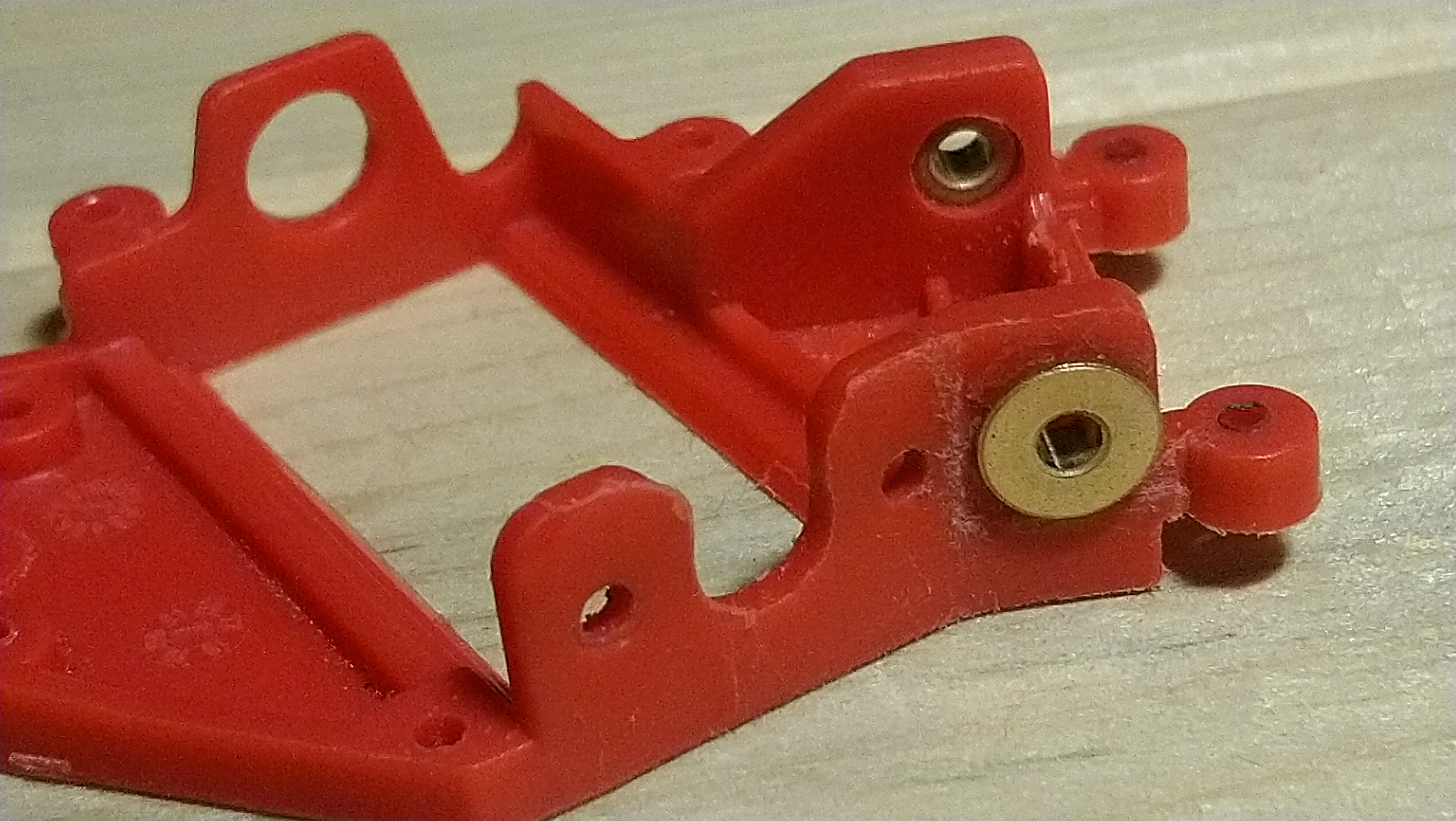

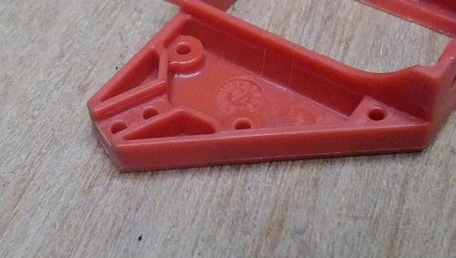

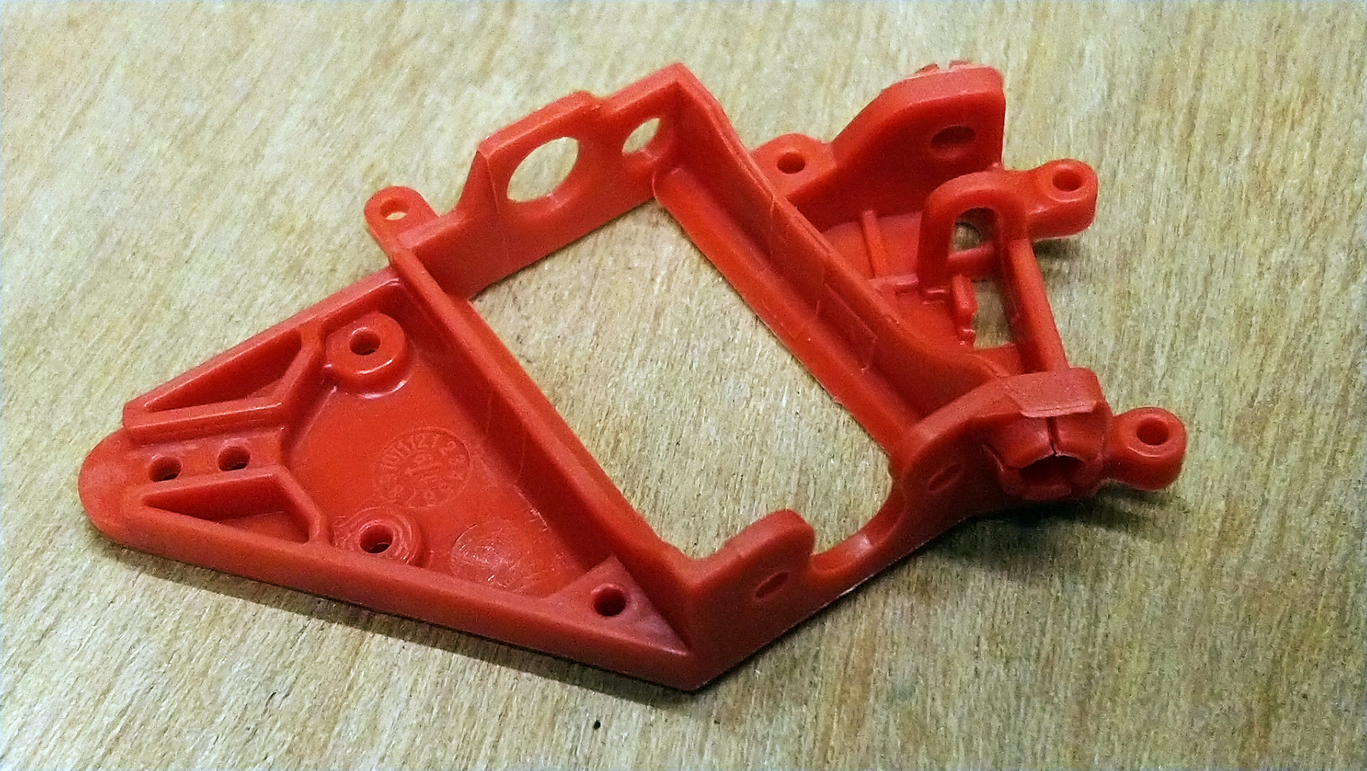

So the pod I prepared did not have a big enough offset once I tried the body on the chassis, too much ride height at the rear; so back to the workbench...
Pod no.2 (0.75mm offset)
[attachment=12770]
Off with it's nose...
[attachment=12771]
Off with it's claws...
[attachment=12772]

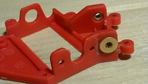

In with the bushings...
[attachment=12773]
And into the chassis...
[attachment=12774]
Now, where was I...

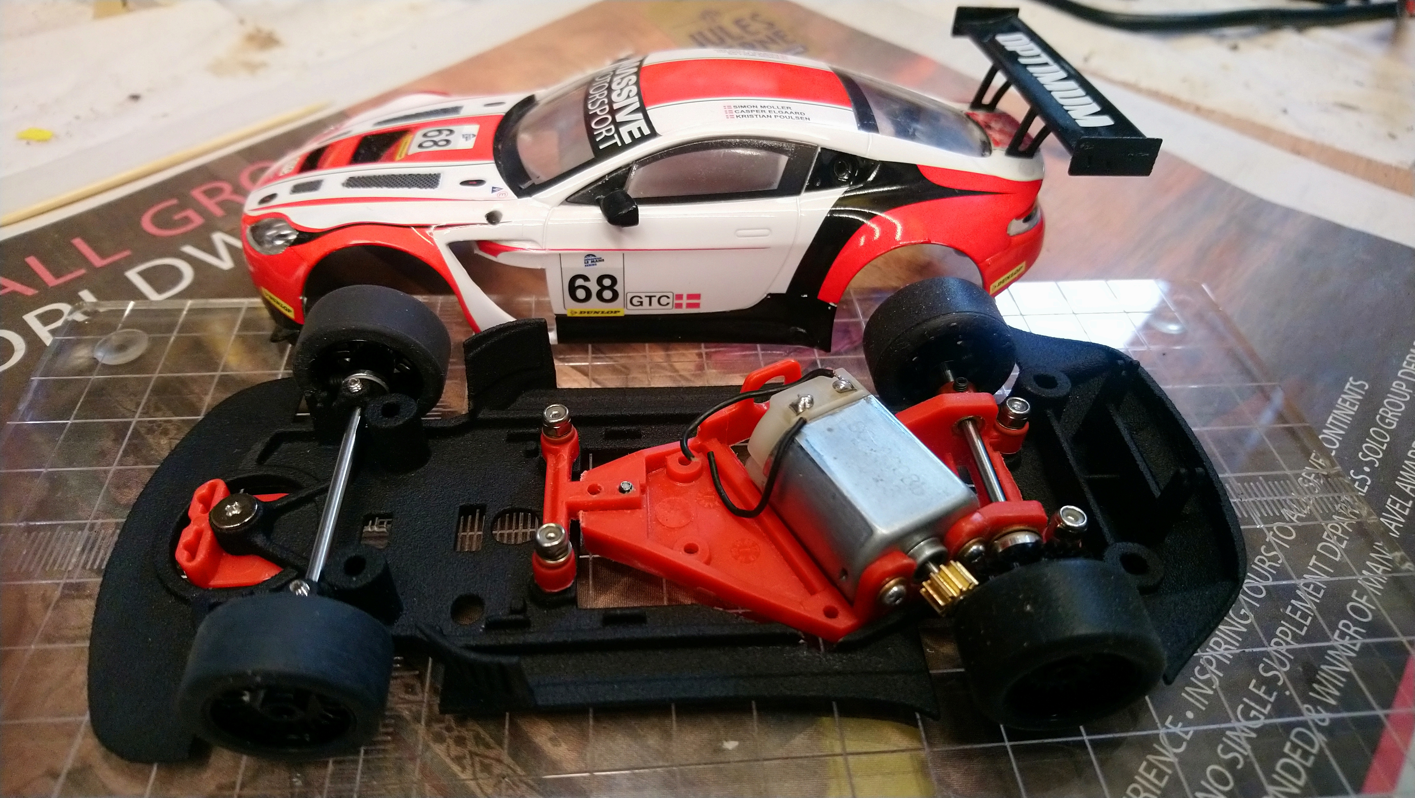

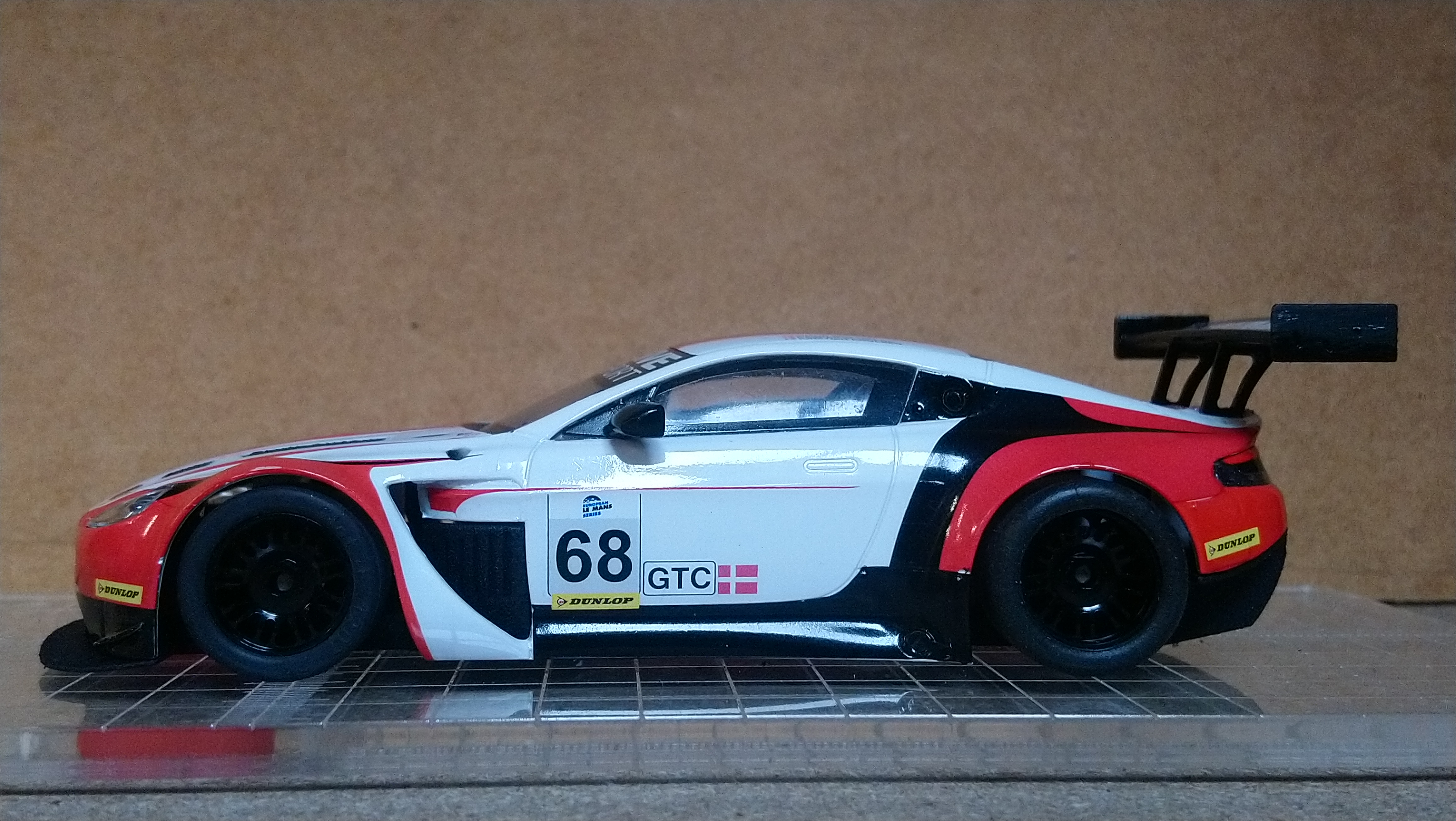

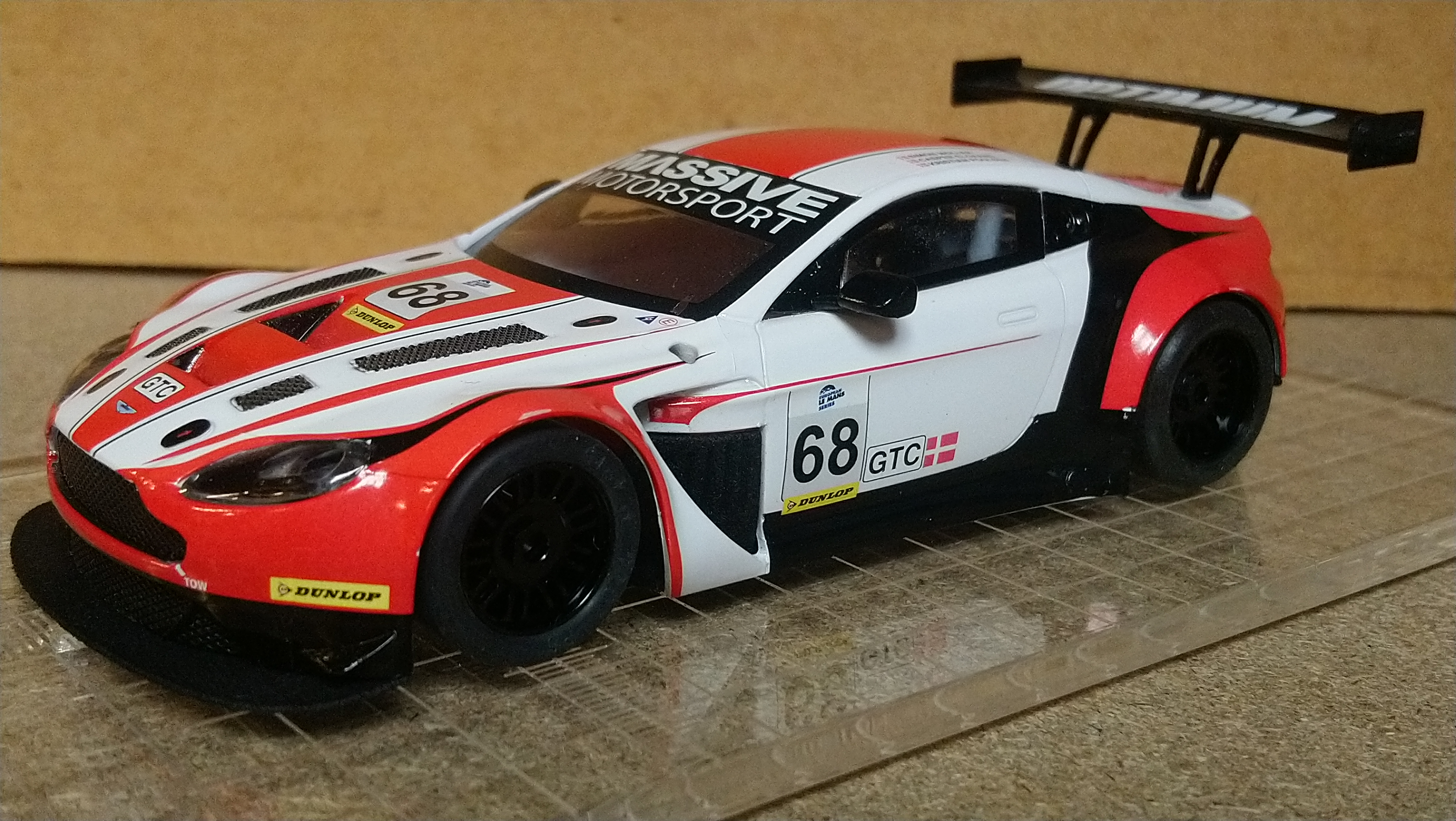

RE: HRW Championship GT3 Proxy 2022 Event Potential Entry - BAracer - 18th-Mar-21
Back onto the build, as I want to run it on my test track next weekend to compare it with my Brighton/John O'Groats Road Race Bentley.
So glued in the bushings using my patent press tool...
[attachment=13475]

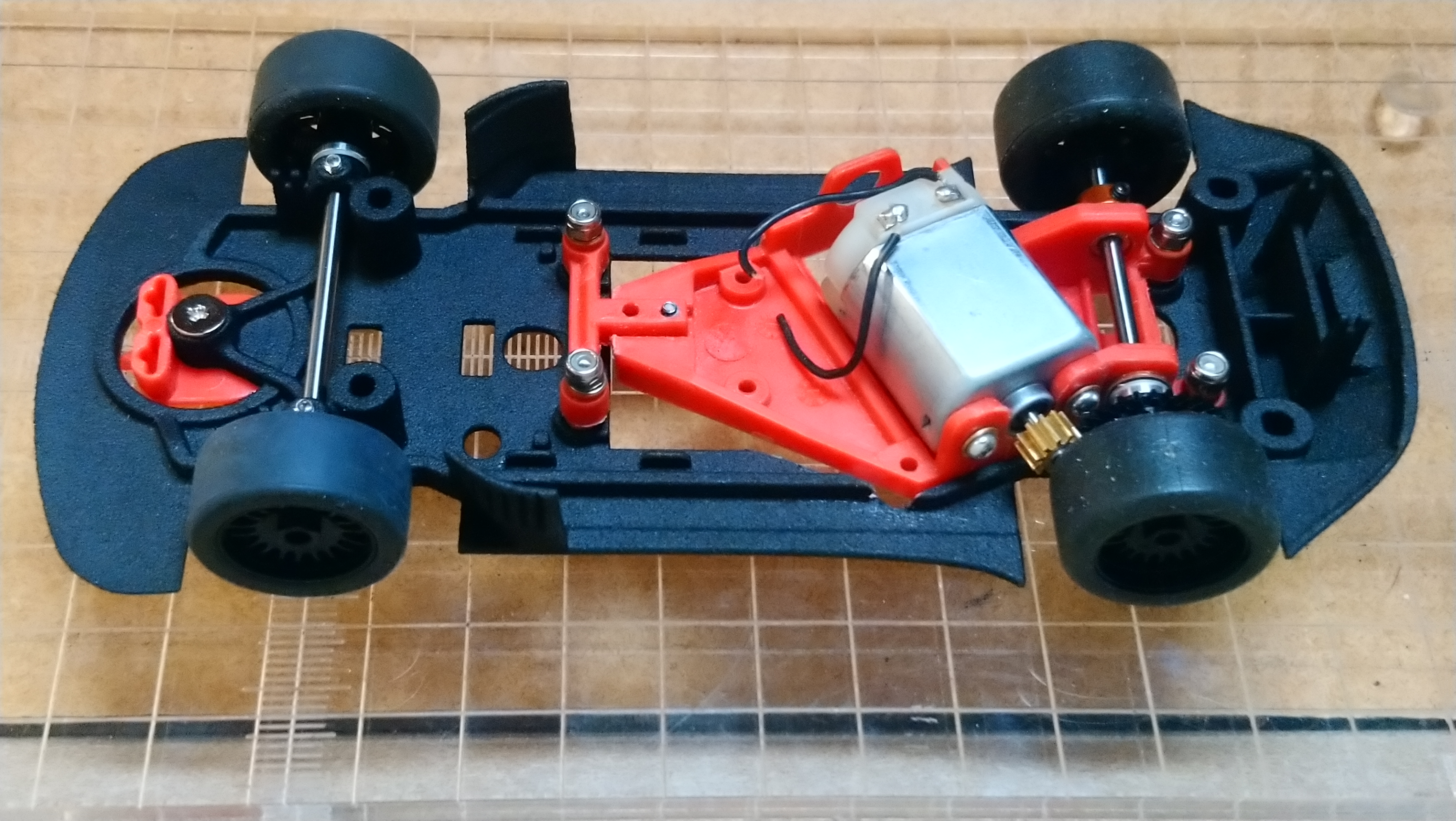

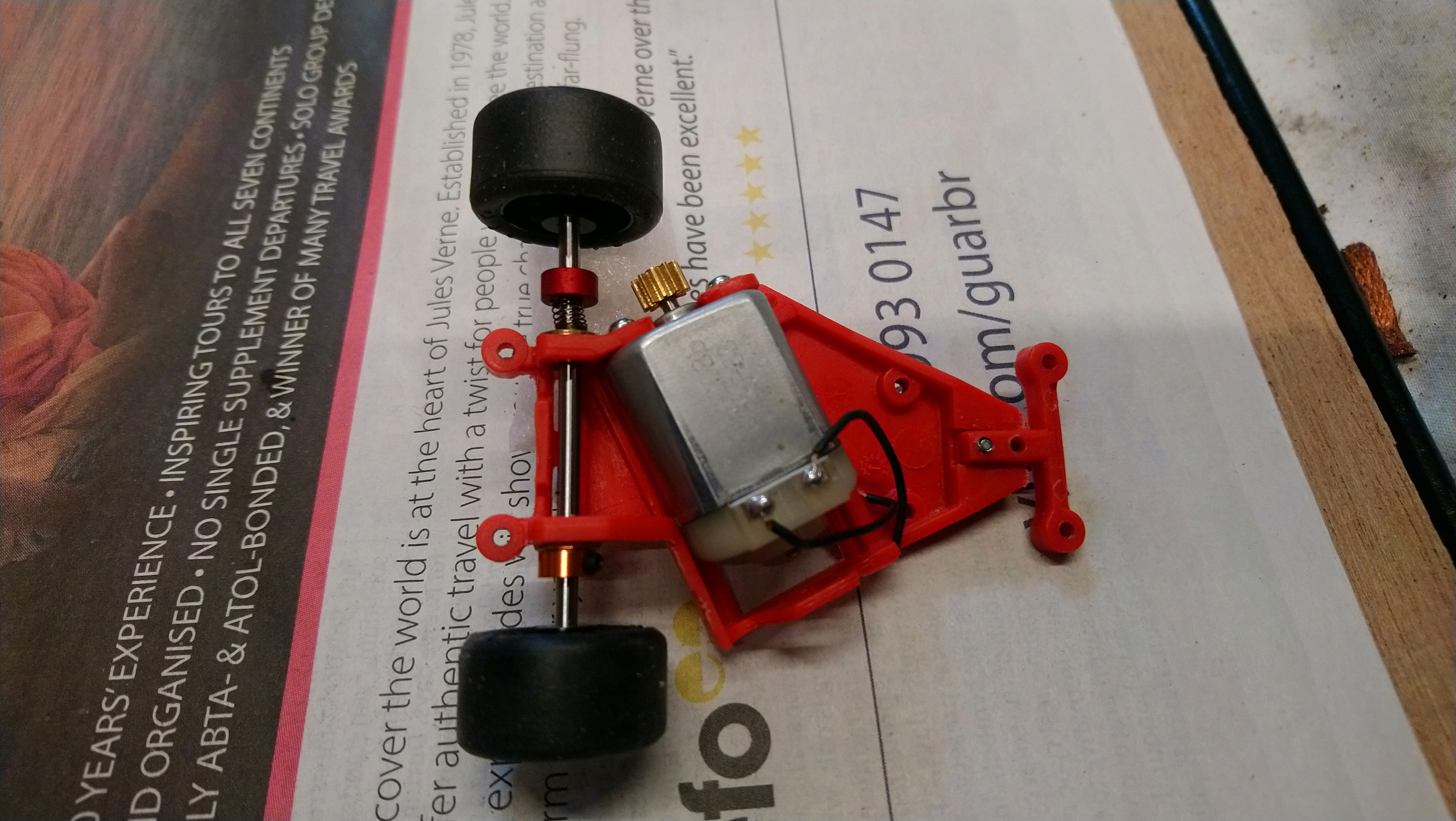

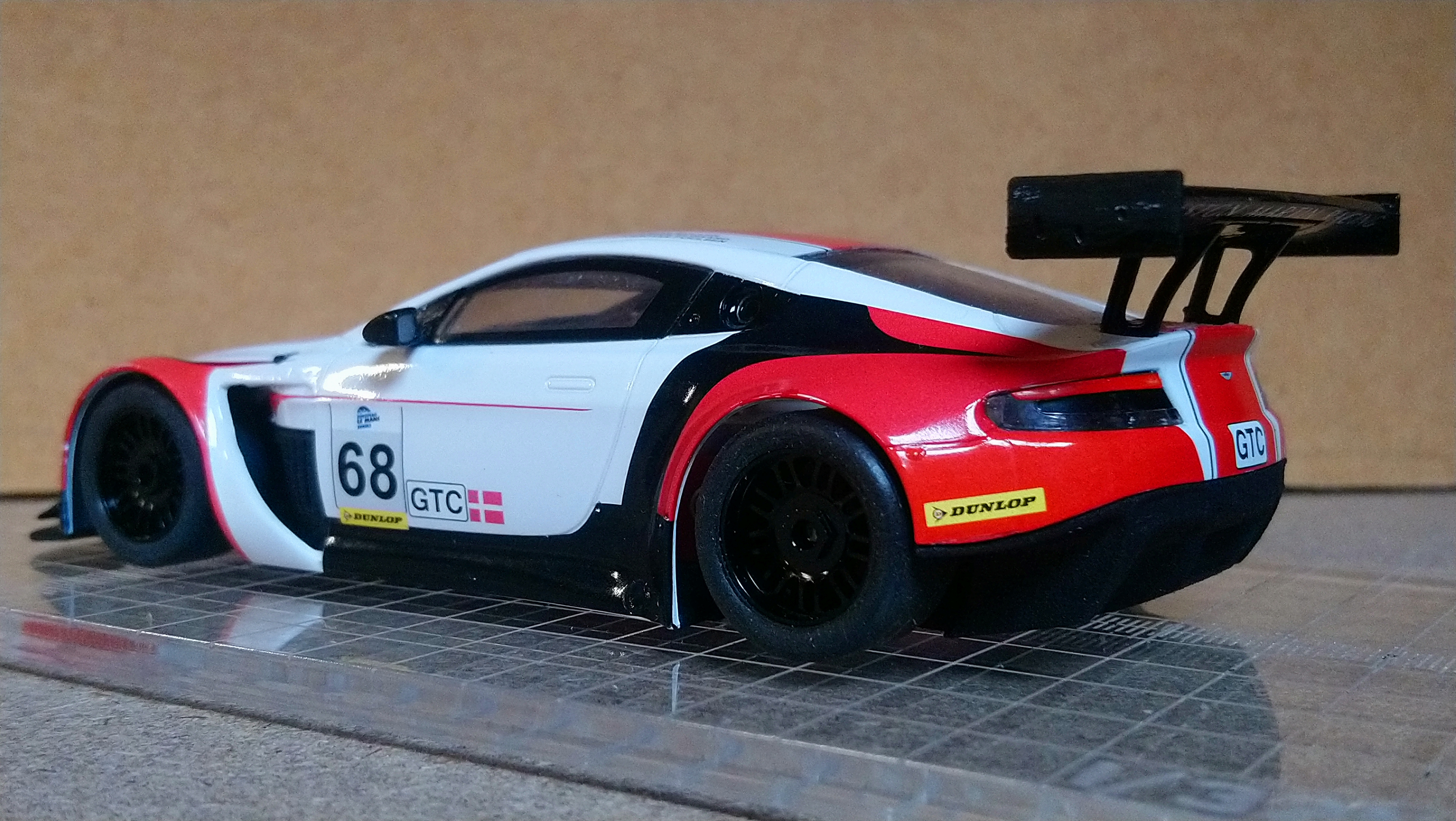

I have spent many hours analysing the motor/gearing choices of this years cars and have chosen my power train based around best practice/gut instinct. So motor, gears, spacers and stoppers installed on the pod, and pod installed into the Slot.it 3D printed chassis using the MR Slotcar fitting kit...
[attachment=13476]
Et voila...
[attachment=13477]
[attachment=13480]
[attachment=13482]
[attachment=13481]
Stance looks good. Staffs wheels look great, and looking forward to gluing the N22s on and spending some quality time on the Hudy this weekend!
