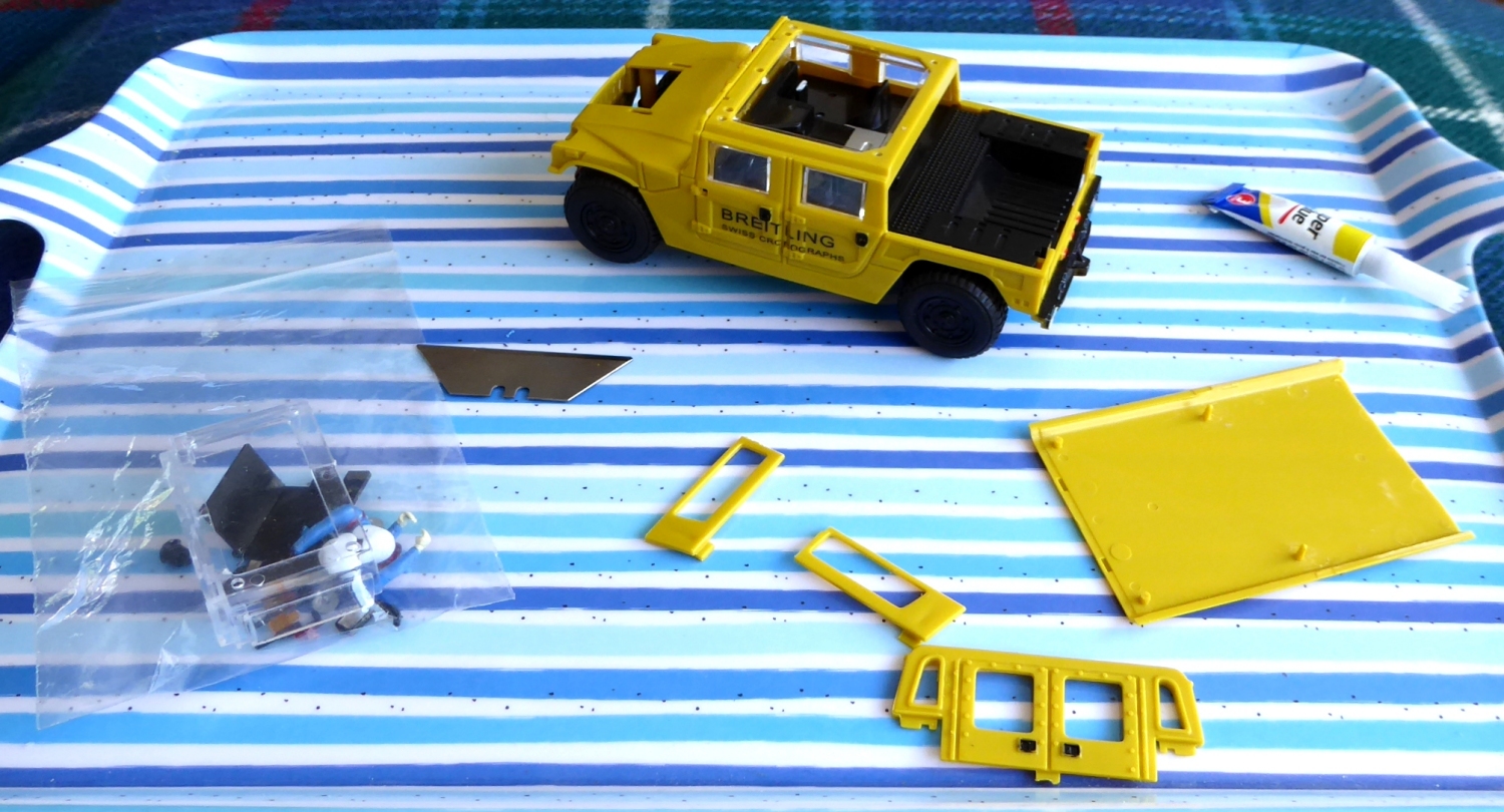

[attachment=13730]

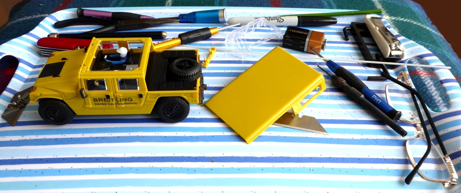

The Hummer remained this way for several days as I lost my bottle and couldn't bring myself to cut it up - but ....... after stripping off the added detail - lights, bonnet vents, mirrors and personnel .......
[attachment=13732]
.... I passed the point of no return, removing the tailgate/rear doors carefully with a Dremel wheel for possible re-use as the back of the crew cab. Side windows succumbed to a razor saw for potentially the same re-purposing, leaving the roof to be shortened - but that's for another day. I think I'll probably follow Powerslot's route though and install a windowless rear wall cut from plastic sheet, using the windscreen surround as a template to fit the roof contour.

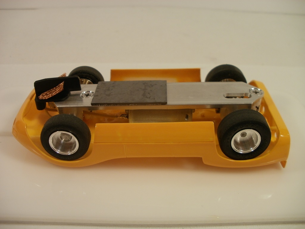

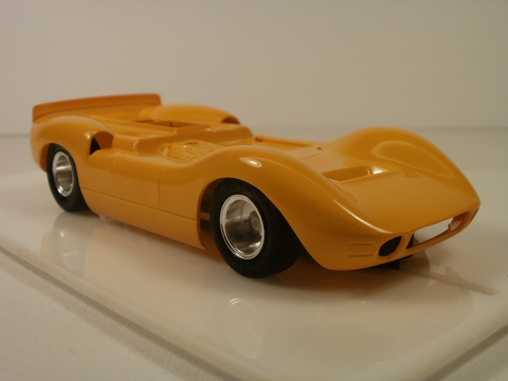

On the bench at the moment is a 1/32 McLaren M1B. It runs, but still needs all the body detail and wheel inserts. A proper build thread will be done when the car is completed.
[attachment=16589]
[attachment=16590]
[attachment=16591]

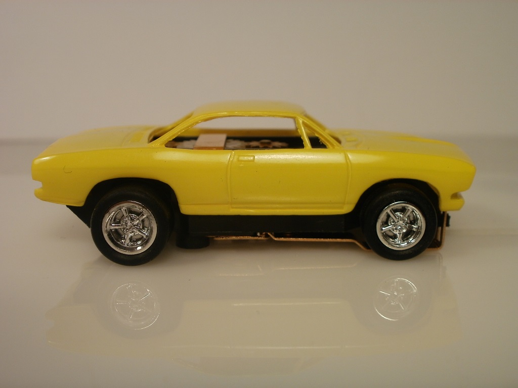

The HO side of the bench is also busy with trying to finish off various cars like this 1966 Corvair.
[attachment=16592]
[attachment=16593]
[attachment=16594]

Did you do the yellow pearl paint Ken?
RE: Whats on your bench ... - KensRedZed - 25th-Jul-21
Hi Top Down,
Thank you very kindly for asking. The Corvair is plain Tamiya TS-16 yellow. And the McLaren is Tamiya TS-34 camel yellow.
Pastel yellow is one of those colours that rarely needs clear-coat.
RE: Whats on your bench ... - Top Down - 26th-Jul-21
Must be an optical illusion then. Highlights look pearlescent on the Corvair  Bigsmile

Ken what brand is the Mclaren? STrombecker?

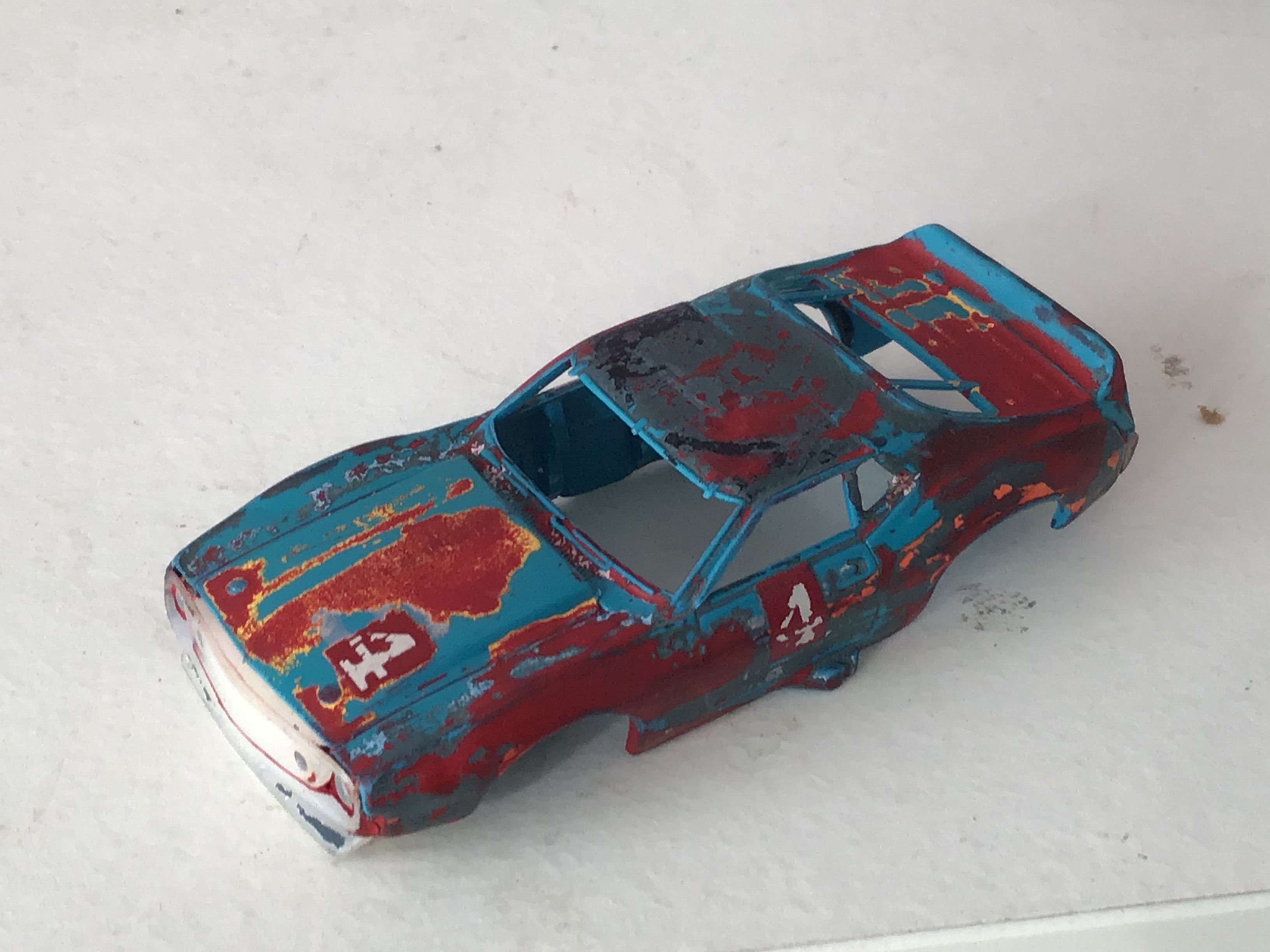

[attachment=16598]A very sad looking AFX Javelin from my spares box is being given a new lease of life for the next drag race at Bear Creek raceway in Texas.
