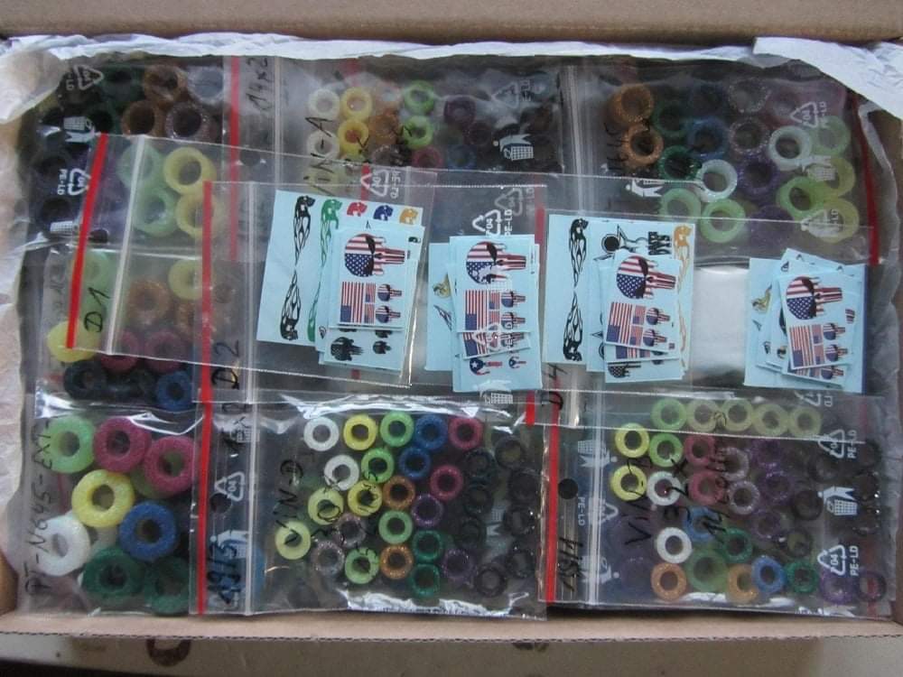

Mr. Woodcote was kind enough to sponsor my first race with a pair of silicone Super Tires. I have bought several pair since, and haven't looked back. Thank you very kindly again, Andy!
I buy Super Tires because I can get them locally. I might consider Hornet Tires if I lived anywhere near Germany, and had a Facebook account.
[attachment=17954]

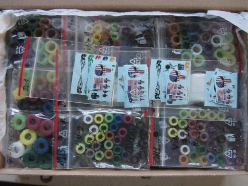

RE: UK HO Drag Proxy Series 2021-22 - Autumn Nationals - RACE THREAD - Nico - 12th-Sep-21
Hornet Silicone Tires has just sent 1500 tires to the US to be sold there.
Available on FB.
Or send Axel a PM here via the Forum as he is a member here to follow my/our Proxy Drag races.
Nico
P.S: he has decals available as well now as you can see in the pic
