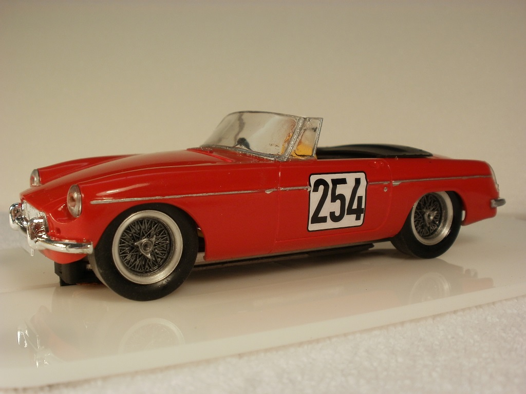

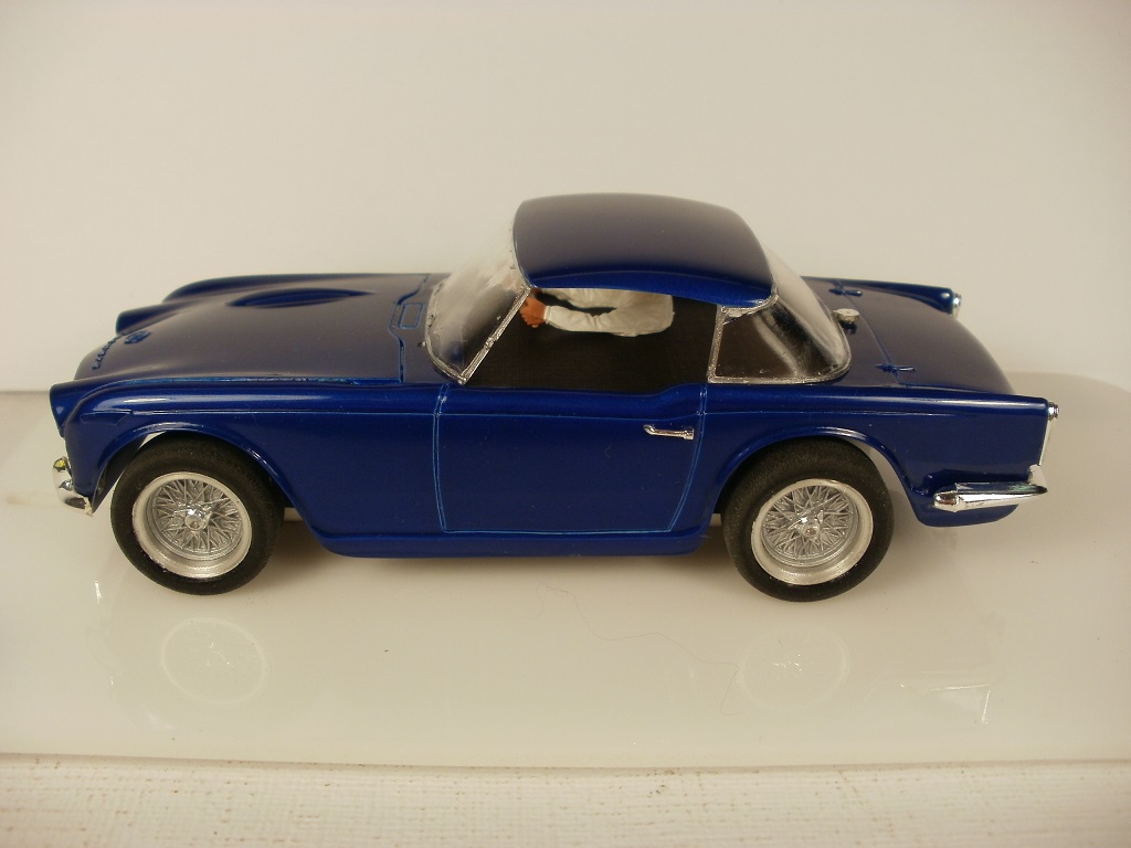

Everyone has a different approach. I prefer 5-minute epoxy for my Airfix, or other scratch build kits.
[attachment=33569]
[attachment=33570]

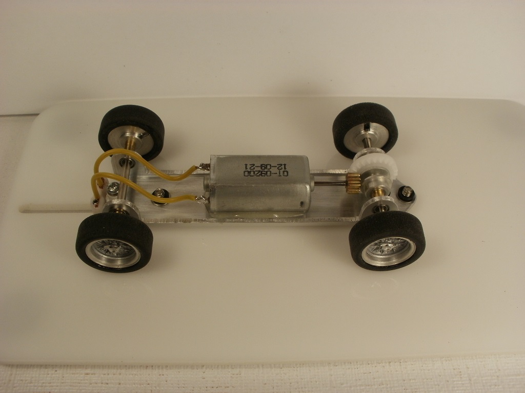

I even glue the motors in with 5-minute epoxy. And the body posts, etc.
[attachment=33571]

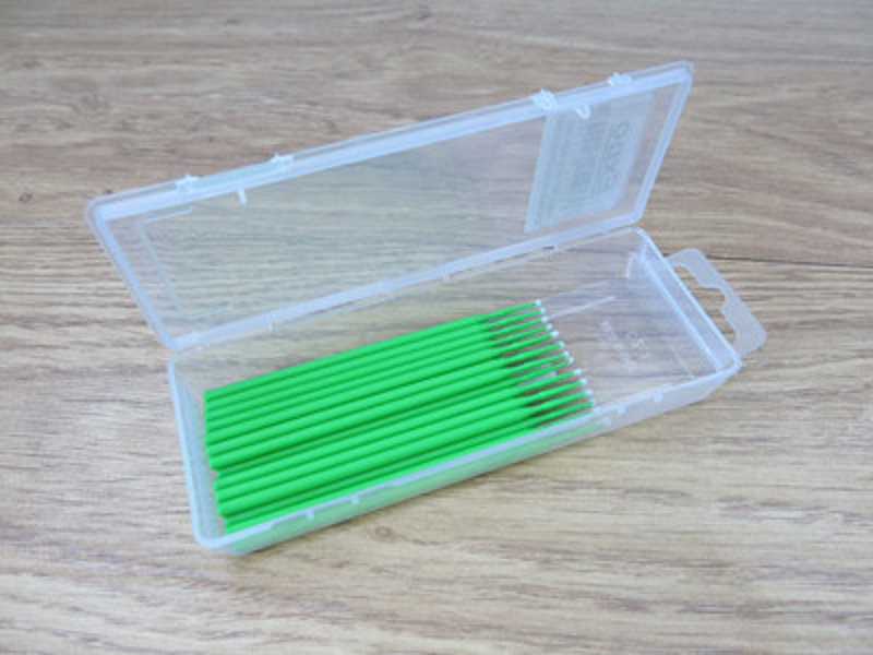

RE: Adhesive recommendations? - StuBeeDoo - 12th-Mar-24
(1st-Feb-24, 09:40 PM)StuBeeDoo Wrote:  The next time I'm in my local model shop, I'll see if they have something similar to those brushes
They do.   Bigsmile  I bought these.  A box of 20 for £2.99.  They do a box of 100, as well.
[attachment=34245]
........By a company by the name of Expo Tools.
